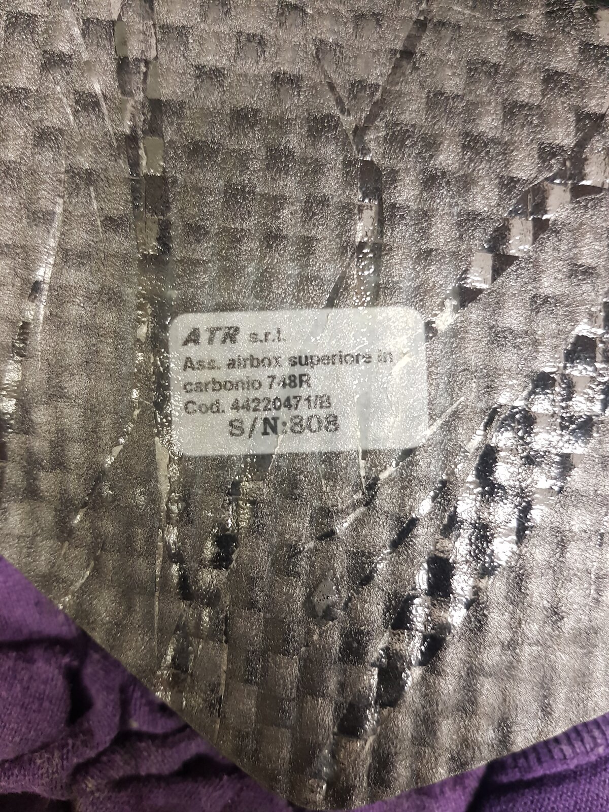

    Bologna! I agree, I'm refreshing and repairing carbon at the mo, the engine may need to come out for a proper clean, and so far the frame doesn't look too bad. Maybe a gentle touch up to remove discolouration around some welds. Wait and see!
  8. Just sanding down then carbon as several bits are severely faded. Found that the carbon air box is from a 748r. I feel that a previous owner has tried to turn this into a foggy rep. 20190121_194900.jpg

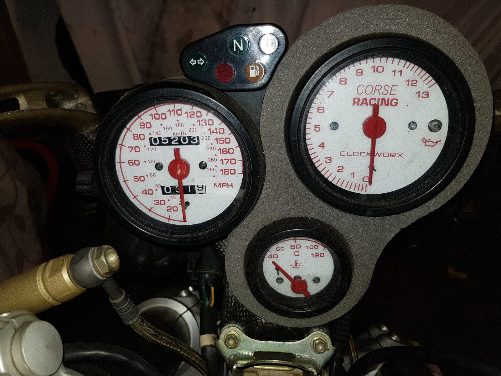

  9. So, stripping down, and as previously mentioned, the clocks are red, when I think they are supposed to be white and green. Any ideas?
    Also, the bottom piece of the exhaust has a dent, is this on purpose to fit inside the fairing, or do I need to see a man with a water pump!
    Think I'll start in the projects thread with the next queries! 20190125_125126.jpg
  10. You have some period 'tat' clock faces - people swapped them who and no taste or were clinically insane.
    Some people hack sawed around the back of the bezel and re glued to swap - if you were careful I think you could get them apart without doing this. There was a recent thread on here about removal of the bezel. You probably can't buy spare faces - I would look out for new clocks: often on Ebay for around £100 each or so {new old stock} - then wind to the correct mileage... make sure the temp gauge is in centigrade as yours and the speedo is the same to 180mph (presuming the white face dials were the same of the original clocks - there were a few differences. Do a bit of research first to confirm the correct clocks.
  11. Nice one! I have come across the same problem on my last Mito build. Prying bezel and carefully cutting through glue. There was a guy that gave you jpegs of the faces, and you just printed them out. Tried researching last night, not much found, and kept getting turned out. Many thanks as always.
