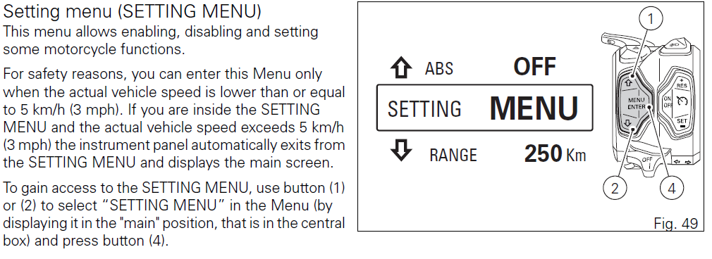

  2. I think its as folk are mentioning, because it changes the ride height and damper settings

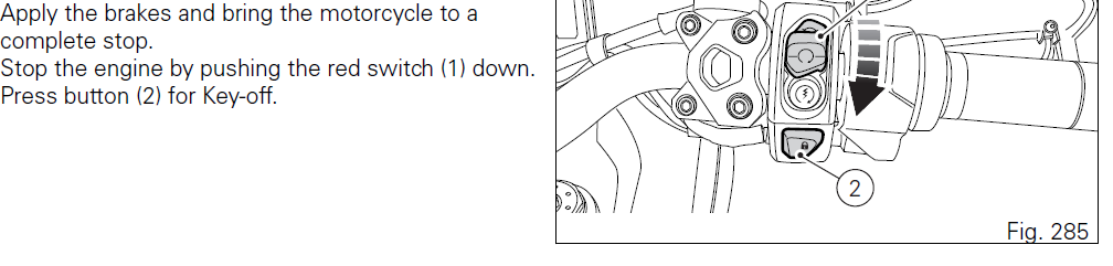

  3. I think the Multi is different from the Panigale in that the power off/on is a separate switch and the red kill witch is ignition off. Below from manual
  4. My last was different to that. The key off was in the centre of the tank. Not sure where 1260 is
  5. The 1260 is button 2 in the pic above (ie, the button the V4 MTS has for changing auto lights on/off)
  6. This is all too much. I’m going to go back to just jumping off at 2mph like I used to on my BMX.
  7. That's right. The kill switch only turns the engine off. All the other stuff like lights and dash stays on.
  8. So I found out why the ignition stayed on. The ignition button at the front of the tank was stuck in! All good now :)
