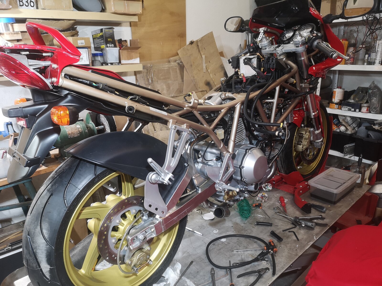

  2. I did a bodywork test fit...hmmm...it's still an ssie...:thinkingface:
    Not entirely sure where to go with this one..I'm going to finish everything except paint/bodywork and then decide outside in the sunshine. The garage is too small to stand back and really see.

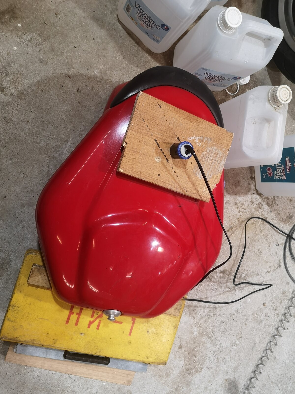

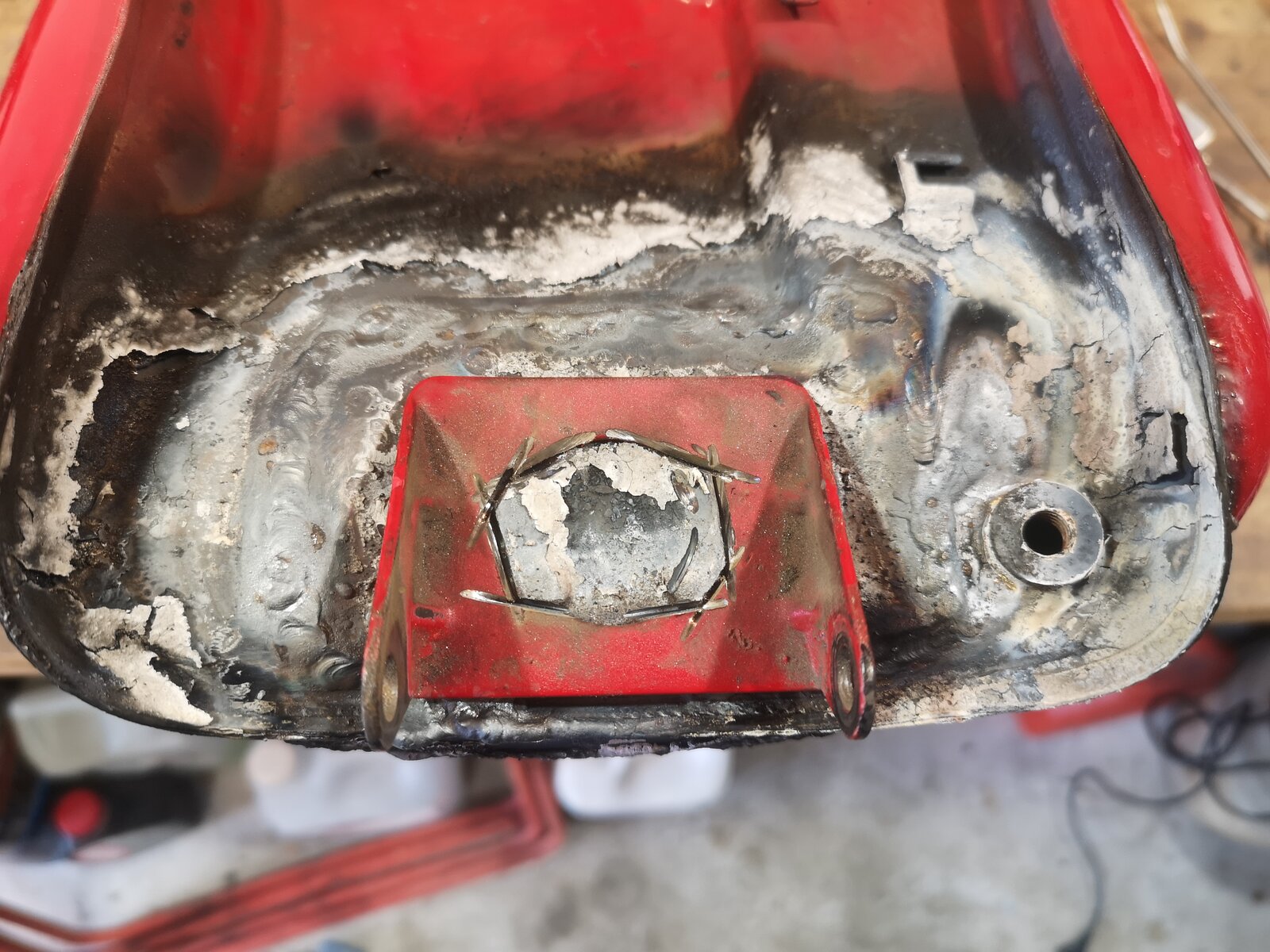

  4. I never did sort the tank issues started quite a few months back. So armed with 15 litres of vinegar and a water heater from my plating kit...
    Woke up the next morning to a garage floor covered in vinegar..bugger! The vinegar did a good job of cleaning the corrosion off the inside of the tank, but it was clear that there was a hole.

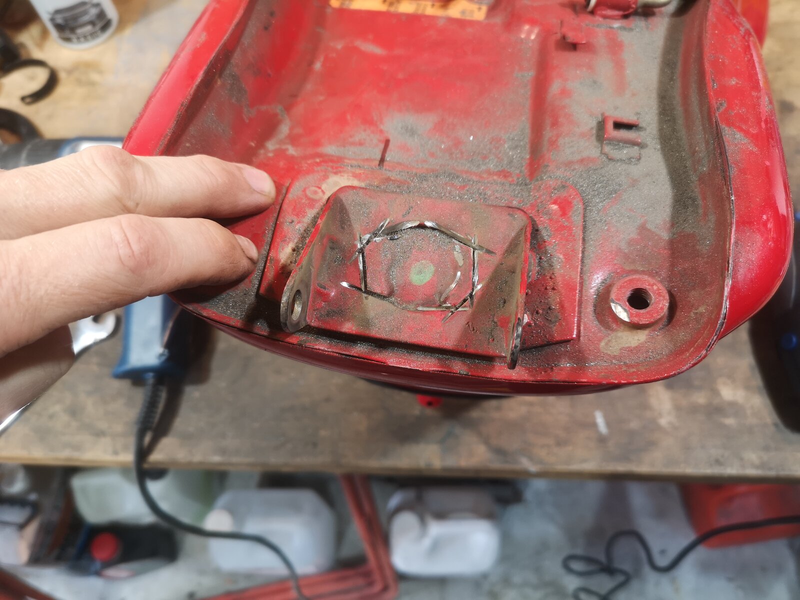

  5. Tracked it down to the left side...I did think about welding only that edge, but the reinforcing plate is spot welded in place so the chances were that the fuel would just come out from under the plate in a different location. In the end I decided to remove the hinge with a Dremel, cutting through the weld carefully, so you can put it back exactly where it has come from. Then weld the complete edge of the reinforcing plate.

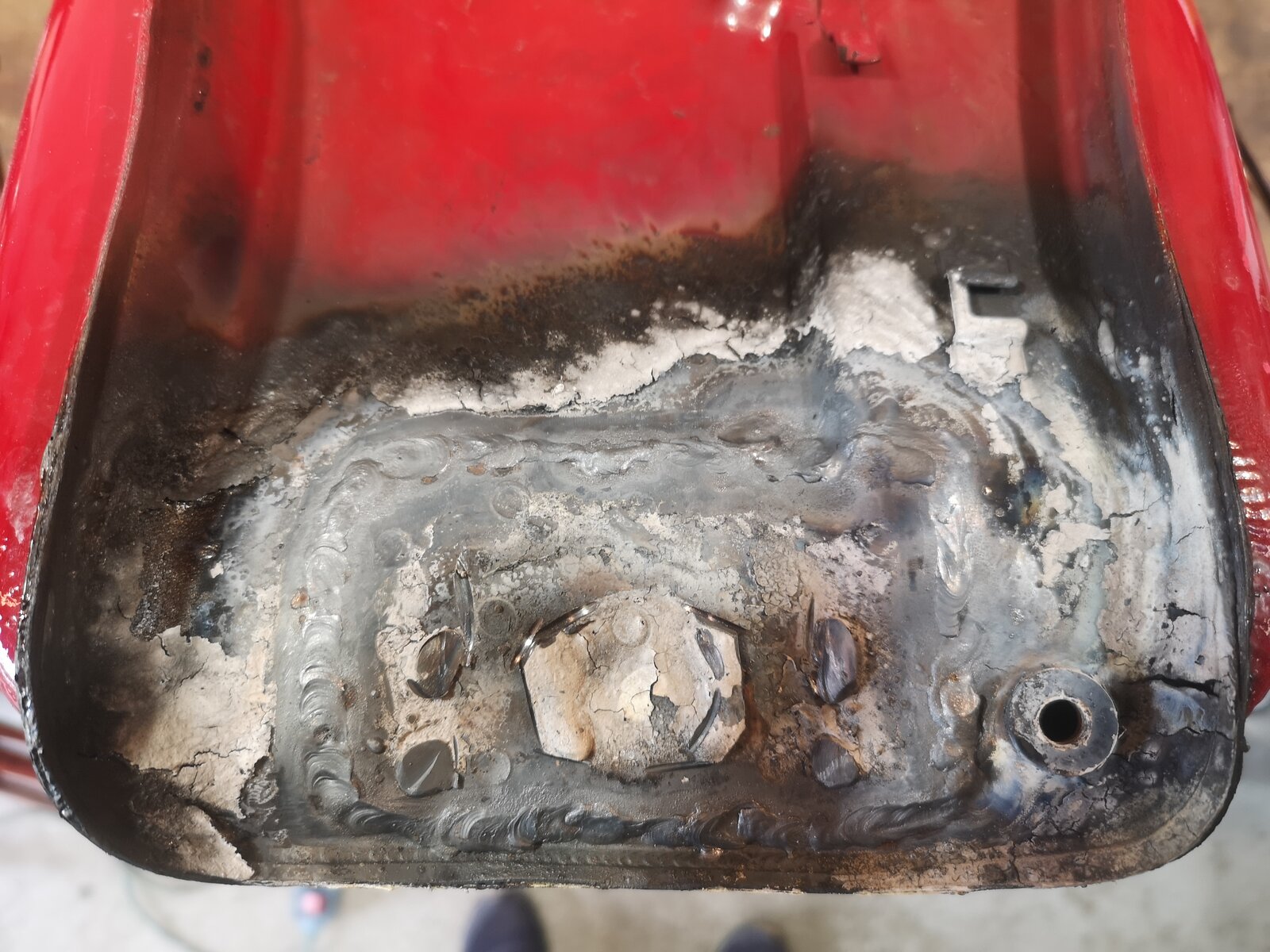

  7. It's been more than 30 years since I have gas welded, but it's still my preferred method. Not perfect, but considering how long it's been...
    I managed to cure the leak on the left, but then the expansion and cooling of the sheet metal started to cause cracks on the right, typical of rotten steel sheet...(I remember this well from VW Beetle floorpans!) Ended up chasing it for hours...weld, cool, add fuel, test, drain, vent and repeat...eventually got it in the end, and welded the hinge bracket back on in exactly the same location.

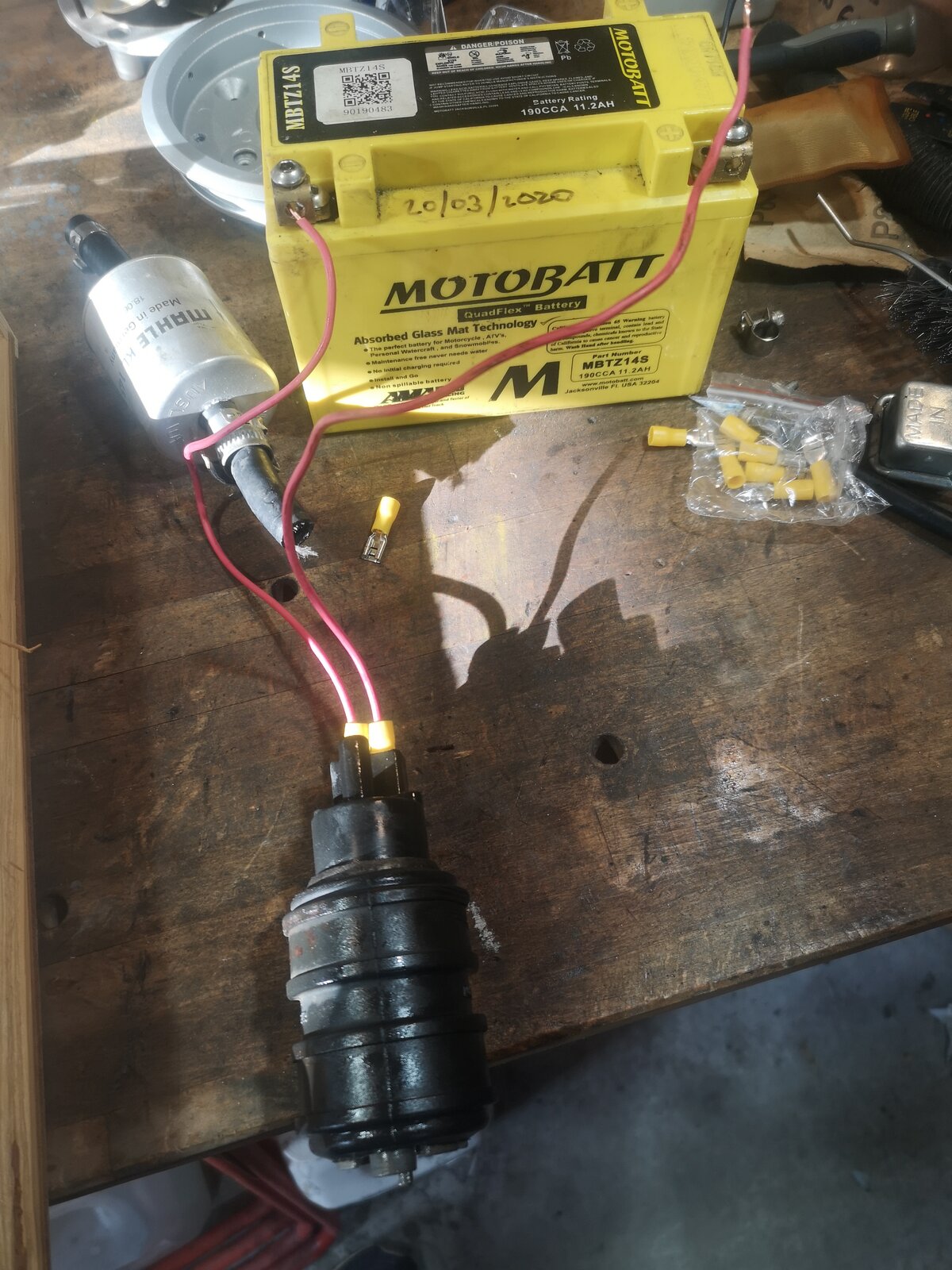

  10. Turned key...lights...primed oil pressure by having plugs out. No sound from the fuel pump...hmm..
    Turns out having an old pump dry means it will likely seize...sprayed WD40 inside...still nothing. Eventually freed it off by attaching it to a battery and very quickly whacking it multiple times on the bench.:upyeah:

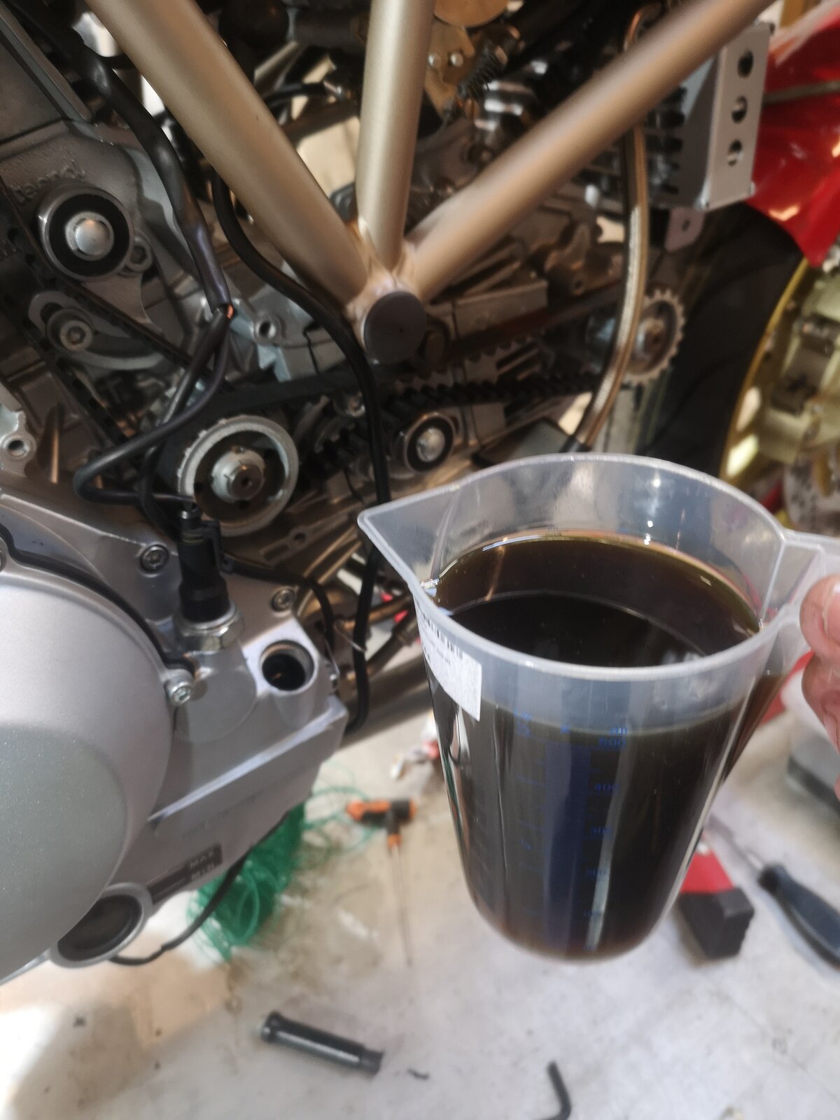

  11. Yeah...shitty oil just for startup and checks... good stuff comes later! :upyeah:

  12. Ooo... splendid! can we have a prolonged and heated discussion on which oil is best to use?

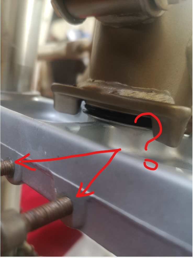

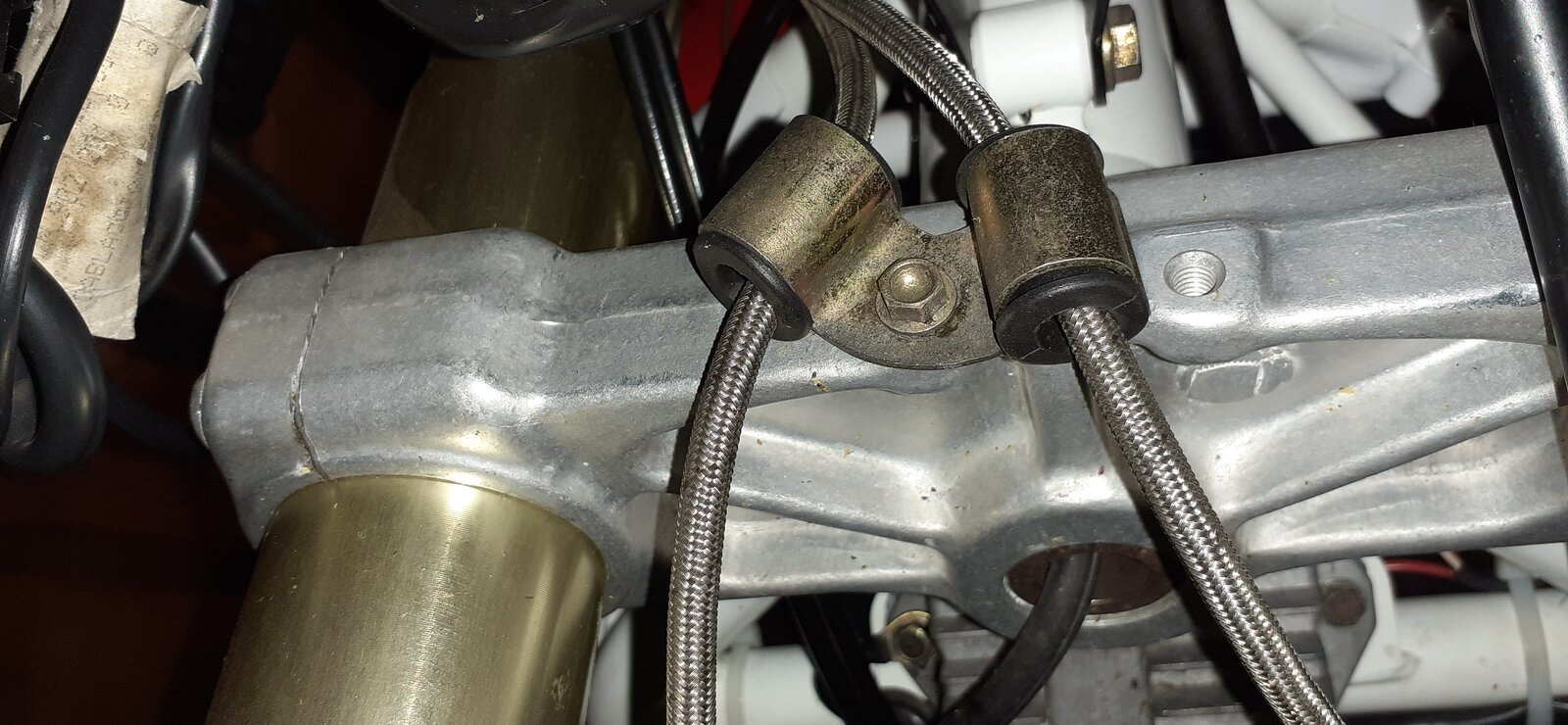

  14. Thought the bolts were for a bracket to hold the brake pipes, only 1 brkt with 1 hole, it looks like you take your pick which hole you use.
    Great thread, but can I ask one thing. Could you change the cap screws holding the rear hugger on to something with a lower profile, flat or button head cap screw. Obviously you don't have to (and tell me to get stuffed) but feel it would look better as they jump straight out when I saw the picture.
    Nice sticker / graphic work.
    Cheers Gaz

  15. Yeah, maybe button head, or even just black, I think it's the contrast :upyeah:

  17. Oh and cheers for the explanation. I don't appear to have those brackets...:thinkingface:
