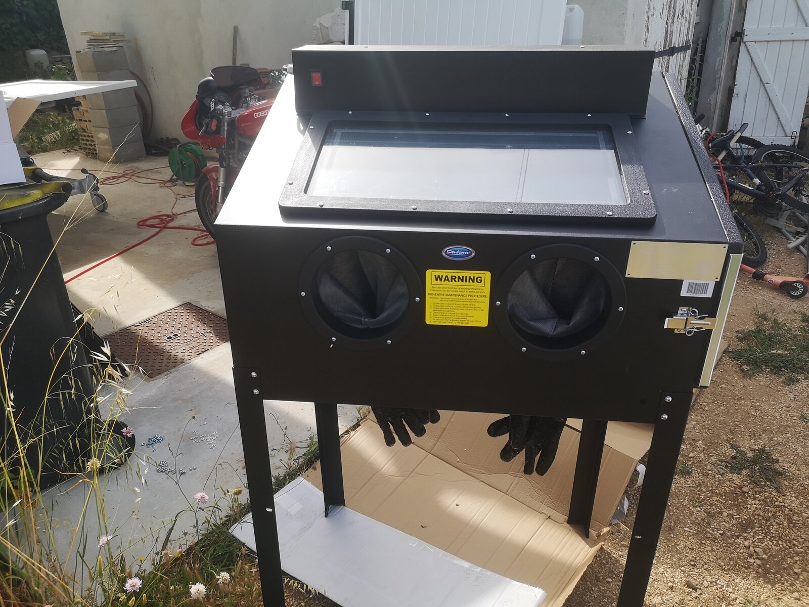

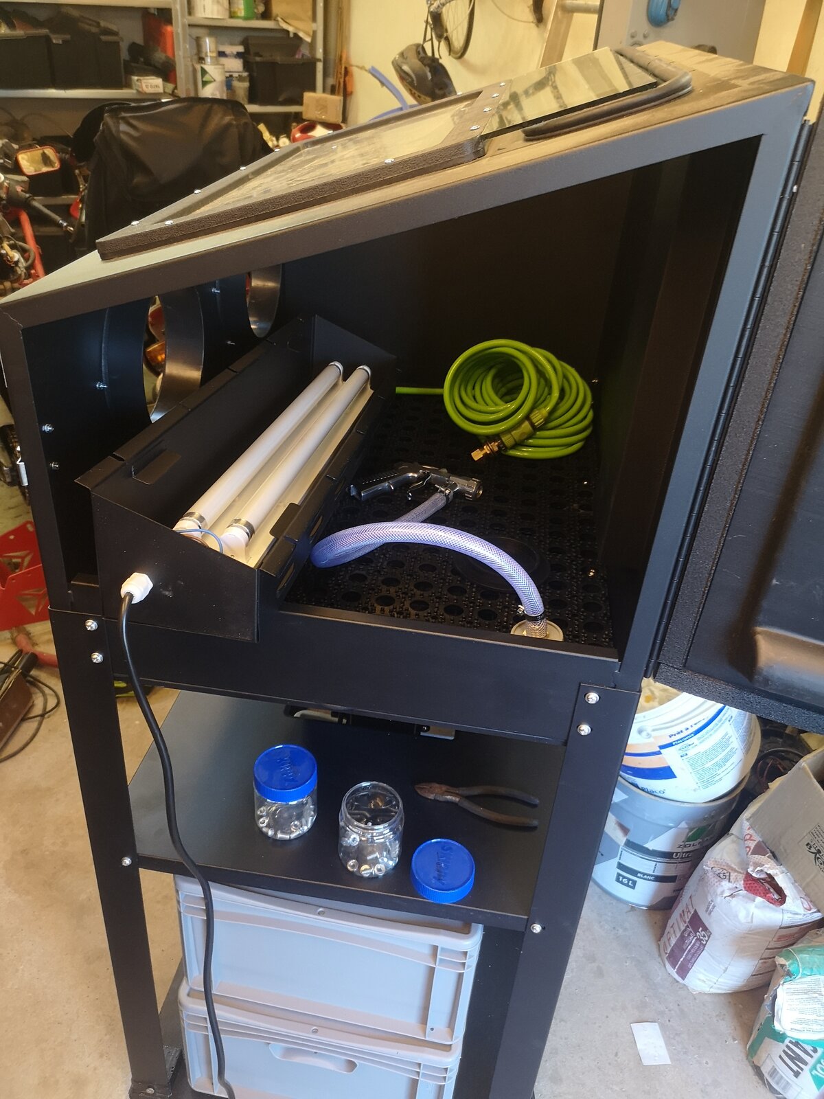

  4. Decided I needed to build up my kit, so in summer of 21 I purchased a sandblaster:

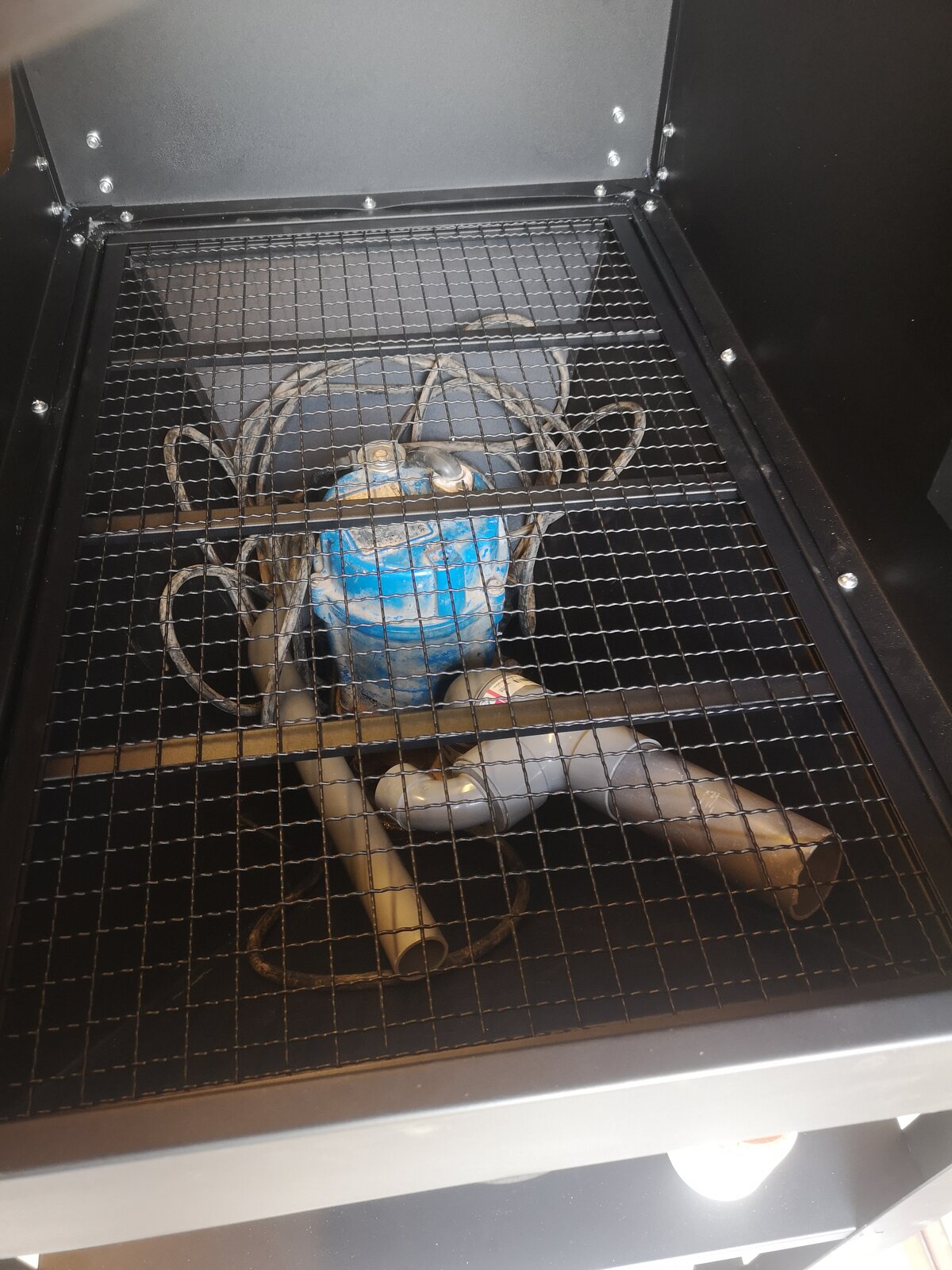

  5. However the sand blaster is just the base cabinet.. The real goal is a DIY Aquablaster..

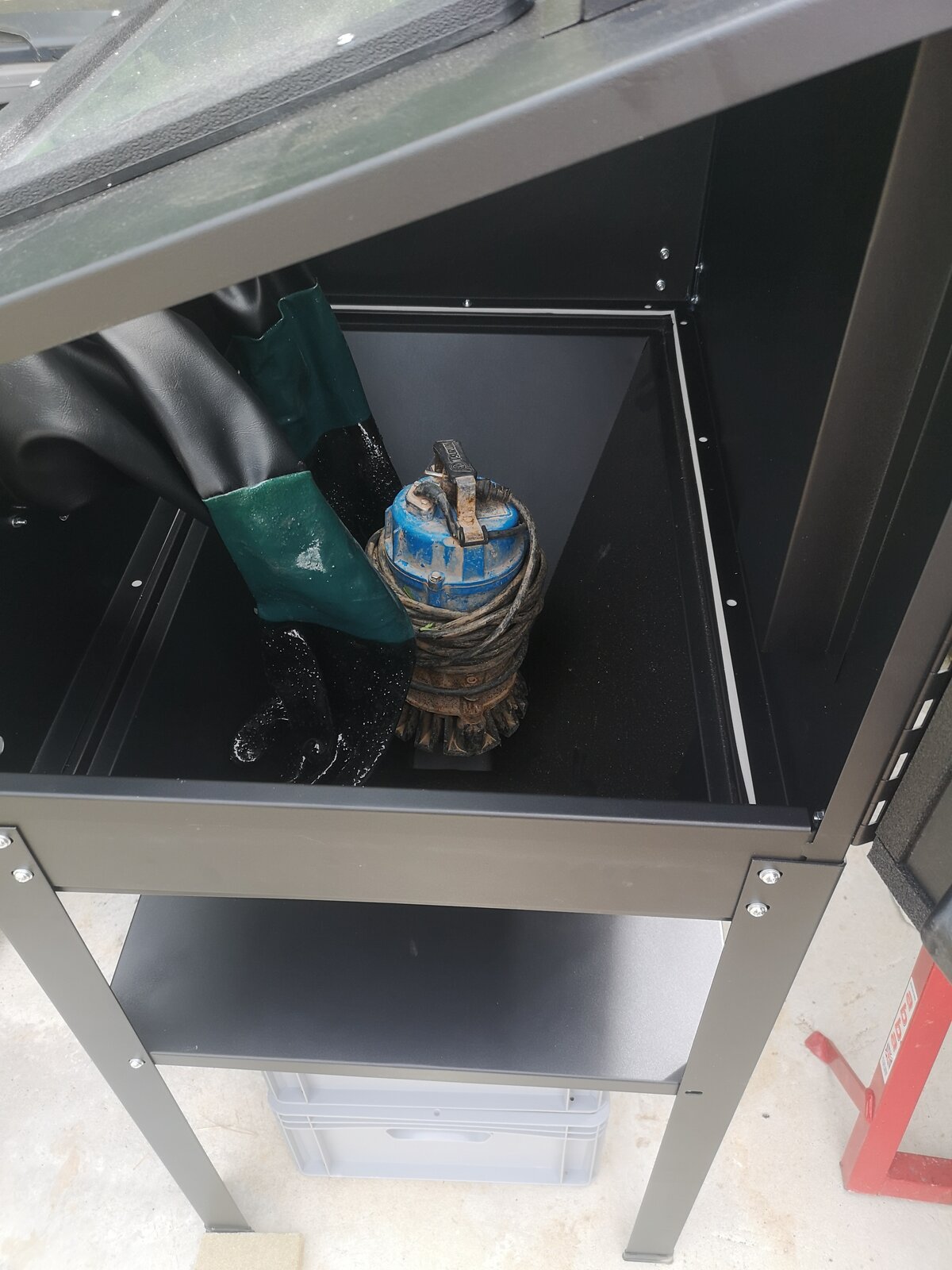

    Test fitting of a high output dirty water pump.

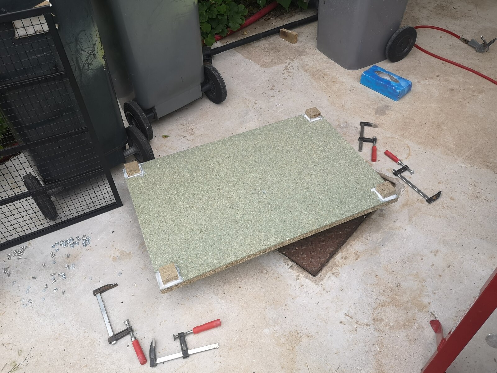

  6. fashioned a rough base (water-repellent chipboard - as used in bathrooms) with casters on the bottom...

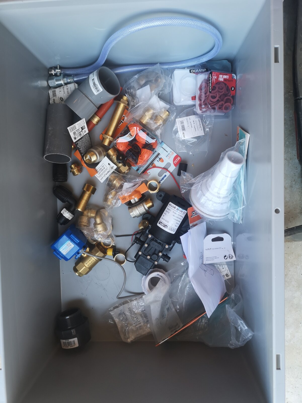

  7. researched and purchased loads of fixtures:
  8. filled the bottom of the funnel section of the blaster with epoxy...no going back!

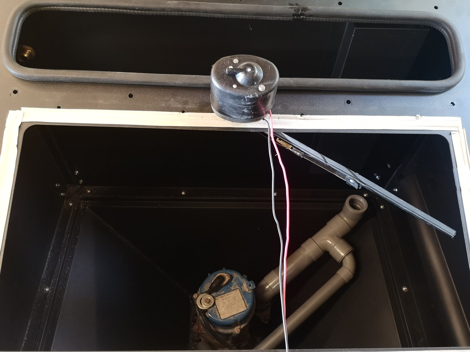

    The pump was a super tight fit, had to trim the base support to fit in the funnel and allow for the mesh floor to just clear the top of the pump. You can see the large bore tubing is where the water/glass bead slurry will come up to the sandblaster gun. The 90 degree small bend is a tube that goes back down to the base of the pump. This will fully agitate the water/bead mix so there isn't any piles of beads sitting in the corners.

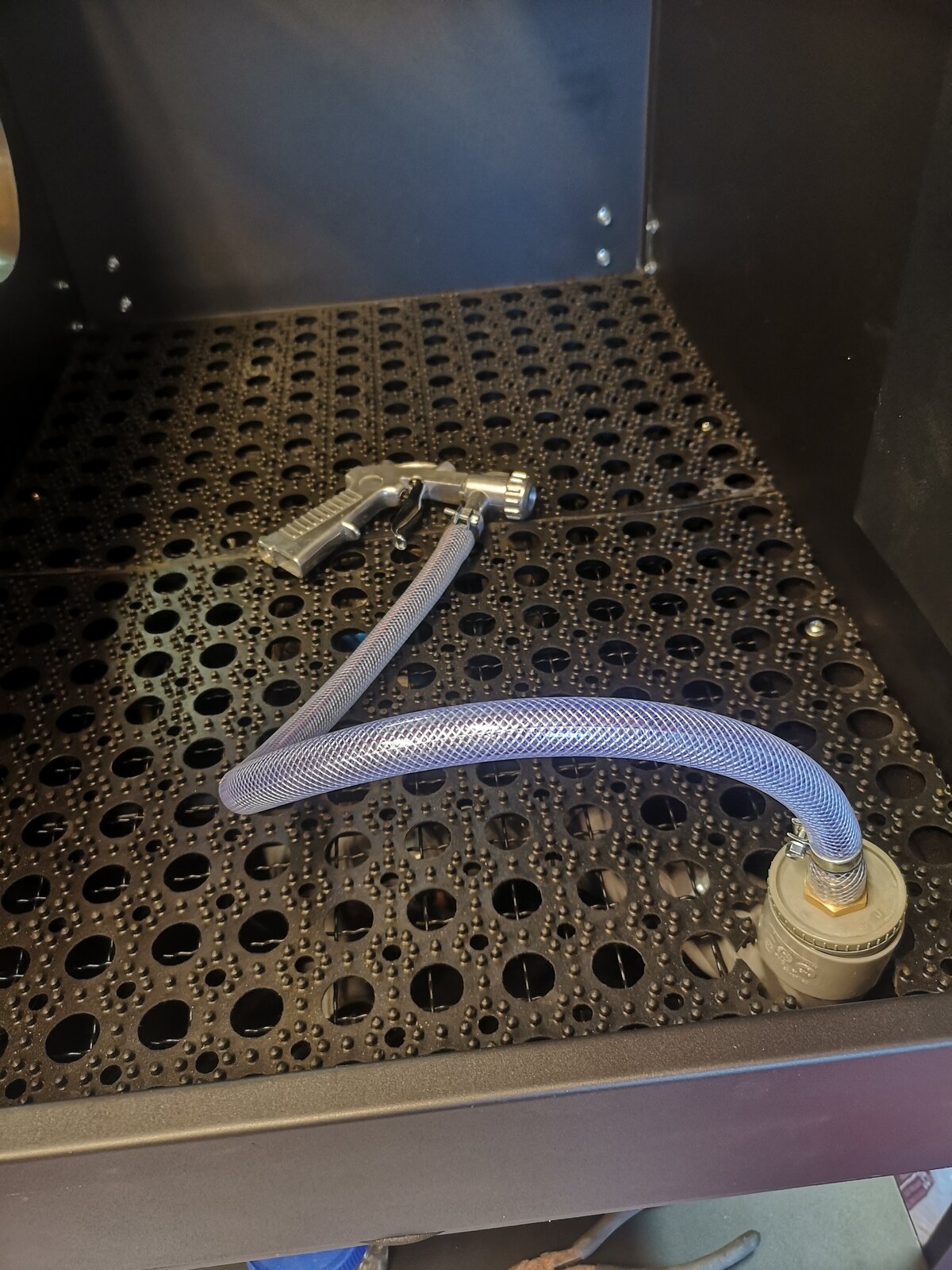

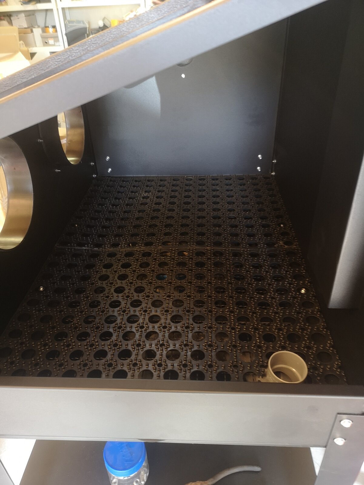

    The large diameter pipe pokes through the floor ready for a removable screw piece to connect the flexible hose to the gun. Nice rubber floormat added too! (Sexy...cough, cough) :astonished:

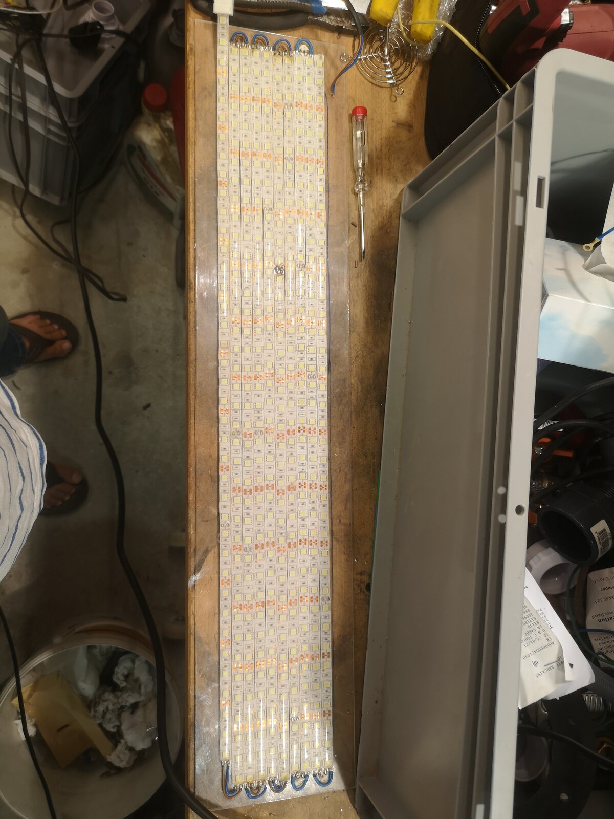

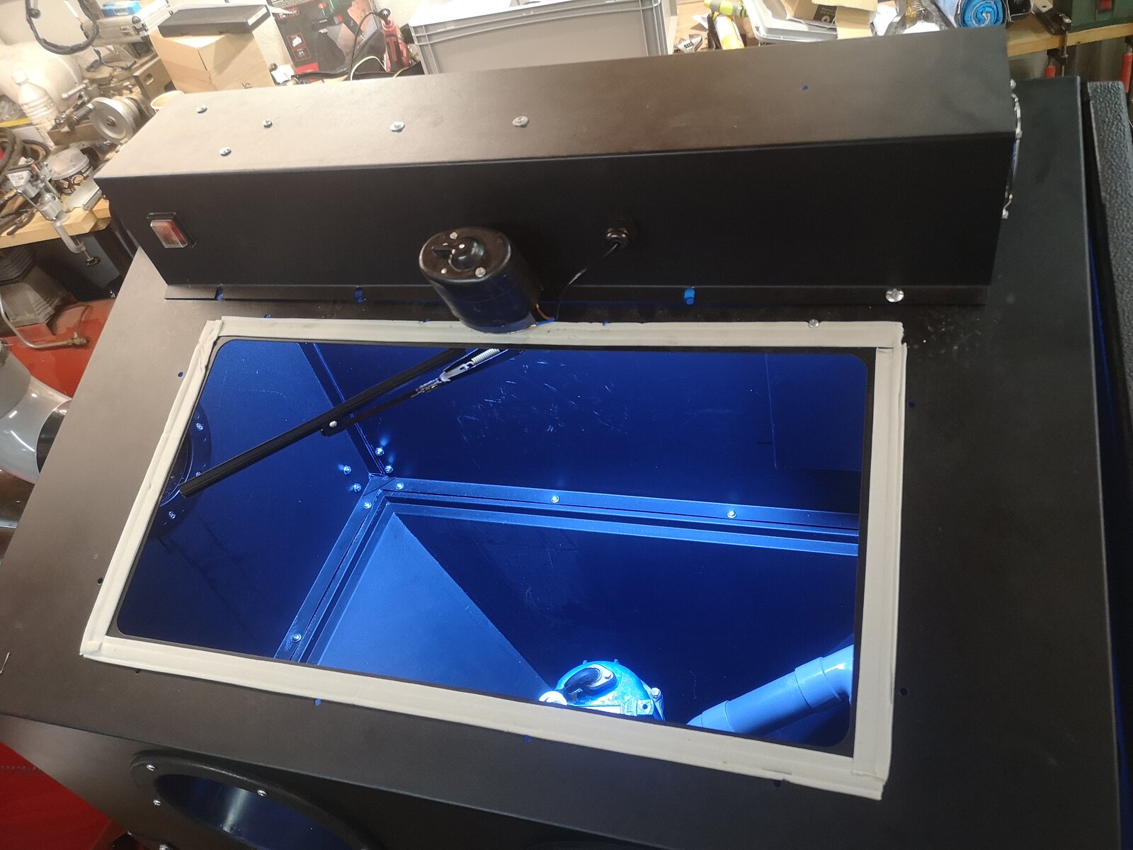

  14. The sandblaster kit comes with a lighting box, with a couple of neon tubes...
    but the lumens output is quite pathetic... so...
  15. made up a LED panel using the LED ribbons you get for decoration around the home...

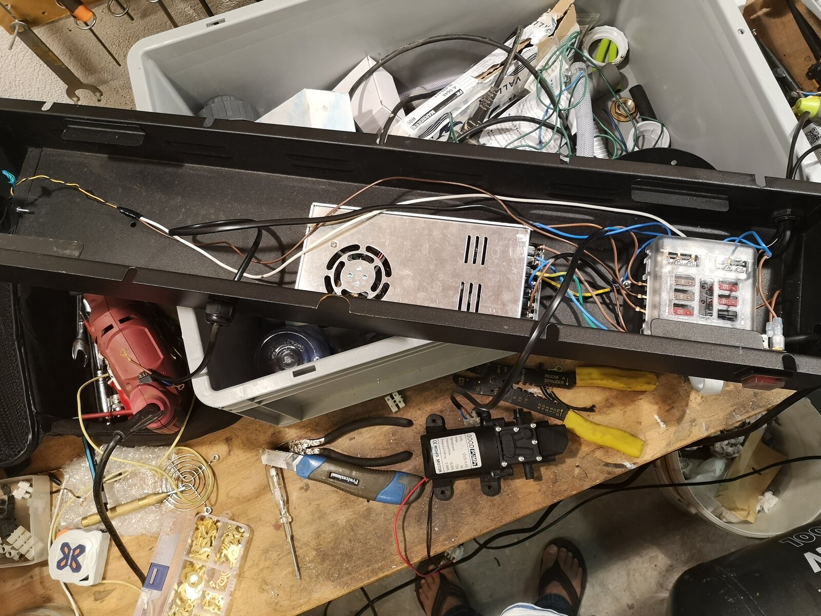

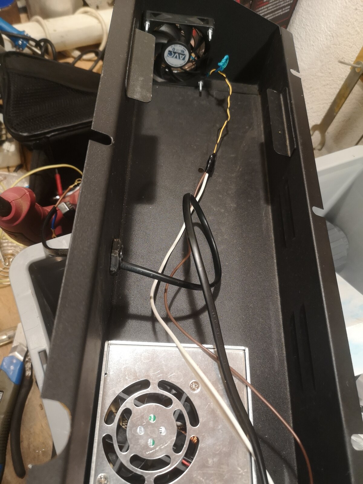

  16. and of course this needs a 12V power supply...
    ...and that power supply will also power other ancillaries connected to the cabinet.
  17. such as the cooling (computer) fan.. as the lighting box is fully enclosed.
  18. and the necessary "windscreen wiper".. as water/beads splash everywhere in use. I don't seem to have a pic, but I also rigged up three jets of water coming through an automatic plant watering hose and plastic nozzles.
  19. Lighting up and running!

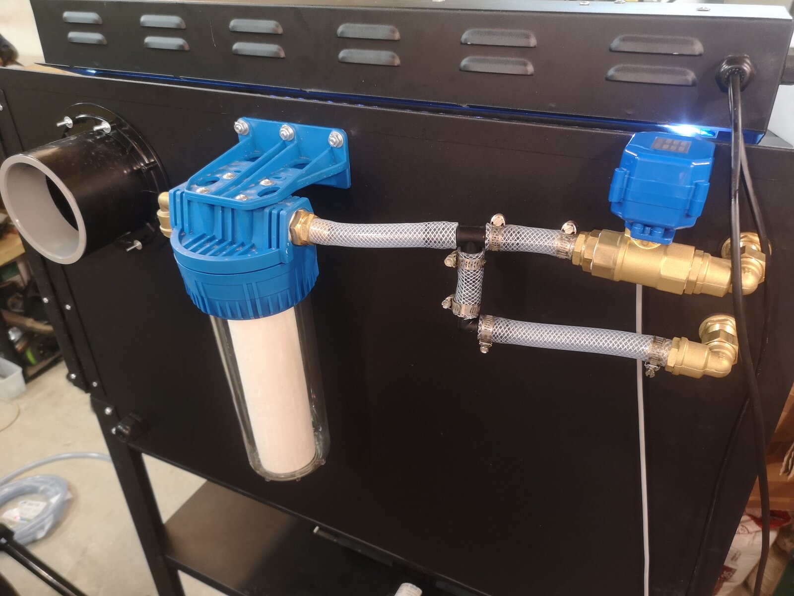

    this is the backside.. waterfilter that will draw from the bottom water reservoir (spray pump to be installed)..then top right is the glass spray with a 12V ball valve operated via a foot switch (as your hands are inside the rubber gloves!). Bottom right leads to a garden hose spray pistol for cleaning the beads off the blasted pieces.
