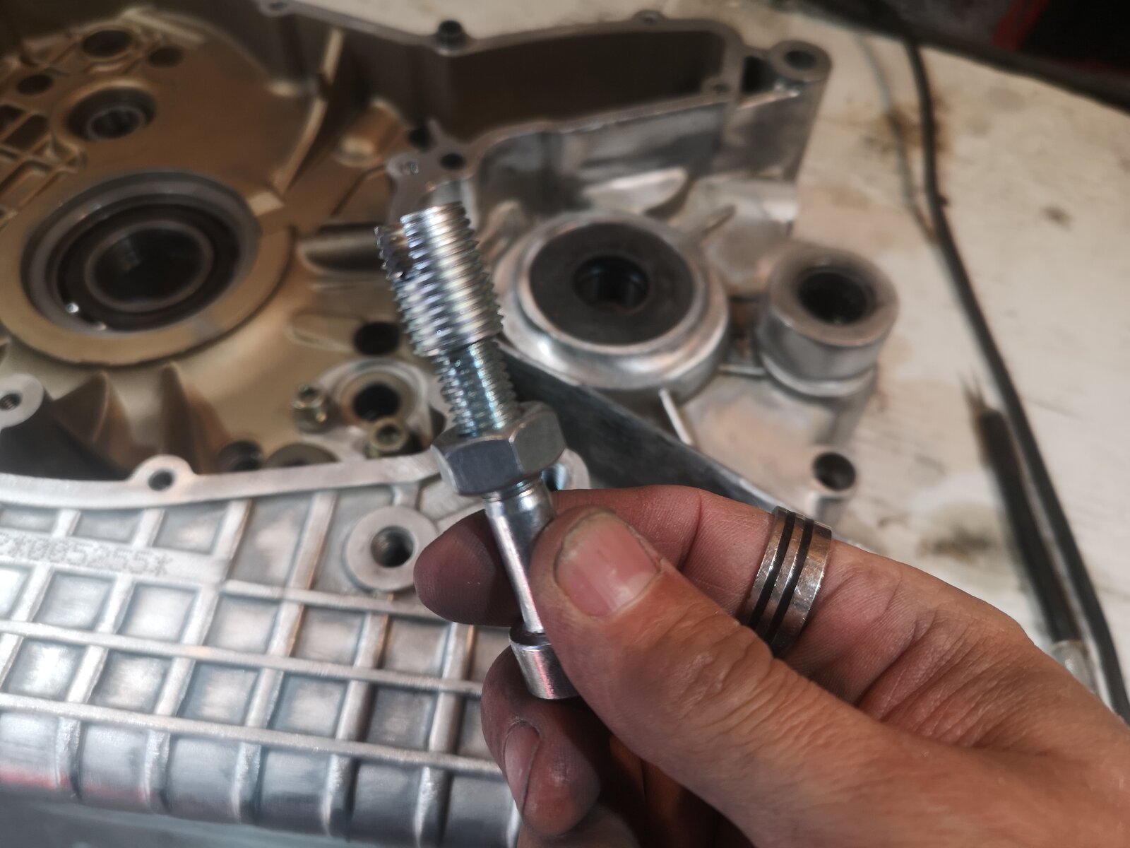

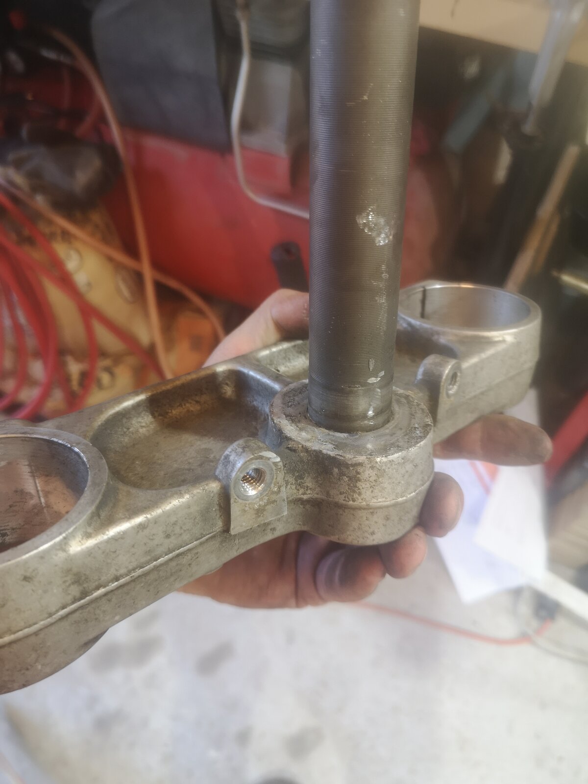

    The friendly TIG man welded up the case, and rather than re-tap I felt that inserts were the way to go...definitely the right choice, first time I've used these things and they are simple and fool proof. @Pict for your swing arm question about drilling for paddock stand bobbins...I would do it this way. :upyeah:

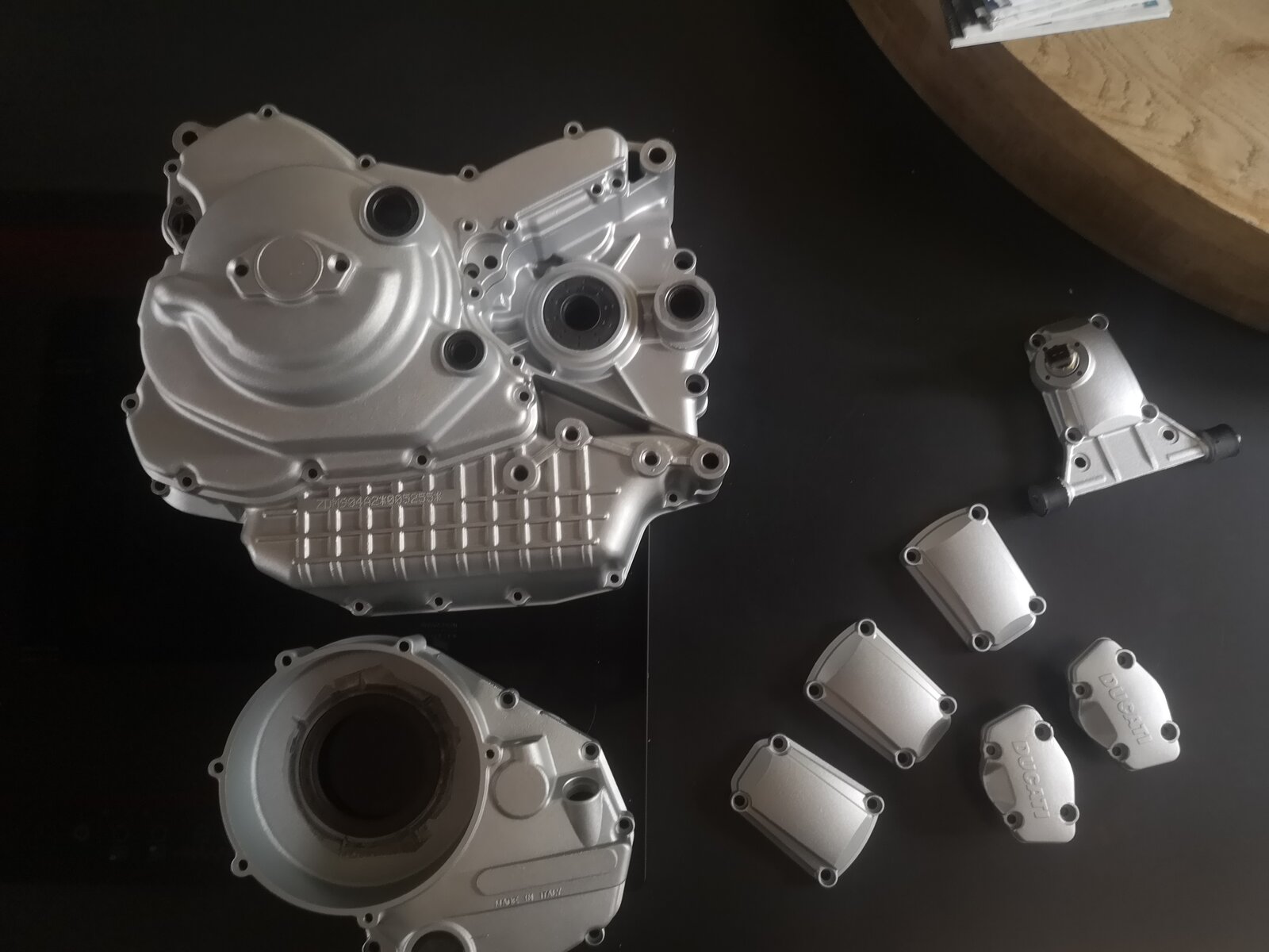

  2. Aqua blasted and painted the engine covers and the other half of the case, again all cured in the oven.
    Looking good, seeing the transformation of pieces is a real energy generator. So I started to push a bit harder (I want to say faster, but we are already 3 years in! haha)

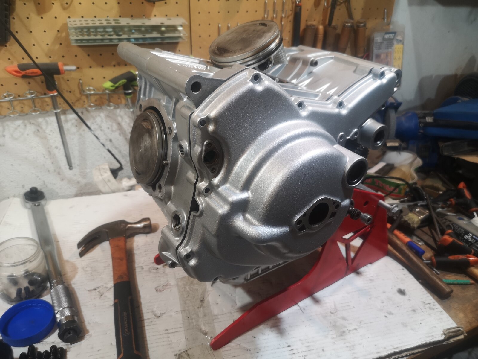

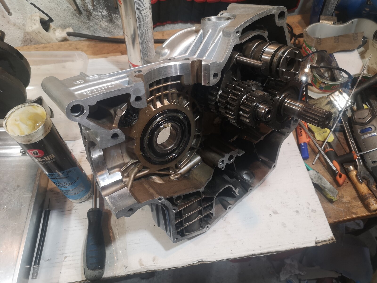

  3. and then moving into assembly!
    Tech is really something, the ability to take photos and video on the phone and then refer to it later is definitely the way to undertake a motorbike build, then when you get stuck there are all the Youtube videos and blogs where people are sharing knowledge...super cool. I built my first VW beetle at the age of 16... and now I just don't know how I did it..no workshop manual, no references, no internet, just take it apart and then rebuild from memory! Nuts! :)

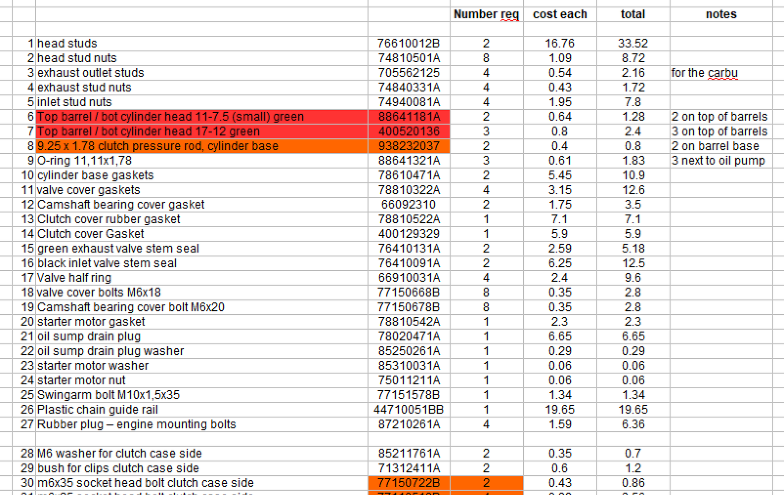

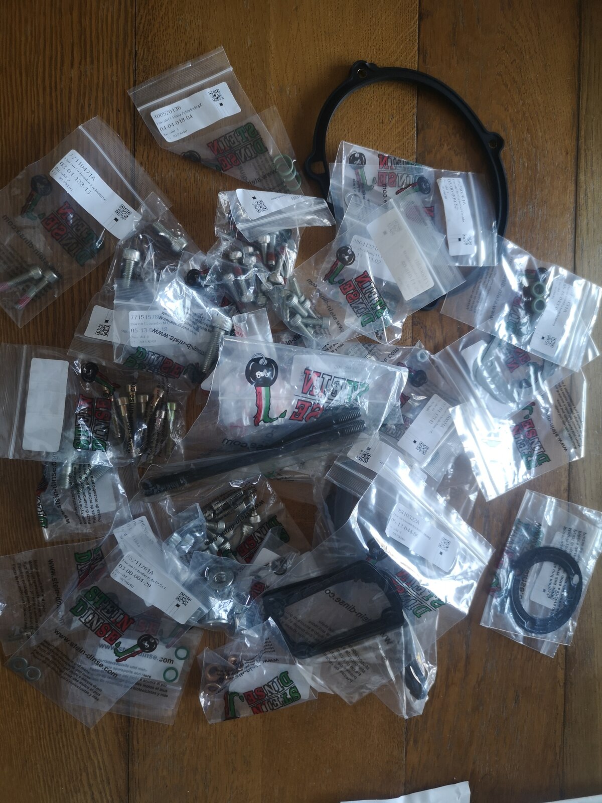

    So it was about now I placed an order with Stein Dinse ...loads of gaskets, seals, bolts...while I always intended to re-galvanise the old bolts, I thought seeing a complete engine in all it's glory would inspire the rest of the bike...kind of leave it like a totem in the corner of the garage!
    Excel spreadsheets with parts lists..very handy!

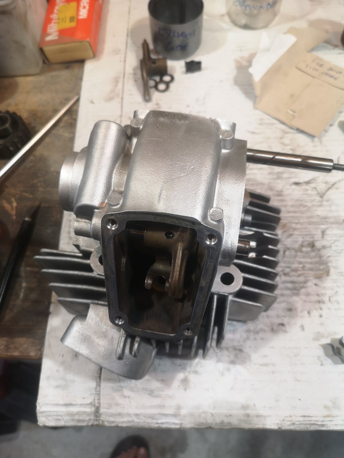

    I managed to order the wrong valve shims from Lacey Ducati, arghhhh 8mm not 7mm!!! So had to return and re-order... (not their fault at all, the Lacey team is lovely...an old fashioned family run business!)... but it meant that I seemed to spend weeks waiting for parts.

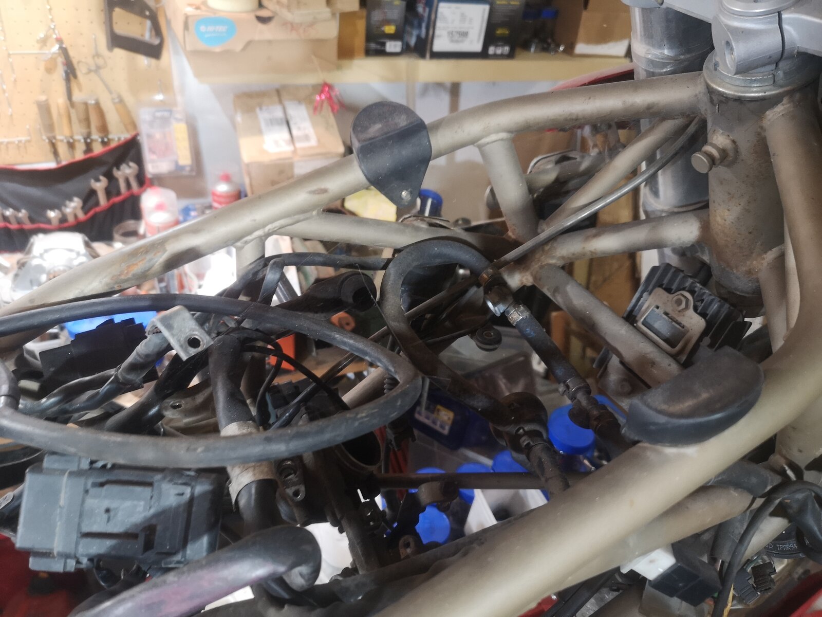

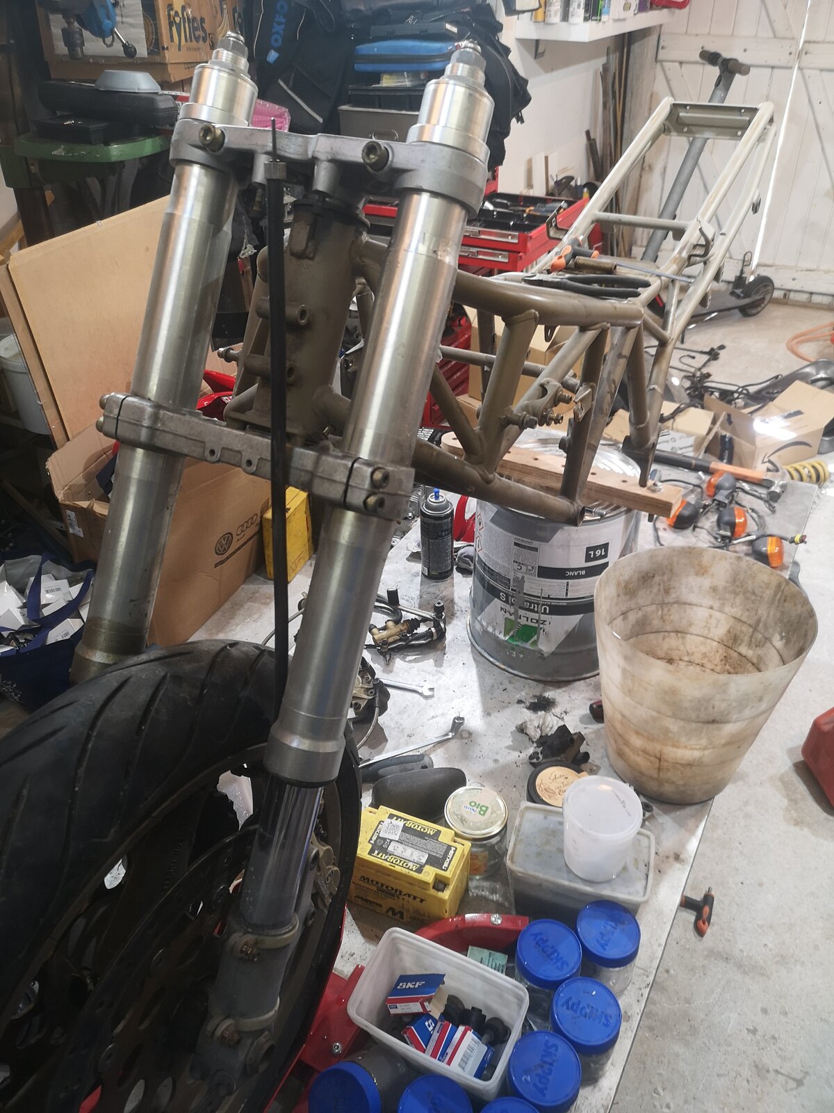

  6. So... I decided to attack the rest of the (utterly knackered) bike...even though the engine wasn't completed. I could also see some parts on the engine would need zinc galvanising, and I just didn't have the gumption to break out the Gateros plating kit I had bought some years back.

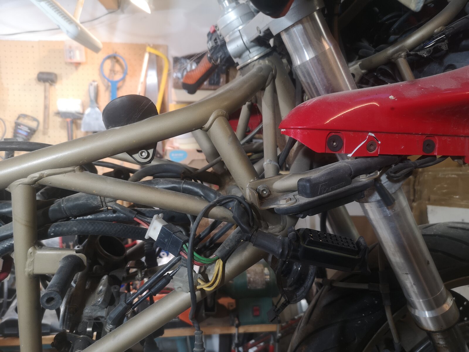

    I photographed every inch of the frame, following cable routing for reference later on...!

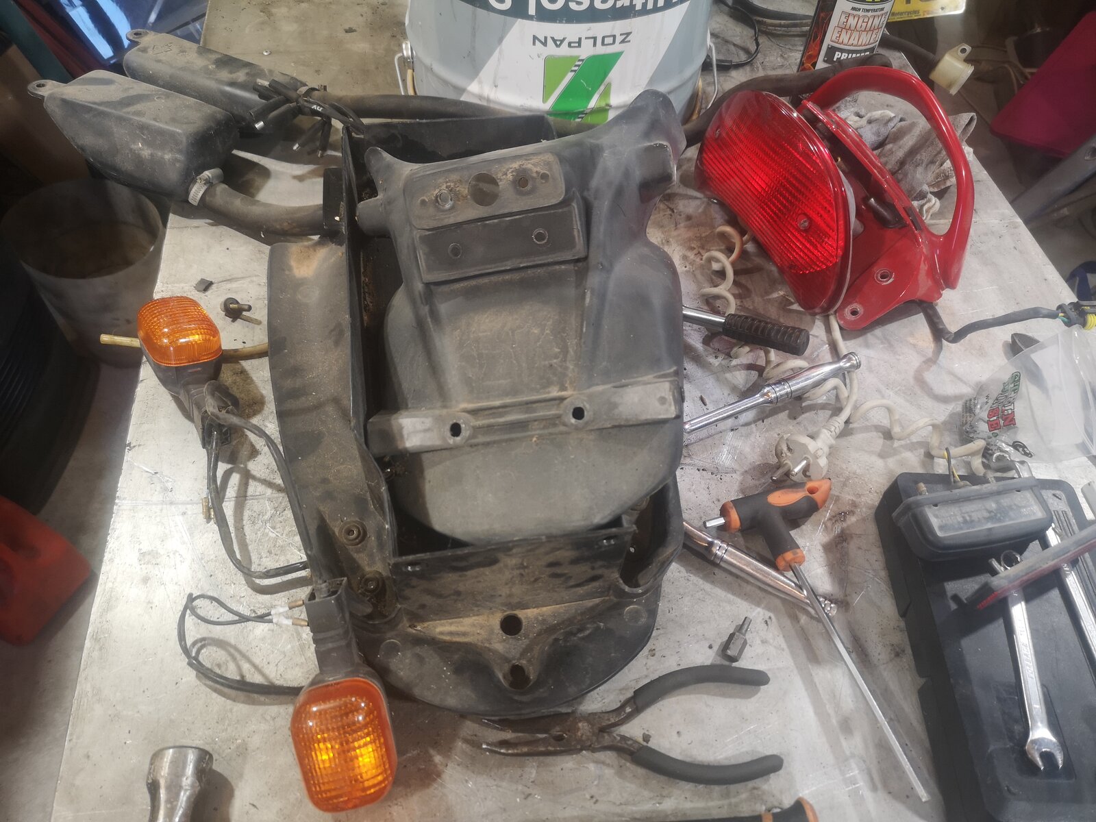

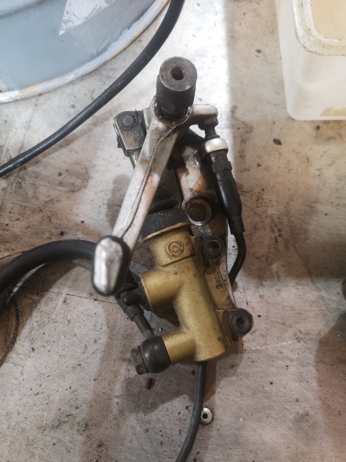

  9. ...removed every piece...what a state. :rolleyes:
  10. This photo best represents the care and maintenance performed on this bike over the years:
    I would love to laugh, but jeez, come on : unamused:

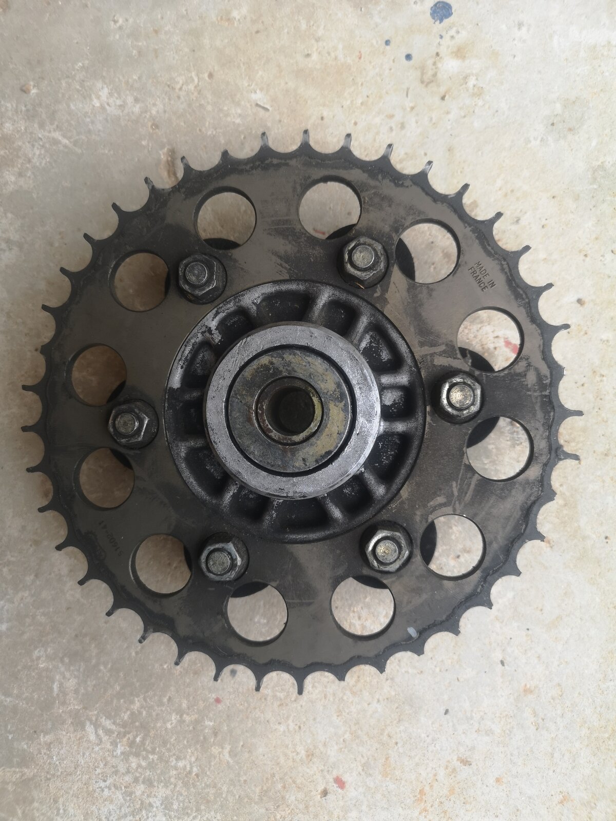

  13. That sprocket is probably the most worn I’ve ever seen.
  14. The steering head bearings were obviously shot...and required (carefully!) cutting off.

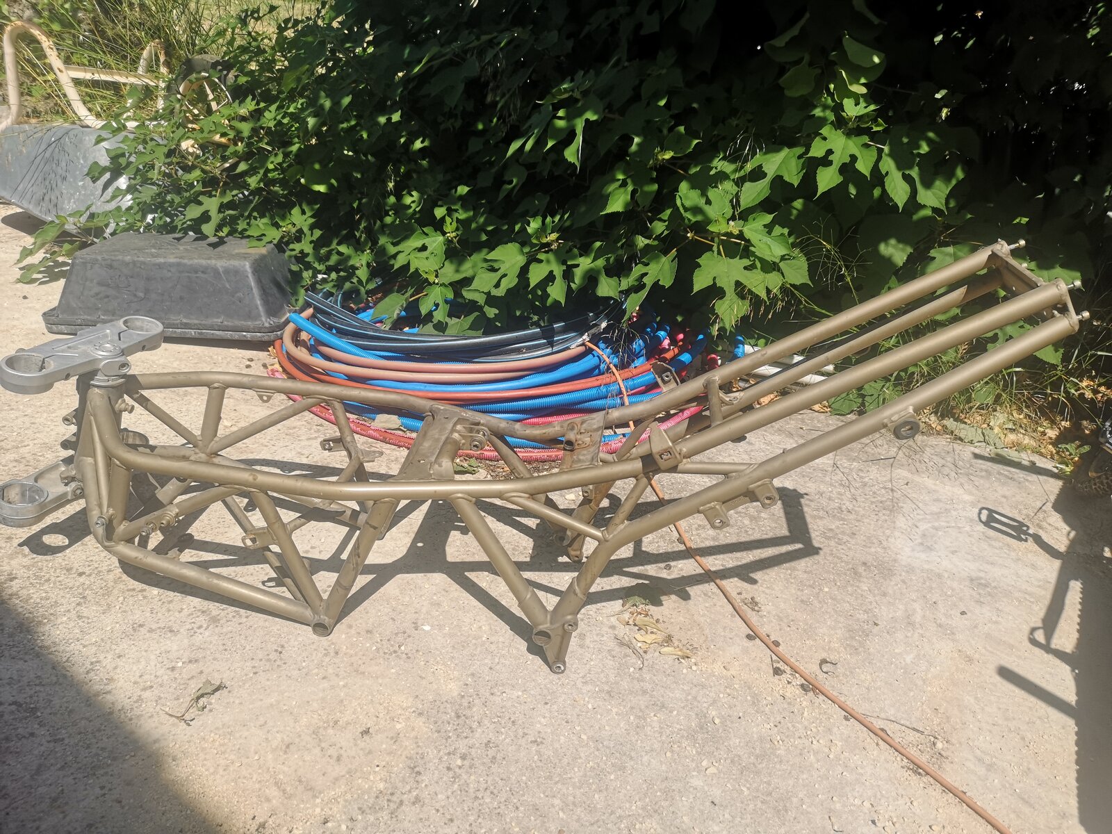

  15. As a teaser... Can I just share the word: Chrysalis
    And share a paint chart so you don't lose interest...;)

    One question, did you have to shim up all the gearbox & crank shafts for end float when assembling the crankcase halves? I've heard this can er... try ones patience.

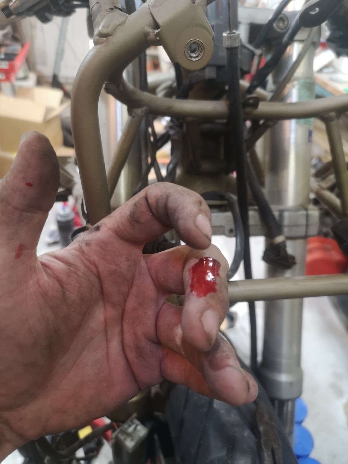

    PS - If I don't have some "claret" leaking out of my hands somewhere , I never feel that I've done a proper
    spannering session ..... :D
    PPS - that rear sprocket is just unbelievable !
    It's mind-boggling how it was even possible to drive it ..... long before it got to that state !

    Regarding the shimming, thankfully the gearbox and crank was in spec, so no stress.

  20. Yeah, when I did the Darmah I was pretty confident the crank/big ends where in good shape from the professional rebuild it had a couple of years before being laid up. Which was reason enough for me to not split the cases.
    I hear the crank can be particularly tricky requiring both preload & zero end float or summat horrid like that.
