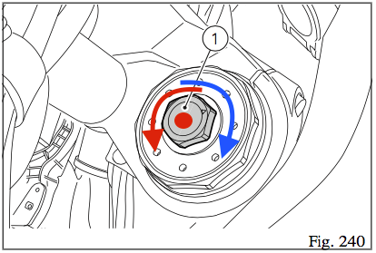

  2. Jeez mate, I didn't imagine that a simple instruction would appear so confusing, obviously 'turn left' means counter-clockwise -in my books there's only one way to do that, unless you'd be performing the task Friday night after the pub's closed :Hungover:
    Indeed check out Figure 240 from page 331 attached, the bold is marked with 1 -and red dot, and turn left -red- until the end and the turn right -blue- each half turn for 15kg (33lbs) until you've reached your weight e.g. if you're 85kg/190lb turn three full turns 6 x 0,5 turns :)Nailbiting: ... sorry I am dying for a beer now :Inpain:)

  3. Perfect response and with pictures.
    The left and right turn isn't universally understood.

  12. Thank goodness you brought this thread back to the DVT model there Bradders! Is your DVT an S or base model? Mines a base model and few 8th turns can change the handling for the better.Just keep a record of the setting where any adjustment started from. I've dialled back in a bit more dive to keep front end 'feel' -but the Non-S Sachs kit is very adjustable.
  13. Tbh I had no idea what is was, just skyhook! Like the note above about each turn equals 15kg (think thats what it said) so may well be going to Benson with spanner in hand Sat and giving it a go
