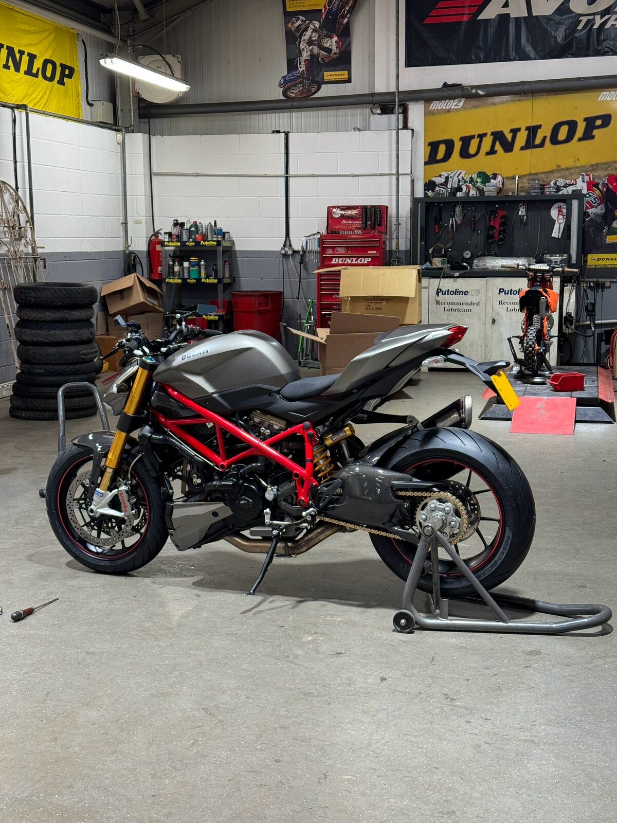

  3. Ignition lock isn't an MoT tested item but yoke/bar impact onto tank is. To get an MoT, why not simply adjust the left and right adjustable lock stops to a position that gives a gnats cock of clearance with no clash, get an MoT pass, then adjust them back ?
  4. Great idea. See post #12...
  5. Yes mate, I saw that but was rather just advising to adjust the already fitted lock stops that are already there rather than fit longer bolts. I guess it all adds up to the same result so either way would achieve the goal .
  6. If the bars or something are currently being stopped from moving any further by the tank, adjusting the lockstops to give a hairs width of a gap will give you more confidence in getting an MOT, and of course stop your tank getting damaged, but then backing the adjusters back off afterwards is going to gain you what? a hairs width more movement because the tank is still stopping the movement.

  8. There’s a few ways to get round this but my concern was the steering lock not working and an MOT failure. I put a rubber rivnut over the thread and this worked well although the Titanic probably had a better turning circle !

  16. I have larger carbon intake tubes on my 916 and, initially it would trap your thumbs on full lock, never had an issue either with MOT (don't think I've ever seen an MOT tester test full lock?) or riding.
    I fitted adjustable bar risers with longer bars that solve the problem anyway and the longer bars are a revelation.
