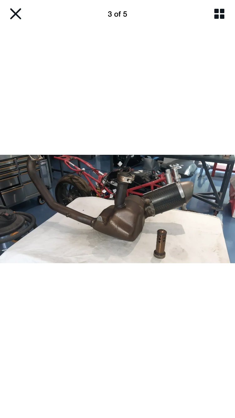

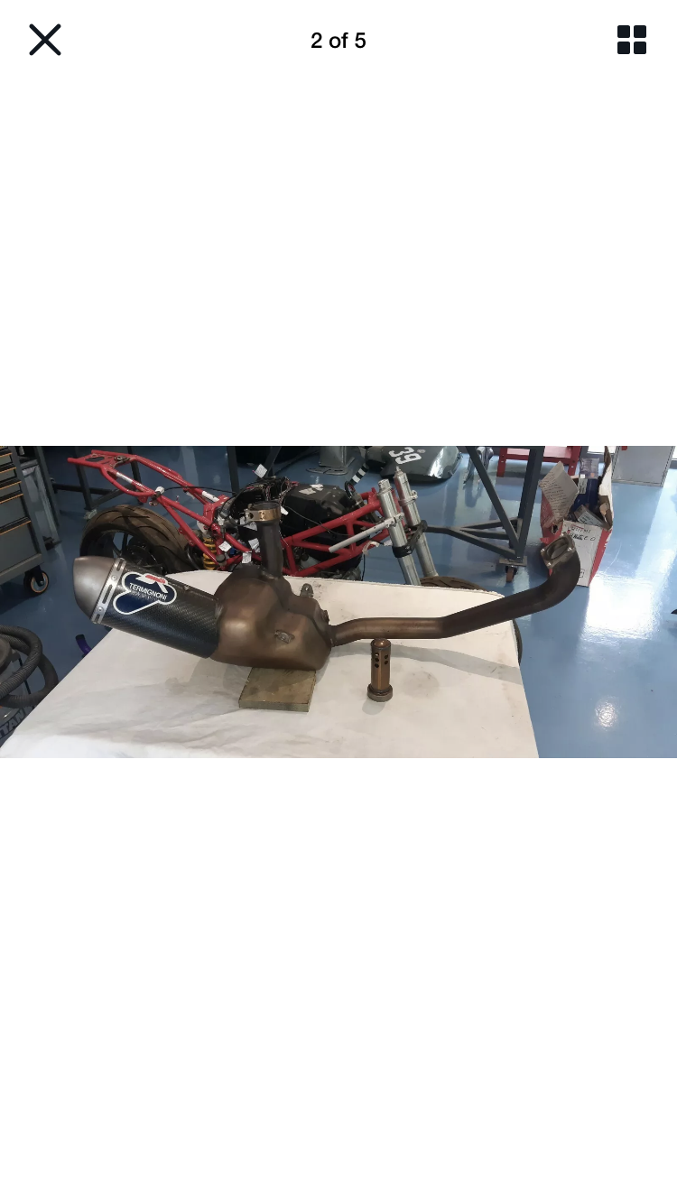

    Just out of interest I googled "titanium exhaust for S4 monster" and it only came up with aftermarket brands like Zard, Akropovic, Arrow etc. Pretty sure that Ducati never offered titanium option.
  5. That’s a big stock header and cat with the aftermarket stubby Termi. They will be stainless steel, all be it a lowish grade hence the sh*tty brown colour

  8. All my own handiwork I’m afraid. I had the carbs off my Bandit for some reason and when I came to put everything back together a bolt was missing. I searched for it obsessively for hours before realising it must have fallen into the engine. And it had. :astonished:

    The guy was clearly not the full ticket, was a habitual liar and I strongly suspect he had some sort of personality disorder. It got to the stage where he was saying "This is my LAST message to you..." only then to follow it up with 5 more on the same day. He also claimed he had a letter from Ducati confirming the (obviously SS) OE pipes were Ti and when I asked him to send me a copy he became aggressive and refused. I obtained a letter from Snells (big thanks to Dave) stating that the pipes were definitely OE SS items and not Titanium but when I sent it to the seller, he claimed I had either forged it or bribed them!
    I started an eBay/Paypal claim but in the end I withdrew it because by this time I was sick of dealing with such a dishonest, nasty piece of work and fighting with him over what was only a couple of hundred quid (which was clearly the price of this cheap bastard's honour). Given that he had already intimated that he would tell eBay he received the goods back in a damaged state, I could see this dispute going on for weeks. So, in the end, I basically bought a second hand end can (which I like and is in v good nick) for the price of a new one and also ended up with a spare set of OE SS downpipes, which I am rehoming with @bradders in the near future. Naturally I left extremely negative feedback for the guy.
