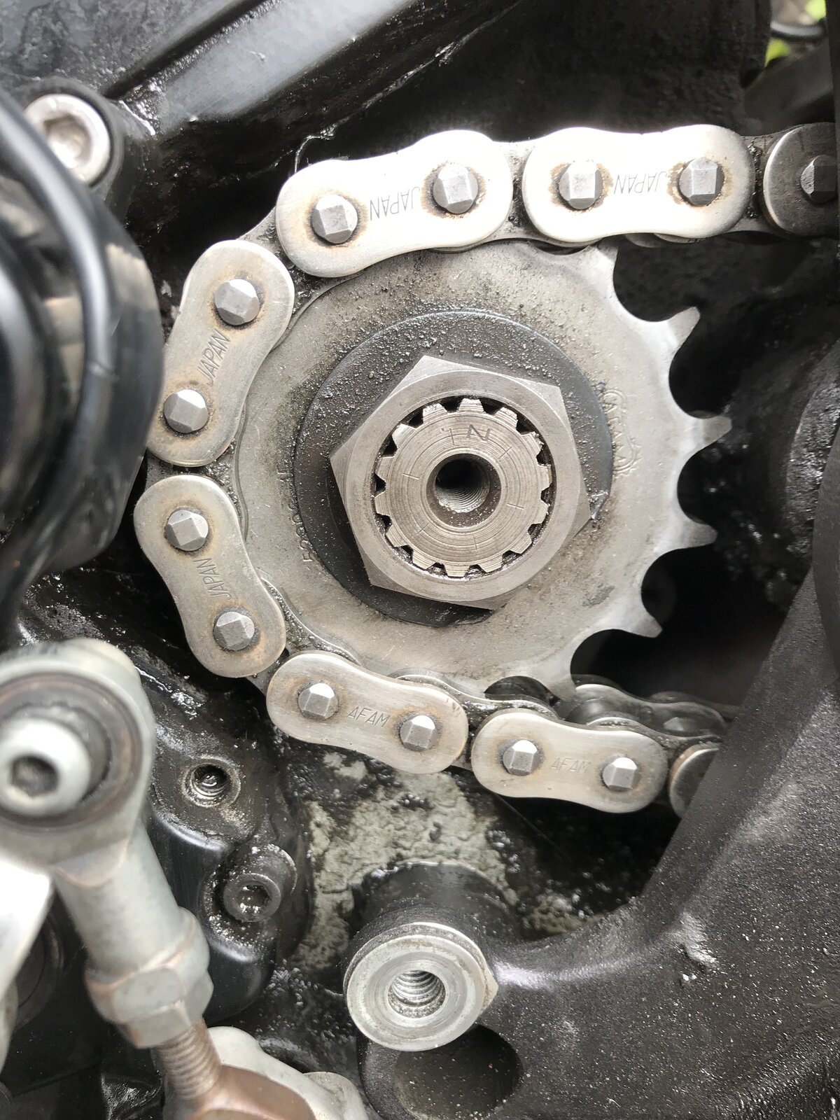

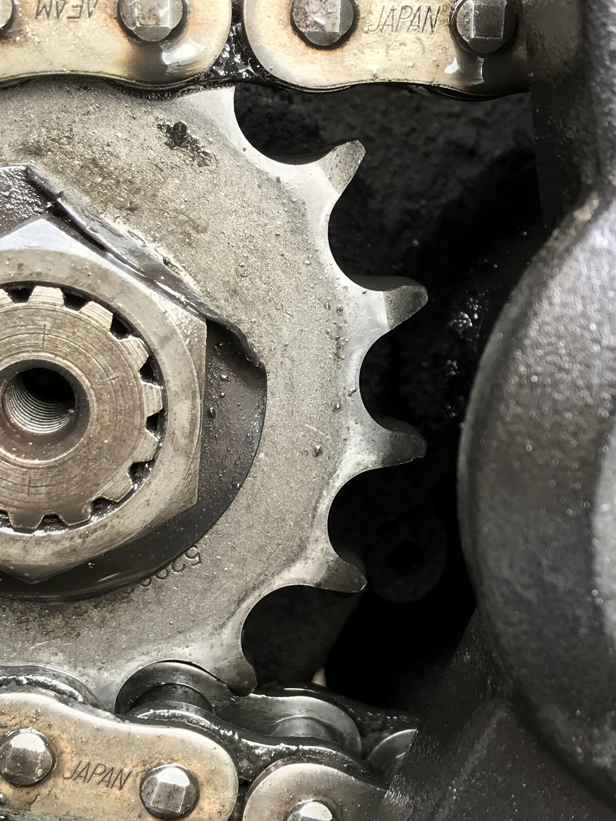

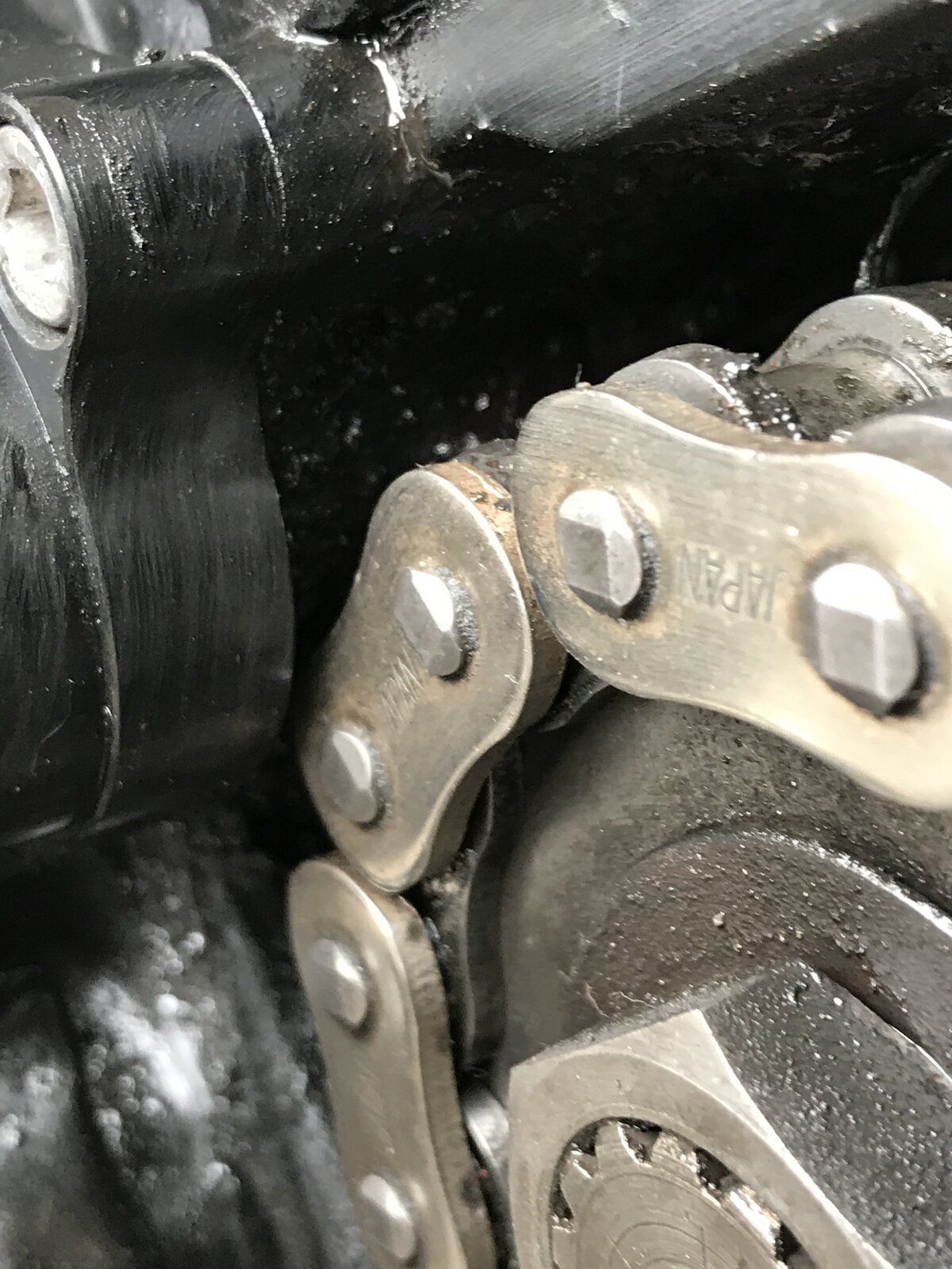

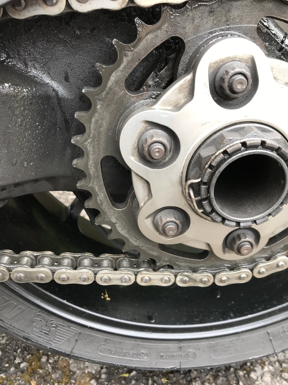

  1. So had a clean, rear sprocket looks ok, chain in fair condition and only comes back about 3mm when pulled . Had a look at front sprocket which looks pretty worn to me but I will be guided by you who know better. Cleared out loads of accumulated shit there. One thing I noted, very little clearance between the clutch slave cylinder and the chain??
  2. Sorry to have to be the bearer of bad news, your rear sprocket is rogered. As has been previously stated, at this stage, it’s time to dig deep and replace all three. Andy
  3. Thanks Andy.
    kinda knew in my head it’s time to renew, feels lumpy to ride too.
    I’m digging deep, turns out Halfords online sell Afam kits at remarkably low prices. BUT there is absolutely no info available from them as th chain pitch, sprocket teeth, amount of chain links. I have phoned them and they have none of that info, shame .
  4. It’s in your owners handbook. If it’s the same as mine, 530 x 108 links, 15/40 teeth sprockets is stock. I dropped to 14 on the front which uses the same number of links. Andy
