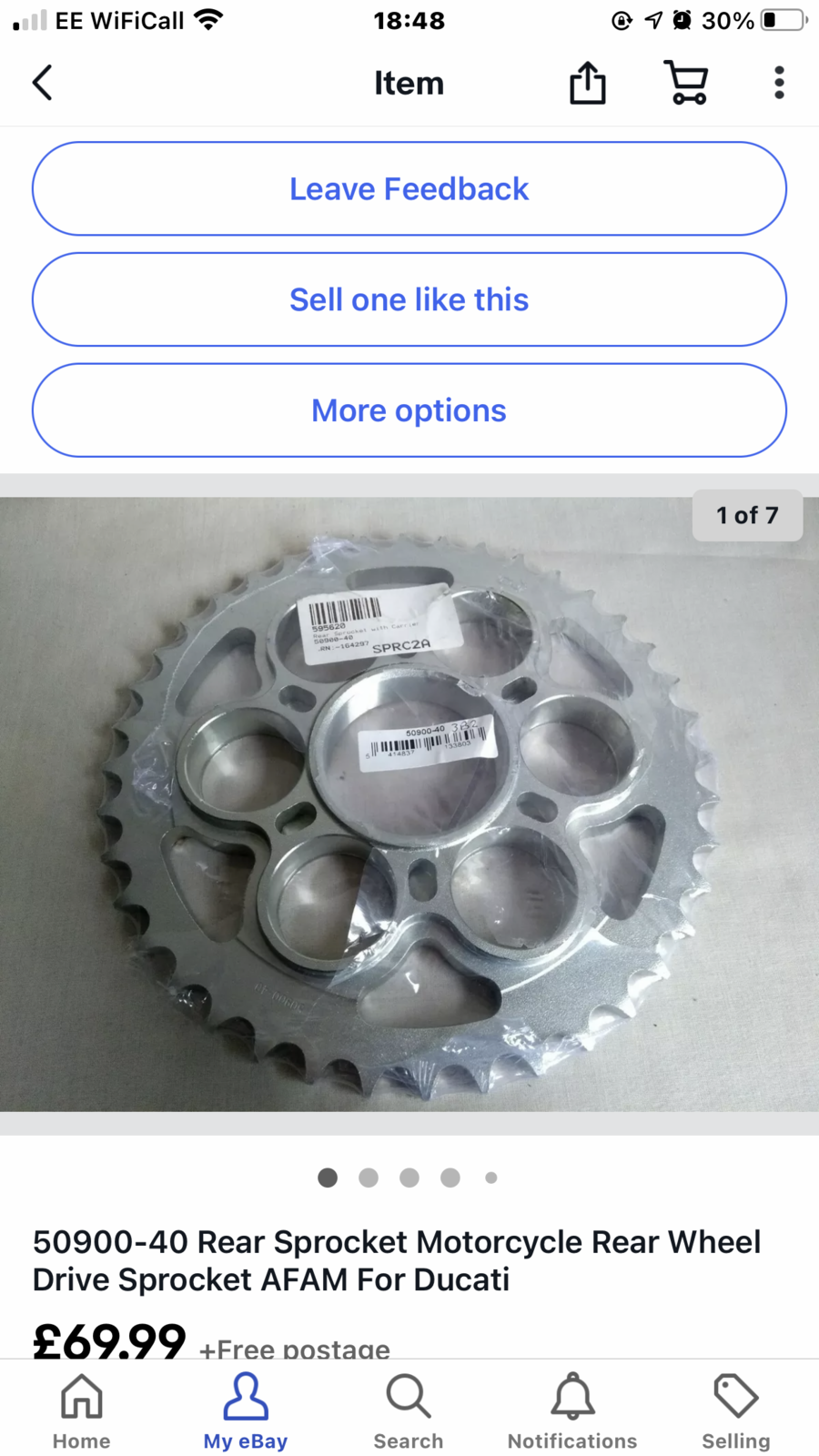

  14. So update.
    I called Biketorque yesterday and had a good chat with a nice young chap called Darren who just started there a week ago. Very helpful and we come up with best Afam chain for £114 against DID at £140, so a no brainer, Afam it is as it lasts twice as long as DID. And also on Fleabay came across a rear Afam sprocket unused but wrapping torn a bit, same part as I curreuhave in for £69.00 as opposed to £130 normally. So all in all a good day and thanks for the suggestion. I had already looked at their website, but it was not bringing up much bike specific, so the phone call sorted it.
