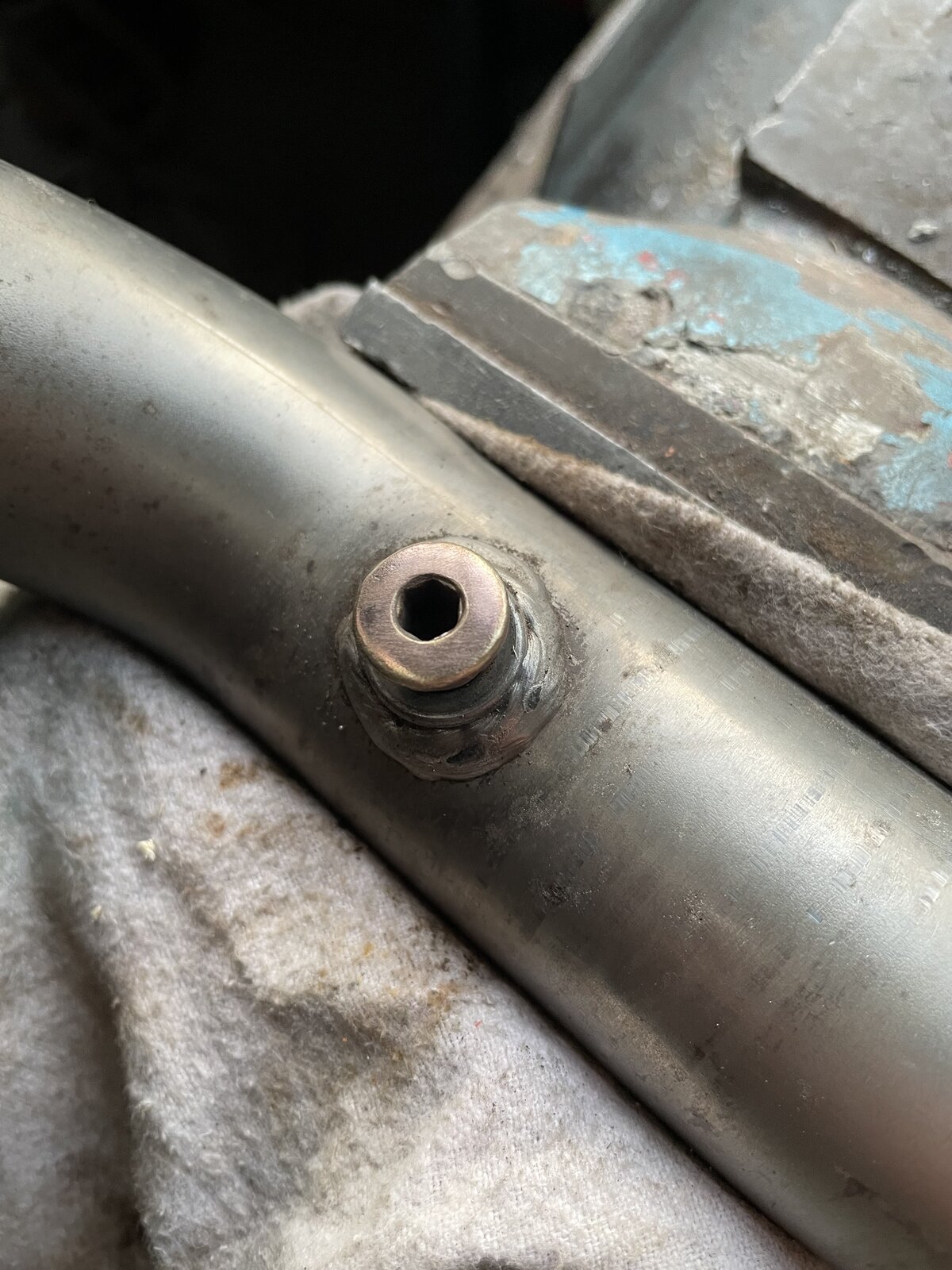

    If you haven’t already, try to unscrew, clean and grease (w/ copper) the 2 headers screw plugs. Beware as sometimes they are rusted and won’t come out easily.
    These are important to set your injection, during the last phase when you set the idle mixture (%CO). That’s where you can plug an O2 sensor and mesure the Air/Fuel ratio (AFR), which is directly linked to the %CO.
  2. Good shout. G I’ll do that.
  3. I had to reread that. I thought you’d used wee as a solvent.
  5. Nothing to declare unfortunately. She’s up and running I’ve given her a good service belts oil brake fluid all filters etc but she hesitant to start unless she gets some throttle, unfortunately I’m 150 miles from any Ducati places to get her set up properly. I’ve put some injector cleaner in the tank so come the better weather I’ll get her mot sorted and get a few miles on her and see if it helps. And then I’ll have to get some one to check the valves and set tps I’m not going to restore her as she’s scruffy but totally original and their only original once.
