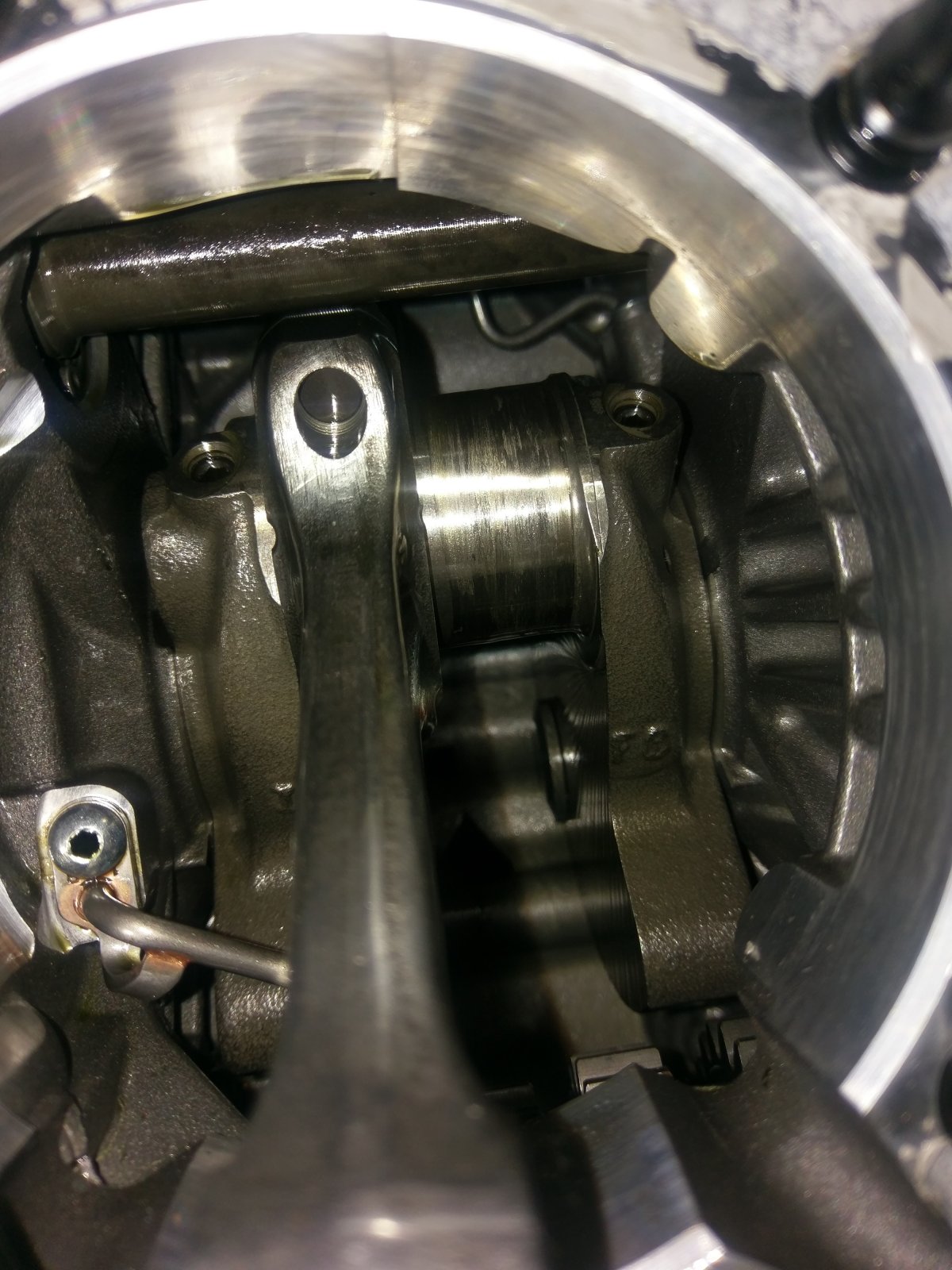

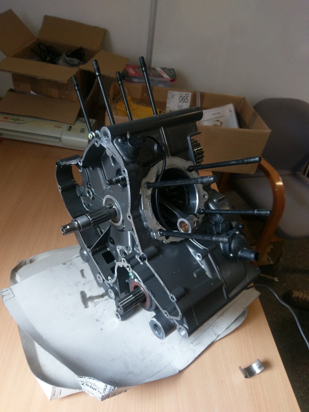

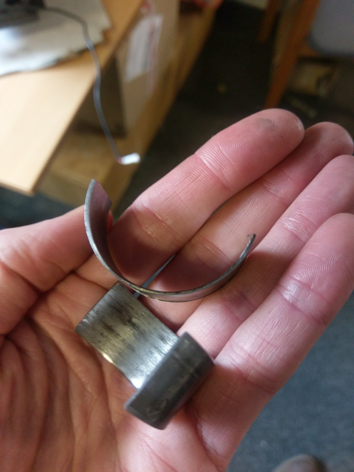

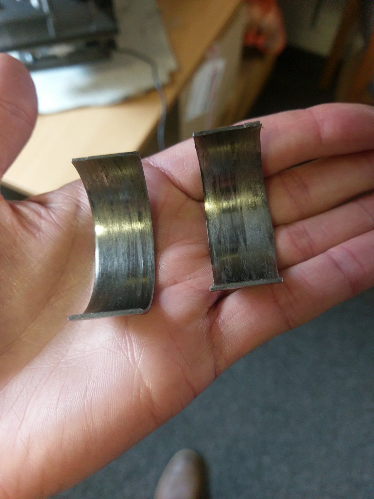

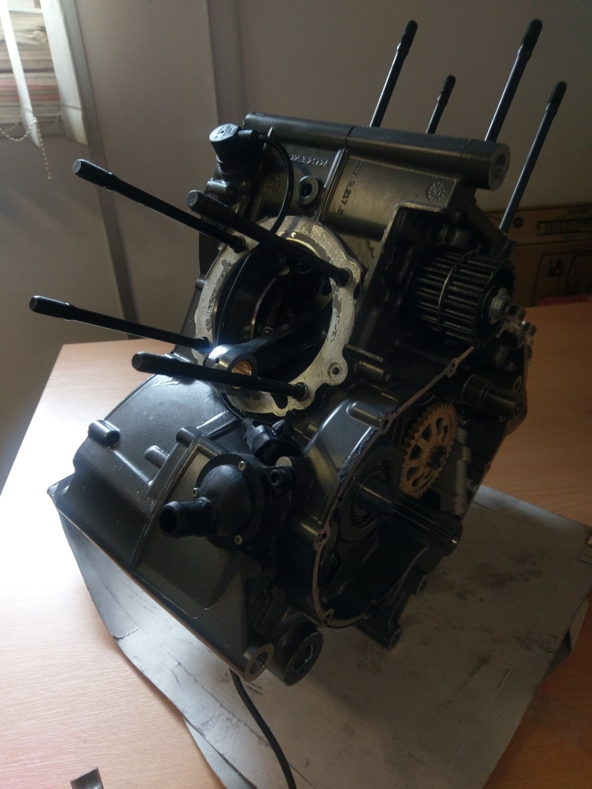

  10. I've now seen my engine so I know how to failed. I just don't know why...
    The big end bearings have spun in their location and then picked up and chewed themselves down to about half their original thickness. The crank is pretty heavily scored at the bearing locations and a small spring came loose from the gear selector assy (presumably when the wheel locked). The bearing failure gave the pistons a load of rotational play which is why the knock sounded so horrific.
    On the plus side, the bike is definitely getting a new engine and apparently they have found one lying about at the factory so it should be over and ready to fit in the next few days (read: weeks). :tearsofjoy:
    Ian at Ian Murray has taken a heap of pics which i'll post up when he sends them through but in the meantime, here's the brunt of the damage.

    The noise is normally the piston top smacking the head..
  12. Yeah, the pistons were definitely topping out which was making the typical knocking noise but the rattle the whole way through their stroke is what was making the bike sound like it was completely destroyed.
  13. Would be interesting to see the pistons and cylinders, sounds like one has possibly partially seized in the bore causing the back wheel to lock up?.
    Normally when main bearings fail you can limp it to the side of the road (as long as the rod hasn't snapped!).
  14. Yet more main bearing failures... go figure ‍♂️
  15. But these were the big end bearings not the main bearings.
    Steve
  16. This model uses shell type main bearings not rollers like MTS, and they appear not to have failed, but the con rod shells have
  17. Here's the rotational play on the first piston. It isn't hard to see why it sounded so horrible.
    The pistons didn't seize so to be honest, I'm not actually sure what locked the back wheel. Possibly the bearing picking up after spinning in location but who knows.
  18. Bearings spun and locked the crank. That's the normal cause if a seized motor.
