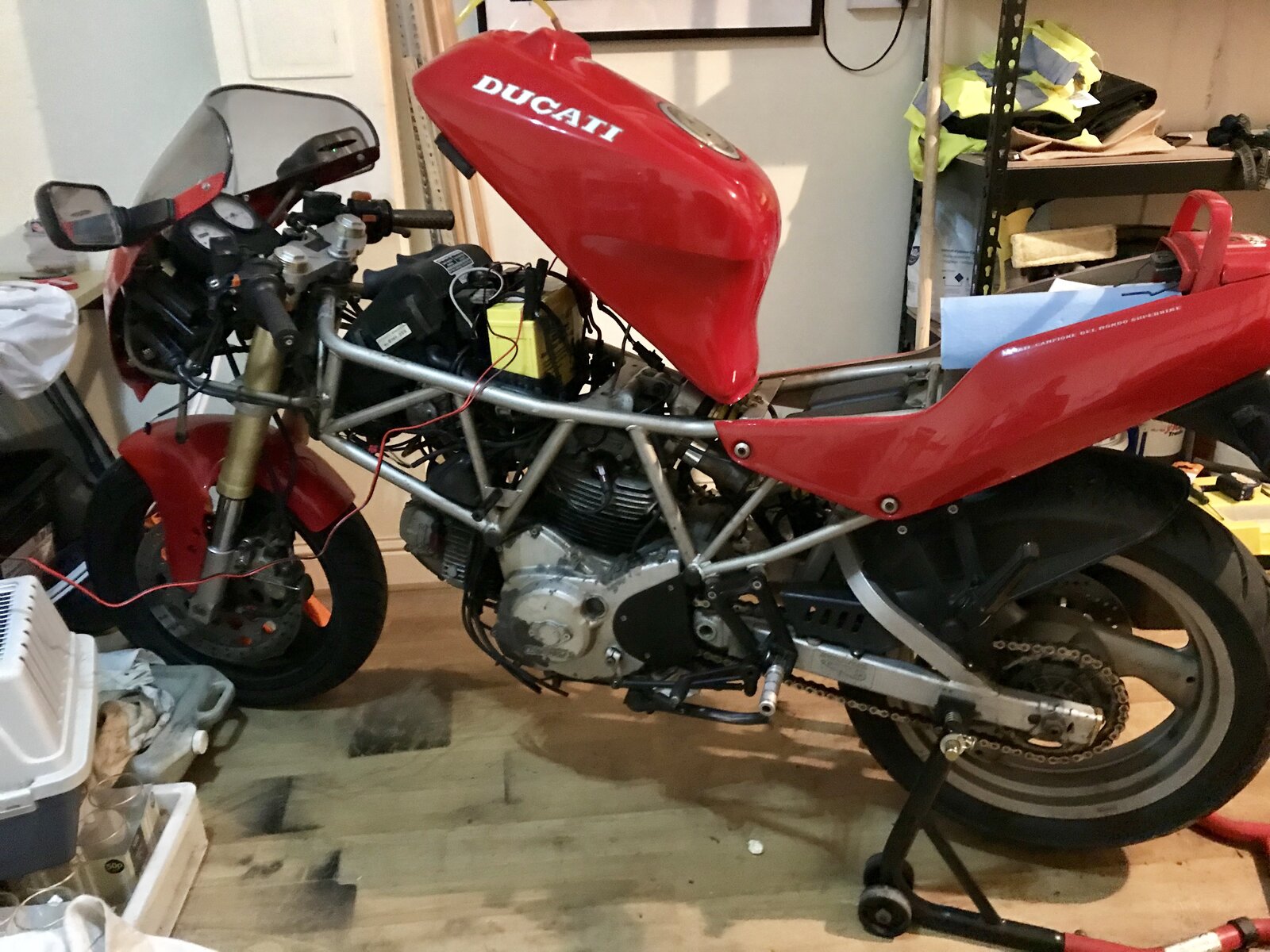

  1. If you can't find the info here, I'm happy to go through it again, but I have been a bit short of time the last few days.
  2. @Desmoquattro thanks for the tip, swapped the wires on the pick up coil and it ran on both cylinders! Mega chuffed
    Had forgot to check it before but when researching the forum on @Arquebus advice I found someone who’d had the same issue and that was the fix.
    Bike seemed to be running lean as the revs were hanging so took the fuel screws out to 3.5 turns from fully in and tried to set the idle. Was running much better but still hunting a bit and the revs are still hanging a little, also getting a bit of backfiring so I think there must be an air leak somewhere.
    Took the bike for a spin around the block and it pulled perfectly, picked up nicely from low revs and nice and linear all the way through the rev range. Checked how much load each cylinder is taking by pulling one plug lead at a time while the bike was running, very little difference pulling the front plug and a bigger drop pulling the rear one so figure that the carbs are slightly out of sync.
    So a bit of tuning to go to get it all right but it’s running properly for the first time in 3 years! Thanks for all the help and advice

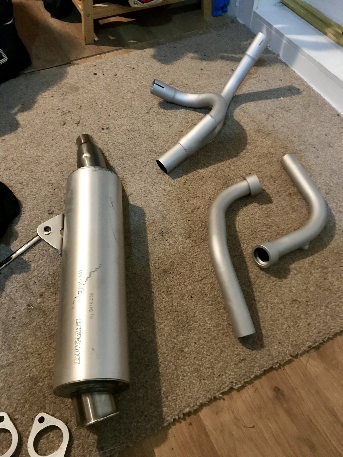

    Have also managed to source a decent set of exhaust headers locally which I'm collecting on Sunday amongst a few other bits and bobs, with any luck the bike could be ready for an MOT within a week or two! :party:

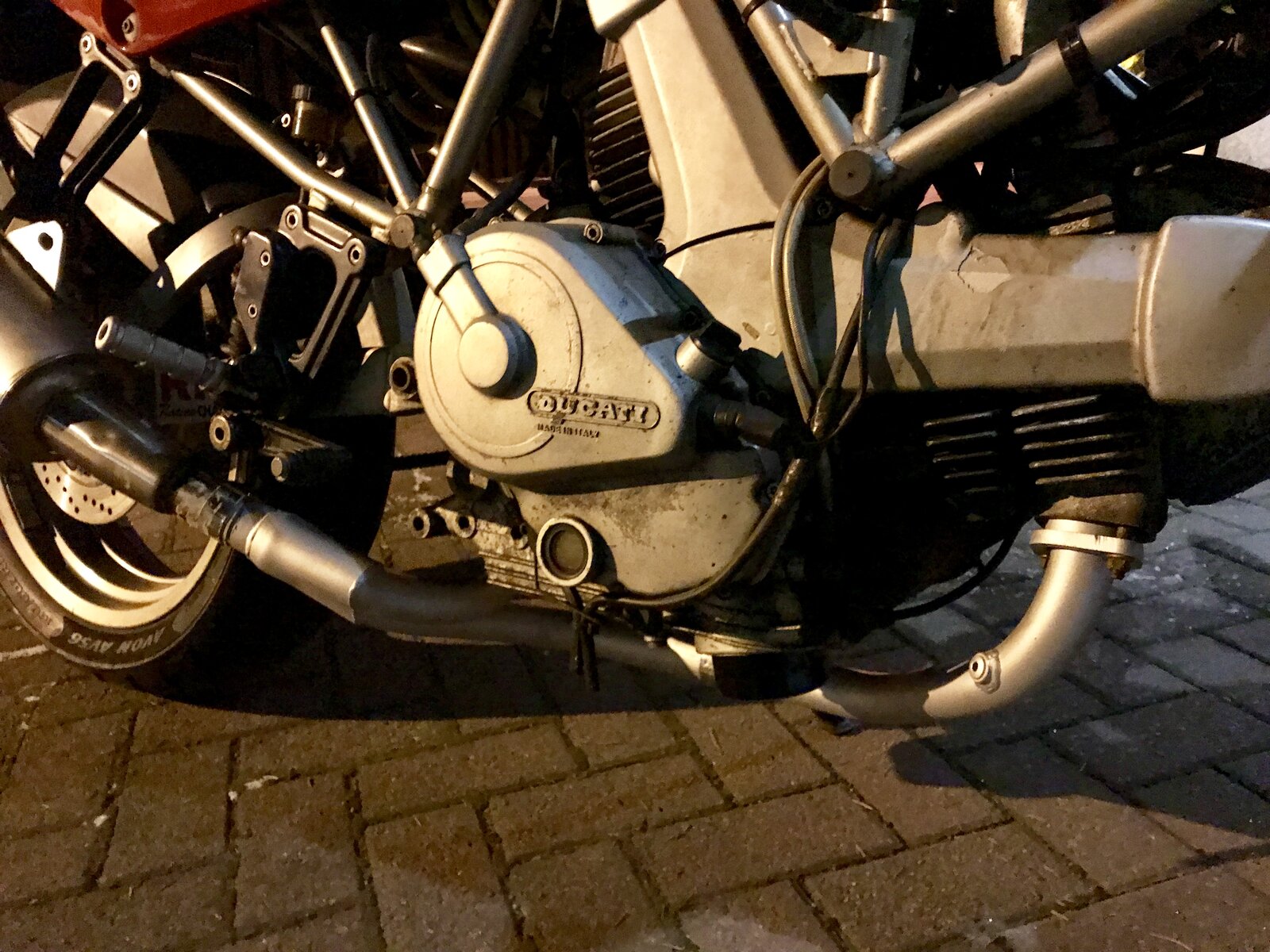

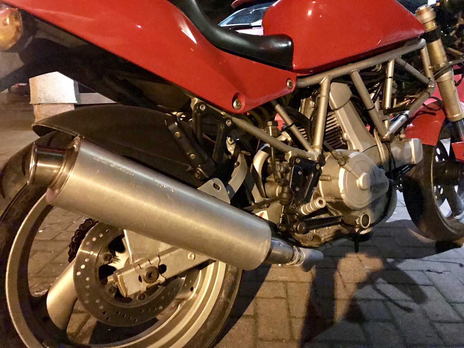

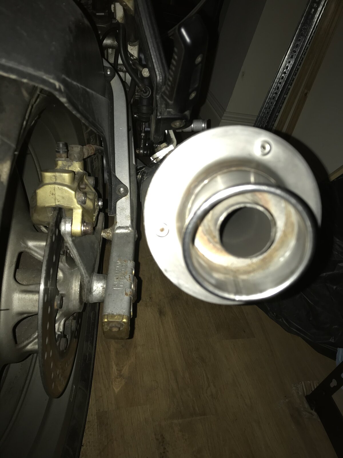

  5. Little bit of progress again. First off thanks to @HairyWolfhound for the exhaust, it’s in much better condition than the one that came off the bike! To try to preserve this I’ve given the headers a few coats of high temp paint.
    Fitted the new exhaust up and ran the bike briefly (too cold to be hanging around outside) and it definitely runs better, sounds good too! Struggling to get the exhaust in a position where it’s not hitting the swing arm though, think I need to slacken everything off and try and manipulate the whole arrangement a little.

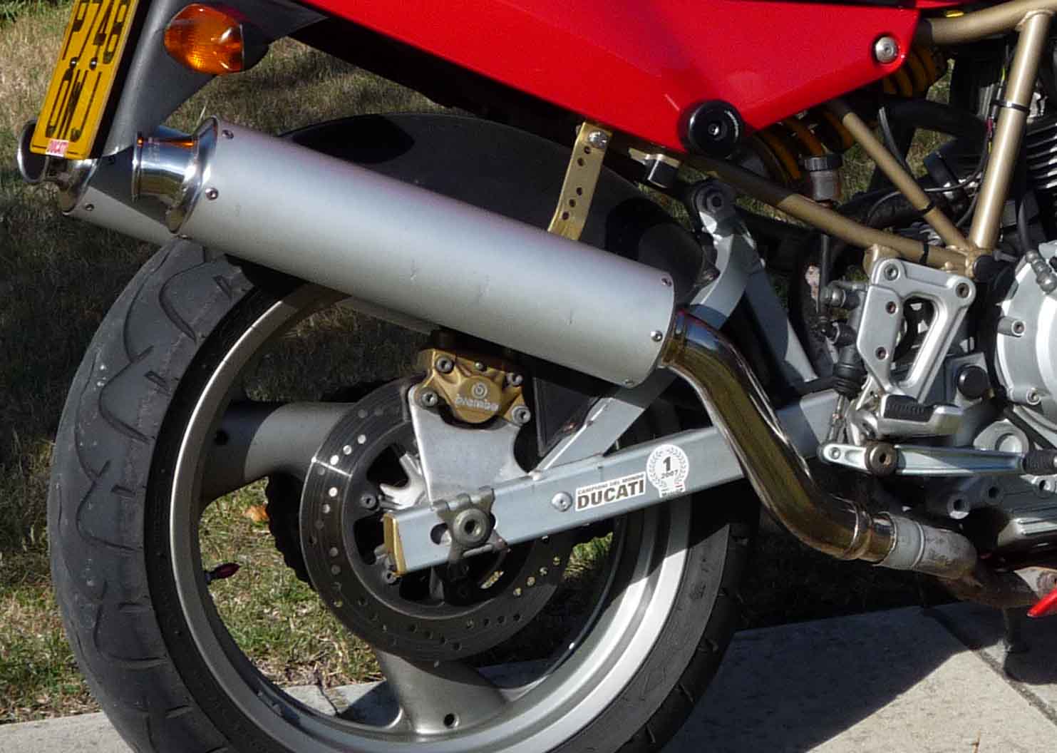

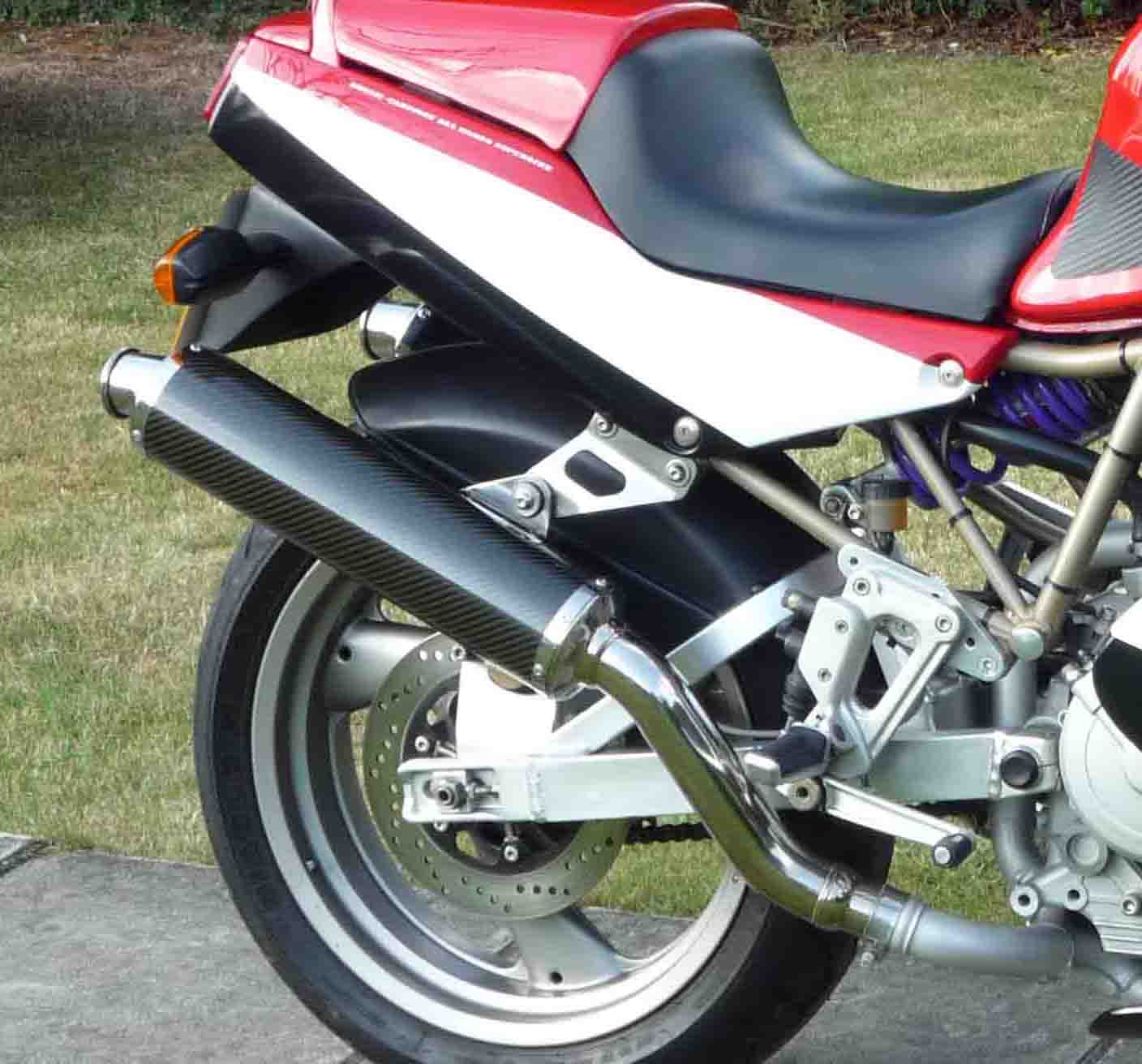

  6. I had a similar problem with my 750 albeit it had twin cans......ended up making my own hangers and turning the outlet caps to suit as well.
    From what I can see in your photos, it seems to me you need to reverse the hanger bracket on the can, and rotate the can so the bracket is upright; then remove the end cap rivets and turn the end cap and re-rivet so it is in the right position.
  7. Yeah I figured it would require something like that. Didn’t want to go too deep into it last night as it was late and cold. I think I’m going to slacken all the clamps and see if I can manipulate the outlet from the headers so that it exits at a slightly better angle too.
    A job for Sunday!

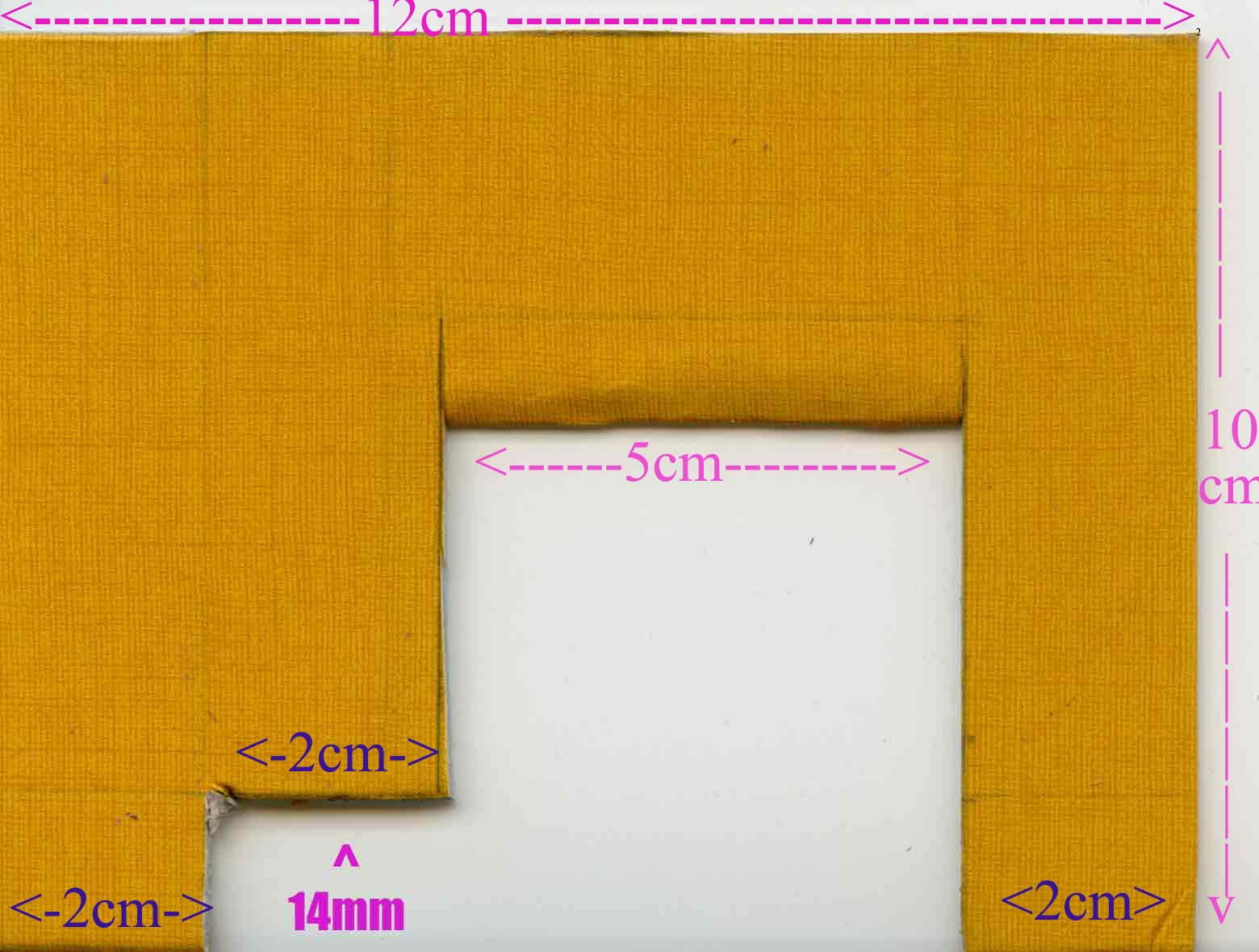

    Have you replaced the needles and main jets?? They do wear...
    I found it hard to measure the float height, so made a crude one-size version of the adjustable factory pro gauge
    The 14mm dimension, you make to whatever Al recommends.
