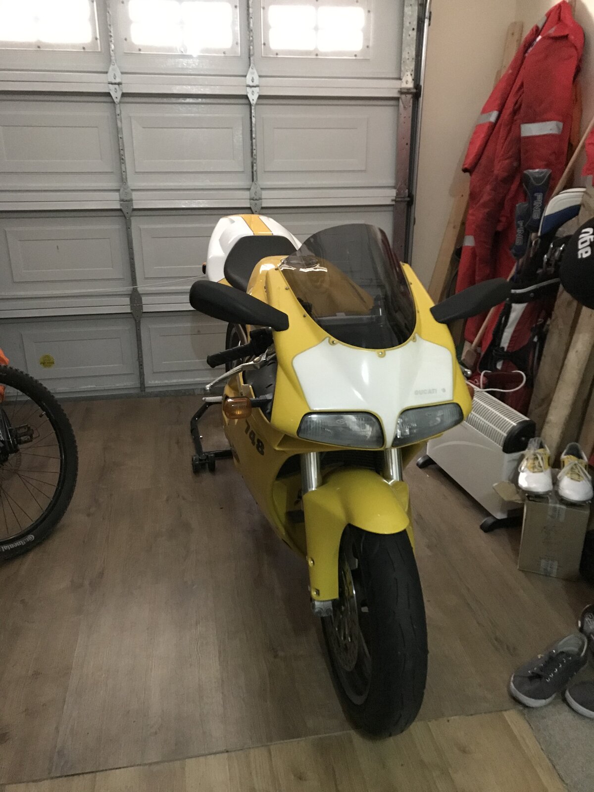

    The yellow peril is getting plenty use in the meantime:upyeah:

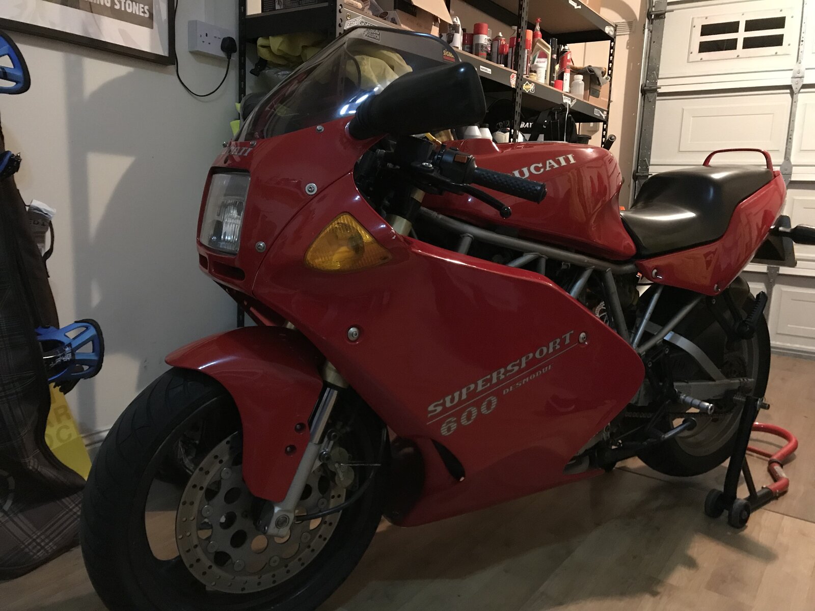

  17. After a bit more cocking about the bike is finally MOT’d! Absolutely delighted, rides beautifully and feels quick enough given its relative lack of power.
    Planning on putting some miles on it to make sure it’s reliable and might look to move it on to make space for a new project. Time will tell.
