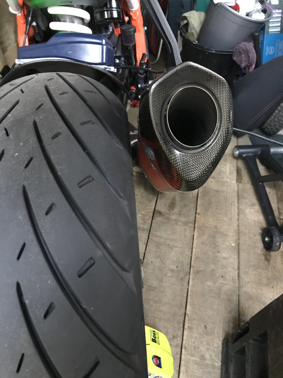

  3. Good to see Wayne. Can you share a picture of your top bolts?
    To be fair, in the image I shared, I nudged the exhaust as close as possible. Due the the sprung press fit exhaust there is some movement, and when I nudge the exhaust out as far as it will go, it usually returns to the close position after some riding.
    It’s not really bothering me now. 4K miles and it’s fine.

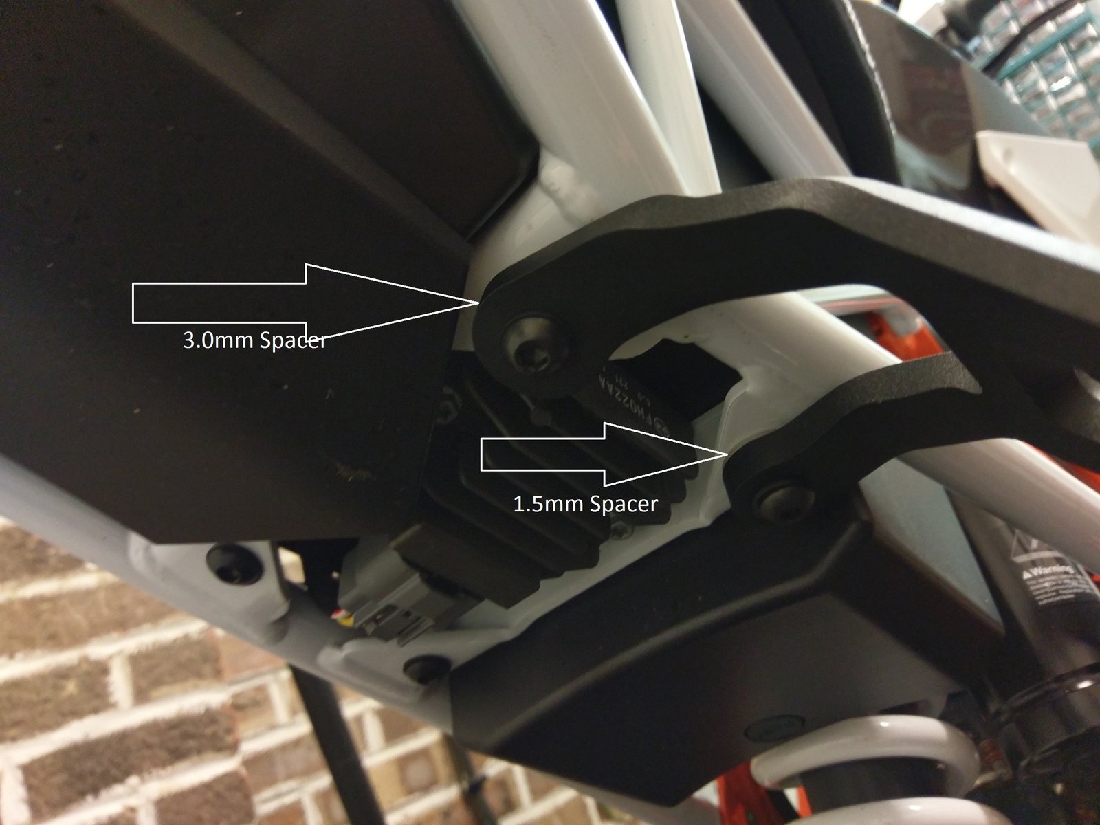

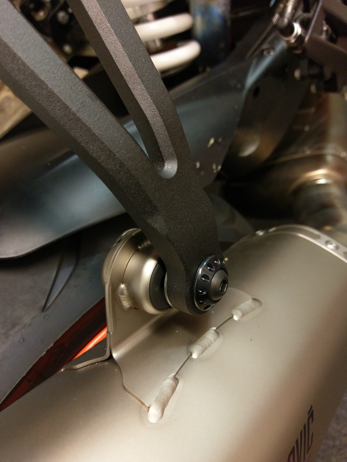

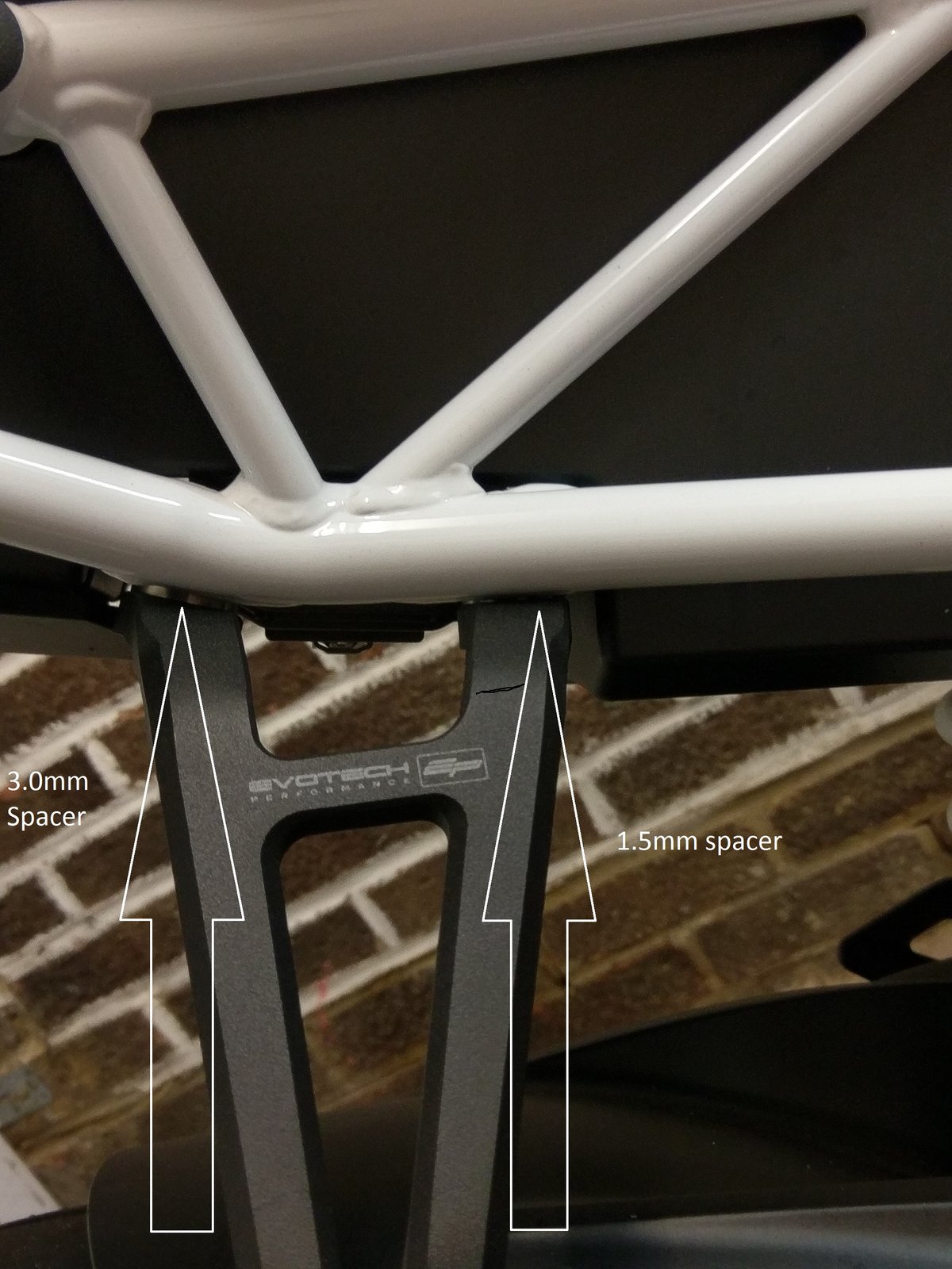

  12. @Jimmy899 . There are the allen heads with a black washer underneath them, then the hanger metal, then the spacers closest to the subframe of the bike. 3.0mm on the left, 1.5mm on the right, apologise for the piss poor photos, but you get the idea

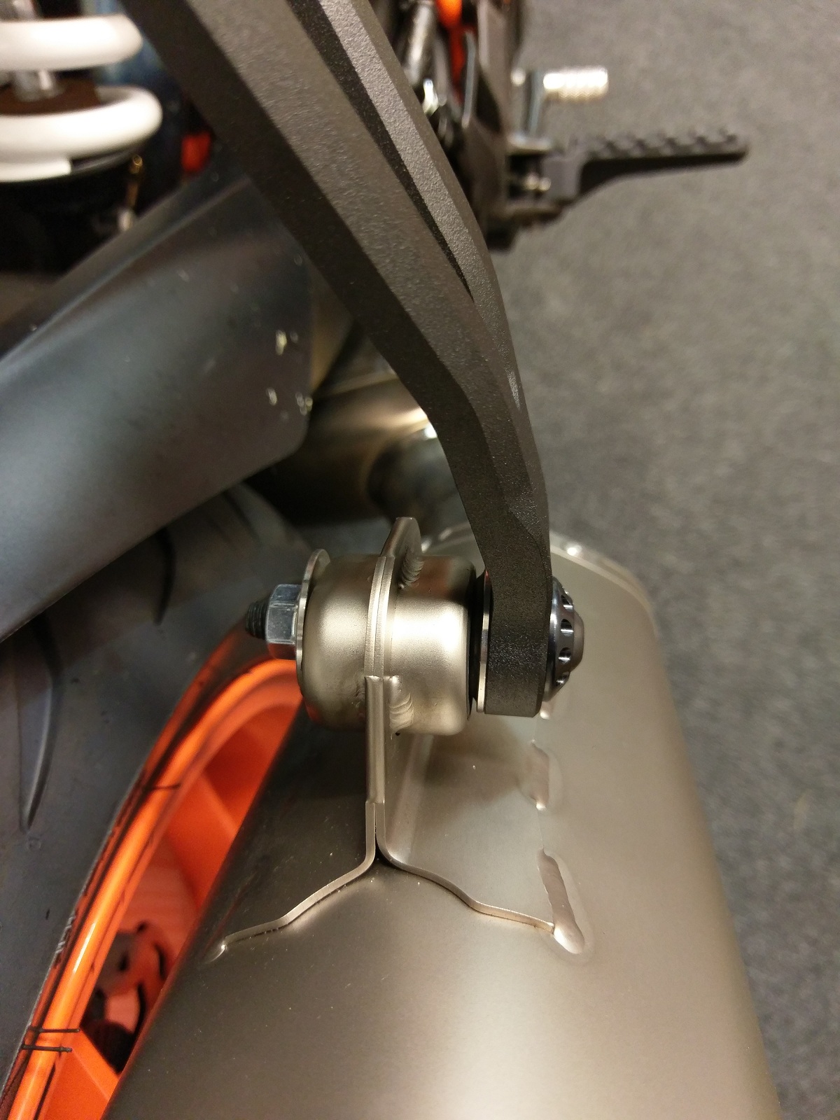

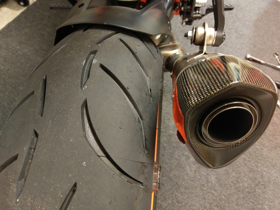

  13. PS @Jimmy899 . The gap remained consistent between exhaust and wheel after one journey to work and back last night...:upyeah:

  15. Done some jiggling and it’s looking better...
  16. Well jiggled sir ;)
