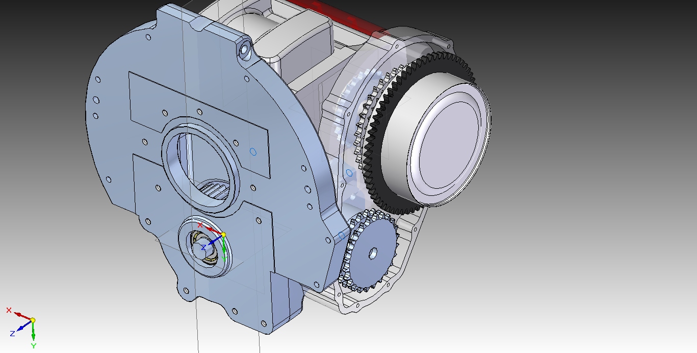

    I've been abusing my poor little lathe by turning a 140mm x 100mm long alloy billet into a boss for the primary drive output shaft.
  11. mate,that pile on the floor looks nothing like a primary drive housing.:smile:

  16. Will it run with the clutch dry Chris, it does it have an oil case?
  17. Nick, it'll have a wet clutch. The primary case will provide a support bearing between clutch and final drive sprocket and also add structural strength for the swingarm mount.
