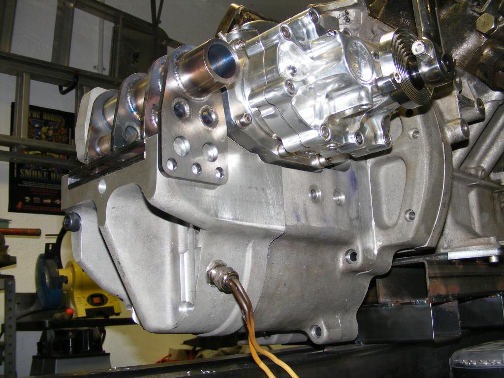

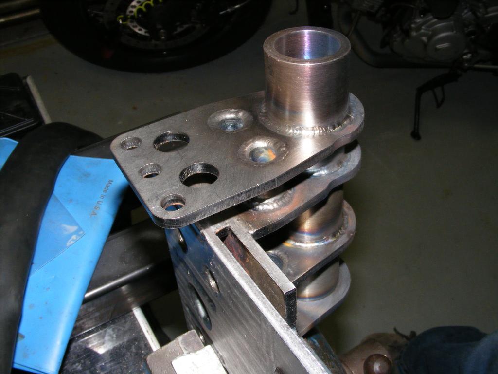

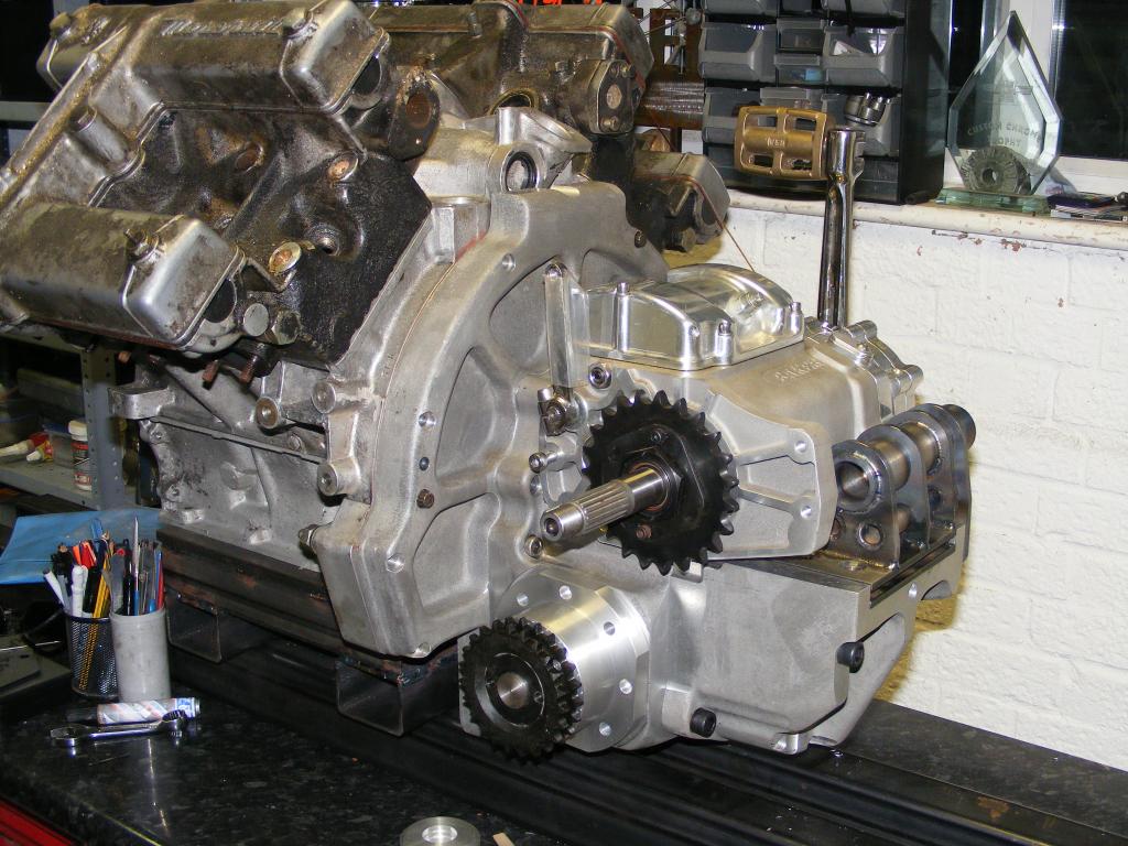

  1. DSCF9521_zpsdae114bf.jpg DSCF9515_zpsf0a8b8e3.jpg DSCF9522_zpse89266df.jpg

  2. Added another Ducati part to the Maserati build
  3. That's looking really good Chris!
  4. Thanks Nick. I'm so lucky to have a brilliant foundry near me..

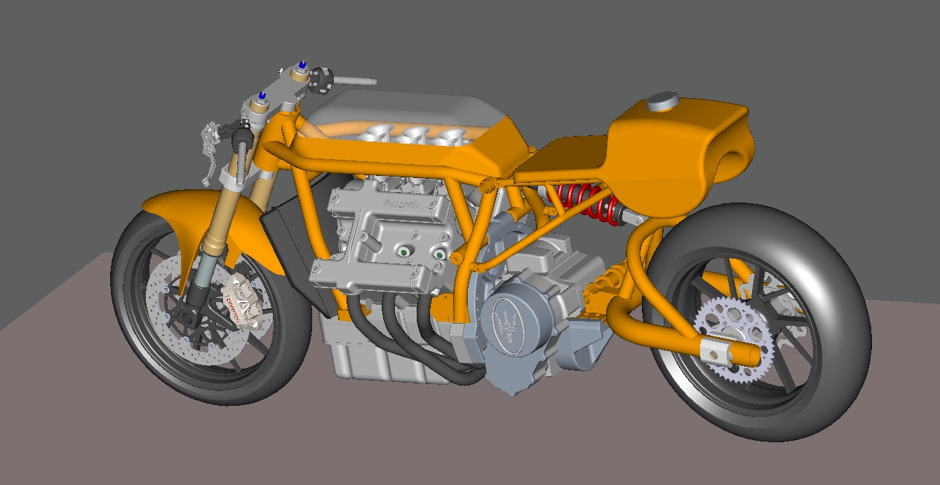

    I've redrawn the frame and this is what the bike will look like. The wheelbase is 1665 and rake of 28 degrees. I could have pulled the rake in and shortened the swing arm but I think this would make it even less rideable.
  13. I think you have the proportions pretty good considering what you are working with - I would question the rigidity of the frame. Any chance you could brace the headstock top rails on to the front of the engine?
    The tank / seat unit shape will be critical but it has the potential to look fab, love the build :)
  14. You're correct, there are a few anchor points available in front of the carbs that I plan on bolting to. I'll make the seat subframe bolt on also. I stuck a TZ750 seat on there because I had a 3D model on hand but I will make something bigger to hold fuel. It's getting exciting now because it will start looking like a bike soon. I'm thinking old MV for the bodywork.
