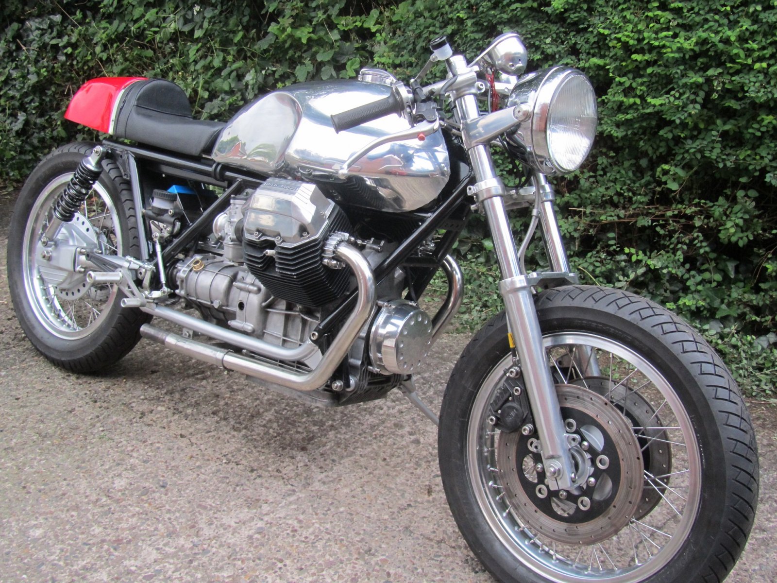

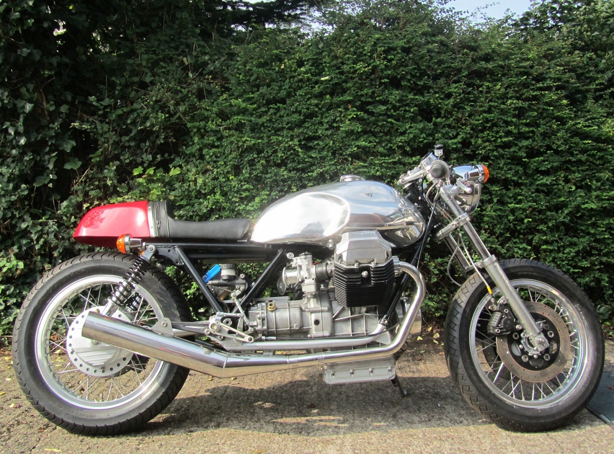

  1. Managed to get it rolled out the garage today, the problem was that the new brake pads and rebuilt discs were a bit 'sticky', should be ok with some miles under its wheels. Also spaced out the billet alt cover as it seems the alternator on mine isn't that reliable and doesn't like to get too hot, hence the spacers to let the cooling air in.
    Removed the sump, cleaned it up, bead blasted it and now got I'll probably paint it, same colour as the bevel box.
  2. Looking very tasty, I love the Alt cover
    Personally not too sure about the red bump stop, I'd have went black masel, but heh ho.
    Very nice and a very good showcase of your considerable skill set
    John

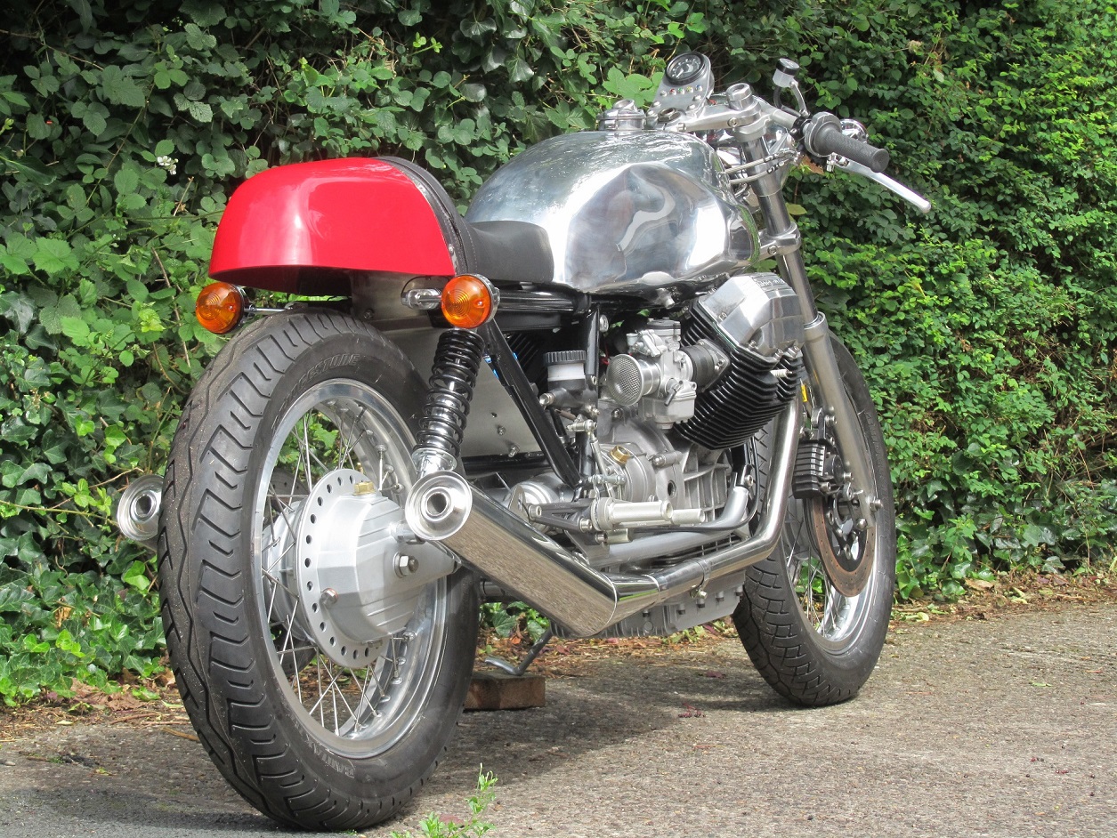

  5. A few more parts arrived in the post this week... indicators, cables and a small LED rear light.. maybe a bit too small? It'll be getting a billet cover to bulk it up a bit and to match the rest of the bike. Also fitted the freshly painted sump and filled it with fluids, though had a brain fade and overfilled the transmission with the engine oil... duh! Oh well, helped flush it out I guess.

  6. Finally decided to go for the obvious answer for the front indicators.. drilled the headlamp brackets, so it pretty much copies how Guzzi did it on the original bike. Next, turns out my newly bought throttle cable.. had to get a shorter one for the clip ons.. doesn't fit the Tommaselli throttle, so ordered a kit from Venhill and I'll diy. Got a similar problem with the choke, as the LH handlebar clamp/switch gear is damaged, which also holds the choke lever. The solution is to do away with said lever and cables / splinter and retro fit plunger chokes to the Carb tops. Those are ÂŁ15 each, which isn't too bad in the scheme of things.
    Yesterday the stainless LM silencers arrived from Keihan, went for the earlier LM1/2 style rather than the bulkier LM4/5 design. They look well made and fit ok, except for the mounting brackets not matching up with the Tarrozzi rearsets. Not really a surprise, so that's something else to sort out.
    I'd originally wanted to something similar from Armours, but despite Emails and many phone calls last week, they never replied or picked up the phone. So went with the slightly more expensive Keihans, ordered them on Tuesday, arrived today, two days later.

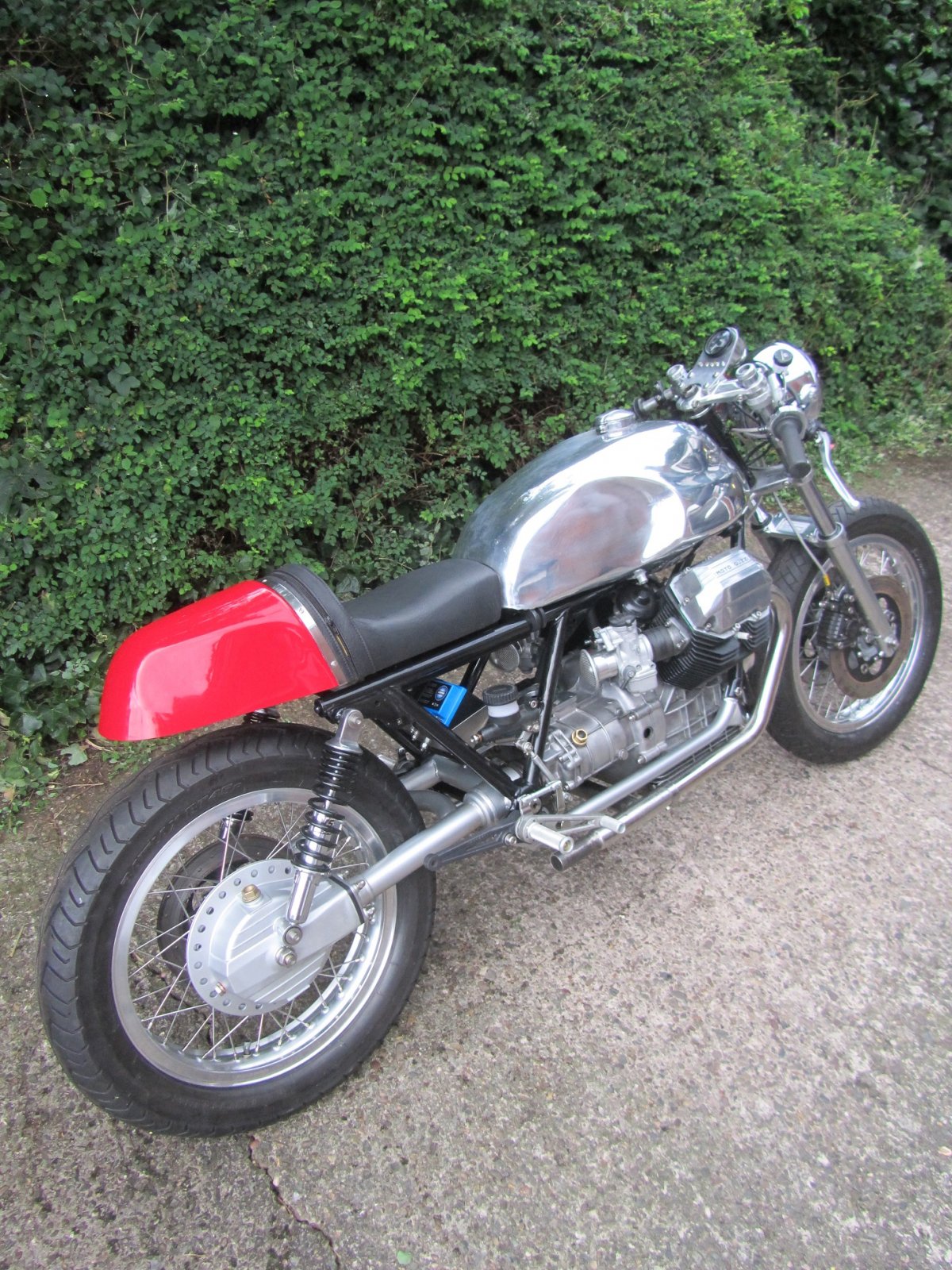

  7. Having wasted hours trying to make a bracket to mount the silencers to the Tarozzi rearsets look anything but crap, I gave up and ordered a LeMans 1 H pipe to replace the battered original on the bike. Cost me ÂŁ110 from Keihan, but it allows the silencers to move forward just enough to line up the silencer mount with the rearset mount. Looks much better too.

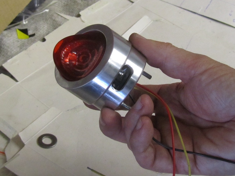

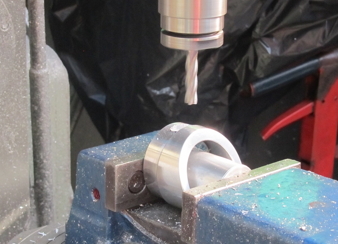

    Cant make a start on the wiring yet, as I'm still waiting for the single fire coil I ordered last week to arrive. Though I am finally happy with the rear light mount/cover, having machined it down for the third time this week.
    The next big expense will be the paintwork, still haven't decided what colour / graphics its getting, I'll probably keep flip flopping between red or black/gold until the last moment. There's no rush now, given it wont be finished until the good weather has long gone this year.. Be good to get the Guzzi all done and dusted, as I have a new mini project I'd like to make a start on soon..

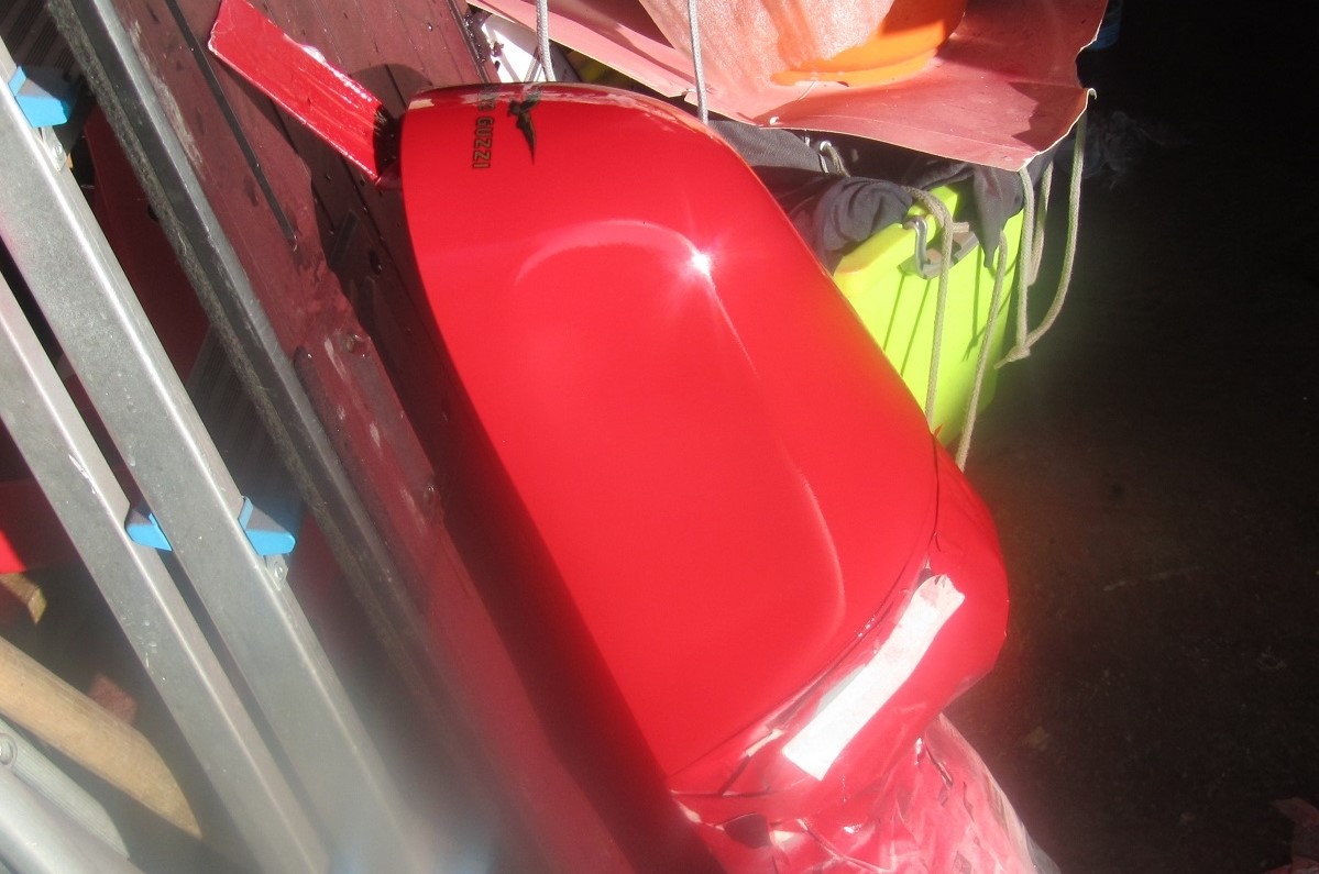

  9. Finally made a start on the paintwork, the seat unit was pretty easy (so far anyway), while I'm still working on the prep of the tank, really want to get the colour on and get it lacquered, but telling myself to do it right and not rush anything...
    Here's progress so far today..

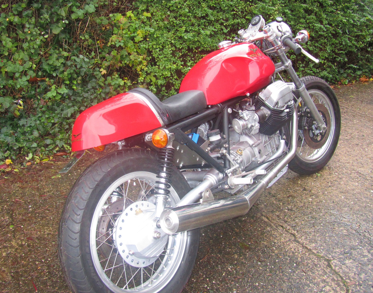

  14. Although the paint still needs to be cut back and polished, I couldn't resist fitting the tank and seat to the bike. Later there was a brief break in the rain clouds, so I quickly pushed the Guzzi outside so I could stand back and see if I like it or not, and if it might need a speed stripe or two (to add 10mph to the top speed of course..).. Think I'll leave it as is for now, the shade of red I chose looks about right, though I do wonder how it'd look in black with gold decals? Perhaps I'll paint my Norley that way someday. Have to tackle the wiring now, which will be next weeks task.
    Here's the second part of the DIY paint video..https://youtu.be/BAn2pw7jFEU
    And here's the Guzzi in its new cloths about to get very wet..

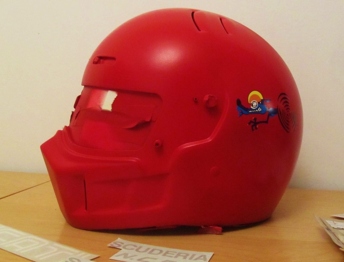

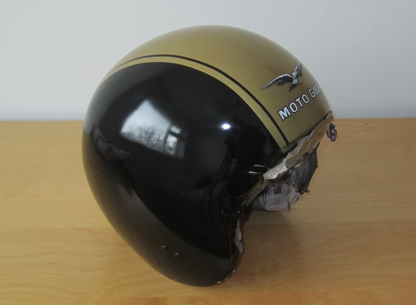

  16. Its too cold in my garage to working on the Guzzi, but with the surprising success of my DIY paint job, I decided to paint a couple of helmets. Both had been given a custom paint job a few years ago by a local place (since closed), and in both cases I wasn't really happy with the result. One is a Davida open faced and the other my old Simpson Super Bandit, the latter also having a gained a few scuffs an scratches over the years.
    After a few hours of sanding, masking and a few coats of rattle primer, I sprayed it Ducati Red... what else.. Then a dug out a big envelope full of old decals that I'd bought but never got around to using, including a full MHR decal set and a few random Ducati decals, none of which were the right size sadly. But all was not lost, as I also found a pair of NCR decals, which I cut in half and used on the Simpson. I now need to order some smaller Ducati decals, not sure what, but probably the classic 70's style. The paint doesn't look like much at the moment, but when its lacquered (I'll use Spraymax 2K again), it should look a lot better....

    Still, I have finished my DIY paintjob on my old Simpson... its now Ducati Red, with NCR decals ..
  19. 004.JPG With the Simpson painted, I turned my attention to an old Davida Jet which ha been given a custom paint job a few years ago, which I never liked, the painter didn't o what I wanted, more what he thought would look good. Not impressed. I chose this colour scheme because its what I have in mind for a future project bike, and I needed the practice. The pinstripes weren't as tricky as I'd expected.. in this picture the paint hadn't been cut back and polished yet, so its still a bit orange peely..
