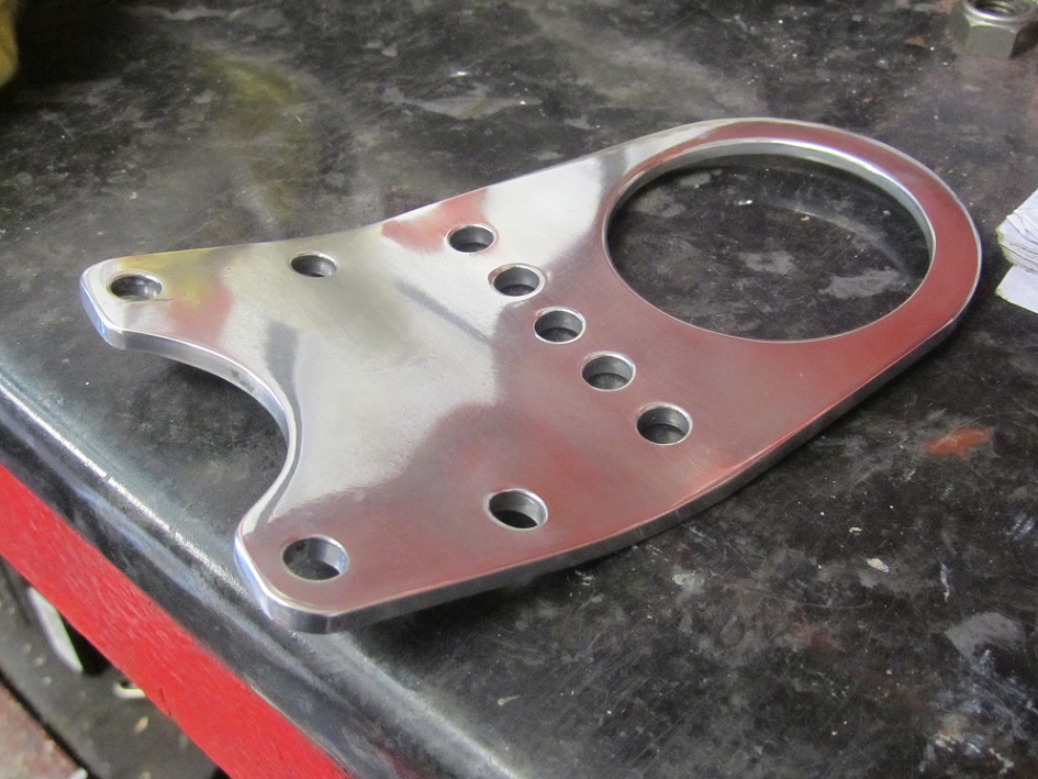

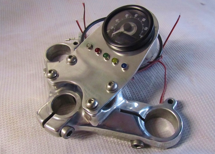

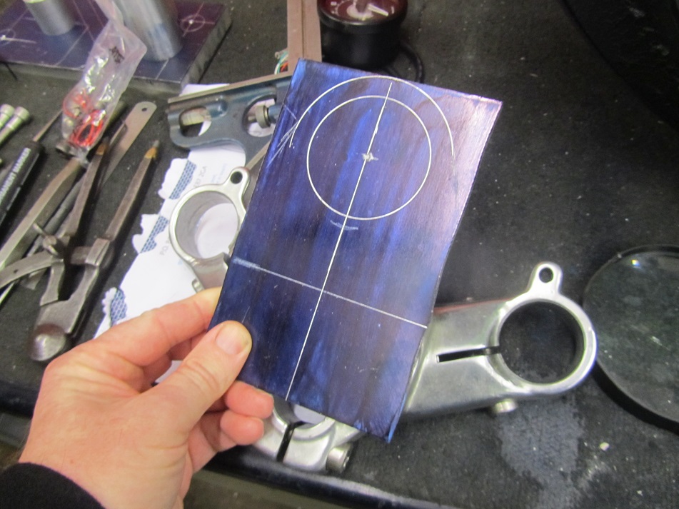

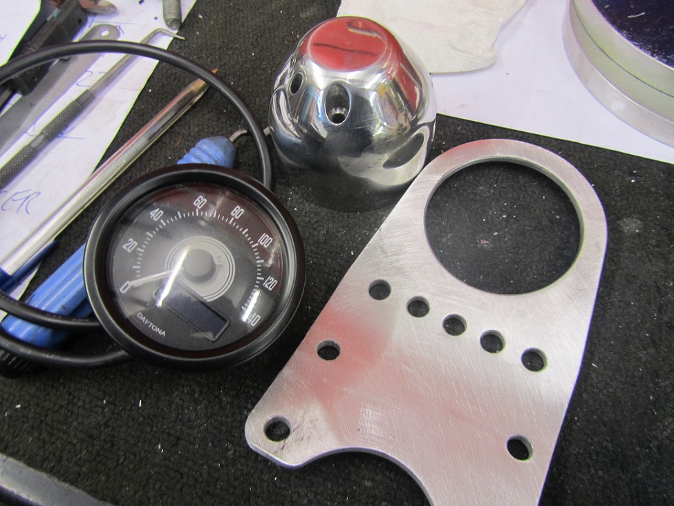

  1. The speedo mount is being made from a scrap piece of 3mm alloy plate, fortunately its going to be shaped by Jeff on his miller when he has time, which will save me a lot of effort with a hacksaw and file. I've also opened my wallet for once and ordered some new shiny bits.. stainless engine mount bolts and stainless pins for the Brembo P8 calipers. Not strictly necessary, but the old rusty ones were annoying me.

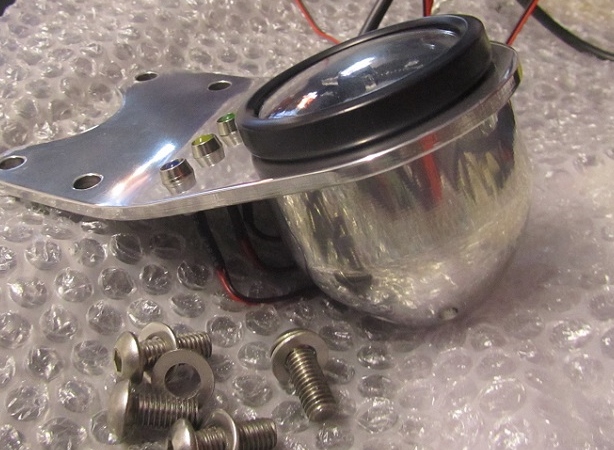

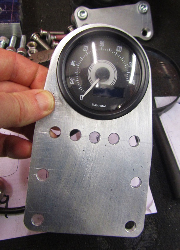

    While the frame was away, got a couple more jobs done. First (almost) finished the speedo bracket which will bolt to the top yoke, it needed a lot of heat to put a bend in it, cant just use force, as alloy tends to crack if your not careful. I'm also getting a billet cover machined for the speedo body, which should be ready next week. Here's a pic before the bracket got a bend put in it. 006.JPG

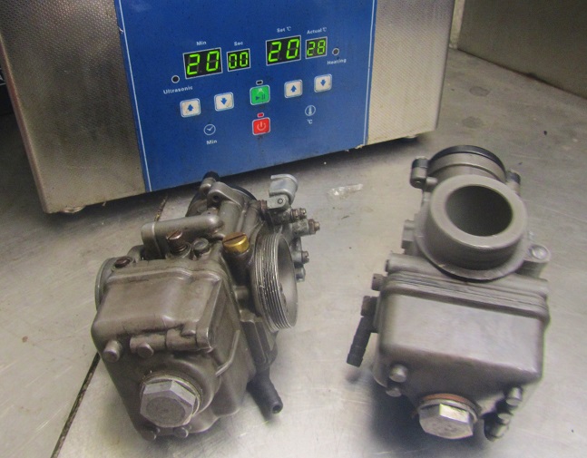

  4. While I was at the bike shop, I dropped off the two carbs for a soak in their ultrasonic cleaner, not sure how well it'll work, will wait and see. 004.JPG

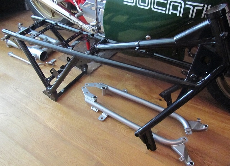

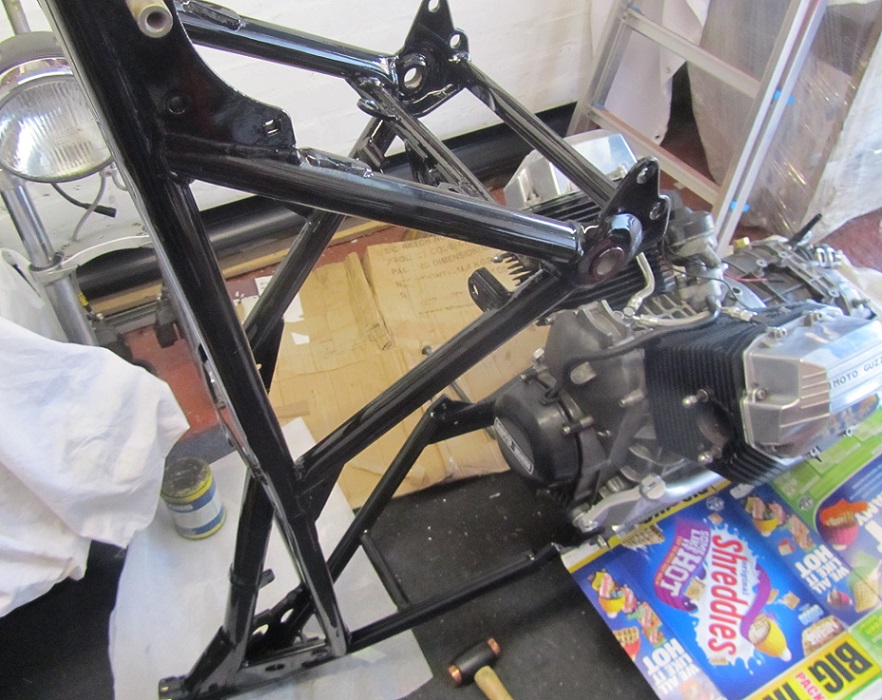

  5. I collected the frame from Triple S yesterday, looks so much better than the first attempt elsewhere. Unfortunately a big pallet arrived last week which is sitting in my garage taking up the last bit of room, so I cant do much assembly work on the Guzzi for now. That's ok, there's plenty of other jobs to do, while in the meantime the frame can stay warm and cosy sitting alongside another old Italian in the lounge. 007a.jpg
    #146 MisterB, Mar 6, 2016

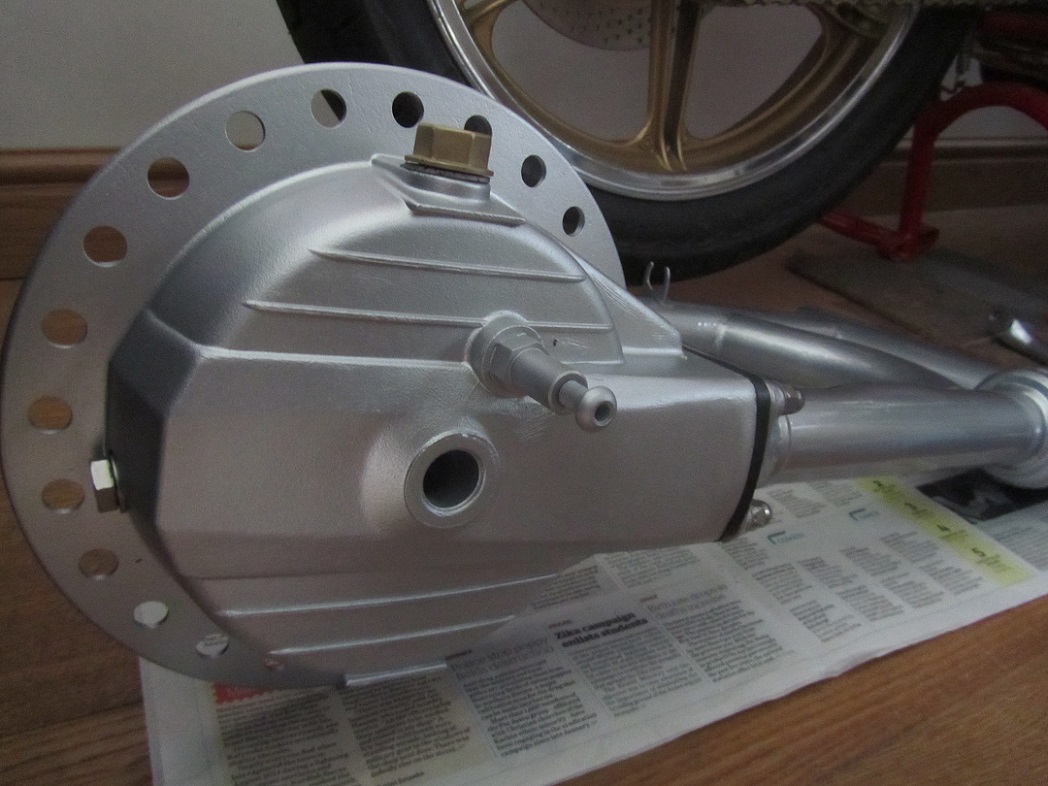

  6. Despite the lack of space in the garage, I decided to press on and try to get the frame back onto the engine. But first I assembled the rear bevel box and swing arm, cos it was easy and looked like I'd done something. I also replaced the old drain / level plugs with stainless bolts which had their head machined to make them look a bit better.
    Ideally an extra pair of hands would've helpful when fitting the frame, but I was working alone so I managed to bolt the front engine mount first, with the frame up ended, then it was a case of pivoting the frame down and bolting up the lower frame rails. This worked surprisingly well with no damage to the new powder coat. The only problem I hit was that the clutch arm on the back of the gearbox needed its adjuster bolt removing to clear the frame as it pivoted down. This little issue turned into a massive nightmare soon after..

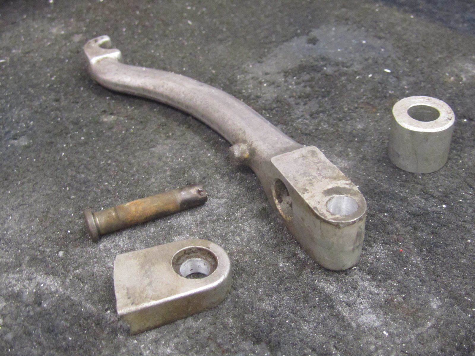

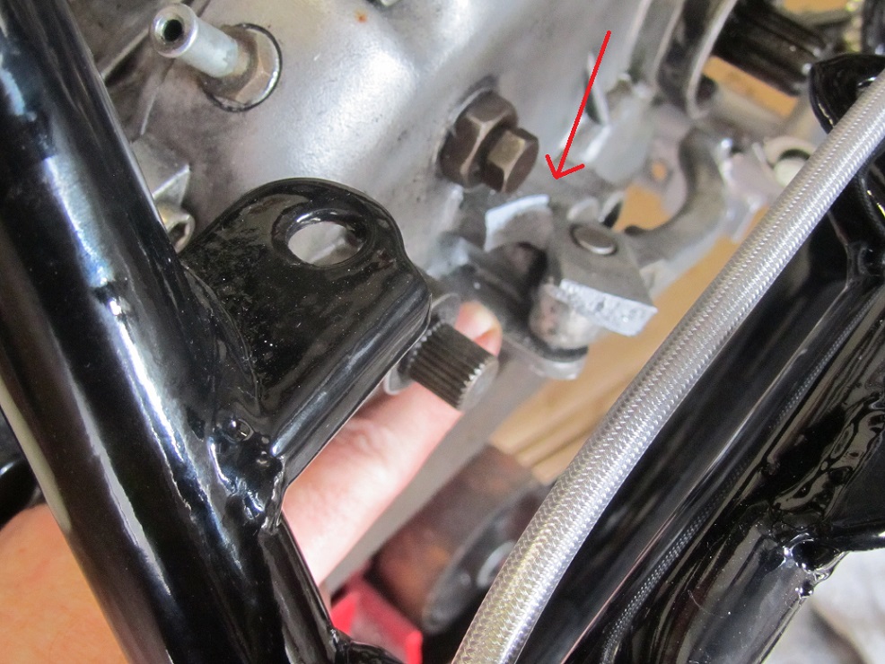

    One part I wanted to tidy up was the clutch arm on the back of the gearbox, its not that noticeable, but it all helps. Its held in place by a pivot bolt which in turn is kept secure by a split pin. The split pin was rusty and fell apart when I tried to remove it, ended up having to grind off its remnants, which still left the pivot bolt not wanting to come out. So I used a small drift and hammer to gently know it out. It was stubborn, but moved eventually, or rather it seemed to move. What had actually happened was that the casting it pivoted in on the gearbox cover had snapped. What I nightmare. I was shocked as I hadn't used much force at all, god knows how it had failed.
    Looks like the gearbox will have to come out, I'll have to reverse everything done to remove the cover and repair the broken mount. At that point, I downed tool, I was to annoyed to carry on today. I've since learnt that the clutch arm bracket is a well known weak spot, wish I'd known that beforehand!

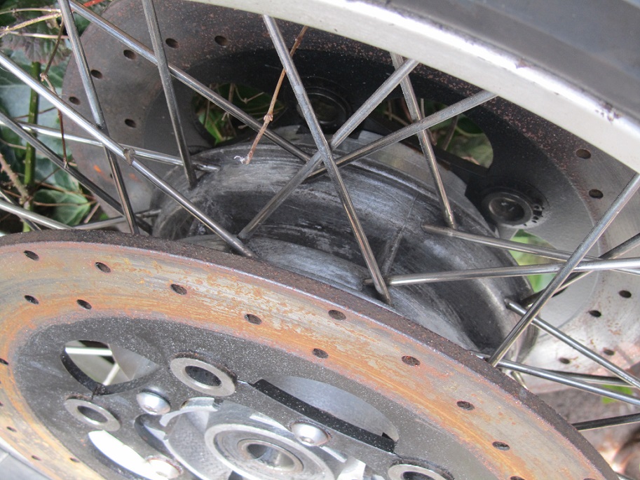

  7. I decided the wheels weren't good enough, the anodised Akront rims were scuffed and scratched, while the hubs had been painted badly along with the rest of the bike by a previous owner. When I got the bike, I tried to remove as much paint as possible, the stainless spokes turned out ok, but it was impossible to clean up the hubs with the spokes in the way.
    I'm not sure yet whether the original rims can be restored to a good enough finish to be re-used, if not I'll get new Morad rims. Expensive but worth it. While ideally I wanted to also reuse the stainless spokes, as they looked to be in good condition.

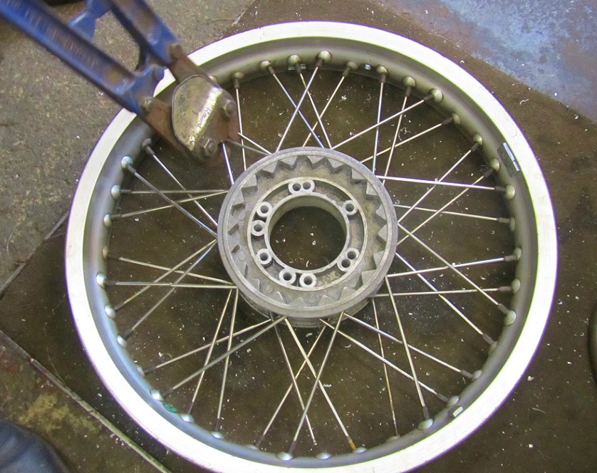

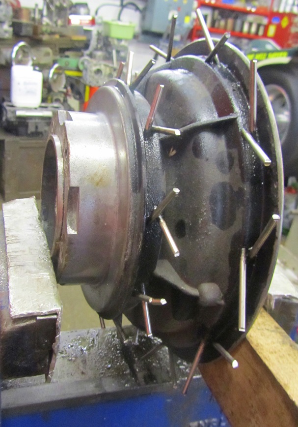

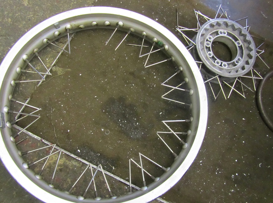

  8. I took the wheels to my LBS, who removed the tyres for me, then it was off to my mates workshop to dismantle the wheels, shouldn't take long, just need to unscrew 80 spoke nipples. How wrong could I be ! The first few spokes snapped inside the nipple as I tried to unscrew them. Not good, and a surprise given that the spokes were stainless.
    There was nothing more that could be done, but to cut the spokes, as they were beyond saving anyway. At least that didn't take long, five minutes with the bolt cutters and the hubs were free. But my wheel troubles weren't over yet. The spokes were seized solid into the hubs, they didn't want to come out, even applying a blowtorch didn't make any difference. Instead I spend 4 hours
    hammering each spoke out of the hubs. What a pita, if I hit the spoke hard enough to move it, it would bend the spoke like a cheap nail. Don't hit it hard enough and its going nowhere.
    Eventually, they were all out, and with the old wheel bearings removed, the hubs, rims and disc carriers are ready for the blasting cabinet next week.

  9. On a positive note, my billet speedo cover is finished, I may spend a bit more time polishing it, when I polish the speedo bracket, it doesn't look too bad for now.

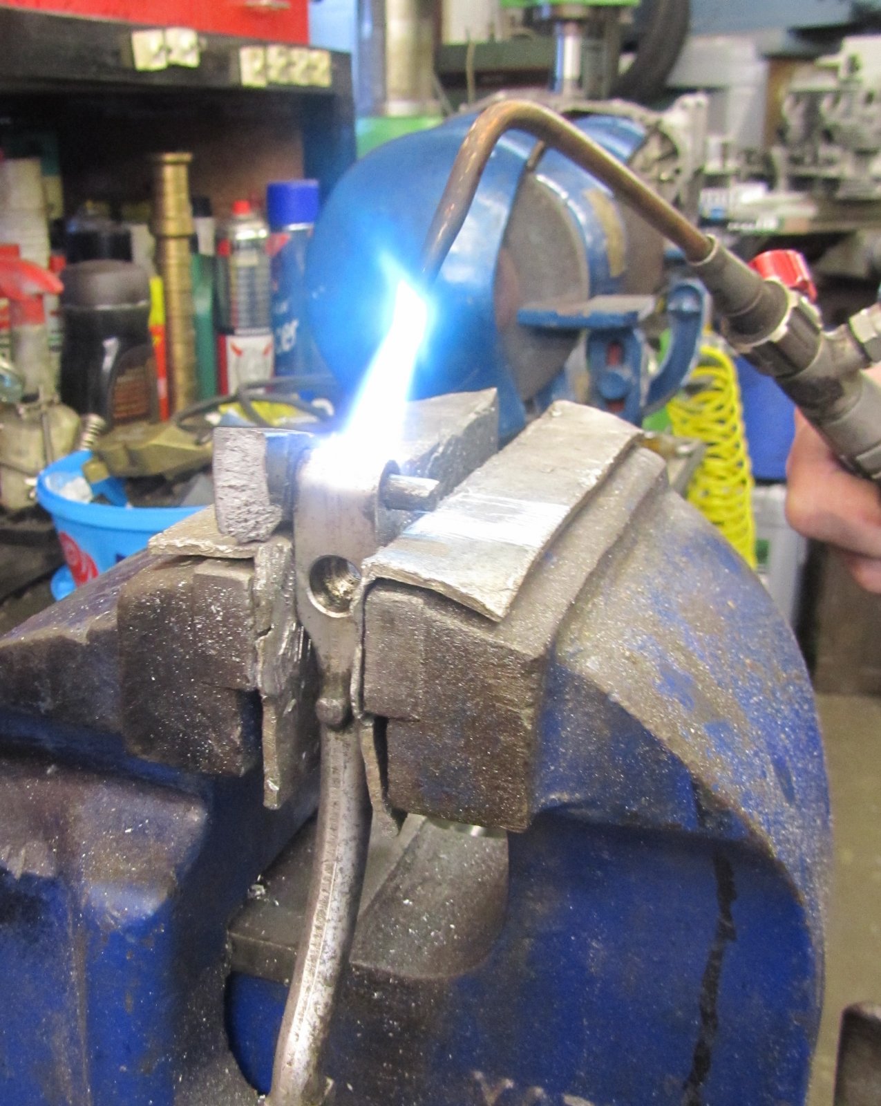

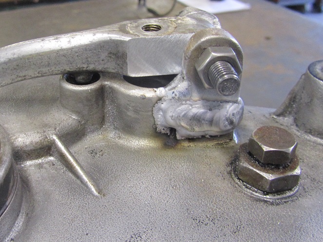

  10. The gearbox was easy enough to remove so I could get the broken clutch arm mount welded. But first had to use heat to get the pivot pin out of the broken casting. The next step was to make a temporary spacer to hold the broken casting in place when it was welded back on. Turned out the pivot pin was 7mm diameter, an odd size, so I reamed the mount and arm out to 8mm so I could use an 8mm stainless bolt to replace the rusted out pin.
  11. Then I took the whole lot to the local welder, who did the job while I waited, just need to polish the arm and fit a shorter 8mm bolt to finish things off..
  12. Talking of polishing, I finally got round to polishing the speedo mount and putting it together, it needs a couple of M5 button heads to bolt the speedo in place, which I need to order. I'd hoped to have the ignition barrel in the bracket too, but there isn't enough clearance below...

  13. I had the same issue with stainless spokes in a Triumph hub. The problem is almunium and stainless are on extreme ends of the galvanic series. I've seen alloy rim spoke holes eaten away by stainless nipplies too, the akront alloy seems to hold up well but the Excell type, which I believe is 7000 series alloy is terrible.

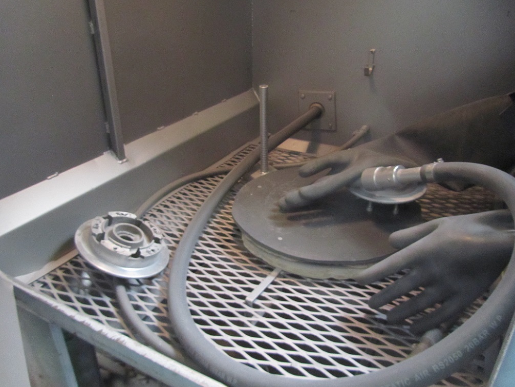

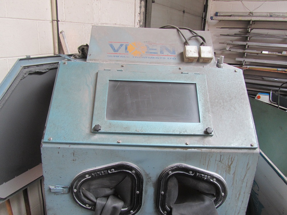

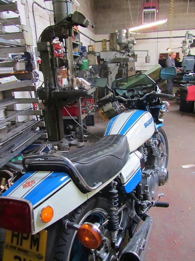

  15. I took the now dismantled wheels to a local machine shop who let me use their bead blasting cabinet, at the cost of a packet of biscuits and me making everyone cups of tea while I'm there.. a fair exchange..
    Here's a couple of pics of the set up, the hose / nozzle which fires out the blasting medium has a heck of a kick to it, you need to hold it tight, they've got a big old compressor that drives it. The shop owner likes bikes too, and keeps his owned from new GS1000S at the shop, though these days it doesn't get ridden much.

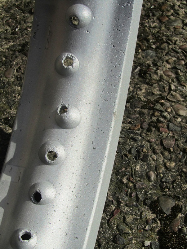

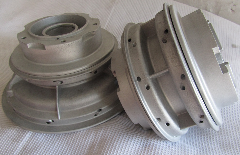

  16. The hubs were blasted, as were the disc mounts, and both came out well, then I moved on to the rims which were anodised, so I blasted the anodising of one rim to see how it looked. At this point I wasn't sure if I could reuse the rims, and whether they should be polished, re anodised, painted or powder coated. While the hubs could be painted or powder coated, I think they are too rough to be anodised. For now, I've sprayed the hubs with etch primer to protect the alloy.
    After cleaning up the first rim, I stopped as it was clear the corrosion pitting in the rim was worse than I thought, they could still be painted or powder coated, but at this point I'm more inclined to order new rims.

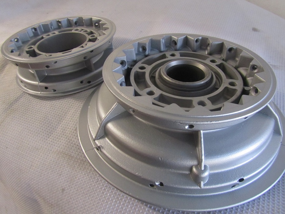

  17. Which brings things up to today. When it comes to the hubs the obvious solution is to have them powder coated, maybe silver, maybe black, whatever. But I could see a problem... the holes for the spokes are about a cm deep and with the powder coat being so thick, there's a good chance that they would be blocked or a least narrowed enough for the spokes no longer o fit. Then I'd have to remove the powder coat from the holes, a pain to do and possibly causing corrosion problems in the future.
    The hubs are too rough for anodising, which left two options, leave them as is, and hope for the best or paint them and hope he paint doesn't fall off in a year or two.
    I went for the paint option.. etch primer, under coat and a few light coats of 'alloy' look paint. It looks a bit too bright when first sprayed on, but it darkens a touch when its dry and looks more 'alloy like' ..

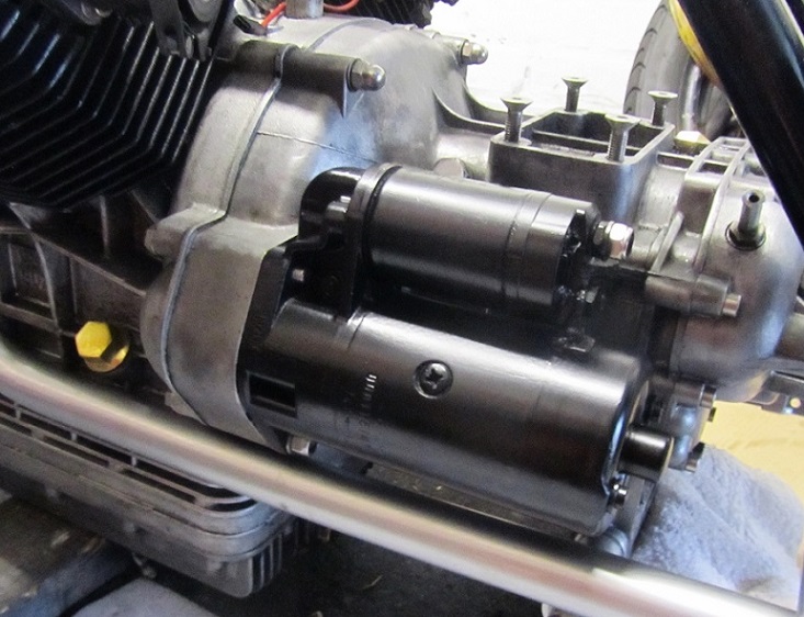

    First I decided the gloss black paint I'd used on the starter motor didn't look quite right. In the end I re-sprayed it satin black, not sure how durable the finish will turn out to be, but it looks better to me now.

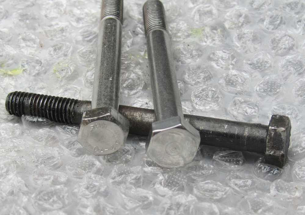

    Next the two old bolts which fasten the starter to the crankcase were replaced by new stainless bolts, but not before their heads were machined smooth..

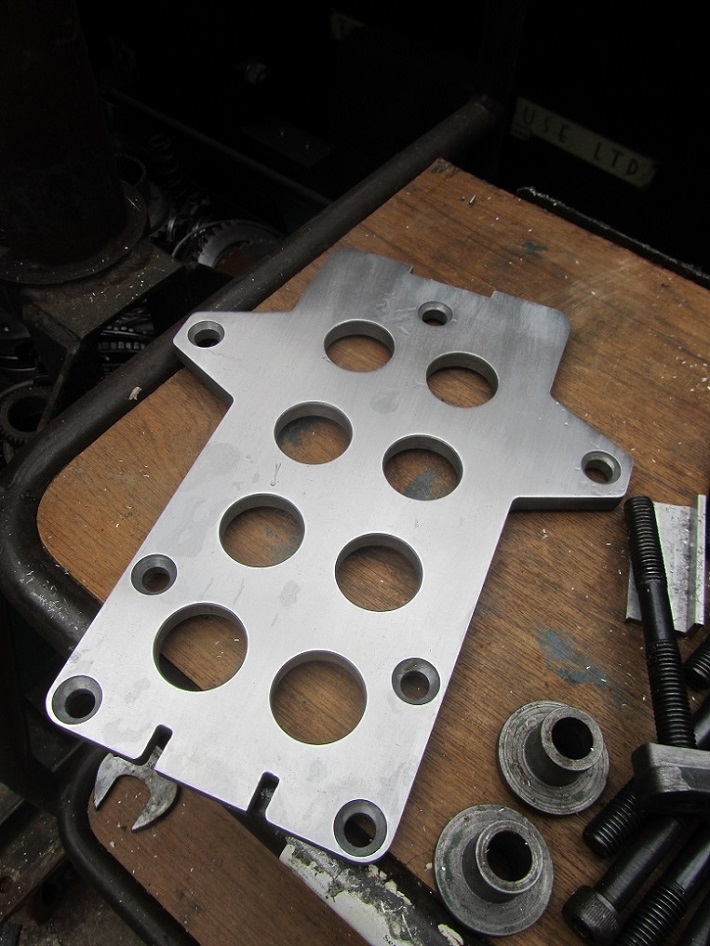

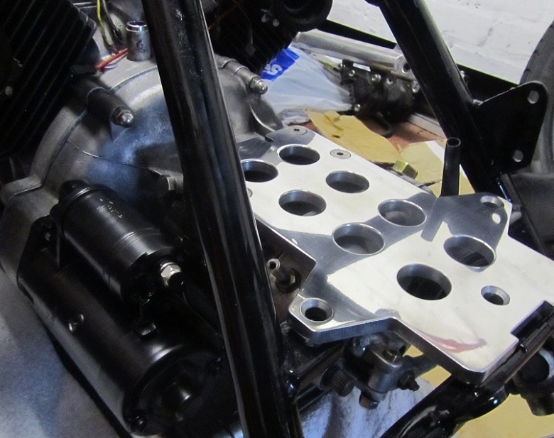

    The billet battery tray was looking dull, as I hadn't spend much time polishing it when I drilled and modified it a couple of years ago. I prepped it carefully, working my way to using 400 grade wet and dry, before using my mates homemade buffer. Its about thirty years old and still works really well. Once fitted to the top of the gearbox, its clear a couple of spacers will be needed to take up the gap to the rear frame mounts. Last time I just used a few washers, this time I'll do things properly.
