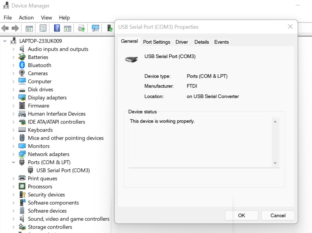

    I uninstalled and downloaded JPDiag again, plugged the cable and adaptor in, checked the COM port, reinstalled the cable drivers from the Lonelec website and checked everything was good to go:

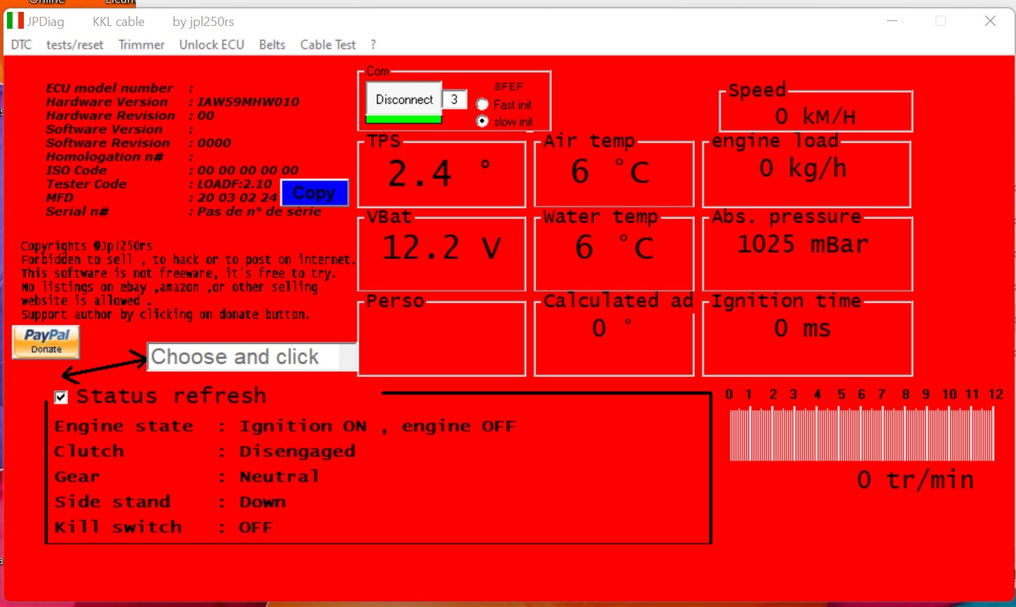

    Knowing I’d connected to my 1000SS with this Laptop and cable before I tried it first, but couldn’t connect, I left it connecting for at least 3 minutes a couple of times.
    Note that being an IAW59M ECU Slow init needs to be selected and no ECU License is required.
    Thinking about what could be different from last time I connected to the 1000SS I removed the license file for the 999 ECU from the folder where the JPDiag exe file is stored, tried to connect to the 1000SS again, and connected within 10 seconds.
    Hooray!

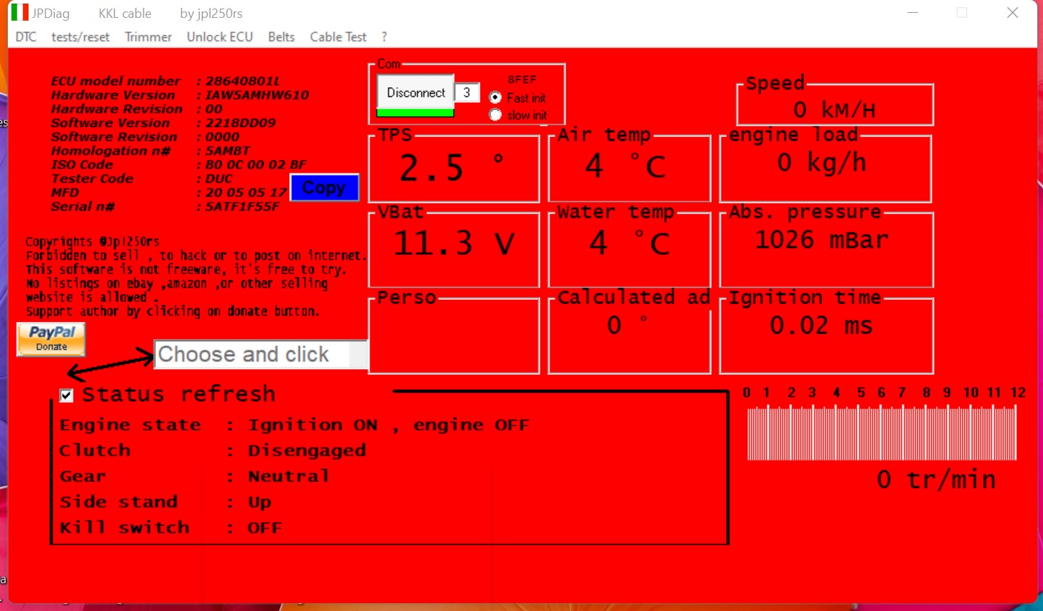

    Flushed with that success I put the license file back in the folder, changed the setting to fast init for the 999s IAW5AM ECU, and tried to connect to the 999.
    Again, straight in within 10 seconds.
    Note on both bikes I pressed the ‘Connect’ button and then turned the bike ignition on.
    Hooray again.

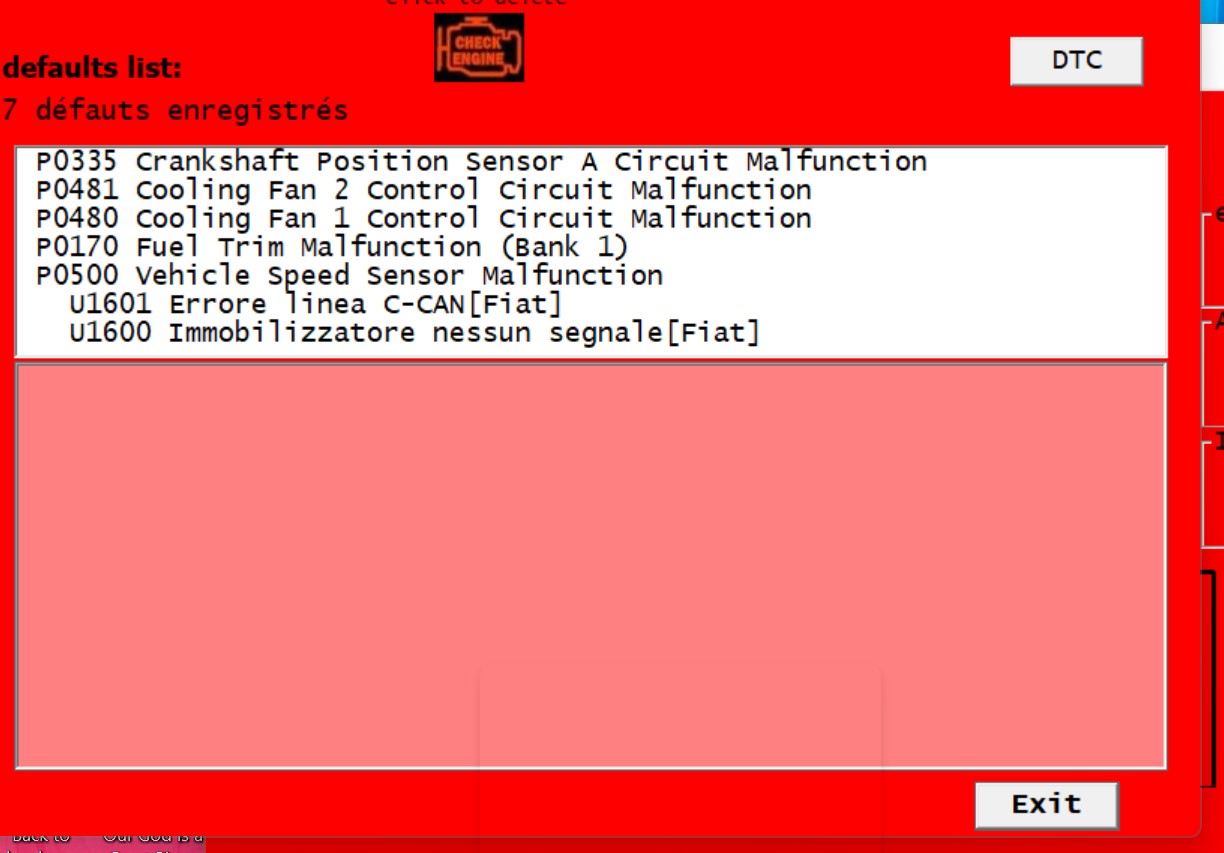

    I then had a look at the error codes using the DTC function
    I’m not at all worried about the above list at this stage and just cleared them.
    The bike has not had the codes cleared in many years and has been run with lots of equipment disconnected more recently, so I’ve no idea what is and isn’t still relevant from that list.
    The Engine management light is now out with the ignition on, but as it was gone 23.30hrs by this point for my neighbour’s sakes I didn’t start the engine to see what pops back up.
    That is hopefully going to happen tomorrow now when I can get it running and fully warm it up for the first time.
