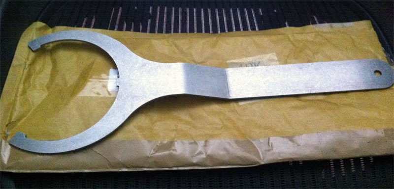

  1. Received this morning. It's huge! Still, all the easier to adjust the chain...and fits very nicely in the hand too. I'll give it a try with the instructions, as the chain needs adjusting. Thanks again Andy.

    (it's big - really big - size of your forearm big) wins the what's that big tool for ? Garage question hands down.

  11. Received yesterday - cheers Andy - can't help noticing it is a lot thinner than the mk1 version - any reason for that?
  12. Well even though the chain doesn't need adjusting, I had to try it on the hub.
    I can report back that it fits easily, once it's on there it is most definitely not slipping ( unlike that crappy c-spanner the bike came with ) so my knuckles can return to their former smoothness with no bits missing!
    Result!

  15. Ok, I've just been out adjusting the chain, and I have to say, this is a QUALITY tool. It makes adjusting the chain so easy, as if you go too tight, you turn one way, too loose, turn the other. This means you can fine tune it to exactly how you want it very very easily. The thickness/thinness, is perfect, and makes absolute sense because it allows you to slide it in between the rear sprocket and the adjuster. It is perfect. The length is also good, because you can get enough leverage, on what is often a 'sticky' adjuster.
    Ive not adjusted the chain that much on the Multi, but I have on many bikes in my time, and this was the EASIEST I have ever done.
    I also took Andy's instructions for both the new tool, and adjusting the chain....foolproof. Thanks Andy. Seriously, if you have never felt content to adjust the chain, or you are slightly unsure for whatever reason, get the instructions (see the link above) and just follow them.
    Andy, the only feedback I would give is that Ducati say that the chain should be adjusted on the side stand, which you do too, except then you go on to say its easier to adjust on the centre stand...which it is. HOWEVER, if you do this, the gauge that Ducati provide isn't correct....if you adjust it to the correct position on the side stand, when you pop it on the centre stand, then chain will look loose. Therefore, if you adjust it to what looks like the 'correct' position when on the centre stand, when you put it onto the side stand, the chain will be too tight. ....just a point worth noting, so that you don't end up with a too tight chain.
    Other than that, top marks. Quality instructions, and a quality too.
    Thanks very very much Andy. :upyeah:

  20. Thanks everyone for the feedback (don't forget Don's [chickenman] role in the tool coming into being :wink: ......I have a 'concept to reality' article roughed out but just not had time to finish......trouble is [one of anyway!] I've actually started riding my bike again!!!)
    David/Don.......good points re the centre stand (or paddock stand) vs side stand method of checking the chain tension, I will add an update for the chain adjusting 'how to' article to my to do list! :) It is important to check chain tension at the tightest point of the chain and checks on the centre stand / a paddock stand make several checks along the chain length easy.
    David's comment above re sliding the tool between the rear sprocket/chain and the hub adjuster ring is the answer.....any thicker and you wouldn't be able to slide your tool in! :cool:
    (not an issue with the MK1 as it engages from above/below the hub)
