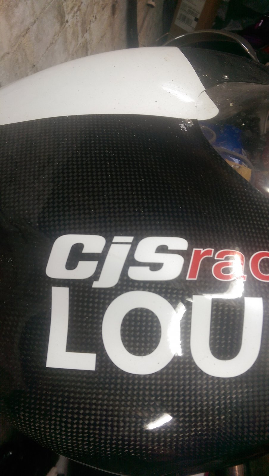

    The top fairing with screen weighed in at about 1700g (i couldn't really balance it well on the scale)
    The bottom fairing was 972g with dzus fittings in place.
    The seat with standard solo seat and fittings weighed 1840g

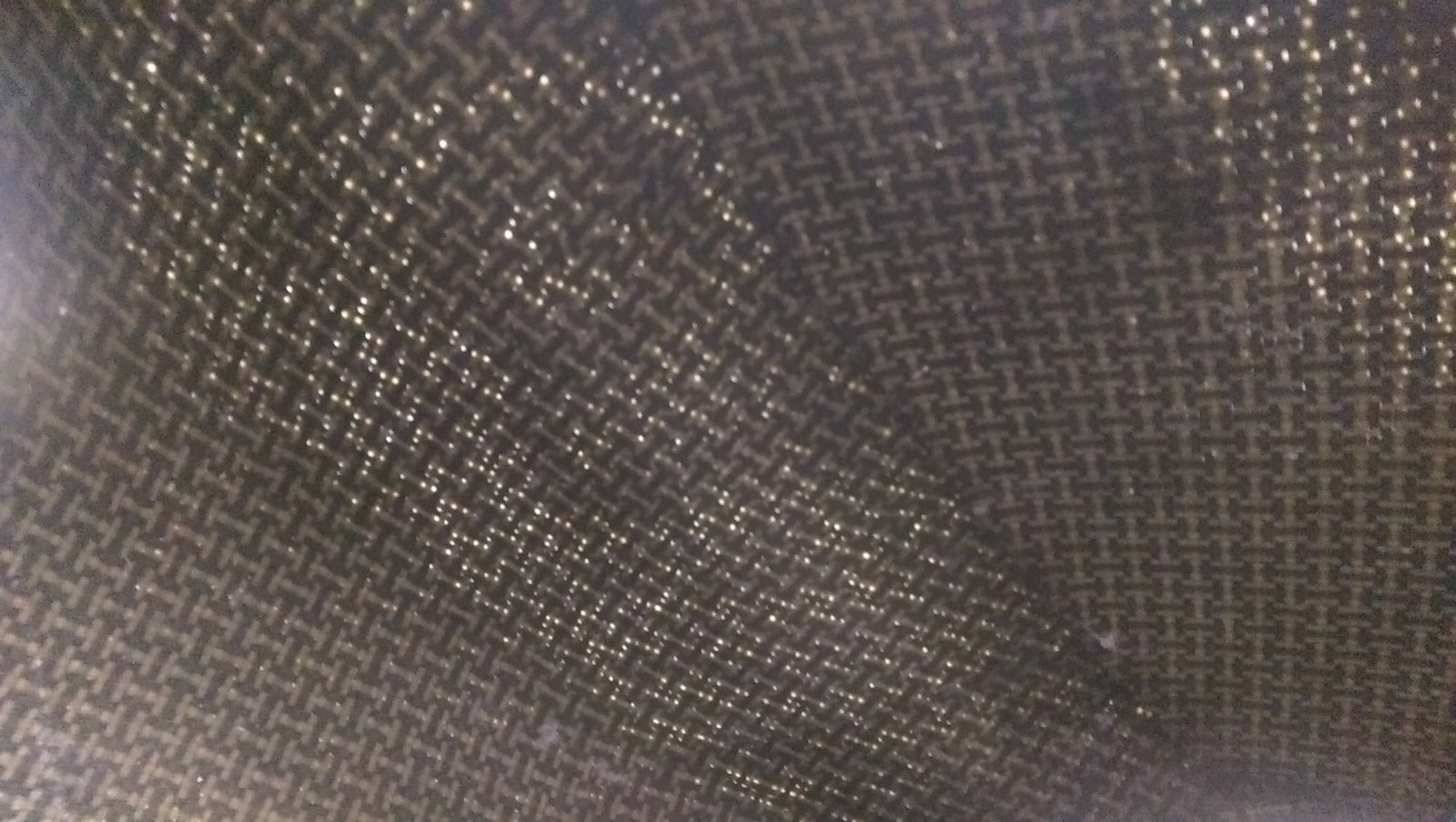

    This is how thin it is.
    With the opposite side being this.
    All the dots are dust as it's hanging up in a dust bowl of a garage.
