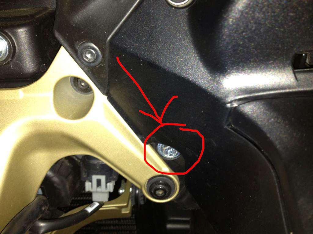

  4. Are these the two gold-ish cross head screws at the back of the lights?

  7. I was referring to the screws that adjust the headlamps vertically (up/down), these are black not gold. They are near a gold frame but not the ones connected to the gold frame. I can post a photo if your stuck, I know I was for a bit, not been a 10 minute job for me. I used a 8mm socket actually rather than a screw driver.

  14. Photo appreciated Chainsaw :)
    That's the blighter, clockwise to move beam down, this is the left hand side from behind, similarly on right hand side.
    HTH
  16. Chainsaw, you've not got a 2013 model? My 2013 model, Philips screws seem to be in a different place
    Seems to me that this is the adjuster on the 2013. I'll try it tomorrow night
