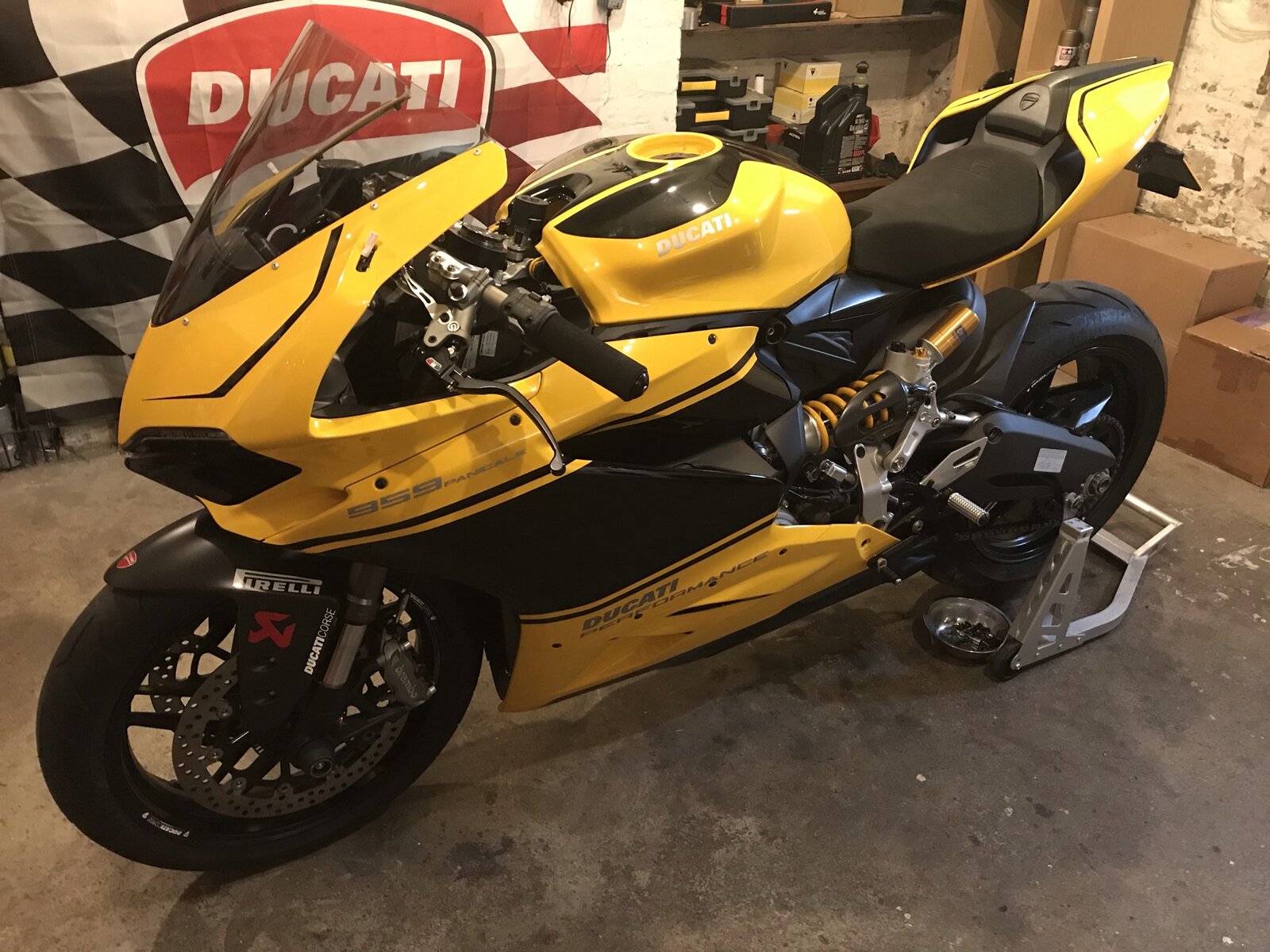

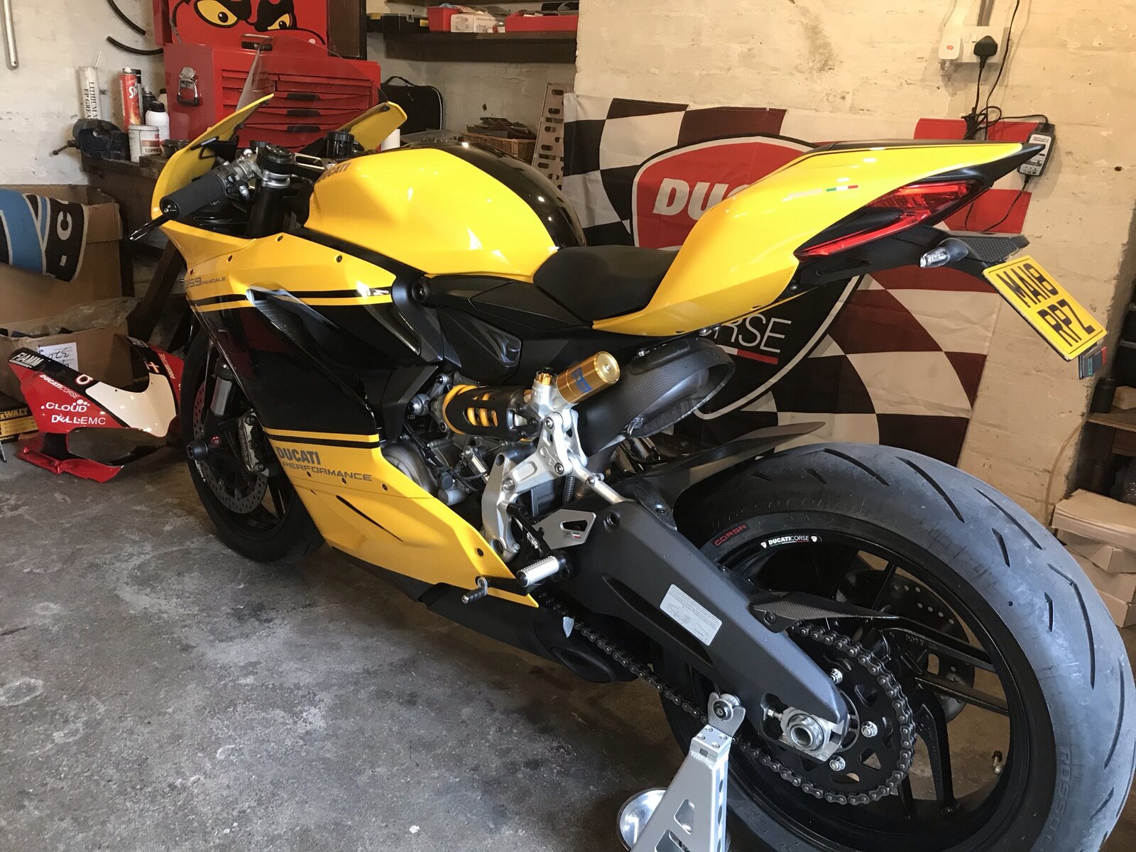

  10. Picked up these new panels and tank yesterday from Moto Rápido. Won them for a very decent price on eBay. Just waiting for the fuel pump gasket set to arrive and then I can finish it off. While at MR, I spoke with Wilf and he’s prepping a modified 1299 ecu to suit the 1299 electronics I fitted so the bike should then be complete or at least until next winter’s mods start coming in. :)
    These were commissioned by Ducati UK for their 959 show bike and was called Xerox and I’m made up with them. :)

  11. looks stunning mate, keep the double sided swing arm and get a set of dymag wheels in there.
  12. Cheers Cooky. Yep, wheels next.
  13. He needs my BST rear, he does:p
  14. "I'm not modding this one"....:D
    Love it mate, looks great!
    #134 Nelson, Apr 24, 2021
  15. Cheers Gaz. You know me, I can’t leave well alone. :)
  16. It only took you days to start the madness mate. Good effort :)
  17. Loving the yellow
