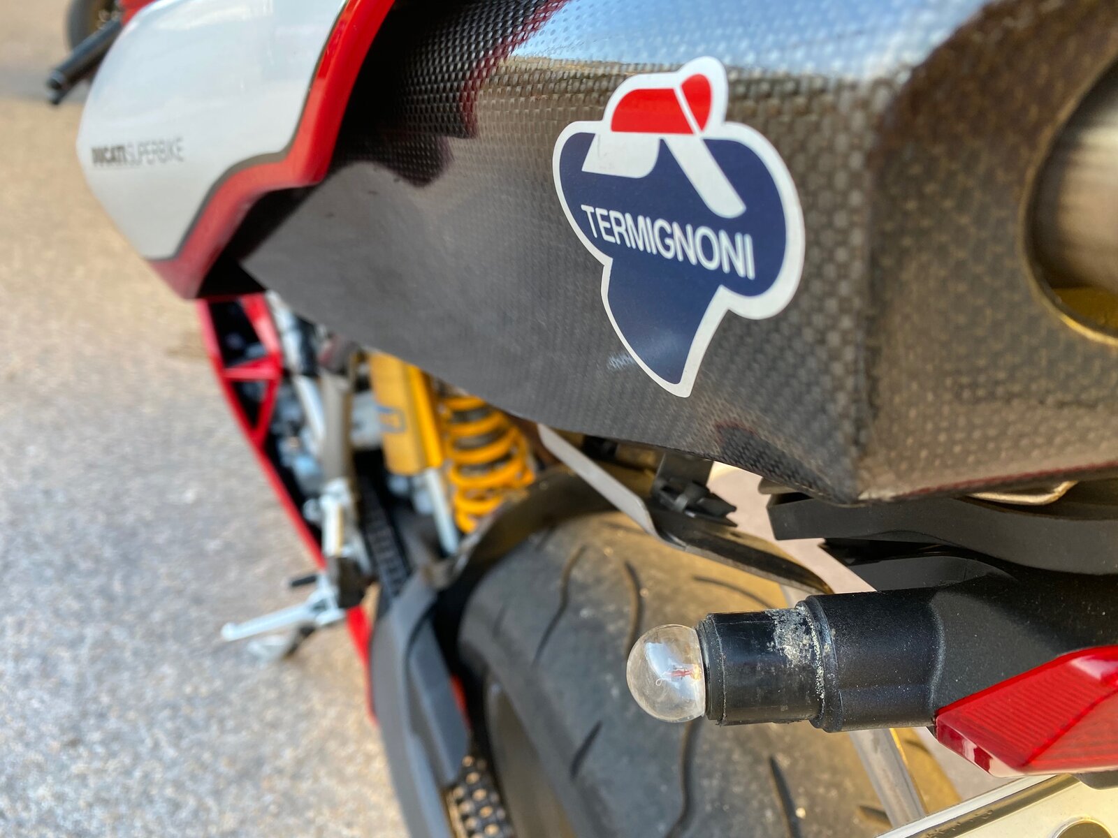

  2. Valentina is now at the stealer for the belt change and whatever else they can (reasonably) find....
    First casualty of the day is an indicator lens that went "weeeeeee" on the way there this morning, +£30 on the bill :)

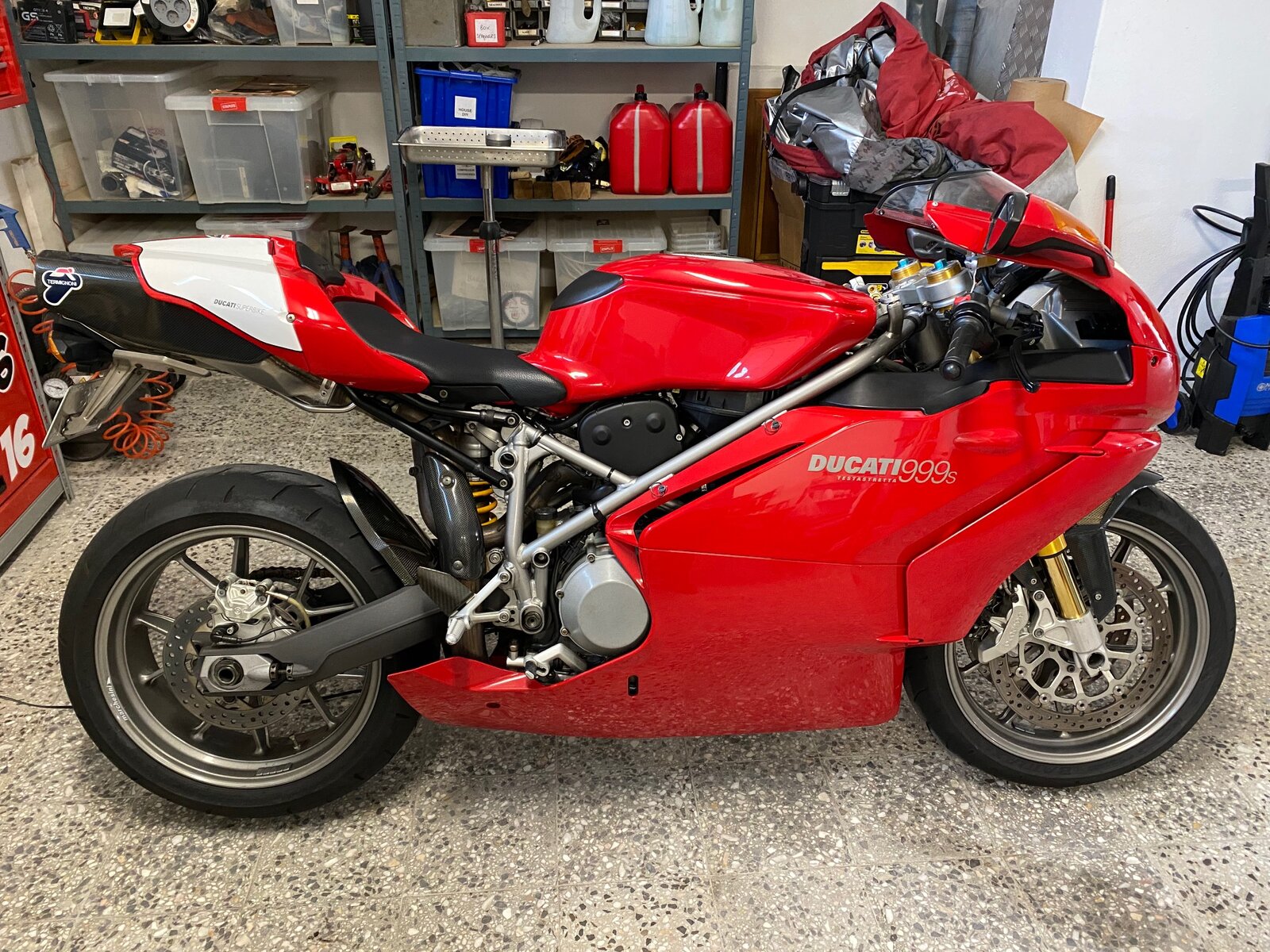

  7. Finally pick Valentina up from the dealer and to my surprise it wasn't as expensive as I was expecting, they did:
    • Belt change
    • TPS adjustment
    • Rear wheel bearing change
    I finally had a chance to open her up on the way back home and many fond memories of my old S4R with an open top airbox came flowing back. This makes everyone feel like Fogarty. That intake snort and the vee-twin sound, lovely!
    So after a better than down the road ride with the 999s and even though the TPS has been done, it still sometimes stalls when on idle. This happens when I give it a bit of throttle on idle and is sometimes accompanied by a backfire (my ears say horizontal cylinder) which feels as if its coming from intake and not exhaust.
    Any thoughts?

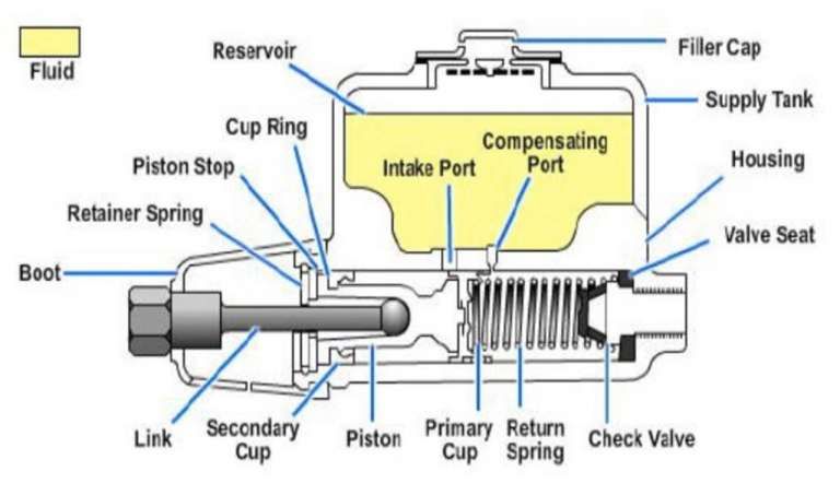

  20. Check that your lever has enough free play. If the compensating channel (compensating port in the pic) from piston bore to reservoir is blocked the expanding fluid will eventually push the slave piston out a bit and cause slipping.
