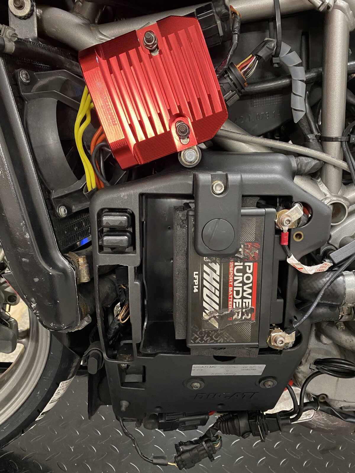

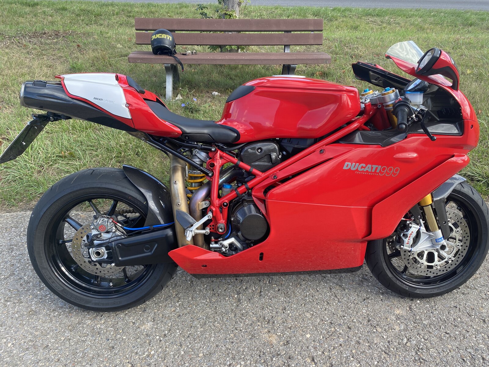

Finally got round to re-fitting the fairings as the front forks were off being serviced and Ohlins parts took ages to come through. Turns out the huge MOSFET R/R, in the position I thought would be ok, isn't. Wouldn't allow the fairing to get close enough to the frame so that it would find its place down in by the radiator. Found a new spot for it using the upper battery box mounting hole and a quickly made brakcet: Also fitted new Dunlop Sportsmart 3 rubber (120/70 + 180/60)....now just need for it to stop raining outside!

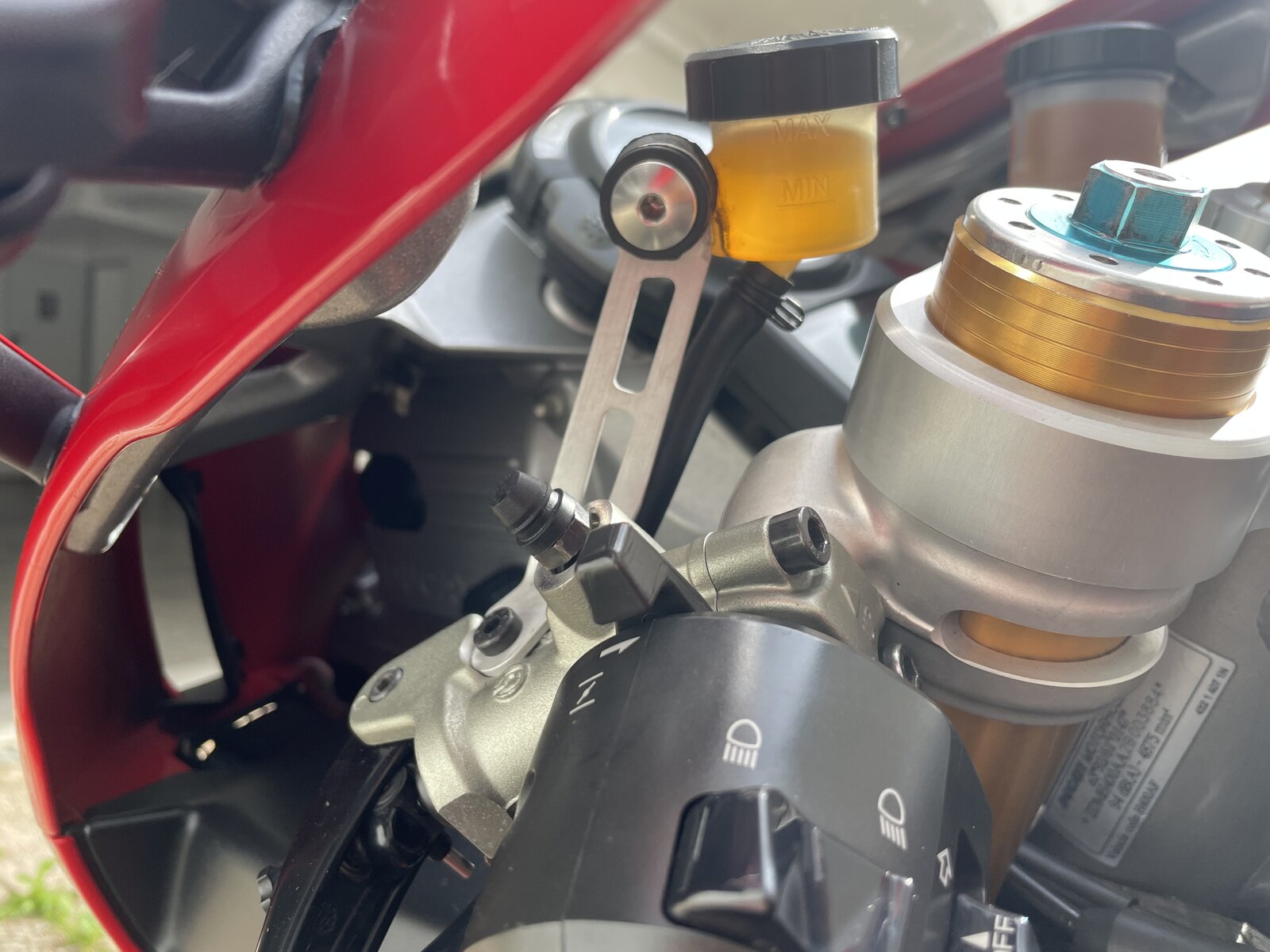

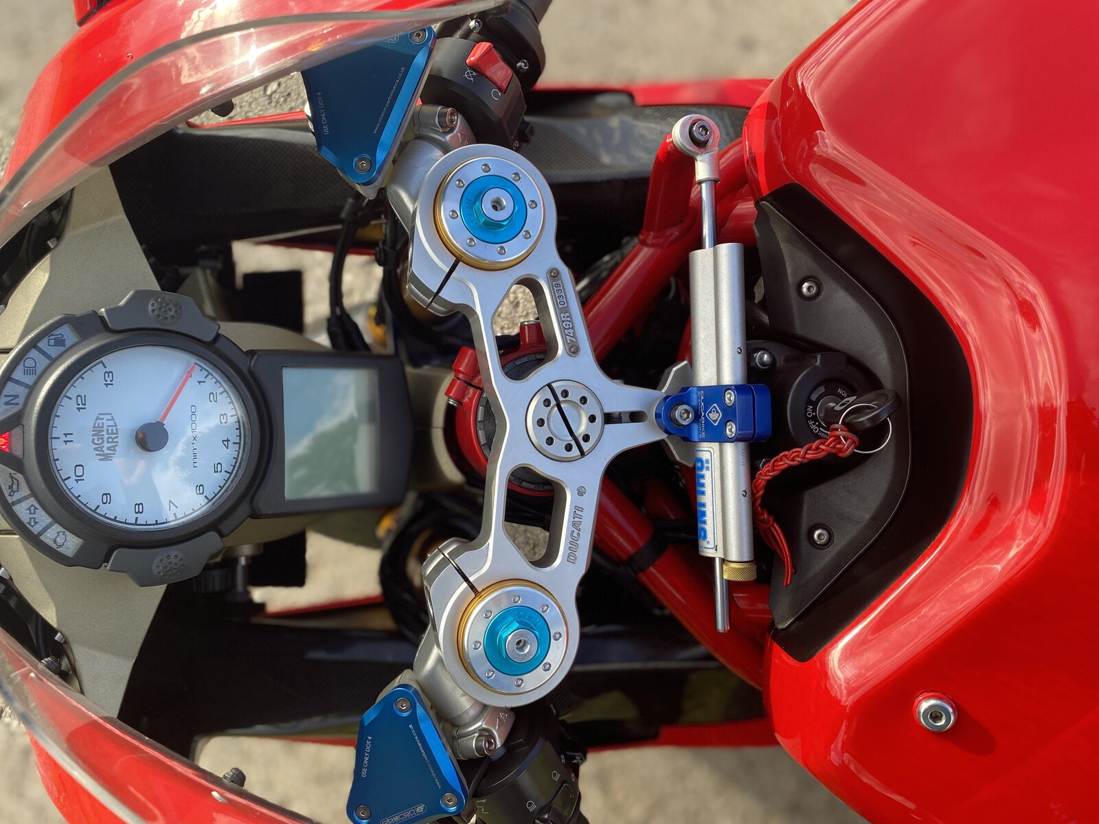

1098 clutch master has been bolted onto Valentina but rain and cold are preventing a thorough testing Meanwhile I fitted a Brembo reservoir mounting kit for the 19RCS which I've posted in another thread as its universal for any 749/999: https://www.ducatiforum.co.uk/threads/brembo-brake-reservoir-kit-on-19rcs.83543/

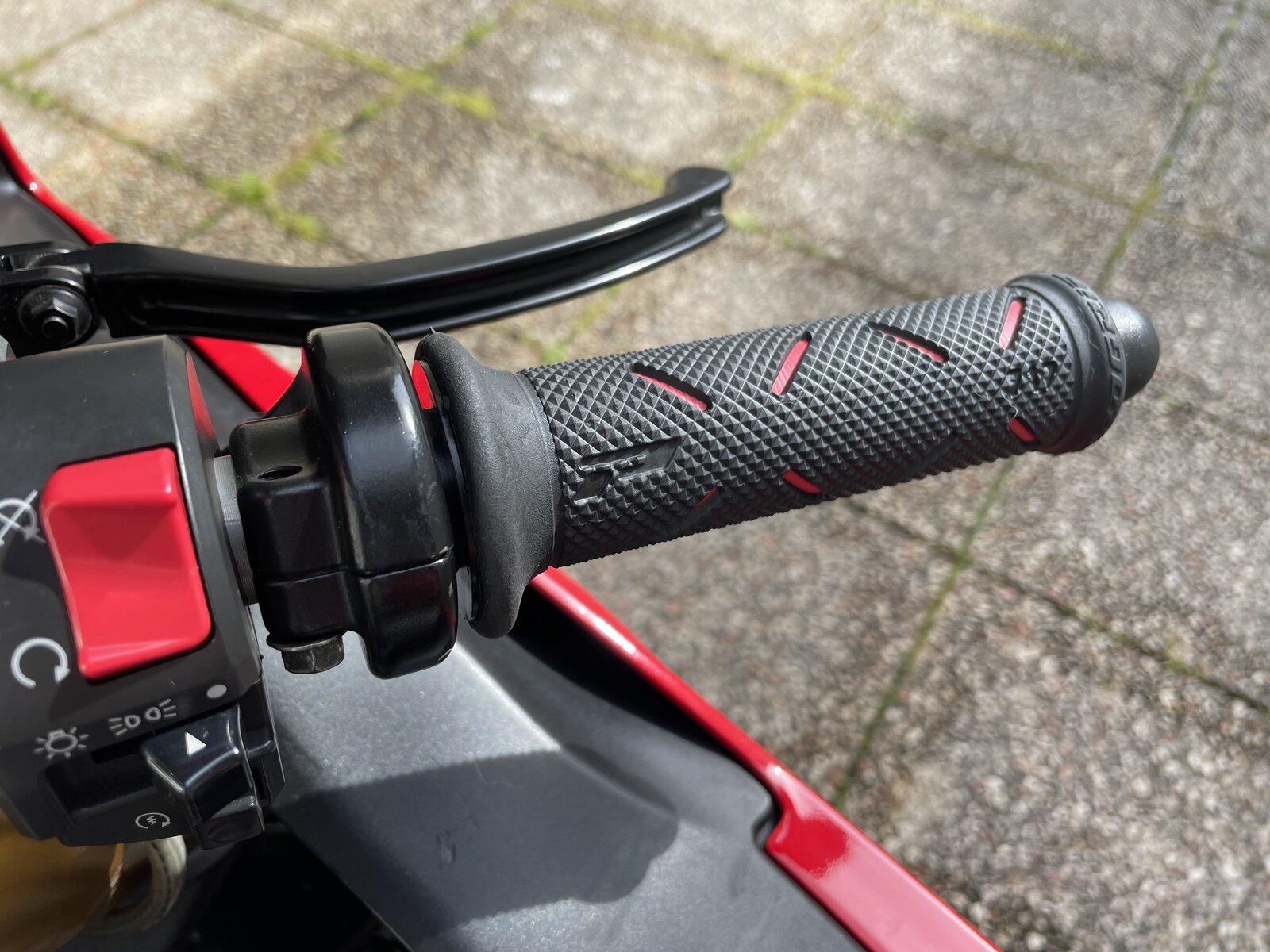

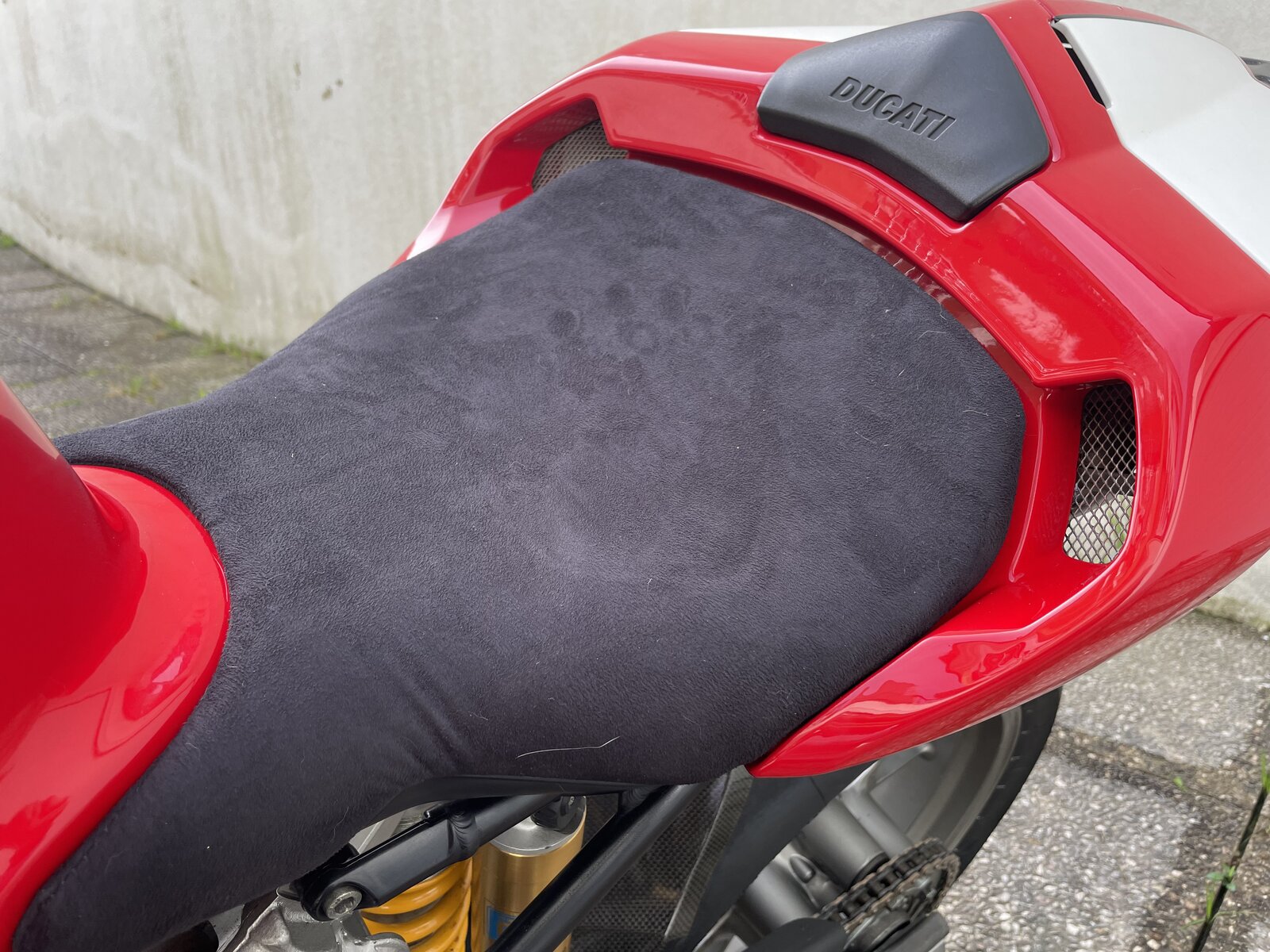

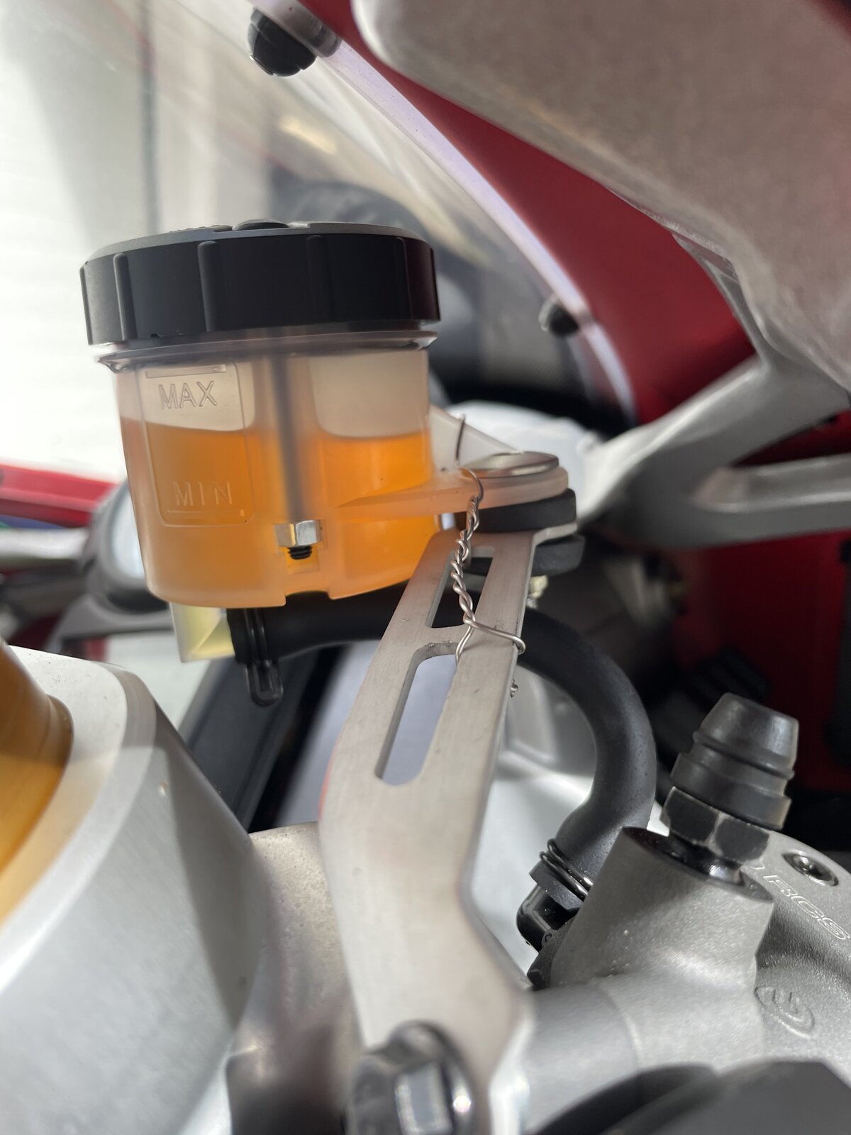

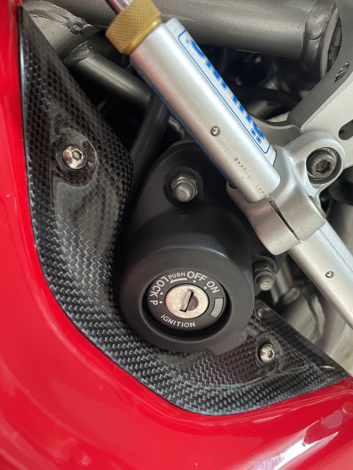

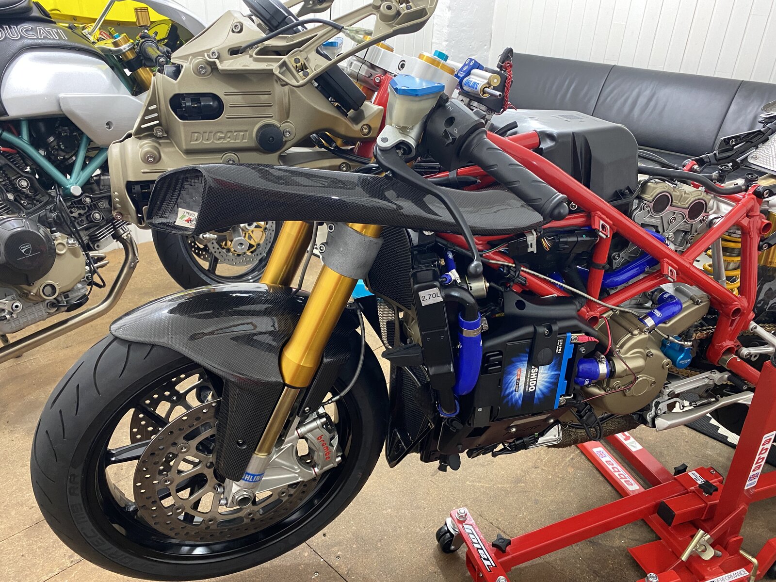

Quick update as I'm waiting for the weather to play nice! Ducati 848 Clutch M/C fitted: Tidied up the lockwire to hold the reservoir close to the Brembo brake kit: Spare seat covered in Alcantara: R1 throttle tube and new grips fitted: More carbon! :
After all the crap weather we've been having over here and despite curfew restrictions, I've finally managed a short 15min ride on the bike. Clutch issue is fixed and I'm putting it down to the 848 master cylinder, no issues whatsoever now!
