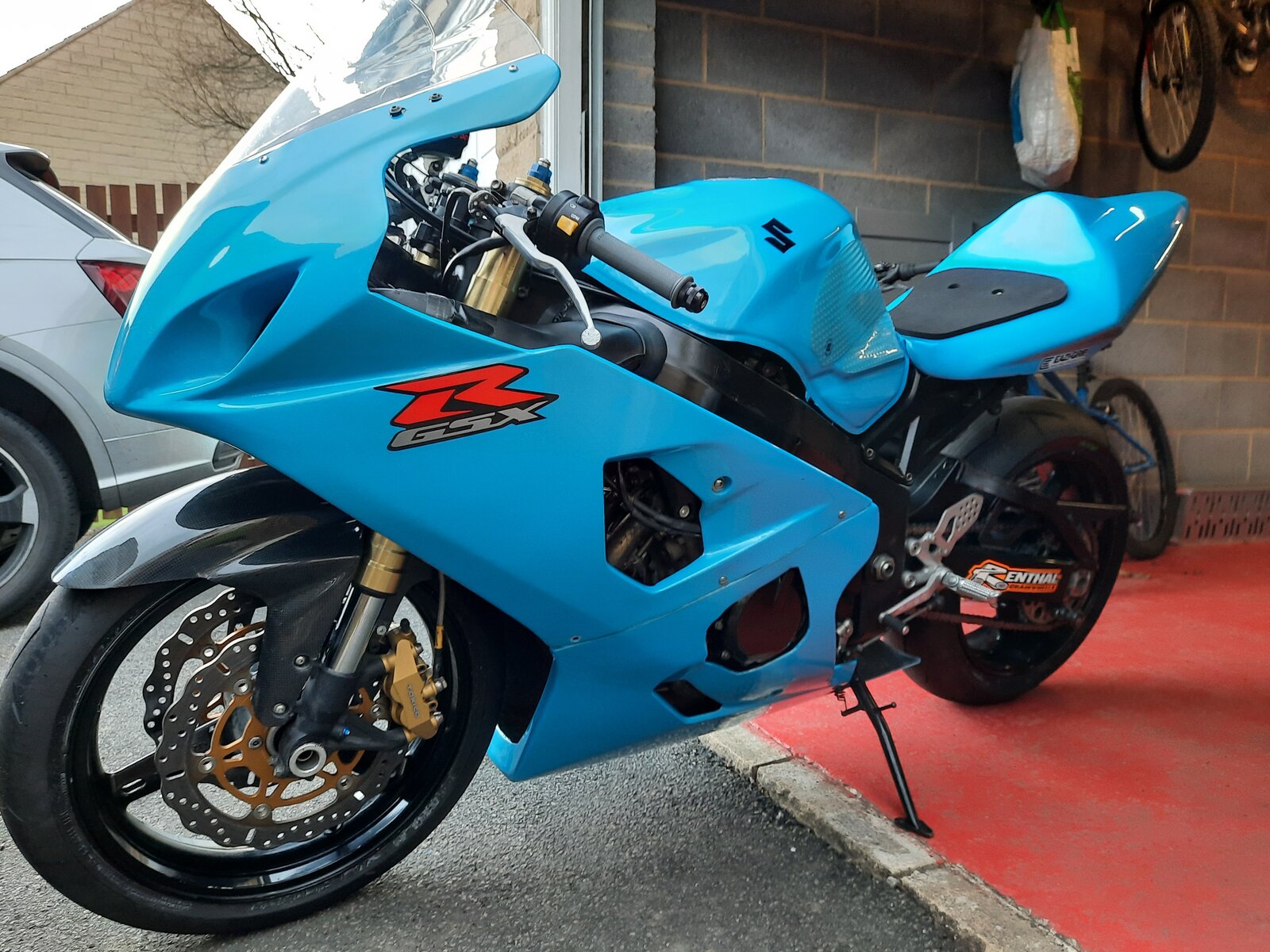

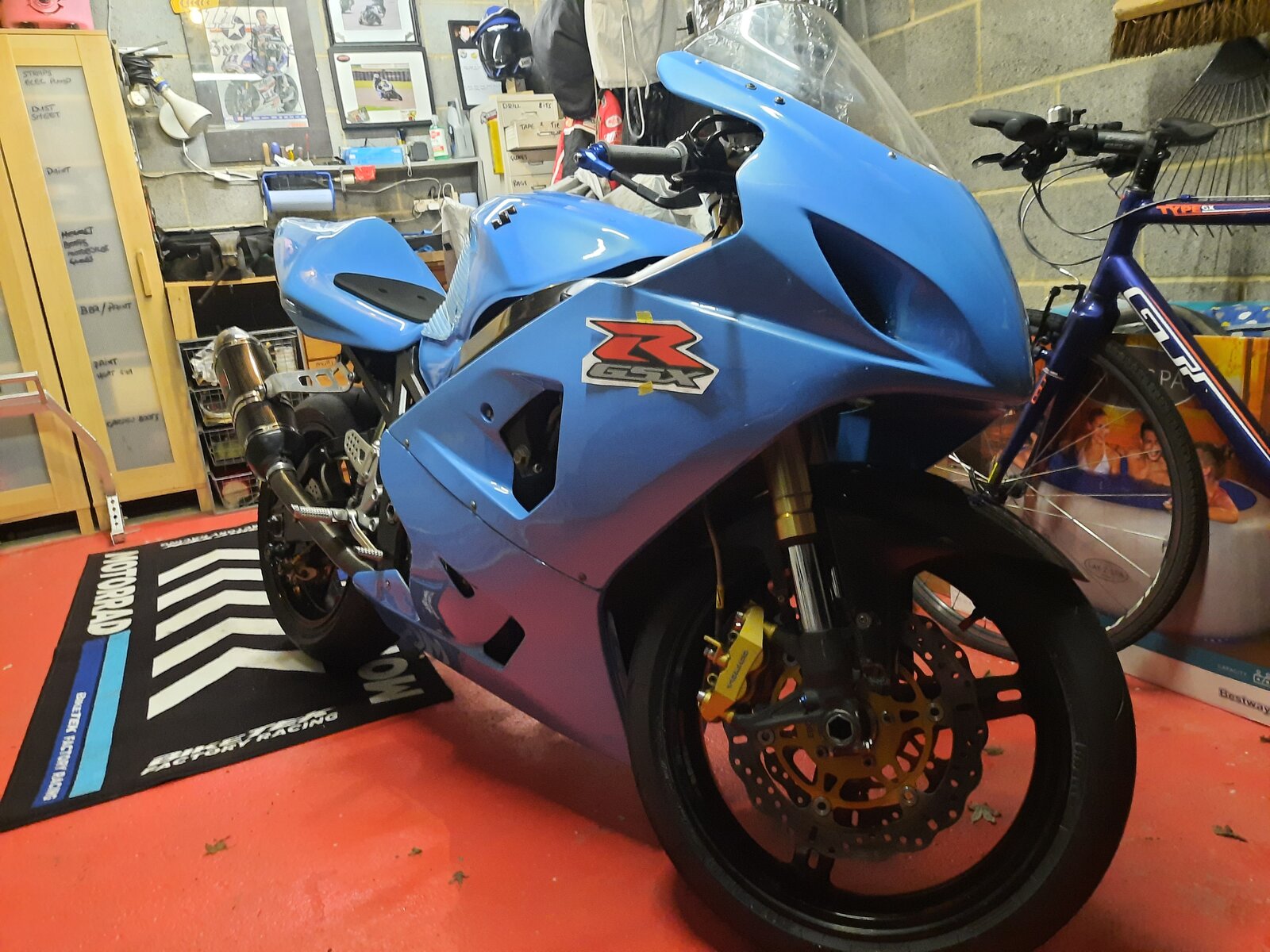

  1. Fairings all.on well that's just about it after 5 months of playing in the garage, time we'll spent. Will post up some better pics over the weekend in the day light.

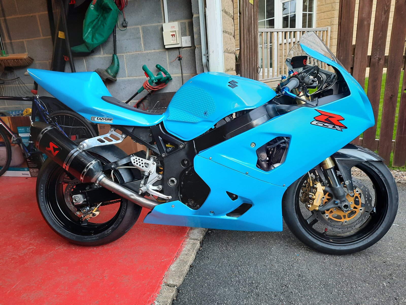

  4. Some better pics in the daylight,really happy with how it's turned out, and enjoyed doing it too..

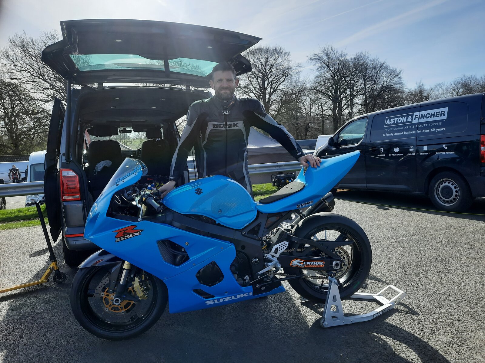

  5. Well took the trackbiie k4 750 build out at cadwell Park yesterday, The bike performed fantastic apart from the front brake lever bolt vibrating loose and coming out to my horror at the end of the start/finish straight. So I took evasive action and took to the grass for what felt like a mile got the bike stopped and composed myself.
    With the help of the paddock we found a bolt amd I was back out in the next session. Note to self lock wire front brake lever bolt..and do lots more pre checks.
