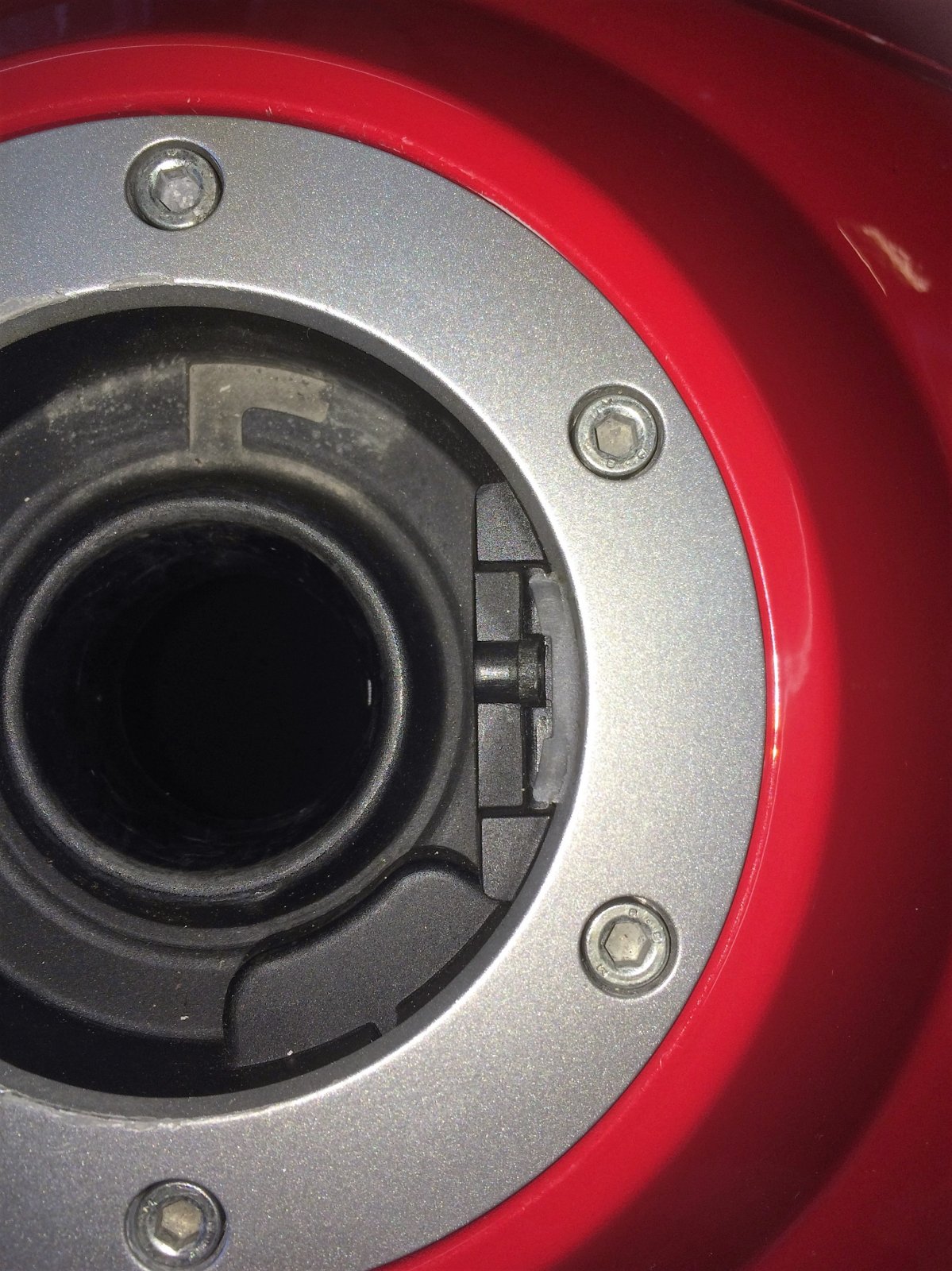

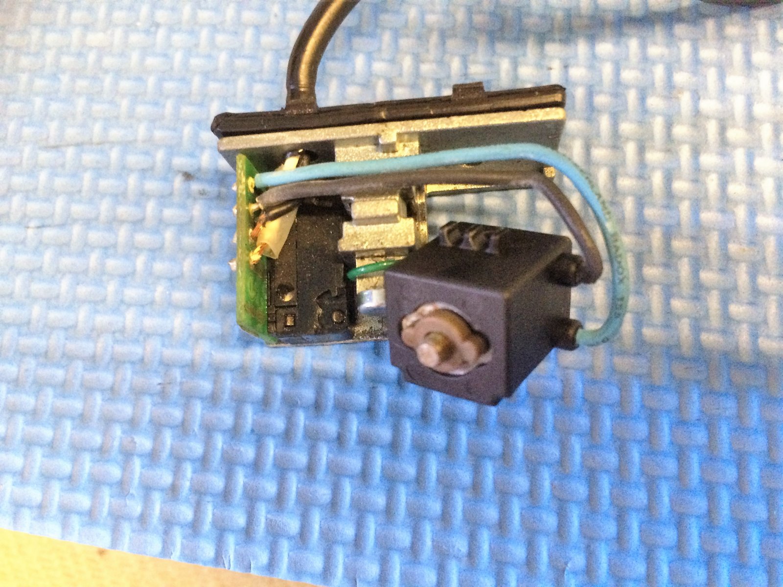

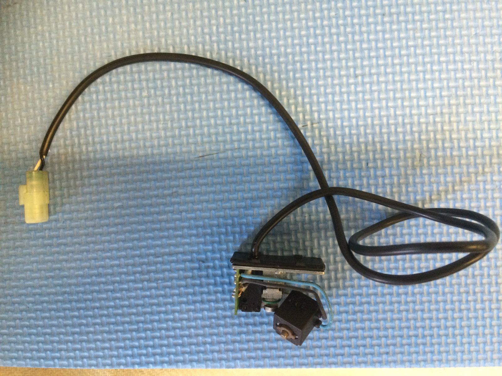

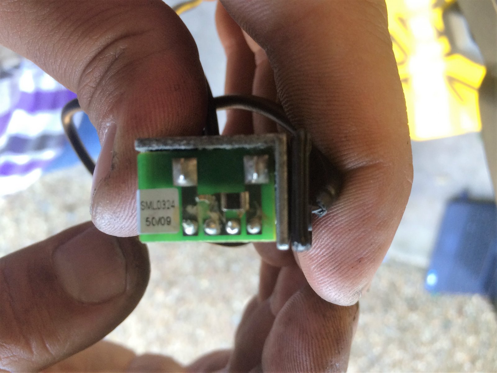

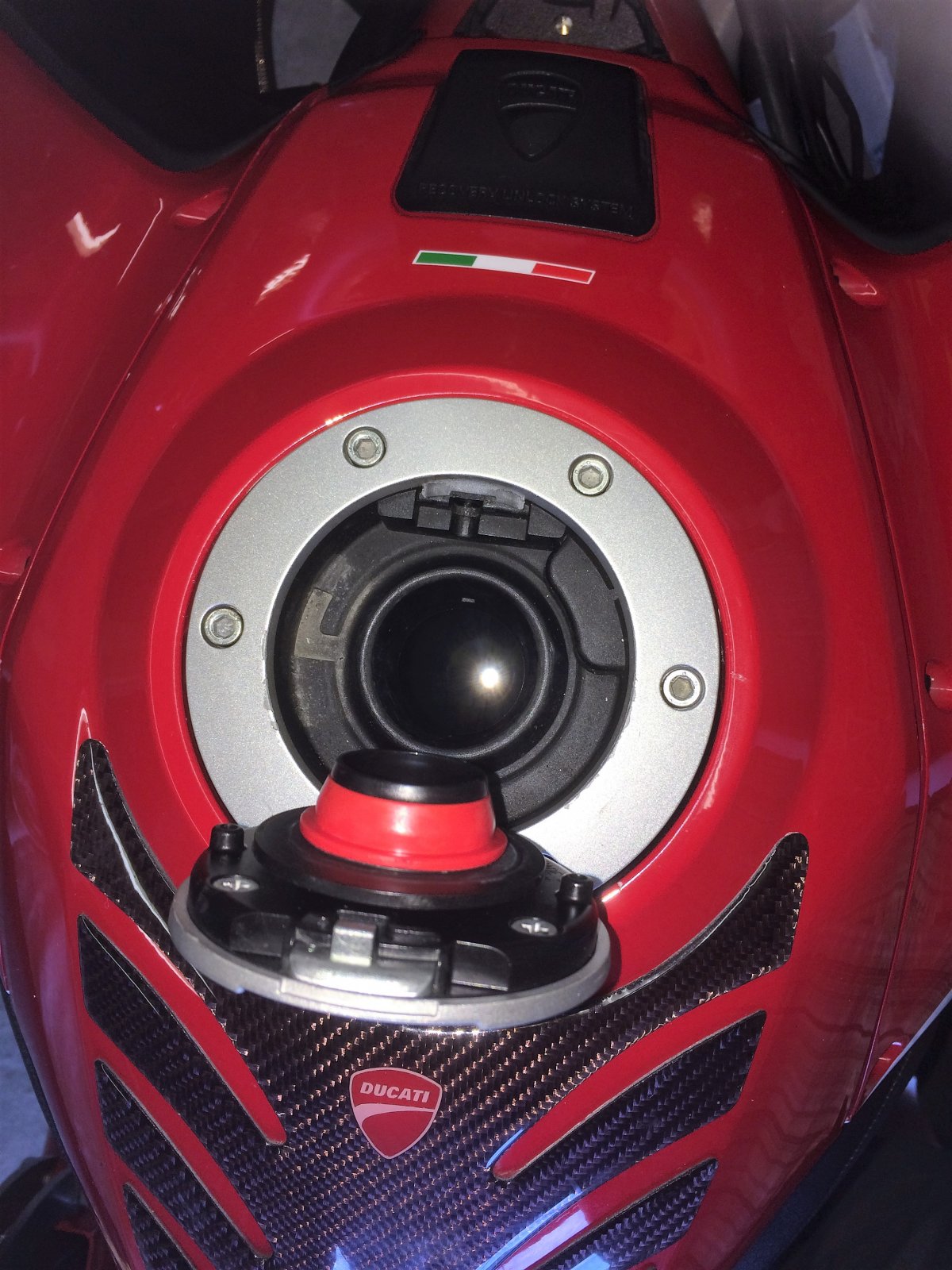

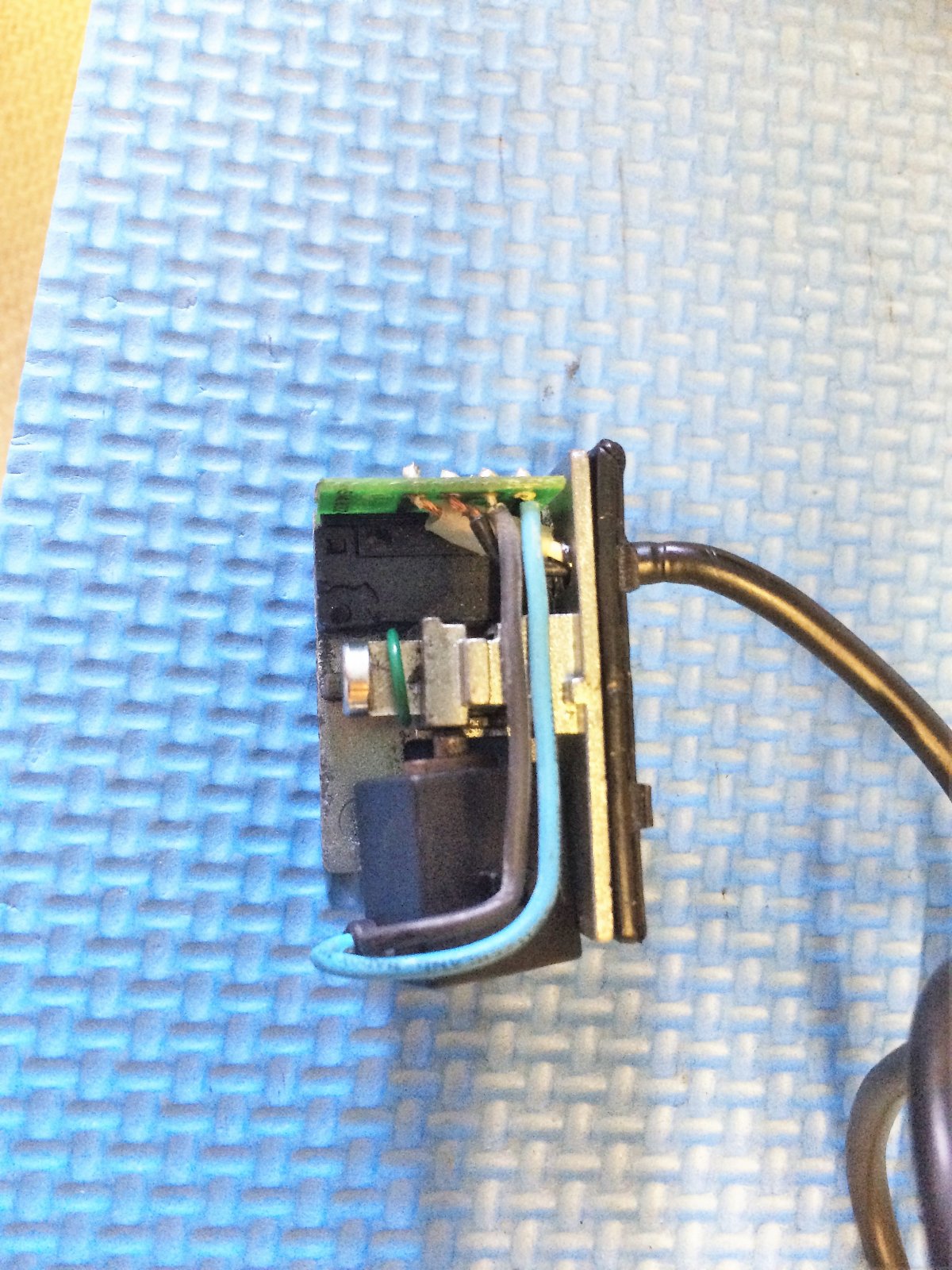

  6. Just had a fun afternoon taking the bodywork and fuel cap off my 2012 Pikes Peak after the keyless cap refused to open. We tried disconnecting and reconnecting the 2 pin connector but that had no effect. Had 4.9v at the connector when the ignition was switched but the Solenoid that releases the locking pin was refusing to activate. Solenoid worked fine when we put 12v across it, so it seems as though the feed to the solenoid wasn't of sufficiently high voltage to activate it, possibly a fault with one of the ECUs with a price tag of hundreds of pounds to replace! Turns out that you can remove the solenoid from the fuel cap and have a functioning but unlockable fuel cap for no money, so went that way instead...attached photographs show the solenoid removed, the unit separated to show the solenoid, and the resulting appearance of the filler cap with locking mechanism removed.
    All done by Glen of Moto-V in Colchester, the man is an absolute star, strongly recommend him to anyone who wants to trust the person they are handing their pride and joy to!

  11. Quick update, the 4.9v feed to the filler cap solenoid was the correct voltage, just the solenoid itself on the blink with an intermittent fault. Sticking with the 'closed but not locked' approach and leaving the solenoid in the bin. Actually filled up with zero stress yesterday :grinning:
