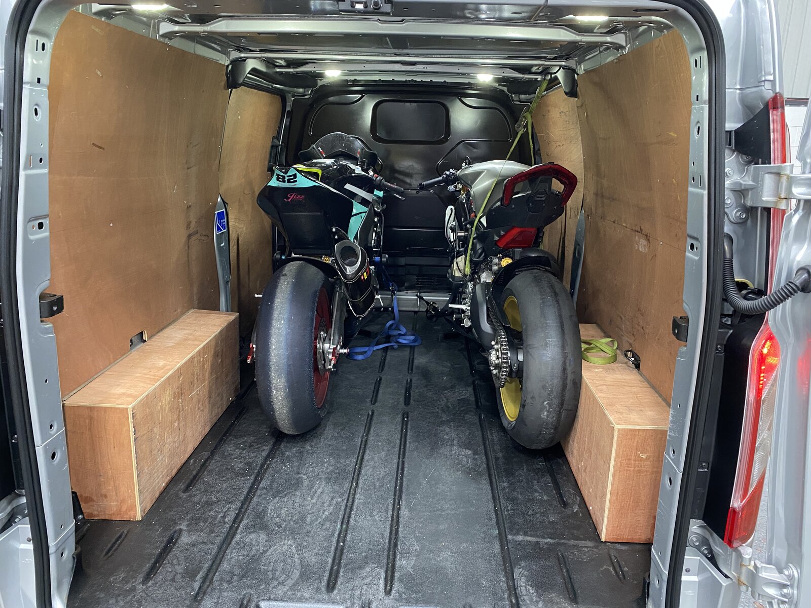

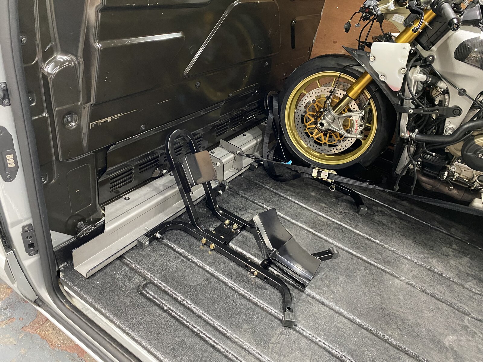

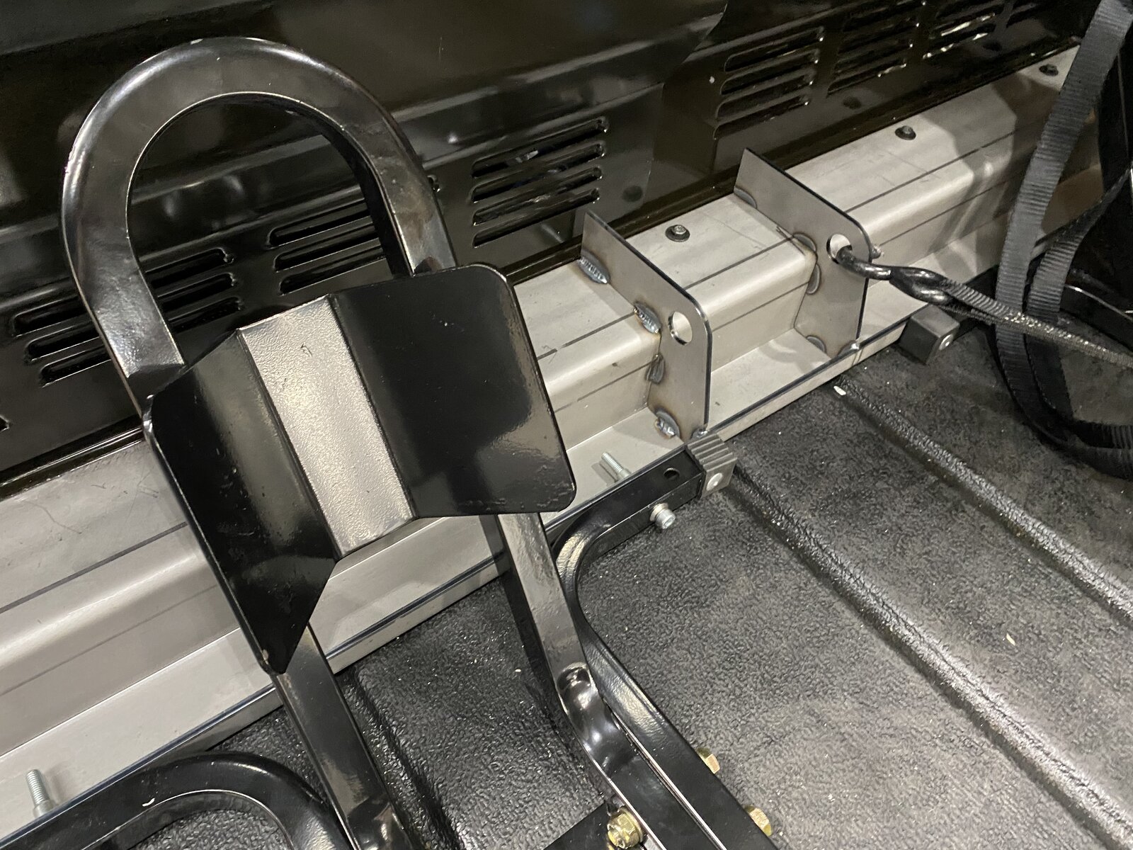

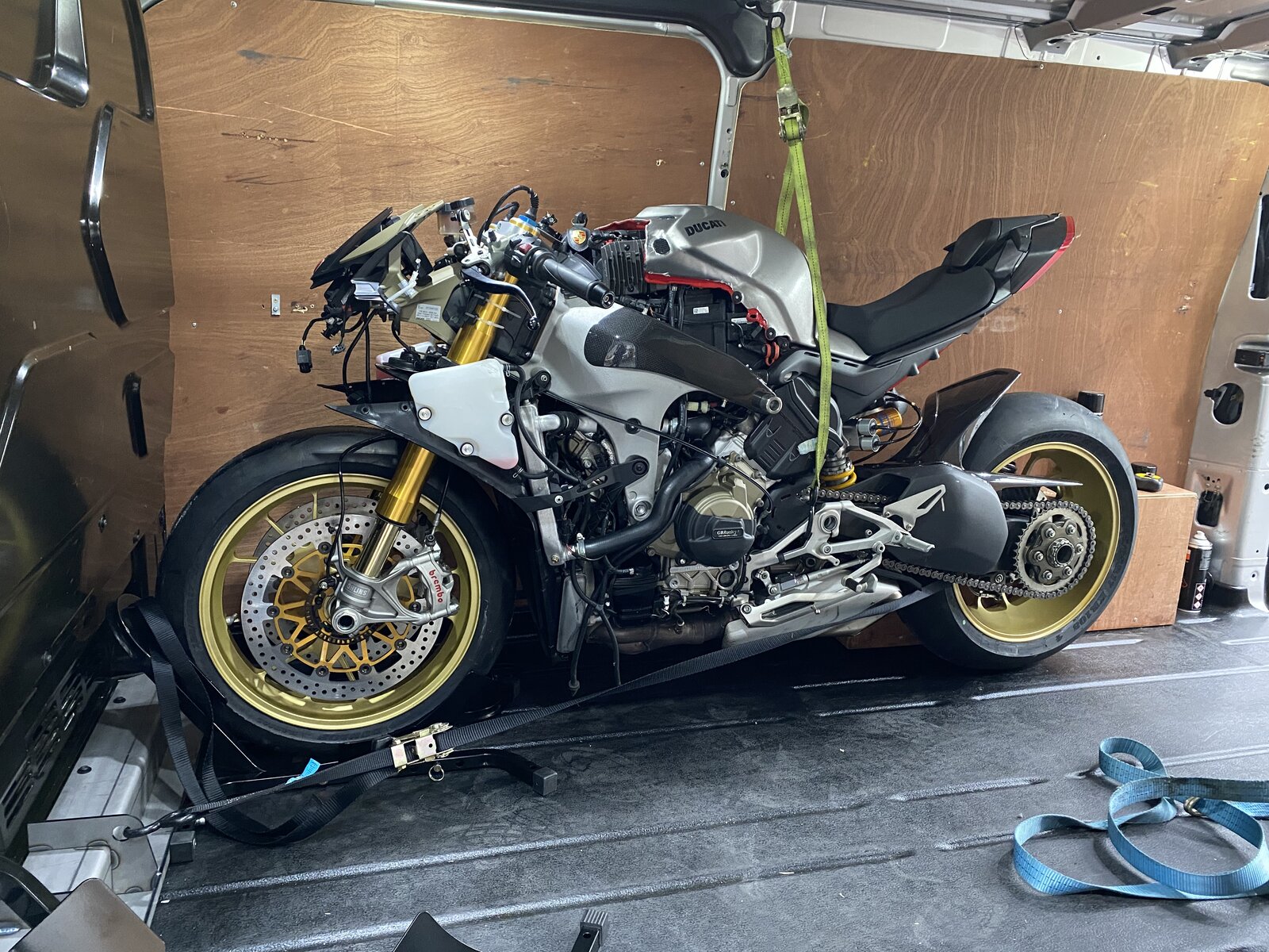

  9. Went into work today to have a play around with van setup. Wasn’t happy with just having the front stand loose, and remembered I run a fabrication company!
    So designed a bracket, fired up the laser to cut it, folded and welded some gussets in with extra fixing points (my mate did the welding!). Planned it so the stands bolted to the upstand which hold them solid, but they can come out with 4 bolts in 2 minutes to clear the back.
    Loaded the bikes up and went for a quick spin and works flawlessly, really happy!
    The van is awesome in general too!
