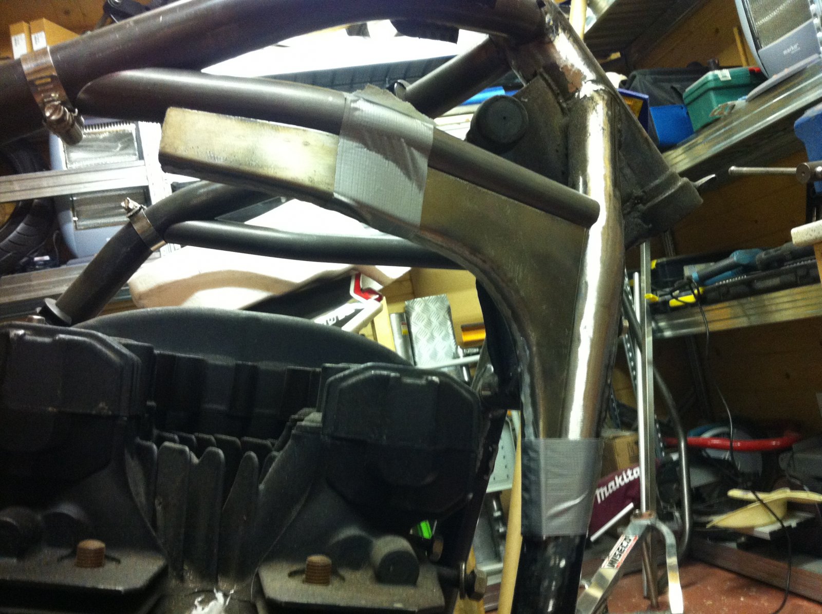

  4. Just finished another hard hand bashing bit - RH Frame brace (box section on this side made from two flat plates which will be seam welded down the centre), glued together and taped for now, finished the rear piece too while it was in position. Just the foot-peg mounts and seat supports to do now I think, then over to Hull for welding!
    This will be the modified version of the bike so will do the seat mounts slightly higher than standard - these bikes were sooo low on seat height!

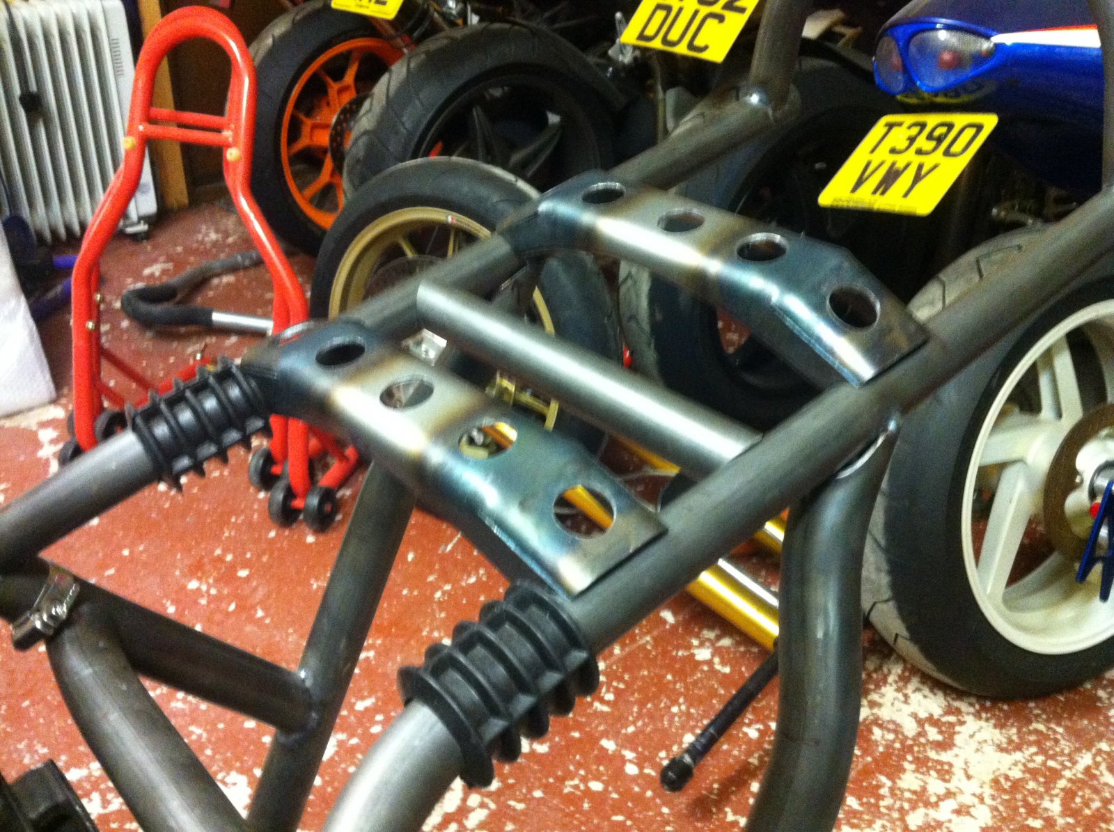

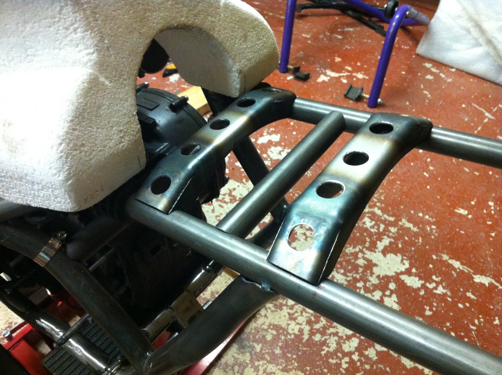

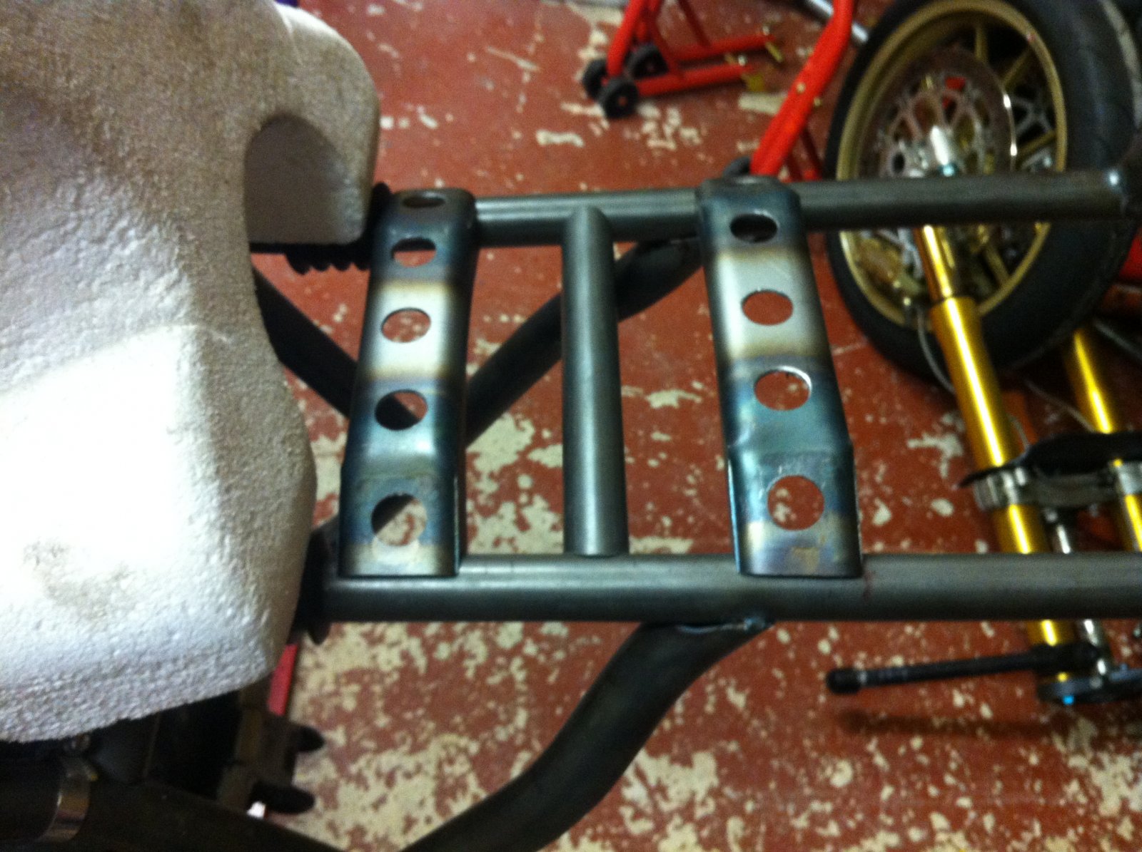

  5. Seat supports proved more difficult having decided to raise the seat height approx. 1" on the 'modern version' of the KR but tonight they are finished ready for welding :Happy:

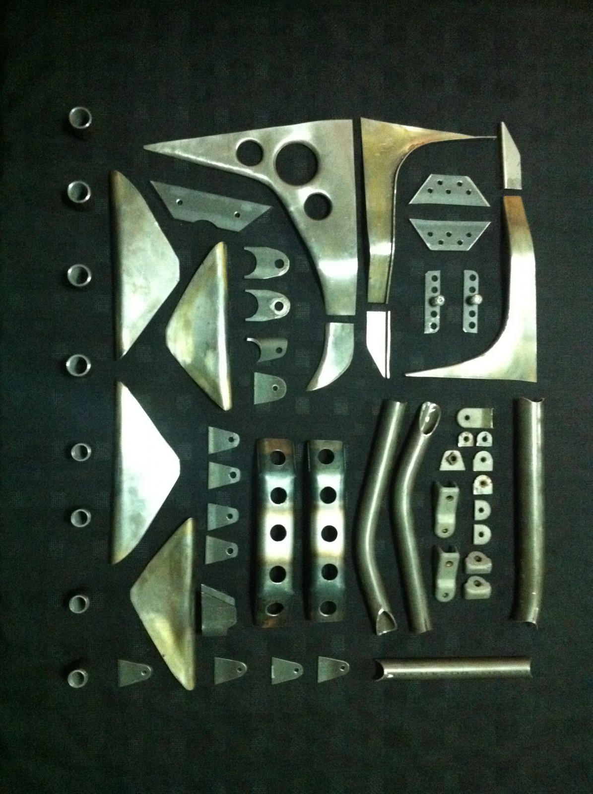

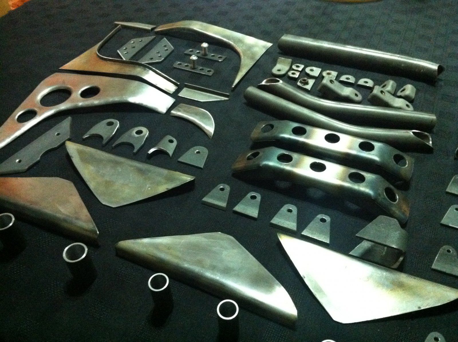

  13. Is it a Transformer,
  14. I'm trying to make it transform into something with me ammer :)
  15. It transforms into Ducbird i know what your up to,:D
    Looking a great job:upyeah:
