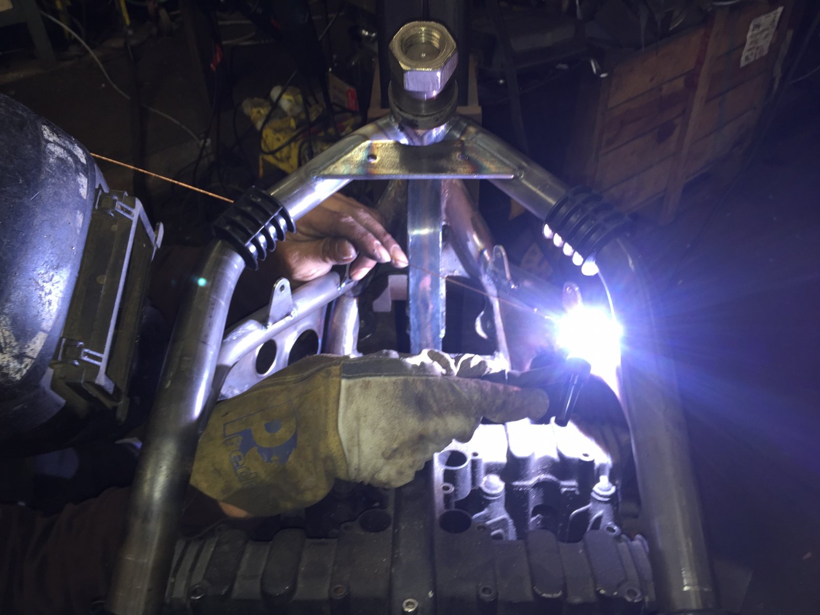

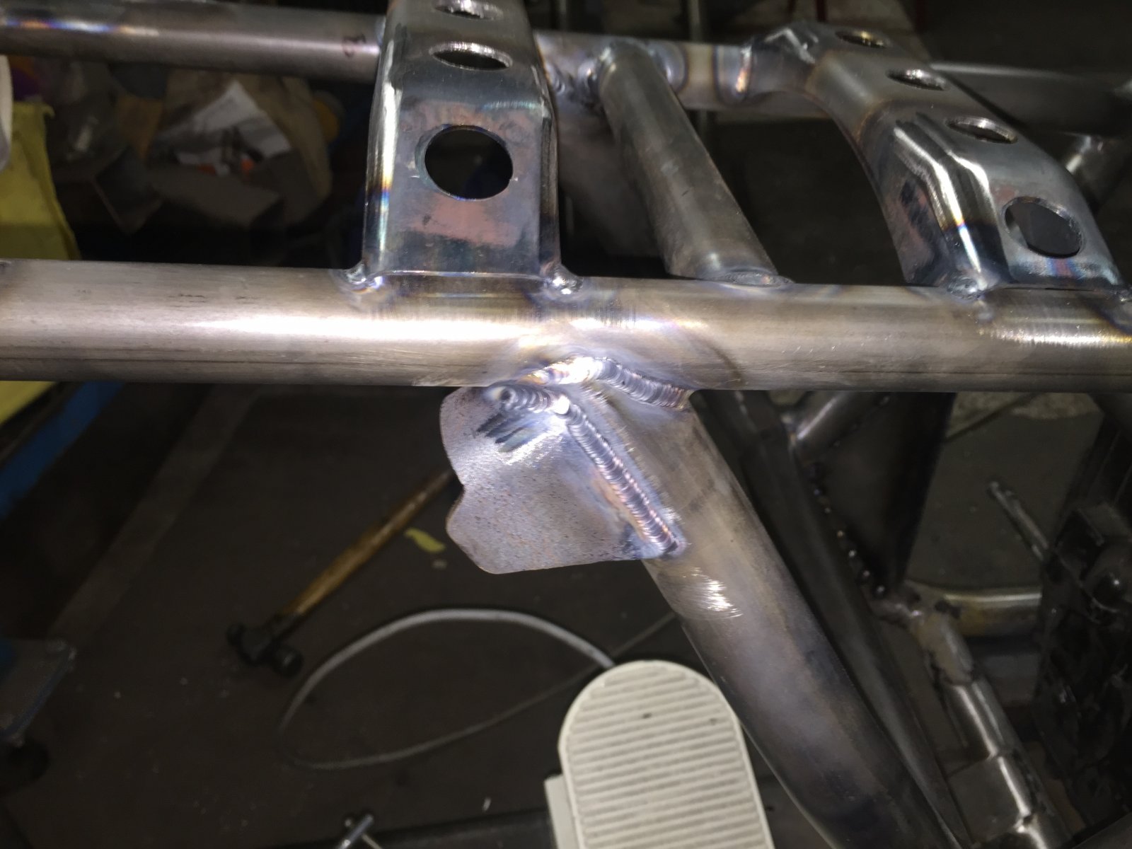

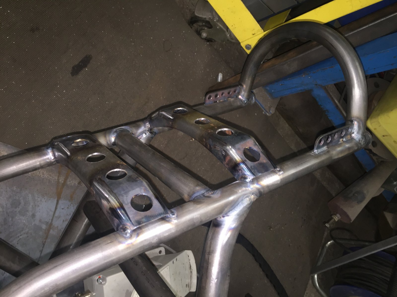

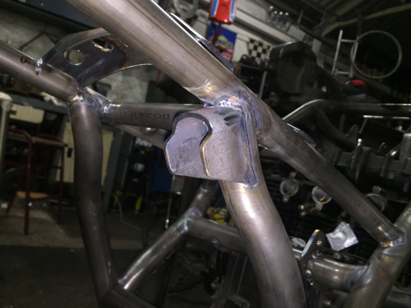

  1. Well, another excellent day of progress, coffee and tabs at RCV4's magical welding emporium yesterday :)
    First the seat supports and a lot more welding from the previous week tacking...

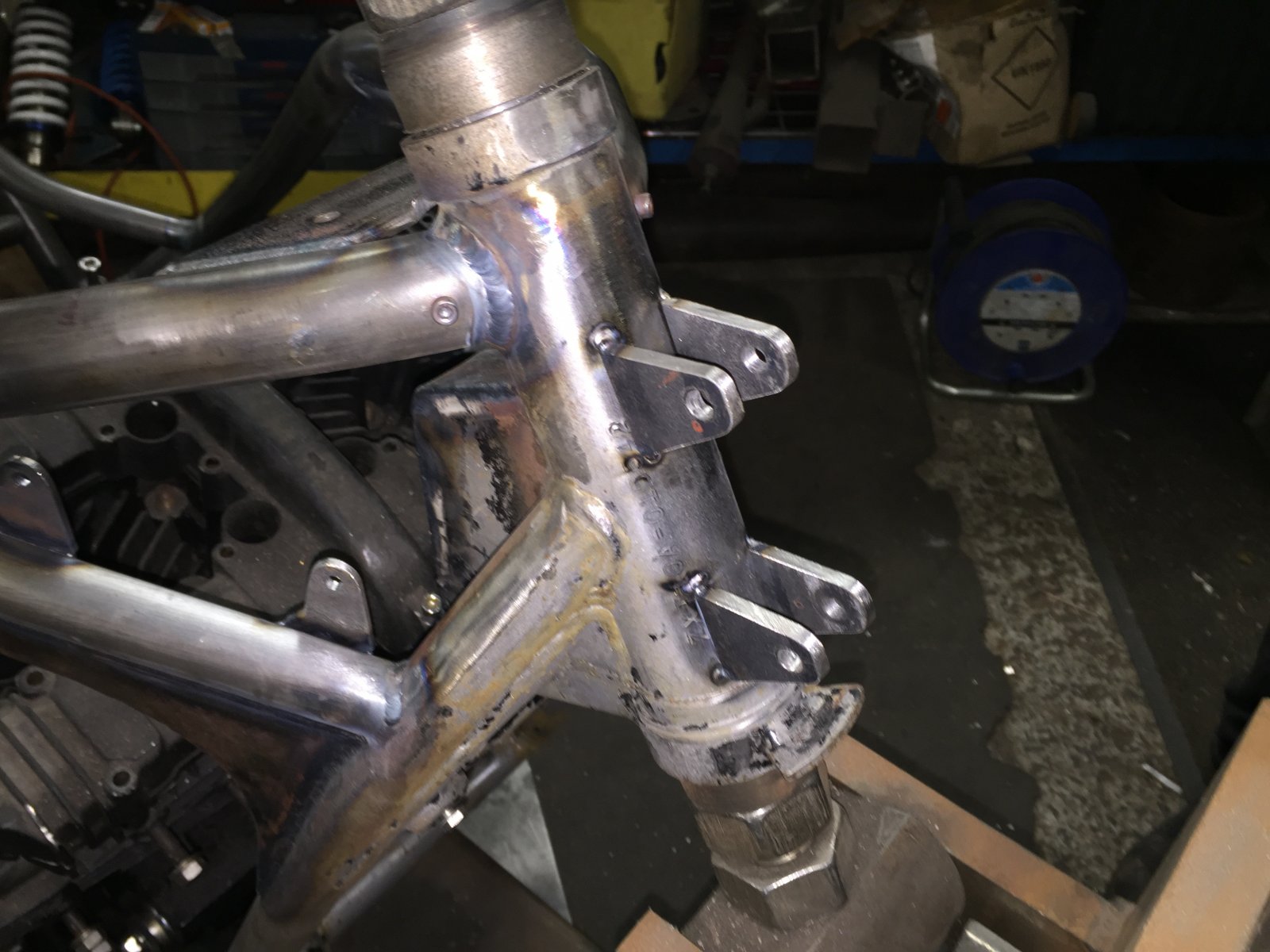

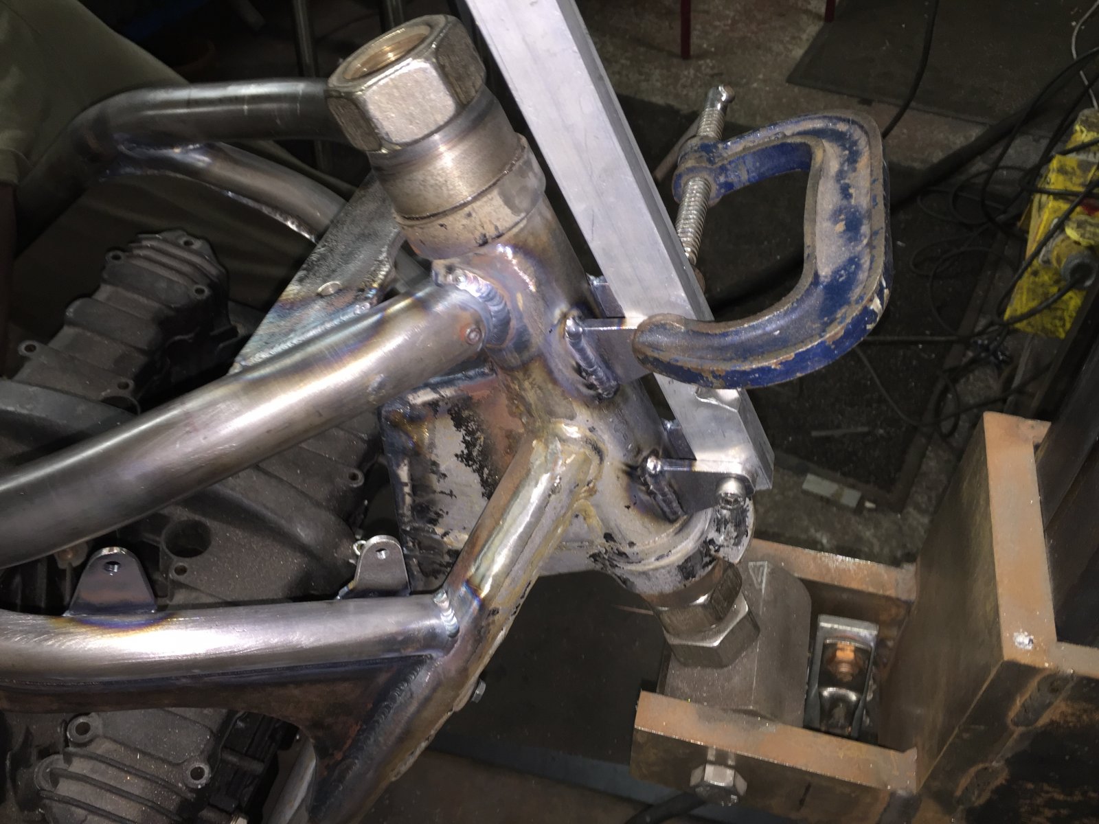

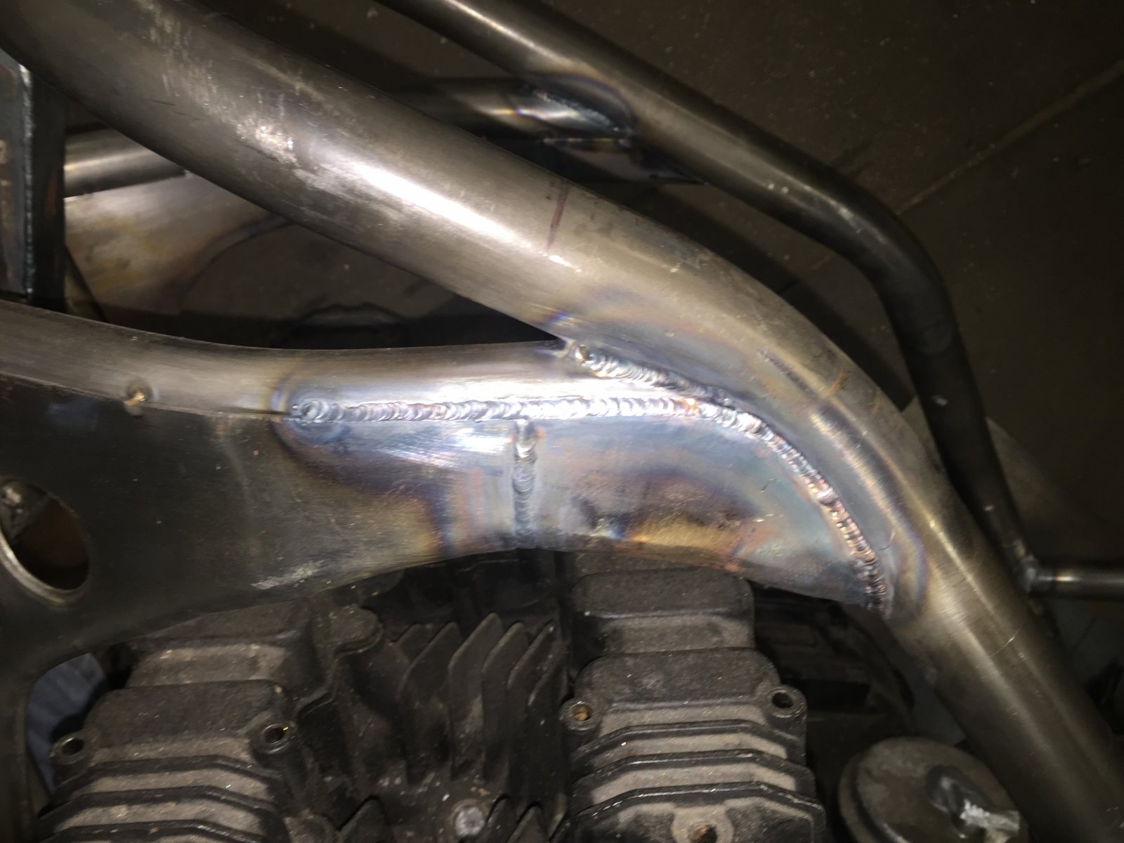

  2. Then the Swing Arm Pivot plates, each of which I made out of two separate pieces, formed and seam welded down the back edge of the inner radius. These took a bit of fettling but they are on now!
  3. Then the Coil Mounting brackets went on:

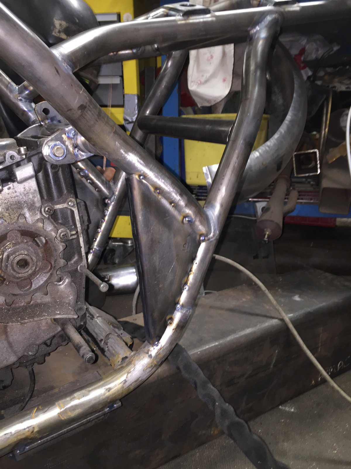

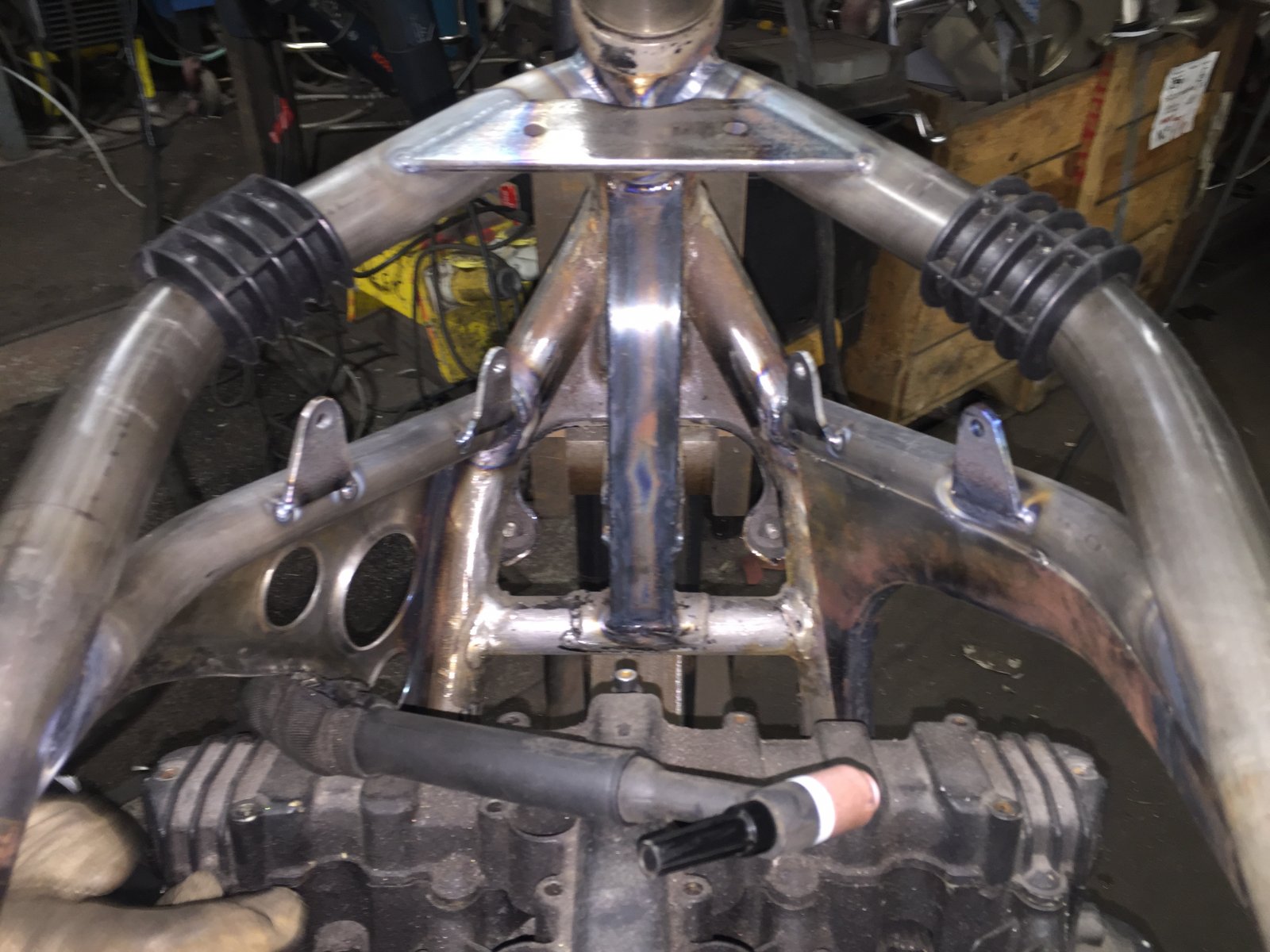

  4. The rear left Engine Mount was fabricated and welded - no photo, then the front headlight / oil cooler brackets were tacked the welded...
  5. Finishing off with the Rear single sided shock mount... that's all for now, re commencing in September :upyeah:

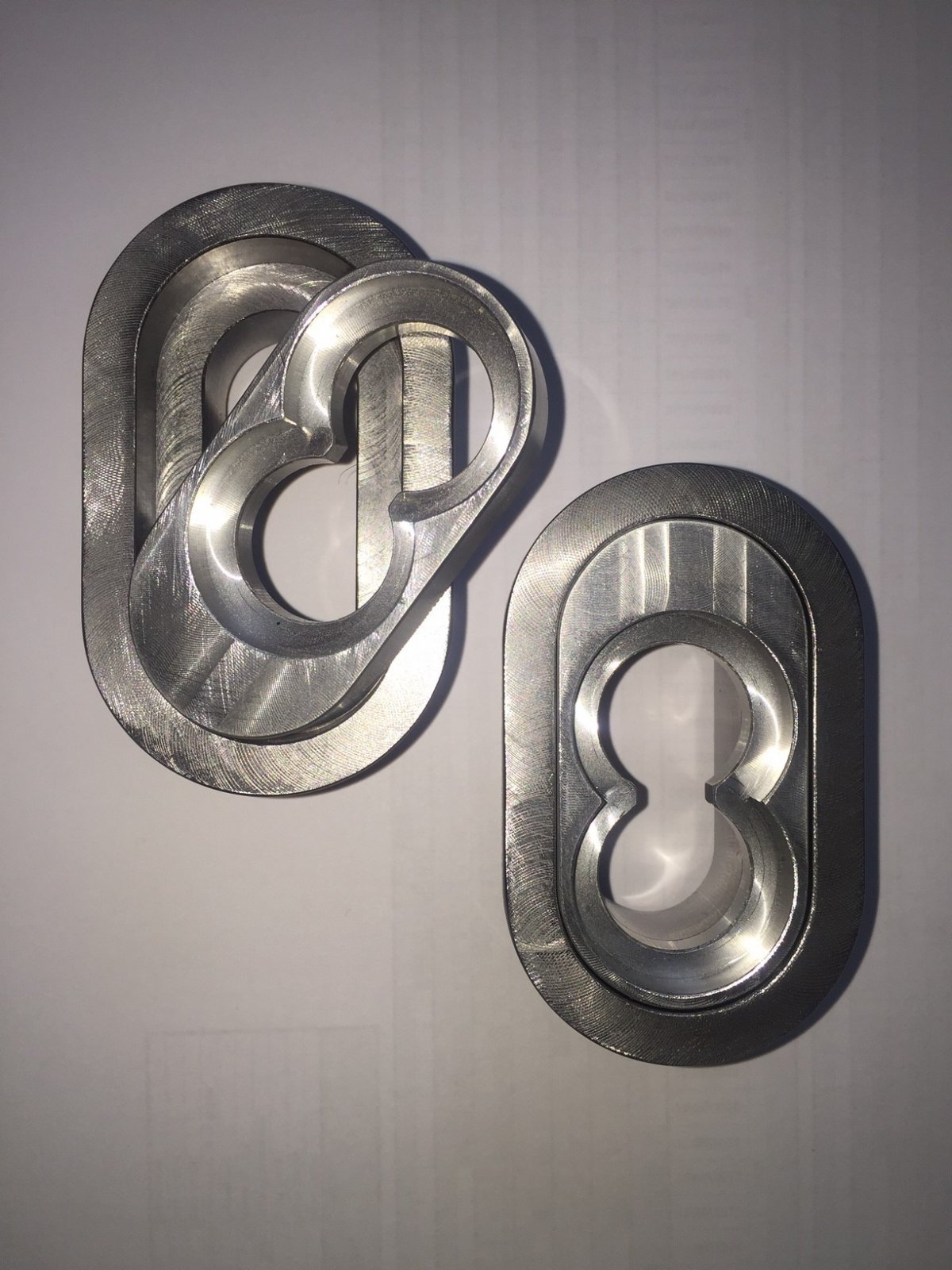

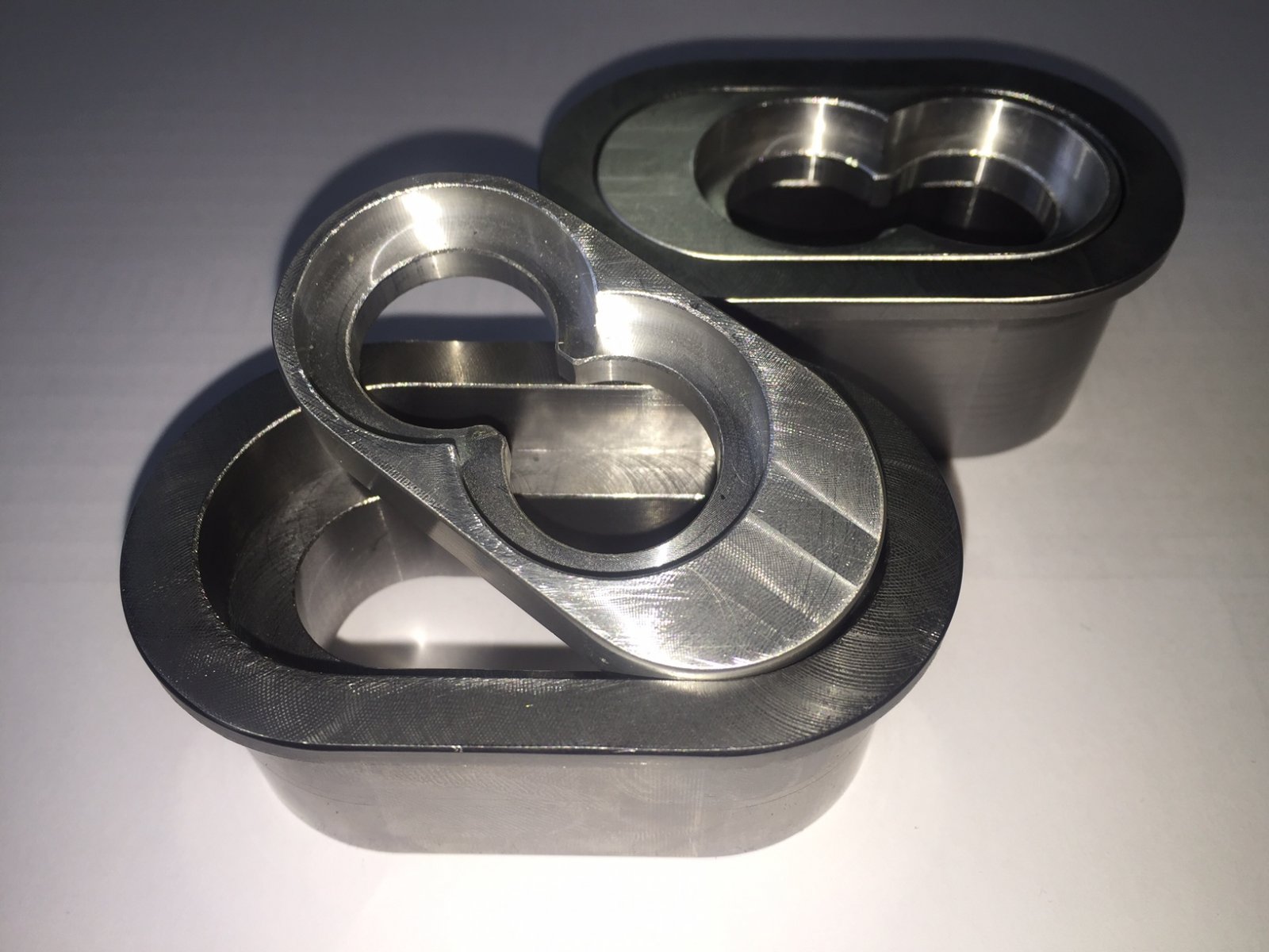

  6. Next hurdle is over :)
    Steel Swing Arm Pivot Inserts for welding in the frame and alloy adjusters, like Ducati 999 ones but with more adjustment - the double offset holes giving 4 positions each 10mm apart when reversed...

  12. Off set holes giving 4 positions :Bucktooth: I'm lost
  13. having read the karma sutra, I'm pretty sure off set holes give more positions than 4...
