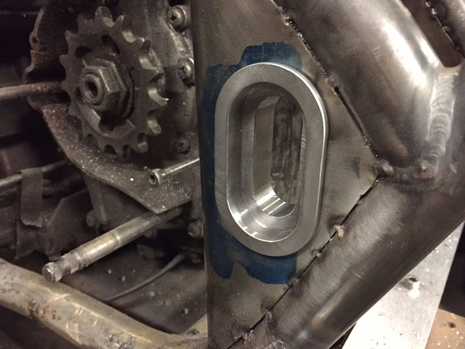

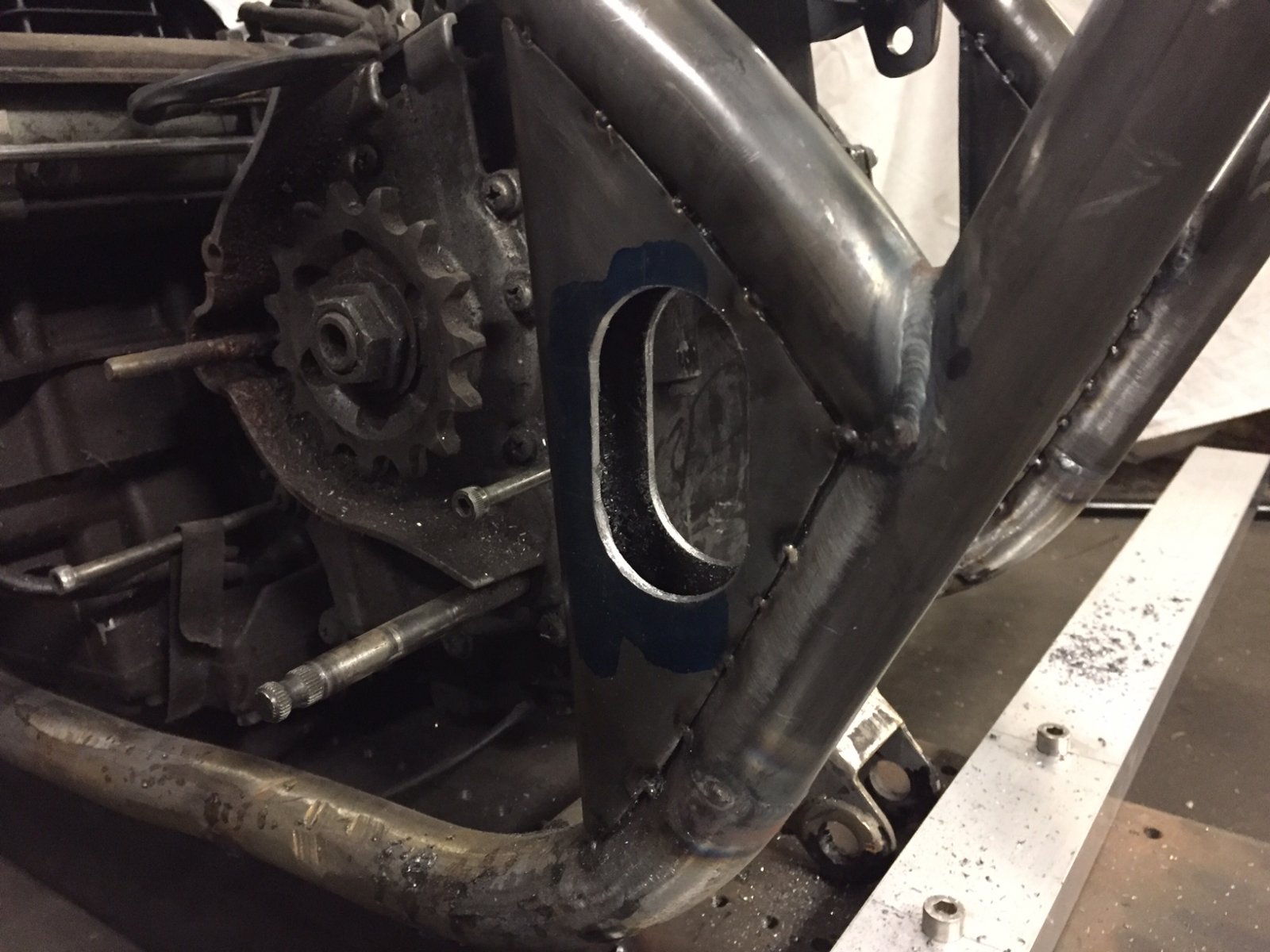

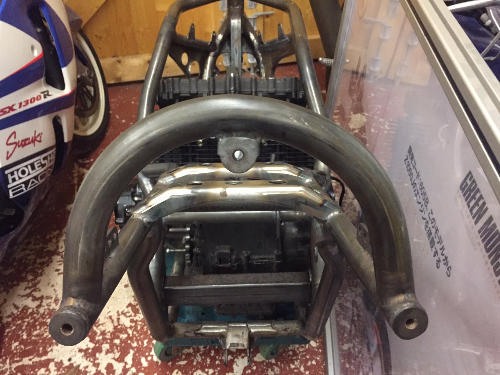

  6. Swing Arm Pivot housings fettled by Chad today and jigged ready for welding tomorrow :D

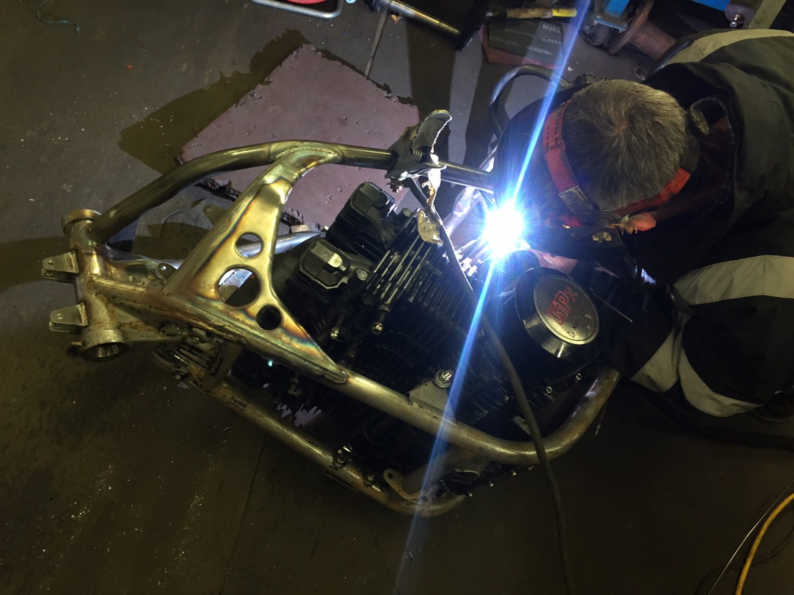

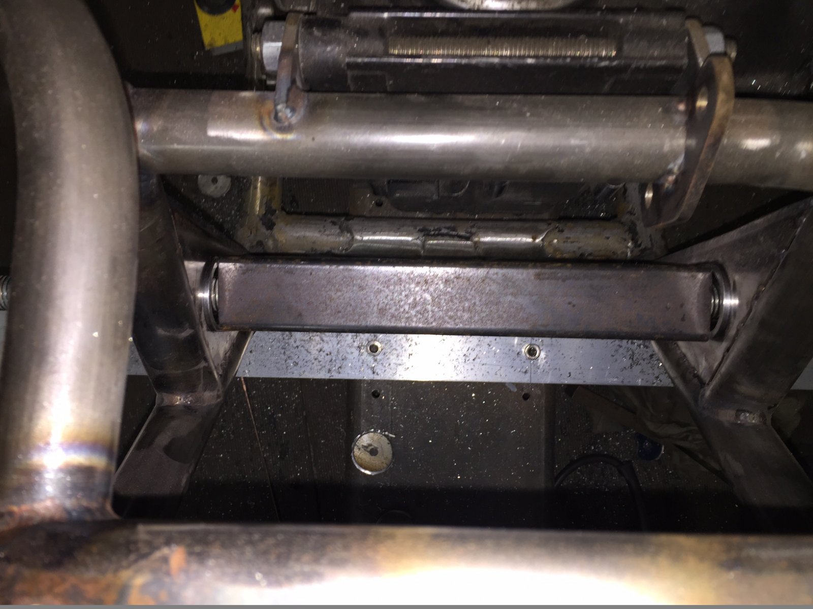

  8. More welding today - big :upyeah: to Chad.

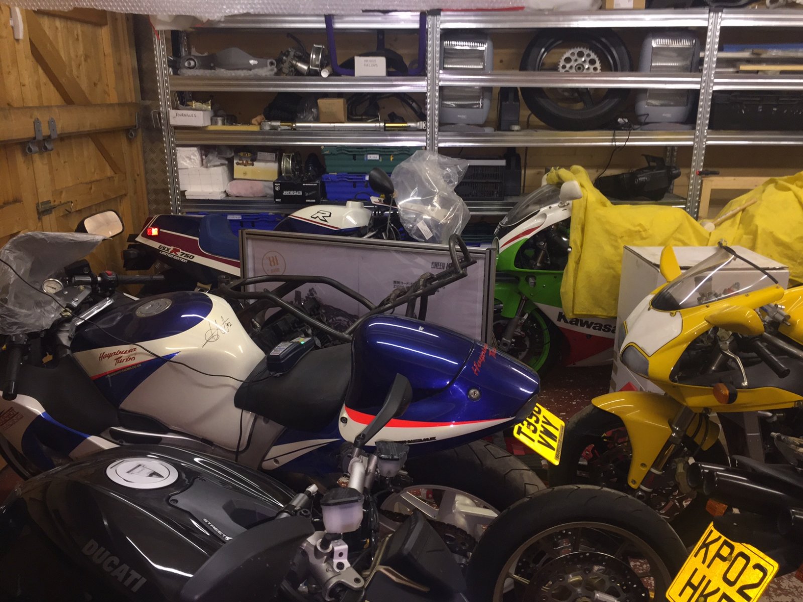

  9. And it is back home for the next stage of the build, but I seem to need to make some room :mad:
  10. v.nice. and it's excellent as well. Buuuuuuut. is that center cambox bolt 4mm to the left off-center?
  11. No, the engines are not central on the GPZ and everything is lined up from the original head stock and down tubes/front emgine mounts :) It's more like 5mm offset actually ;)
    We measured all the alignments and all within 1mm or less in X,Y & Z - far more accurate than a production bike, clever chap that Chad

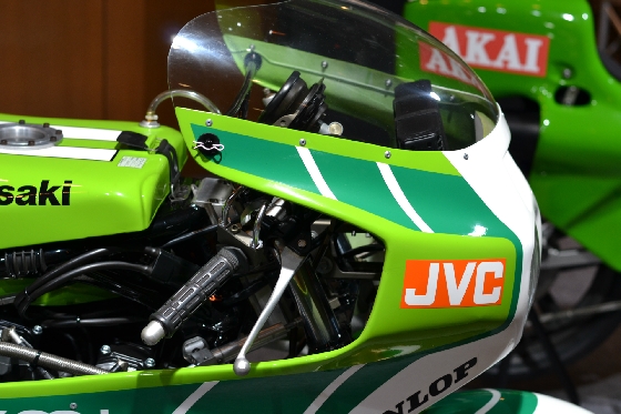

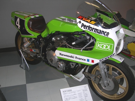

  13. Looking forward to seeing this project finished. Will it be Godier-Genoud green and white?
  14. So will I, it will be a long haul :Wideyed: :upyeah:
    It will be in Kawasaki Green & White :) the team that won the world championship in 1981 with the original bike was a works team run by Kawasaki France.
  15. I think these are the Godier-Genoud colours on the privateer bikes, similar scheme but the bikes were very much different in design - not sure what frames they used but Kawasaki only made 3 of the one I'm replicating I think...
  16. Note the shape at the front corners and rear.
