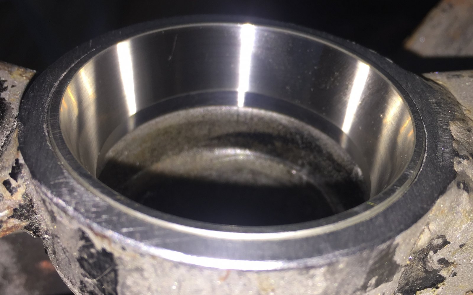

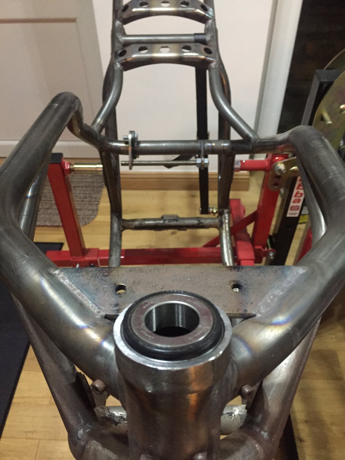

  12. Finally sorted the headstock bearings - the lower race fitted 4mm sub flush so my new bearing with pre fitted seal wouldn't work. Had a 4.2mm spacer turned at work to allow the new bearing to sit 0.2mm proud of the lower headstock tube, you can see it in the photo under the bearing race. This allows the seal to seat correctly. On removing the old bearing I found the race was 1mm thicker than the new one, so my spacer was 1mm too thin :Facepalm:
    It was either a new 5.2mm thick spacer made this week or filing 1mm off the bottom of the headstock tube - decided on the latter so I could get the bearings fitted today. Even simple jobs are sometimes a pain, but it's done now and I have the final measurement to start designing the new steering stem.

  14. If you look at the outer shiny bit this is where I took 1mm off - it's in fresh air in the assembly. I power filed it then finished off by hand so cheated a little. Got it within 0.1mm flush when measured with very-nears, but there was no real need to be accurate with this face - I just like it neat :)

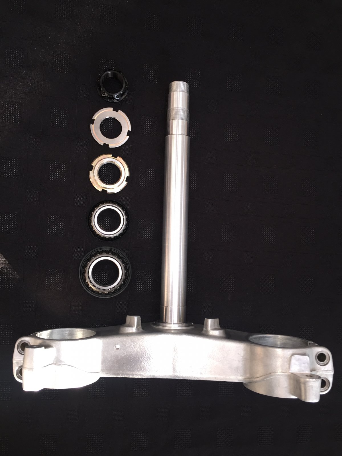

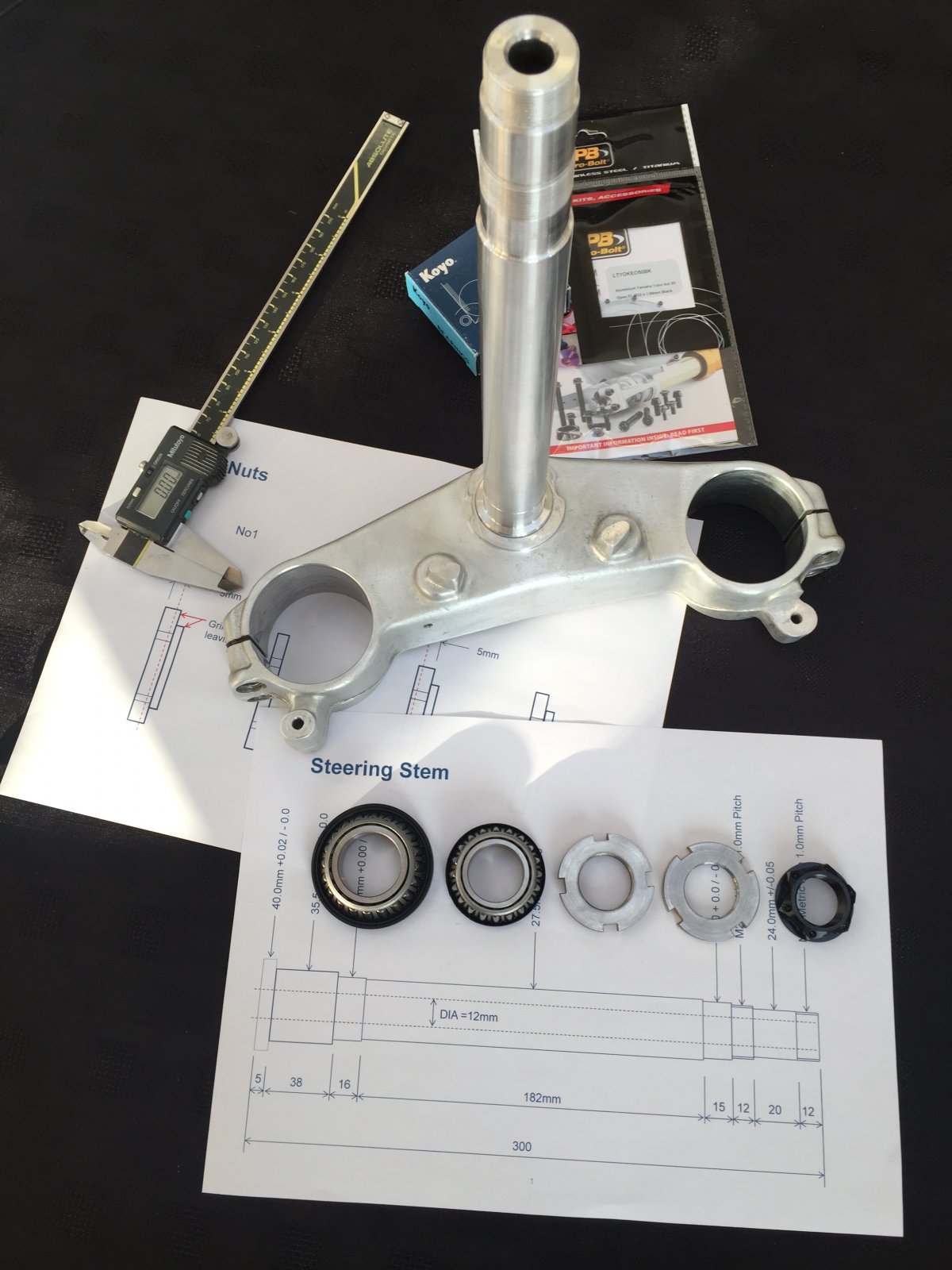

  18. A little progress :eek: steering stem designed and made from T6511 (H30TF) Aluminium - need my drift opening up 0.5mm to get the bearing on. Hopefully everything is calculated well! This is to fit the Ohlins front end :)

  20. I very nearly made more progress last night by drifting the bearing on - put the stem in the freezer, bearing in the oven at 50 degrees (due to the rubber seal not being removable. Hammer at the ready, bearing on - located about 1mm, drift in hand, drift wouldn't fit over the stem by 0.1mm :worried:
    Drift now at work being bored out another half mm so we might see even more progress tonight with a dry fit :eek:
