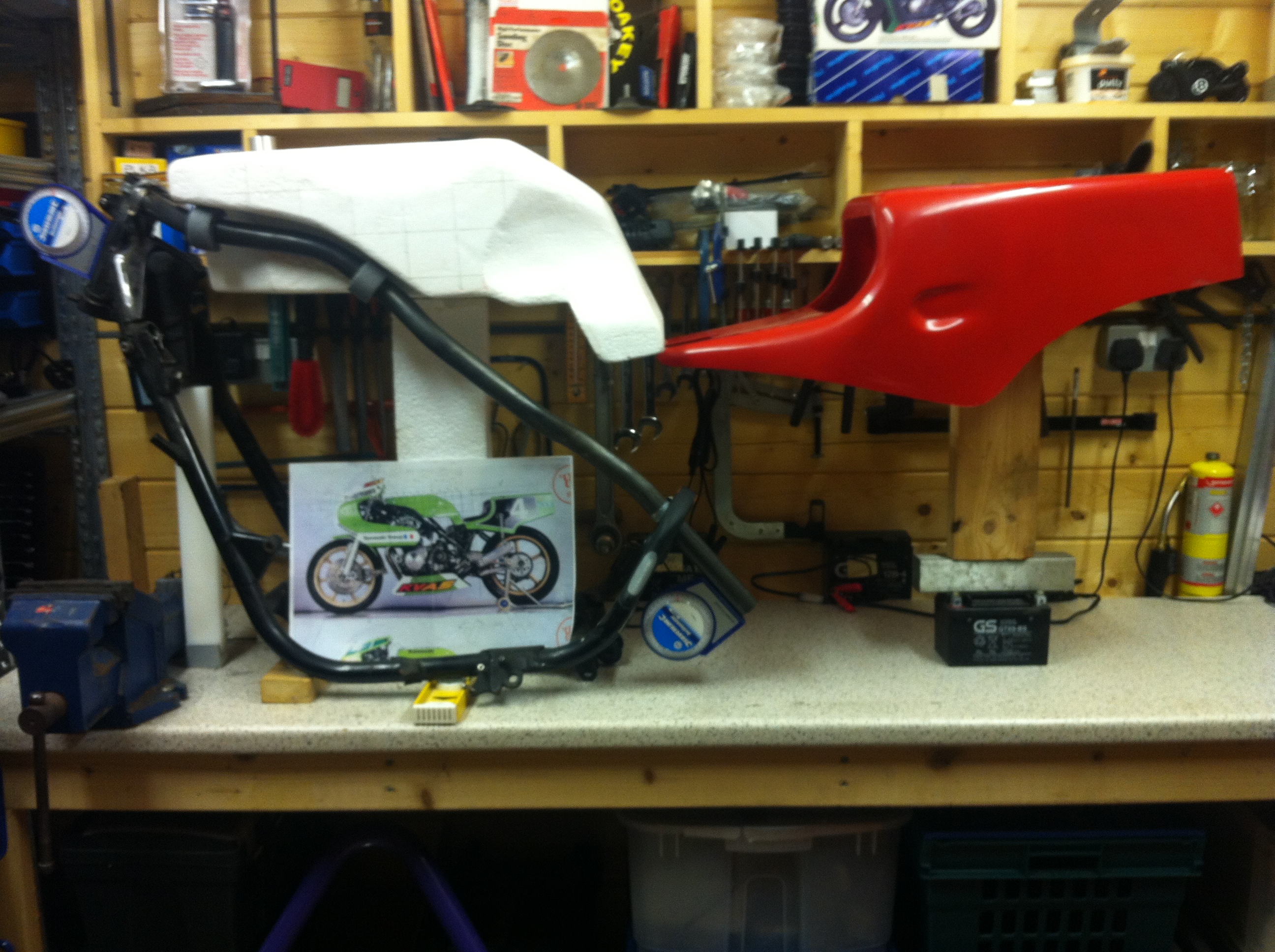

  5. Performance Bikes are coming tomorrow for the photo shoot, was hoping to get a bit more done to this so I have just fitted the seat unit ;)
    Do you think they will notice it's not finished :Wideyed:
    Sorry for the blurry picture - it was wobbling on the polystyrene and wood :Happy:

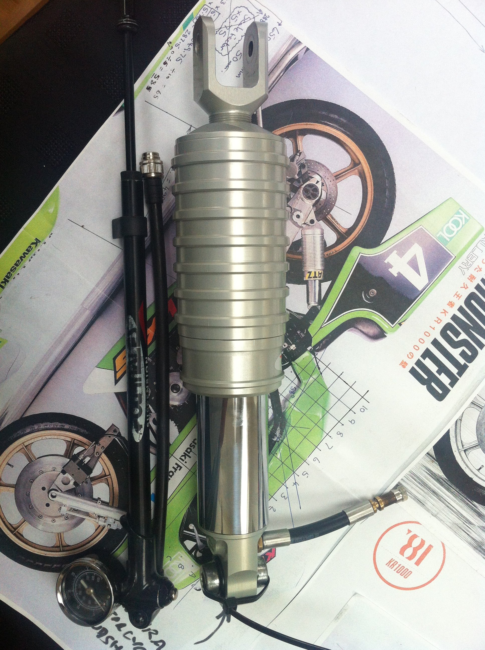

  7. This is as close as I can reasonably get to the air shock used back in the day - close enough I think. See picture of original in the background.
    Arrived today, it's strange, yet yummy all at the same time.
    Won't need it for ages though :Wideyed:

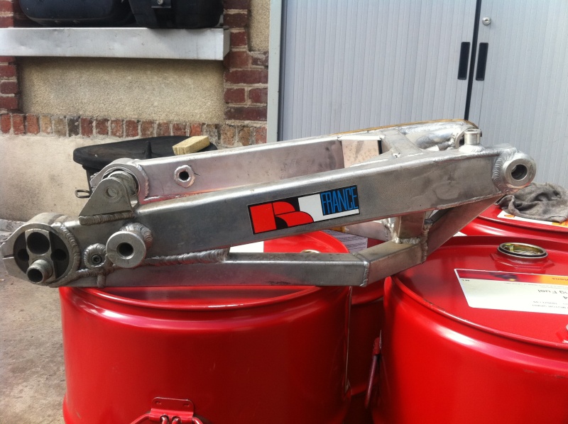

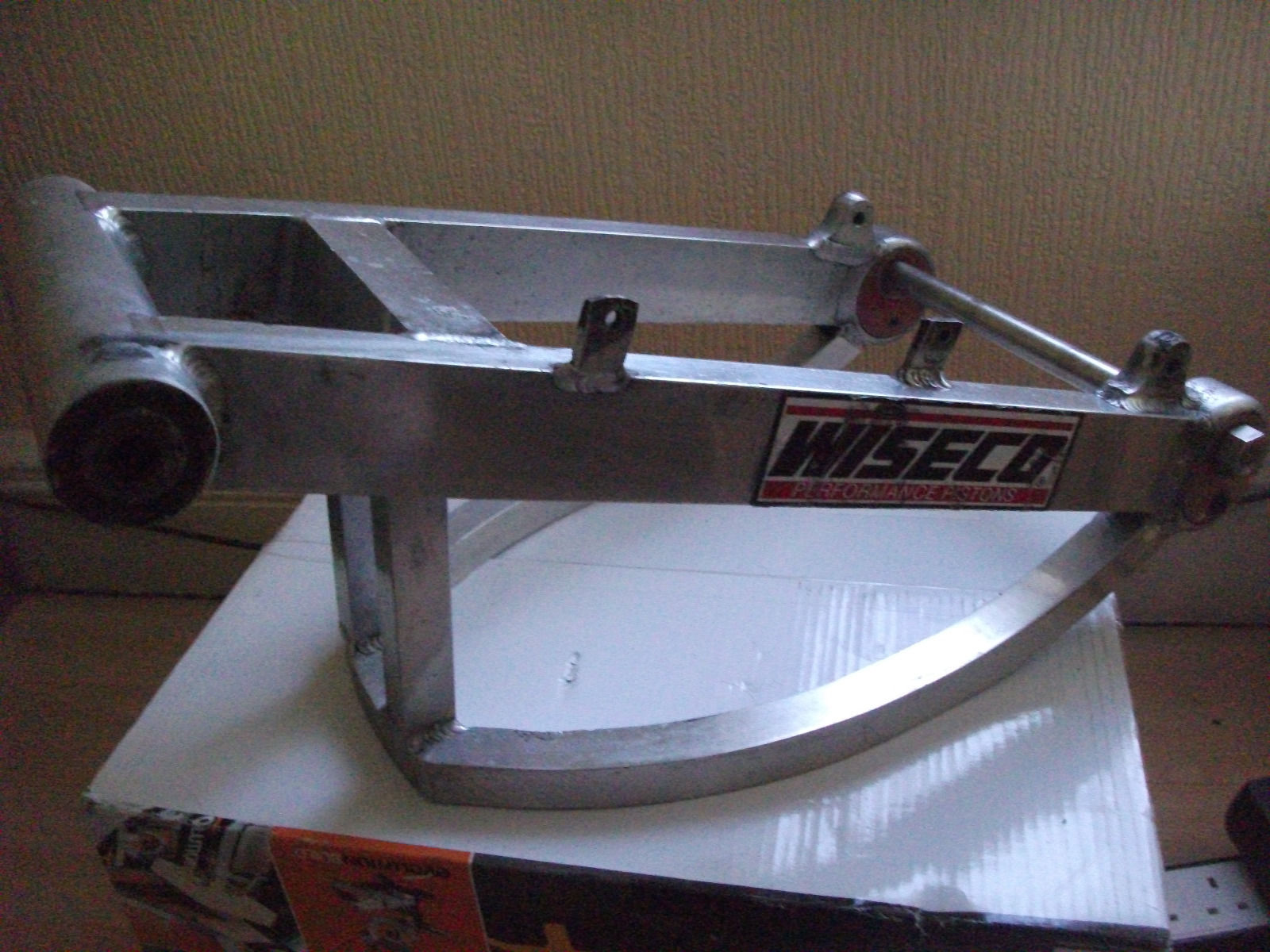

  14. Just bought this on Ebay, was going to make one from scratch but this ones main spars are pretty much cock on for what I need. These old period parts go for silly money, had to pay £225 to win it! It will save some work though!
    Having paid a lot for what appears to be a sort after item, I now need to chop it up and alter all the bracing and lugs so it looks like this:
