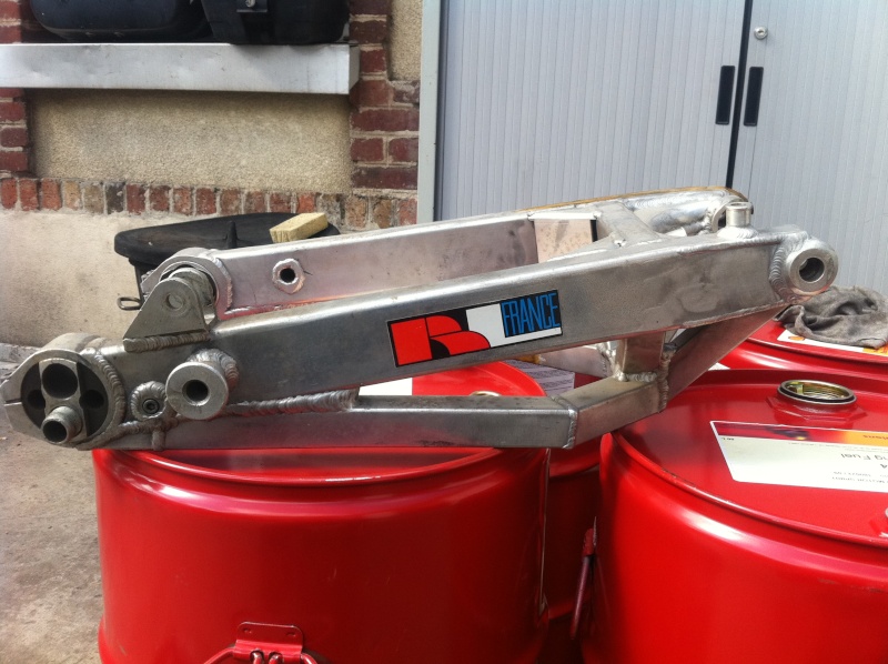

  2. Yes, well far more than the one that won a world championship - it actually isn't much (if any) different than a standard shock mount position on the left side and can only be stronger on the right :thinkingface:

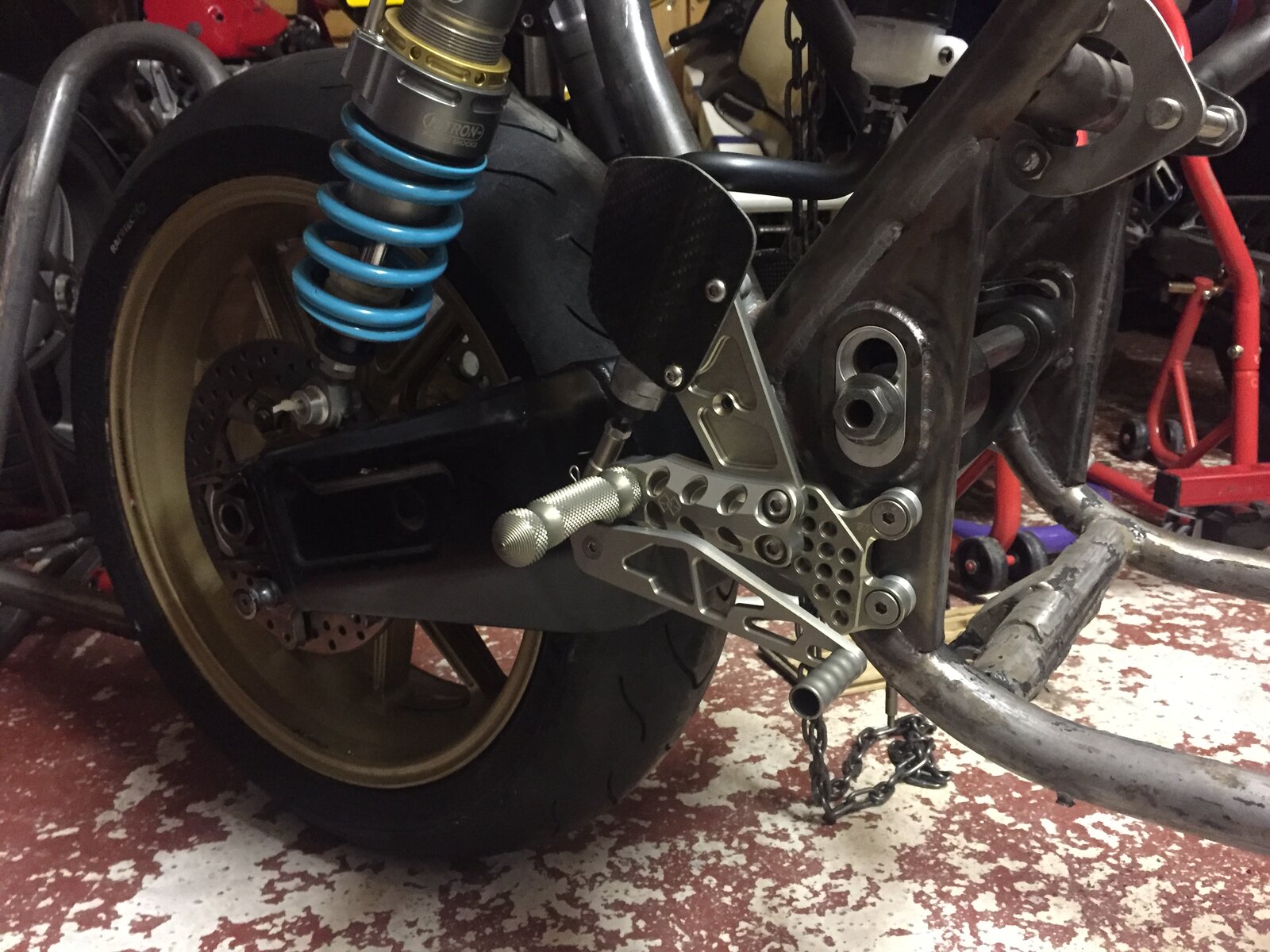

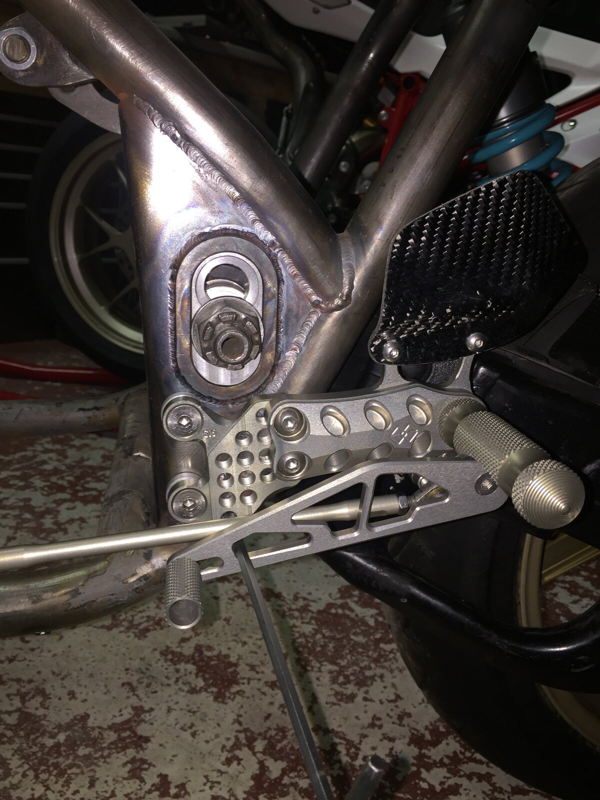

  6. Well, another issue from a year of so ago was getting the Giles Rearsets to fit - the multi adjustable plate wouldn't line up with any accommodating surfaces on the frame.
    I got them out of the box last night as I was on a roll after attacking the swingarm and found a couple of small bubble wrap bags in the bottom of the box - feck me, 2 more adjuster plates with different mounting points! And they would fit too :blush:
    So I spent 2 or 3 hours lining up, scaling from images to get the position as close as possible to the original bike - cross checking the distances on my GSX-R 750RR as it has a similar low slung seat.
    It took a while to finally get the courage up to drill the frame - measure 5 times drill once was my motto today. I also had to de-mount it from the Abba Skylift to drill the holes so it is now supported from the ceiling from my new workshop addition hoist. I can now see what clearance I have for the 2 remote reservoirs so will have a thing about brackets those next...
    I have drilled and tapped the steel plate as temporary fix for now and ordered some M8 x 20 weld in inserts for my next trip to Chad's welding emporium of motorcycle excellence over in Hull :bucktooth:

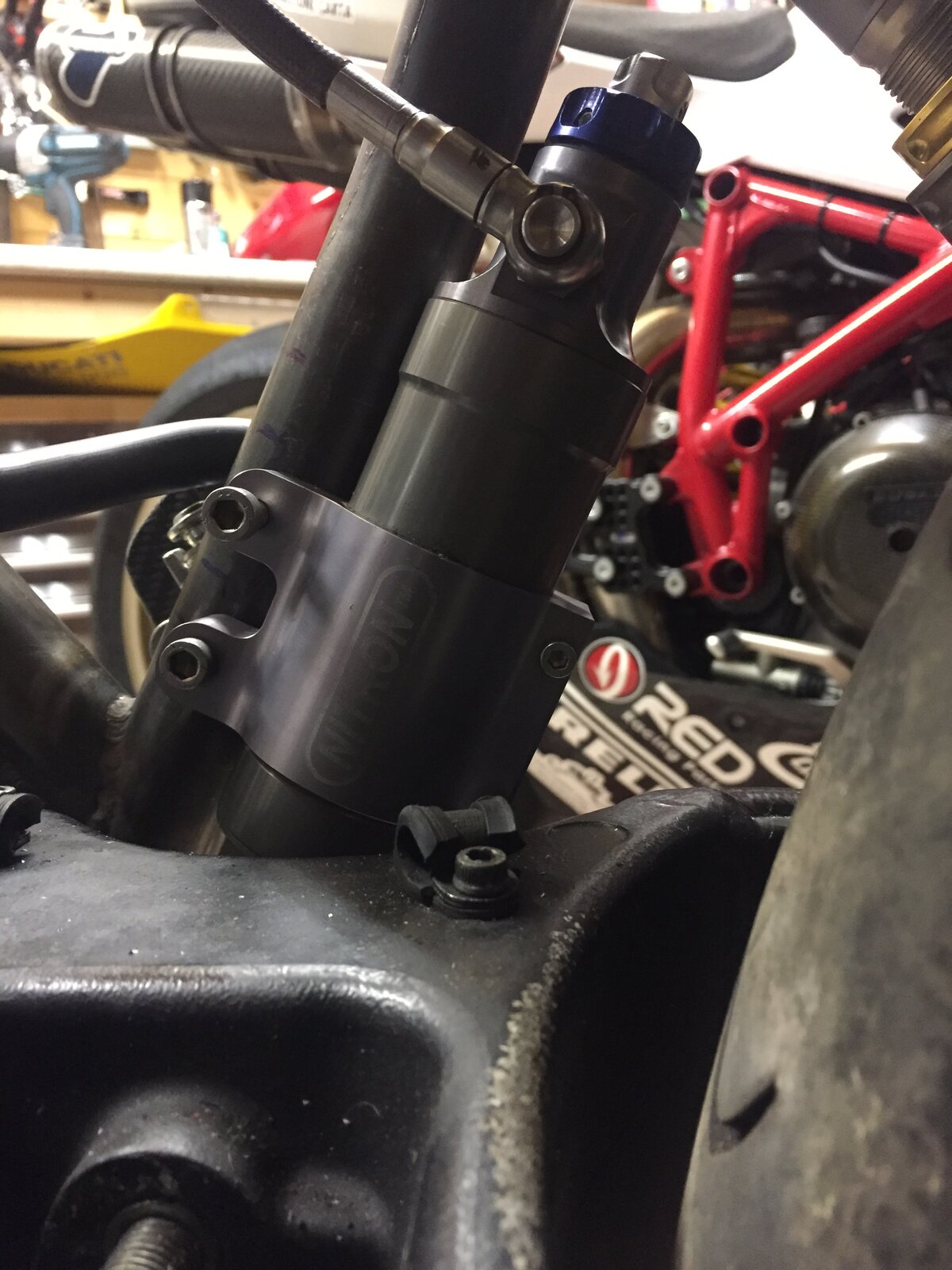

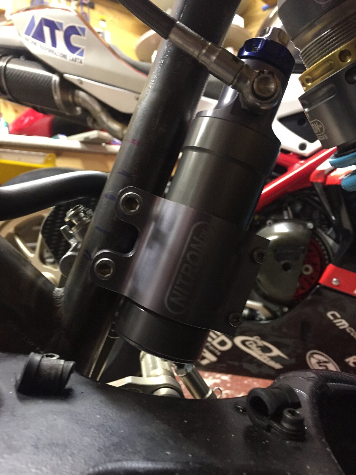

  8. Fitted my remote reservoir with temporary drilled and tapped holes in the frame, ordered some M6 weld in inserts for the proper job.
    View from behind:
  9. Luckily Ducati designed a cut out in the swing arm so at full travel the remote res just drops into it, very nice of them:
  10. Swing arm's upside-down ...
  11. Pleased with the result :blush:

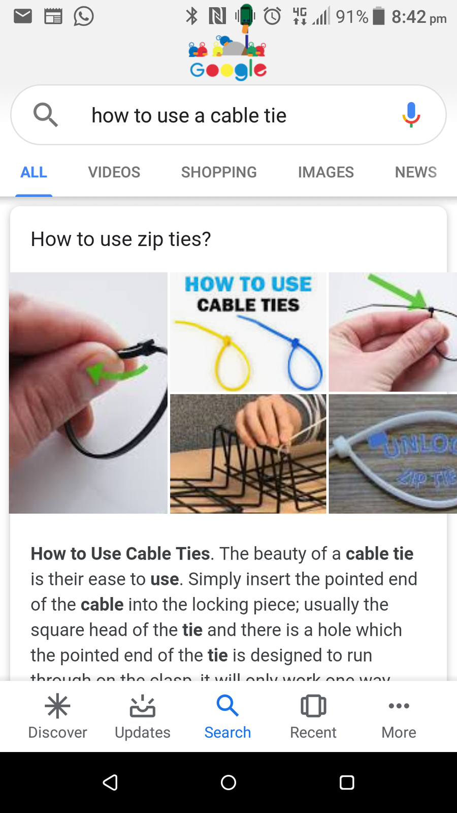

  13. ^^^^ you may want to rethink the cable tie...
  14. Why? it's not attached to anything :bucktooth:
  15. Exactly!
  17. How did you know there was such a thing as an instruction to use a cable tie :joy:
