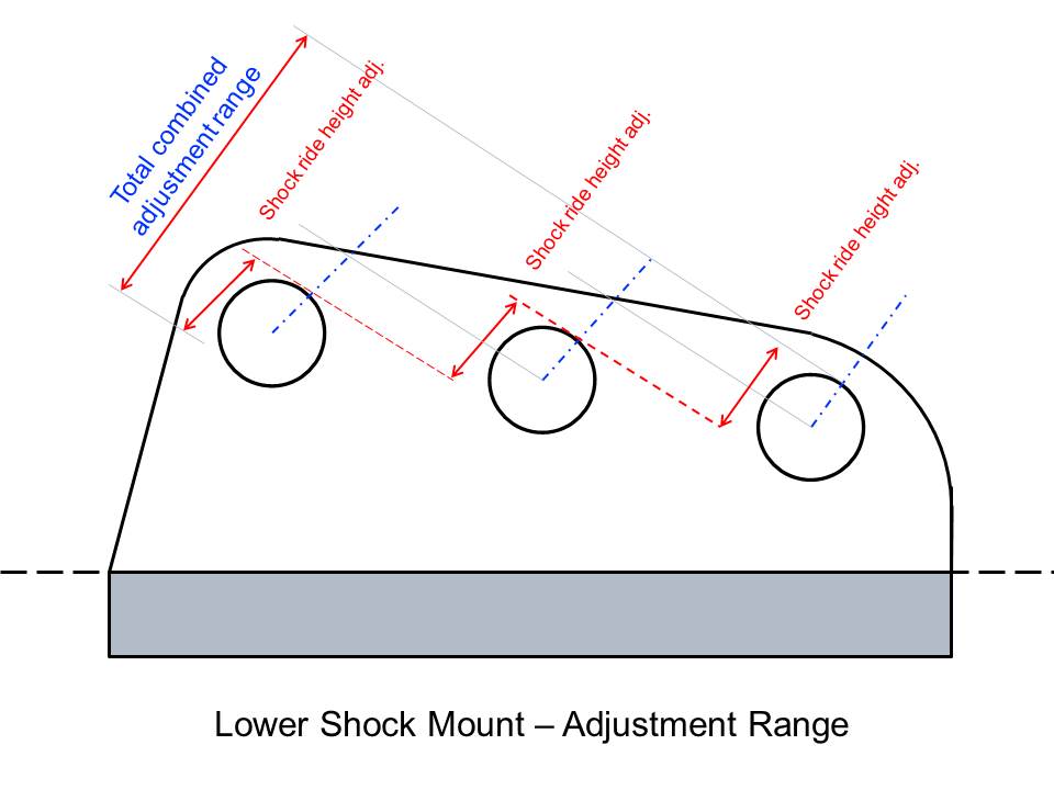

  5. Spent 2 evenings playing with rear ride height and chain to swingarm clearance - don’t know exactly where I want to be so I have designed in as much adjustment as possible with 3 lower mount points. Along with the shock ride height adjuster it gives me full range between the lower and upper settings. Will attack with drill this weekend after a little more pondering, it will end up a bit different to this sketch :thinkingface:

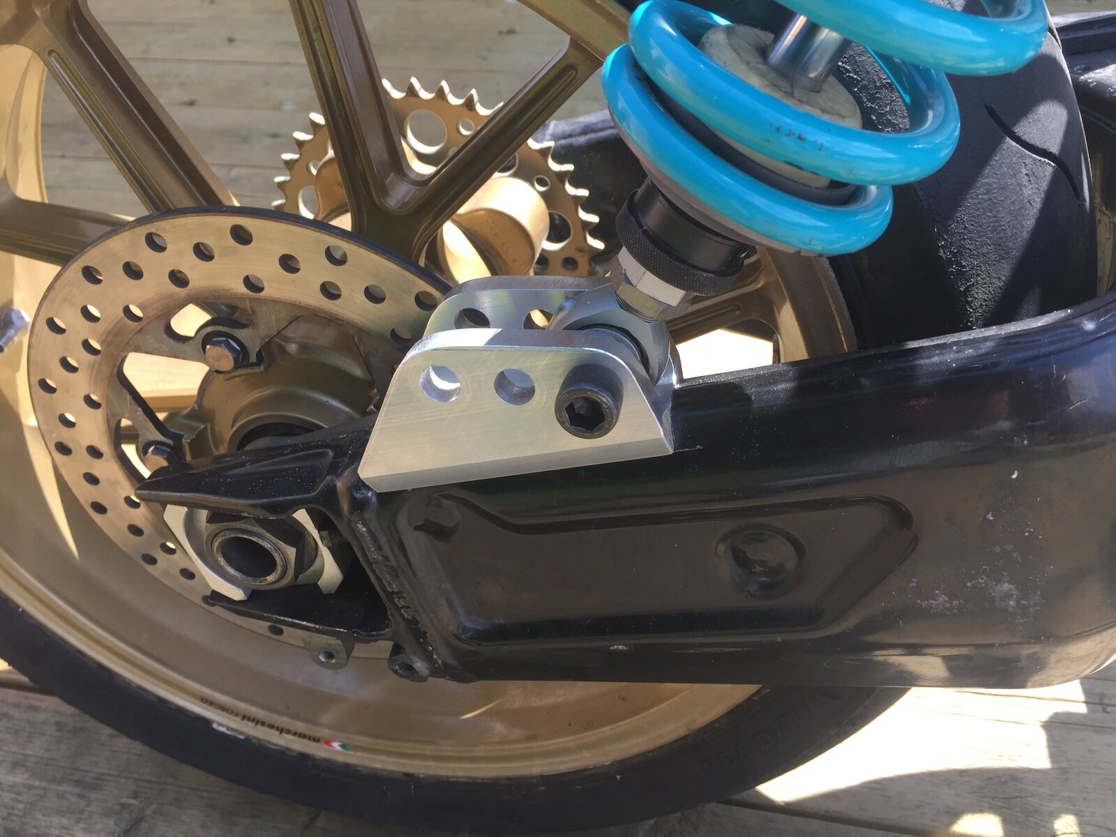

  6. Lower mount finished for welding in - just need to check the top chain run for clearance (might have to drop the bottom half of the engine in to check :thinkingface: but will try and do it by measurement first) - hopefully I have built enough adjustment into everything without needing major surgery. The swing arm is currently on the second lowest out of 4 positions, the shock on the highest out of 3 with the ride height adjuster on the shock on the lowest position. A large rear sprocket may also help if extra clearance is needed. The pub is beckoning as a reward I think o_O

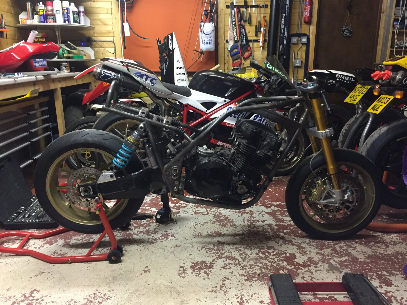

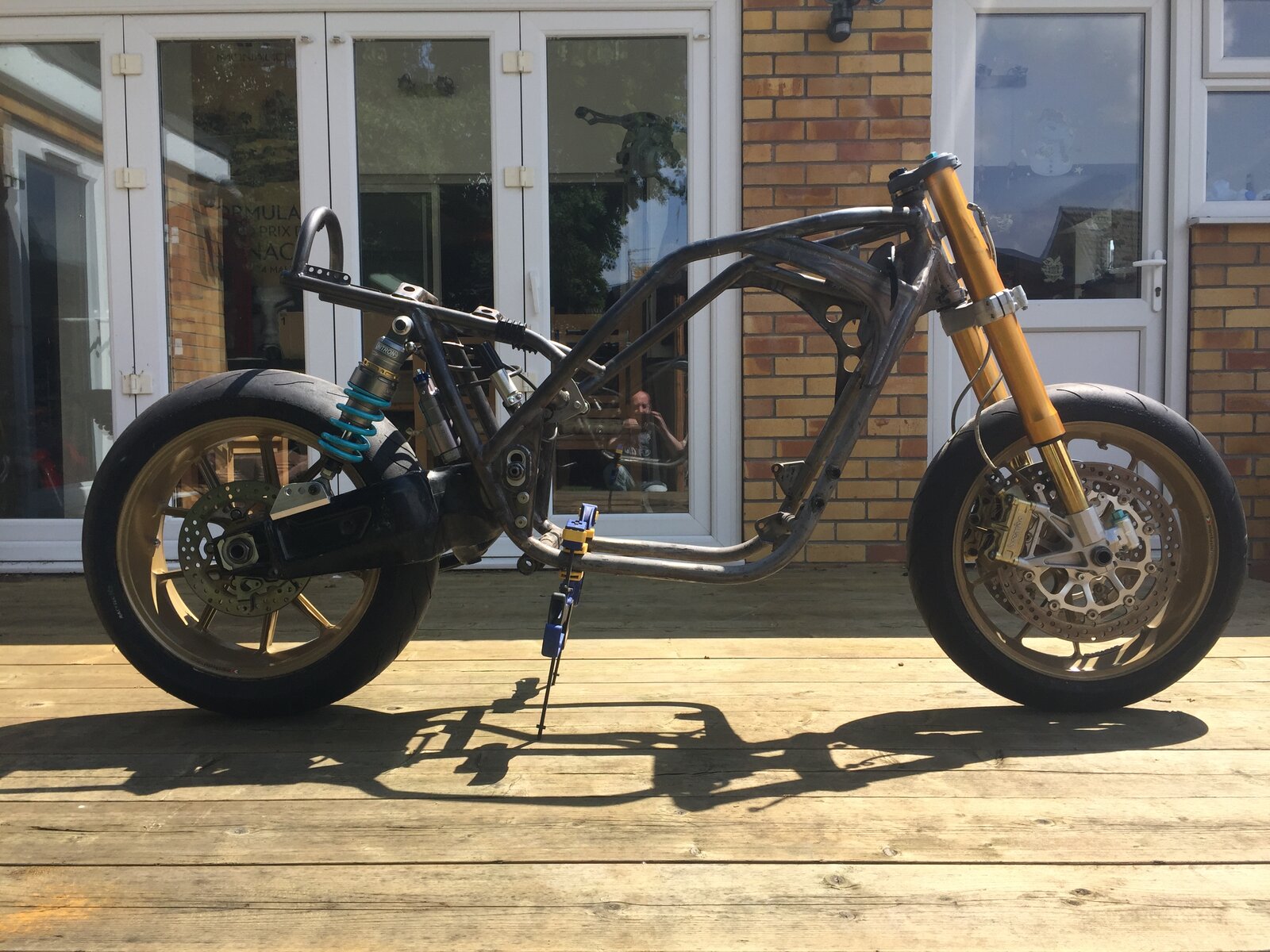

  15. Engine dropped in, although it's piston-less at the moment, quite a struggle but needed to check sprocket requirement and alignment.
    I would rather go for a 525 chain instead of a 530 - it would need a 525 offset sprocket on the front but with the GPz Unitrack A1 spline fitment
    ANYONE KNOW WHO MAKES THEM AS SPECIALS?
