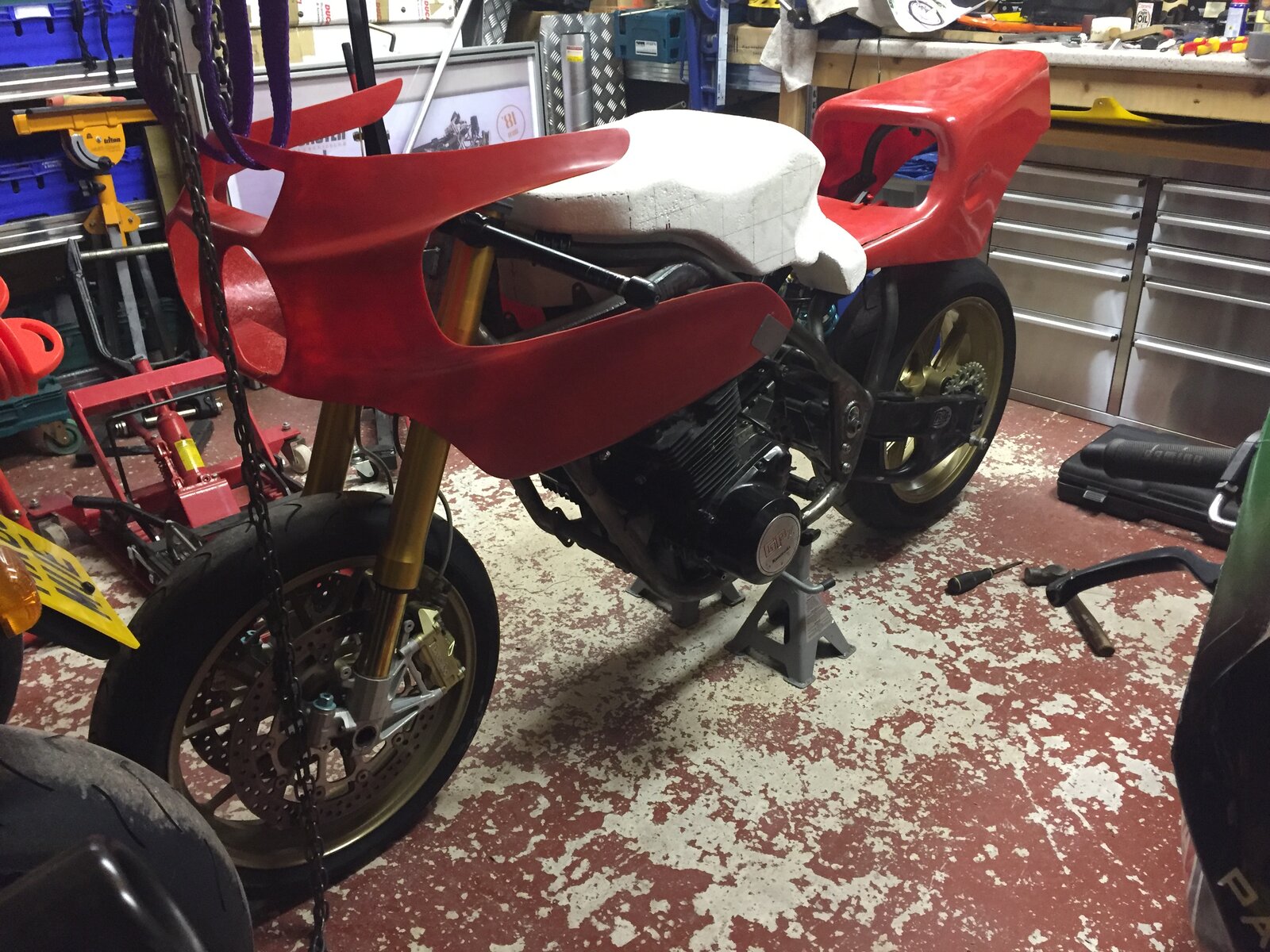

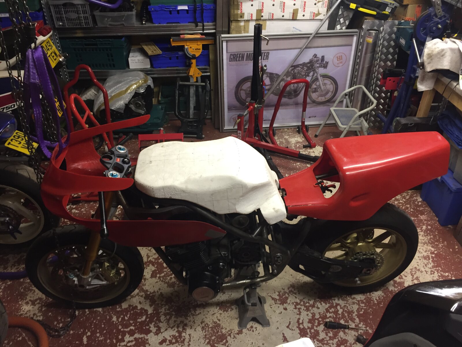

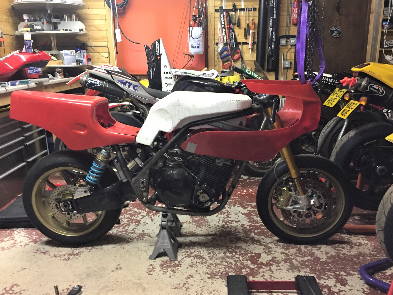

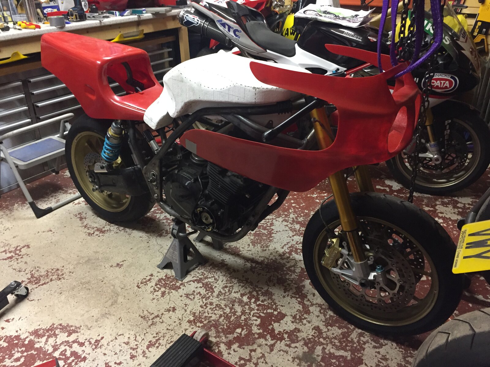

  4. Been playing - now it's on it's wheels this was the first time I had the opportunity to position the tank and seat unit in position and balance the fairing roughly in place. The tank needs a bit more meat between the frame but is sat correct now, the seat unit is fine too (it actually stops slightly shorter than the rear wheel but the pictures make it look longer :eyes:). The fairing needs a fair bit of surgery but I will get the mounts worked out first before attacking it. The fairing was originally made for a KR1000 replica using a Harris frame in Germany and is pretty much cock-on apart from the side bits that will need shortening and re shaping :thinkingface:
  5. More pics...

  13. I thought "That seat unit looks massive" o_O in red. A different proposition in green with the number board. :) :upyeah:
  14. Yeh, close up with a wide angle phone camera throws everything out of proportion too :scream:
