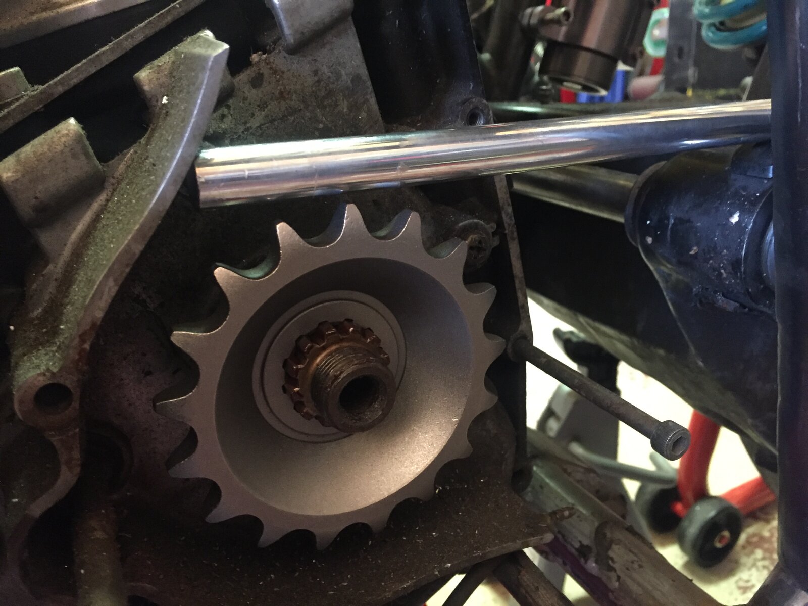

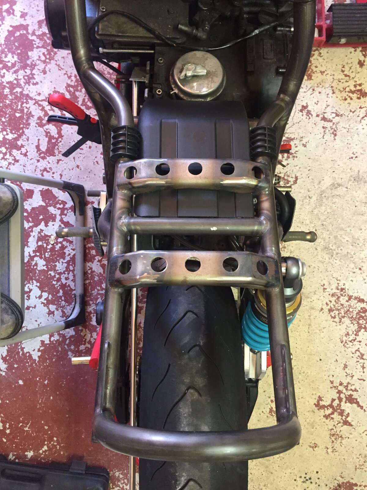

  9. Well, the 1/2" aluminium tube for the top fairing mount was too thick wall section to bend without snapping (grade not ideal either) so after an hour modifying a small plumbers 12mm pipe bender to fit the slightly larger tube and changing the benders pivot centre +1mm with blow torch and hammer (on the link bracket) I just ended up with two pieces of tube instead of 1 exquisitely formed sculpture :worried:

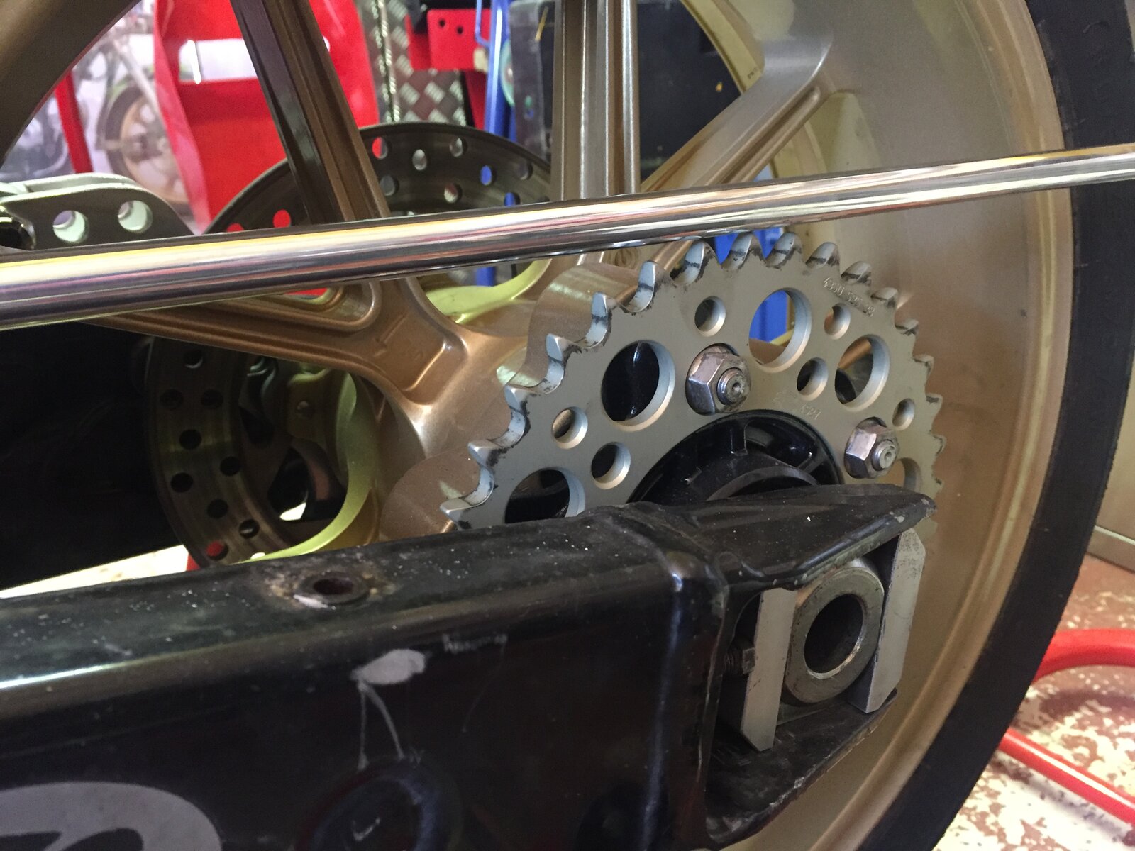

    But then the postman turned up with my 530 size 5/8" offset front sprocket - tried that and everything is cock on - chain alignment is within 0.5mm so well pleased. Just need to take it to work now to reduce the teeth width to 525" profile before ordering the correct larger 525 rear sprocket.
    Small progress, but progress all the same :)
    Also you can see in the last picture a piece of plastic mudguard that I was trialling made from a trailer mudguard. I still haven't decided to put a hugger on the bike, or leave it cleaner with a higher guard like this, or both, least of my worries really as I pick up the aluminium for the fuel tank on Monday :worried:

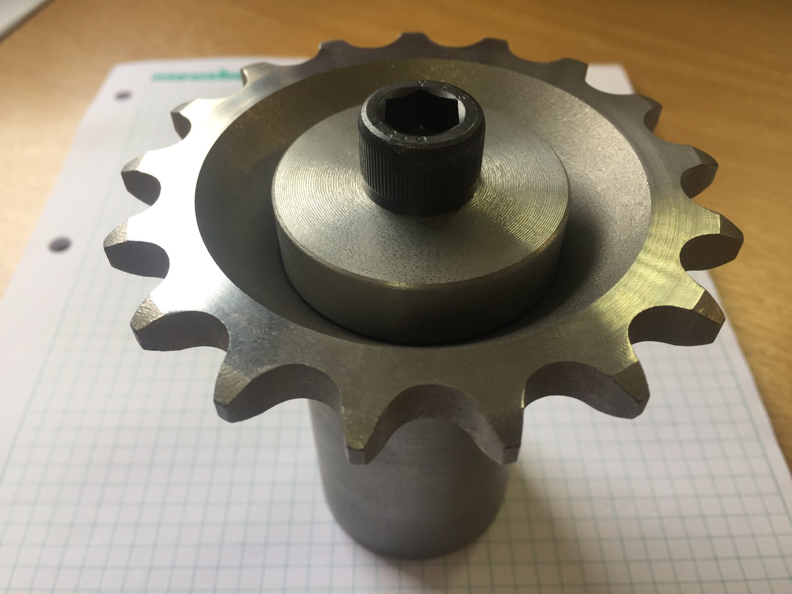

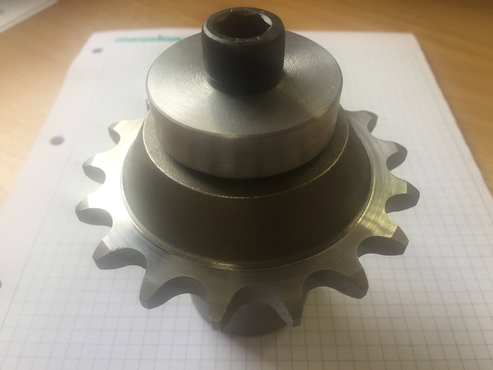

  12. Rear sprocket machined from 530 to 525 :)
    Ordered a 46 tooth rear Renthal from B&C Express: 2 to 3 week delivery.
  13. hope they machined the right side.

  16. That looks like it's upside down?
    • Disagree Disagree x 1
  17. chill, it would of been an easy mistake to make, its allready a whopping bit off center.
