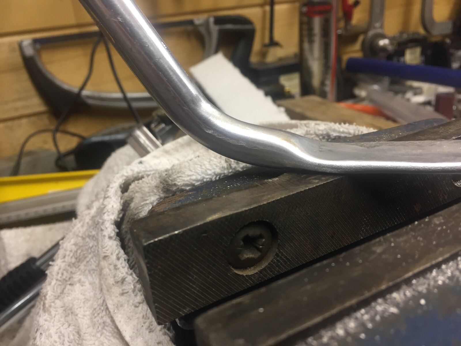

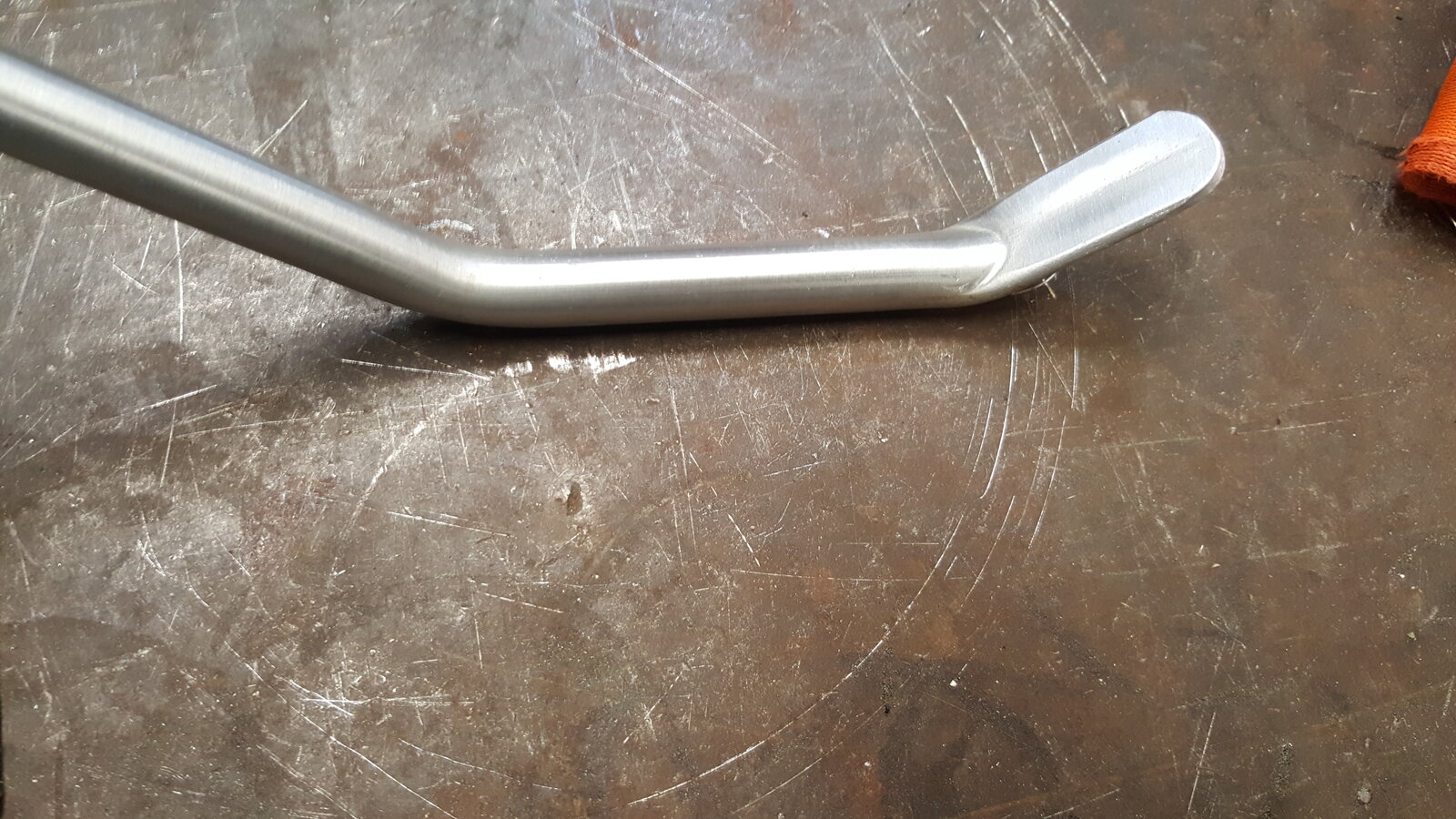

  8. So after my disaster bending the alloy the other day for the top fairing stay I had a go at annealing it first and then bending and also a trail forming for the flat section - it worked a treat, so another length of the same alloy ordered...
  9. I have a press tool for forming the flats stu, its not a big hammer or a vice,you need to bend the tube using the heat while your bending it.

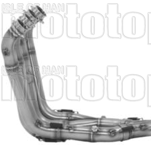

  10. Cheers, was going to text you earlier: would it be best to get an exhaust system to alter (I'm after a Ti System - something like the pictures below) or would it be better for you to make a spangly one from scratch? It needs to come out of the LH side of the bike :):upyeah:
    The first pic looks like it already missed the oil filter cover for access... (if the headers are long enough).
