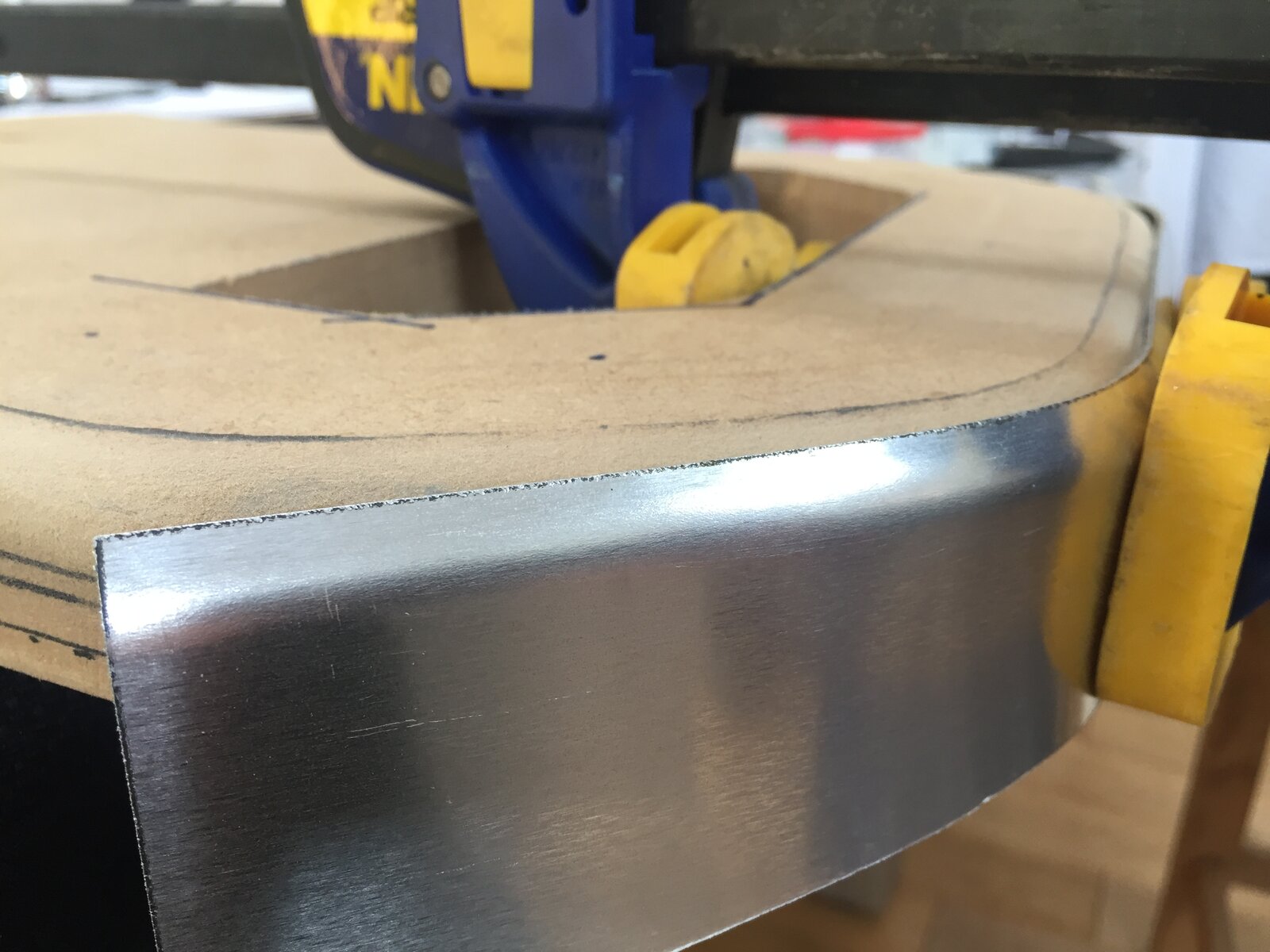

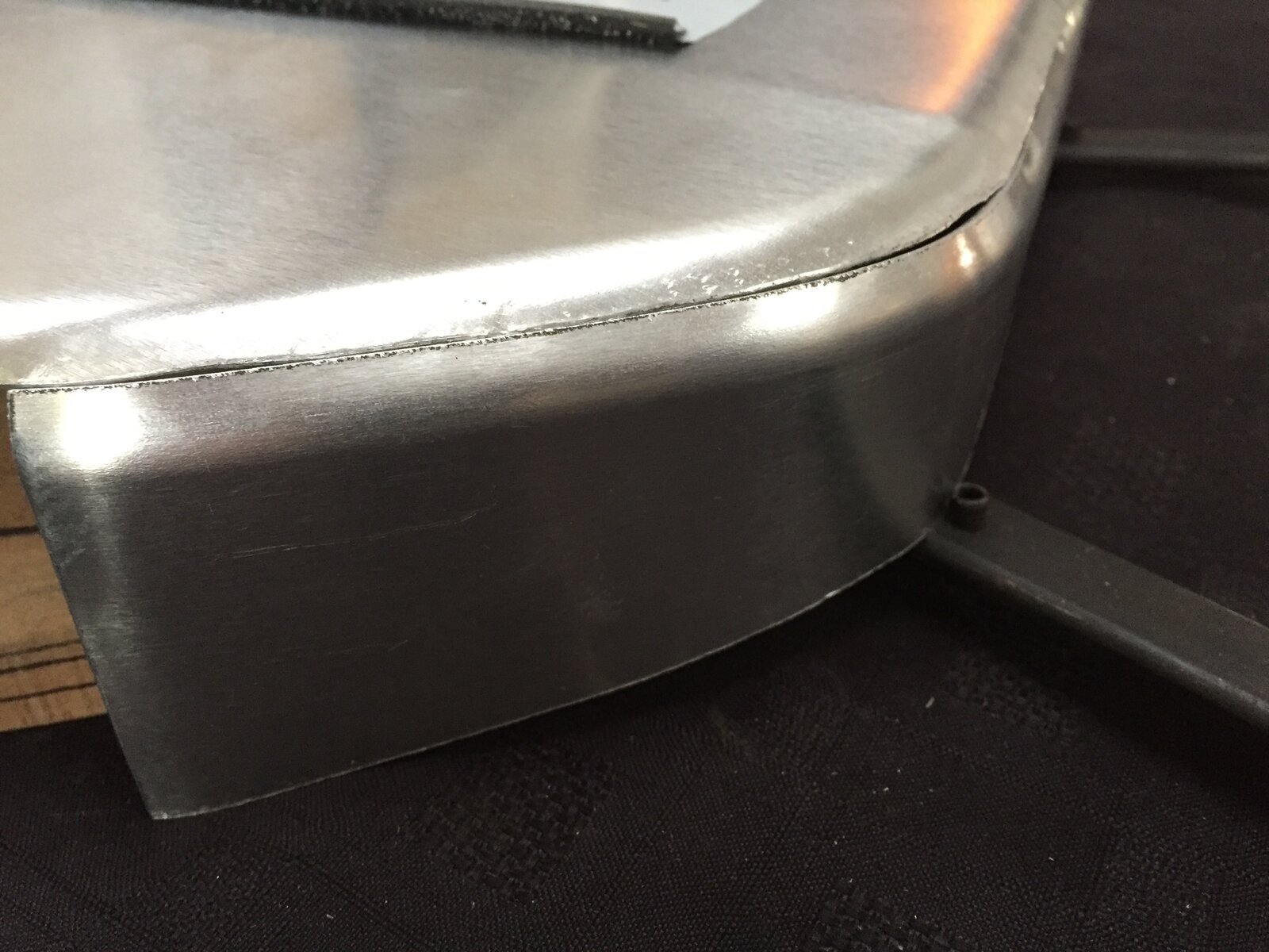

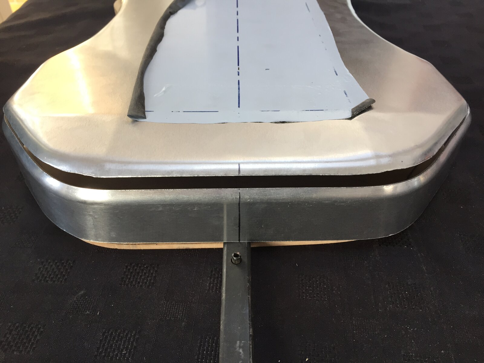

  11. One bit I've been putting off for a while is the second panel for the tank, I did the top panel, but it didn't need to match up to anything so I was a bit hesitant with this one. After putting the top curve on with a steel bar as a former I came up with a way to clamp the panel using the top former I made and managed to bend it by hand to the correct shape with a few taps with the leather mallet. It's still needs a little fettling so Chad doesn't tell me off for gaps when welding - but really pleased with the results. There are however more difficult pieces to come :worried:

  12. Nearly, only about 20 panels to go (you meant the tank yea?) :eyes:

  16. Im watching...better get your file on them joints,as a guide it can take a couple of hours per panel to get a perfect fit
  17. Aboot 3 months without the breaks :p: DQ :eyes:
