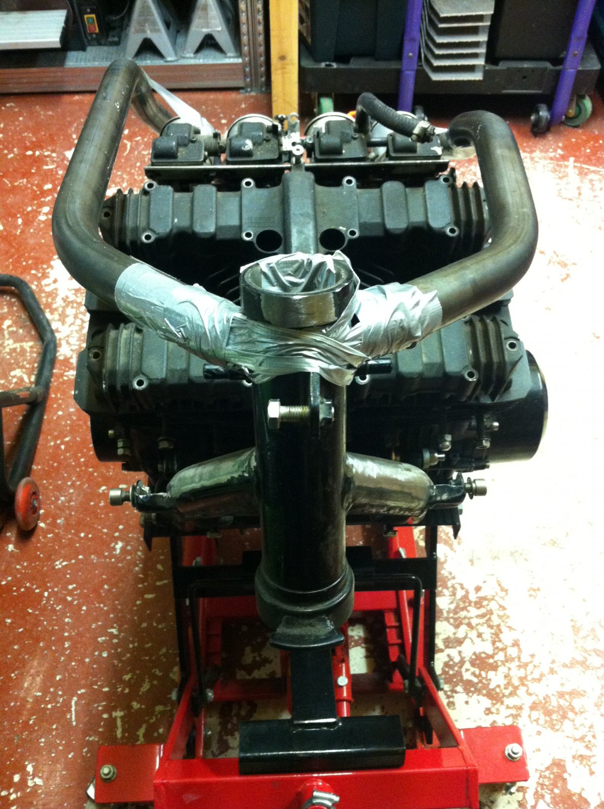

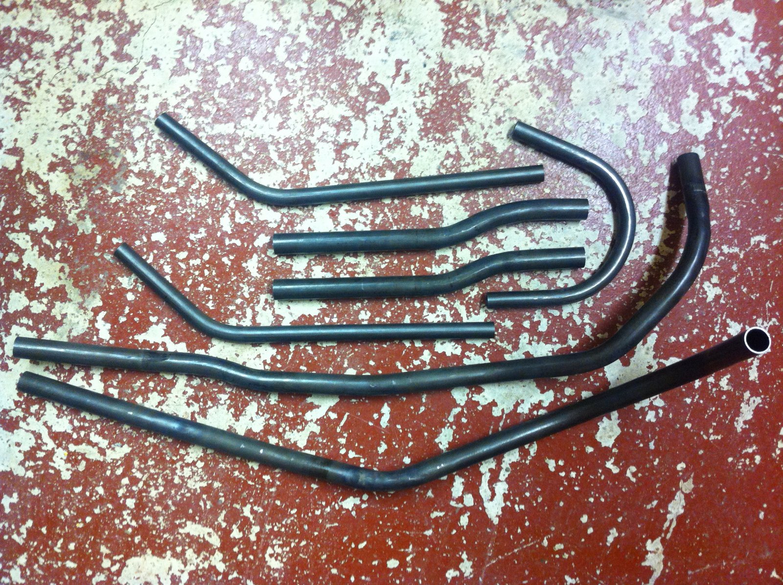

  9. First trial frame tubes - now bending the proper ones and tweaking after double checking scaling and geometry from photo's and the Tamiya model. Gaffer tape works well and far easier than welding, before anyone comments ;)

  10. am an expert with gaffer tape. (cant mig tig or weld at all) but if you need a hand with the gaffer...

  12. TBH mate,, you should get your self a little ( 180 amp ) gasless mig machine to tack weld your bits together, you might be surprised at how easy it is to use :upyeah: ( oh , and a grinder ;) )
  13. Got a grinder already :Happy:

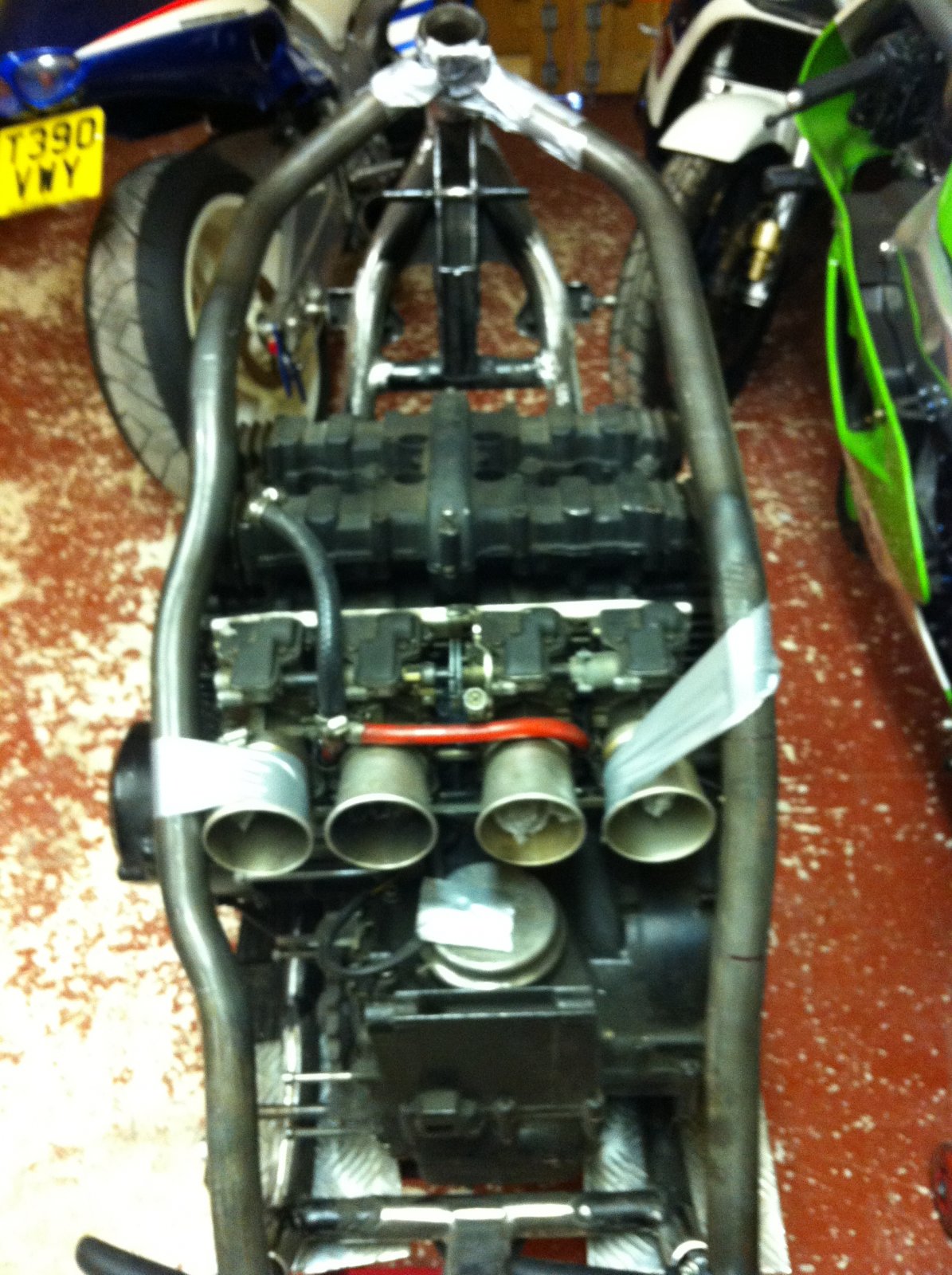

  14. Finished the new frame tubes, just need drilling for the head stock fitment and to fit each other. I'm sure they will need tweaking when offered up but very pleased with the result considering a month ago I didn't think I'd be able to achieve one good bend :Happy:
    It's fab learning new skills and means so much more on the build that I know every single facet of the geometry of the bike even if it did hit me in the eye at one point while I had no high Vis on :Inpain:

  19. I did insert ttonup quote but its gone,you wouldnt belive some of the bad bike work i have seen, did you leave enough length on the tubes to cut the headstock in? I usually file the tubes for the headstock to make sure i get a perfect fit,i have a tube notcher i use for the rest.
