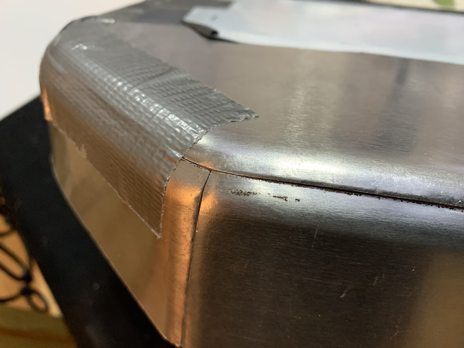

  1. After 3 months of hibernating I dragged the first 4 bits of the aluminium tank out of the garage last week and today I fettled them to prep them for welding. Hope they are good enough for Chad to weld - he's a hard task master :worried:
    Just need to arrange a trip to Hull now to have the gaffer tape replaced with weld - then on with stage 2 of the tank which could well be even harder :thinkingface:
  2. Yep he'll love all that glue on the joints. :eyes:;)
  3. Looking good otherwise. :upyeah:
  4. Isopropanol wipes before I take it :bucktooth: my frame was gaffer taped too remember :thinkingface:
  5. Otherwise :bucktooth:
  6. Before? Or after?
  7. Maybe "during"

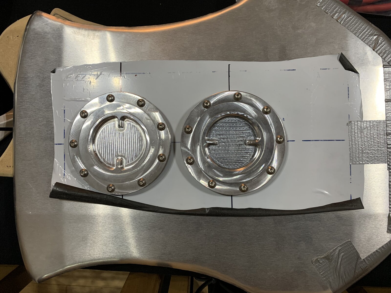

  8. Shhh, I'm measuring filler cap positions :mad:
  9. Mum's the word then.

  14. Just clean the tape glue off it,i will wire brush and acetone clean it
  15. Yeh, got some isopropanol wipes :):upyeah:

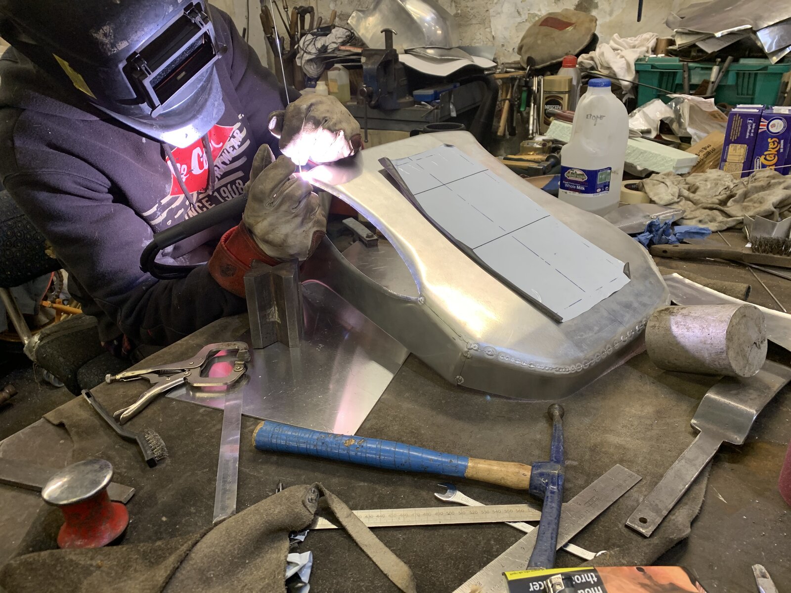

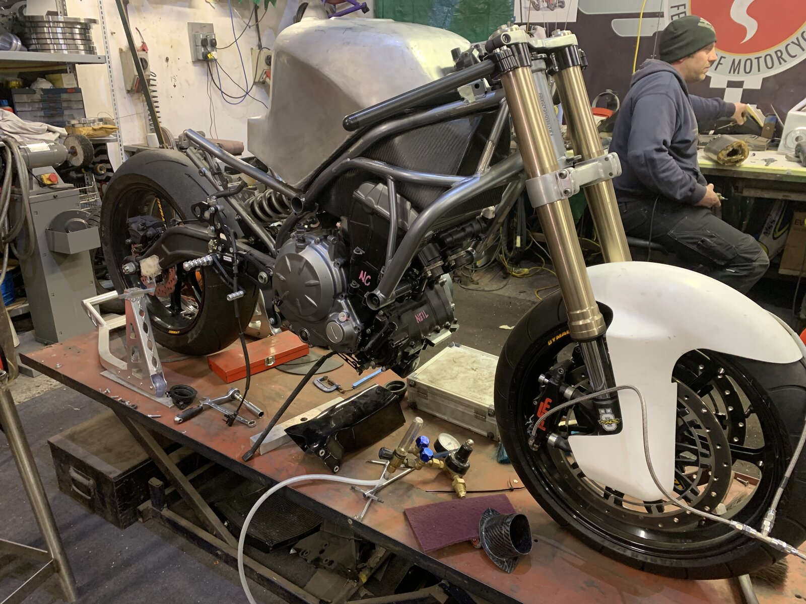

  18. Back from Chad's Emporium of Strange & Wonderous things, 1st Stage of the Tank tacked up and the headlamp / fairing / oil cooler bracket is welded too - now for the pub - good day all round :blush:
    Pic of the tank during the welding and a couple of other interesting items in the workshop...
