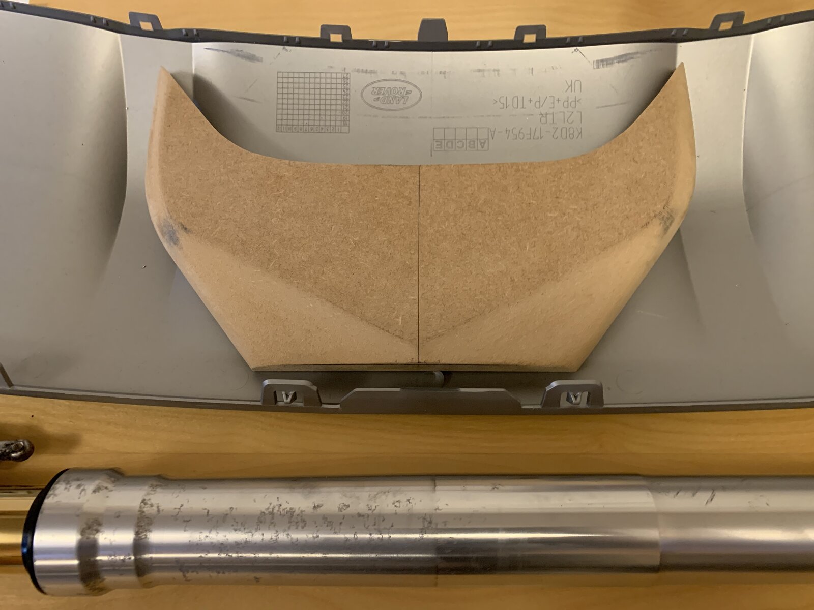

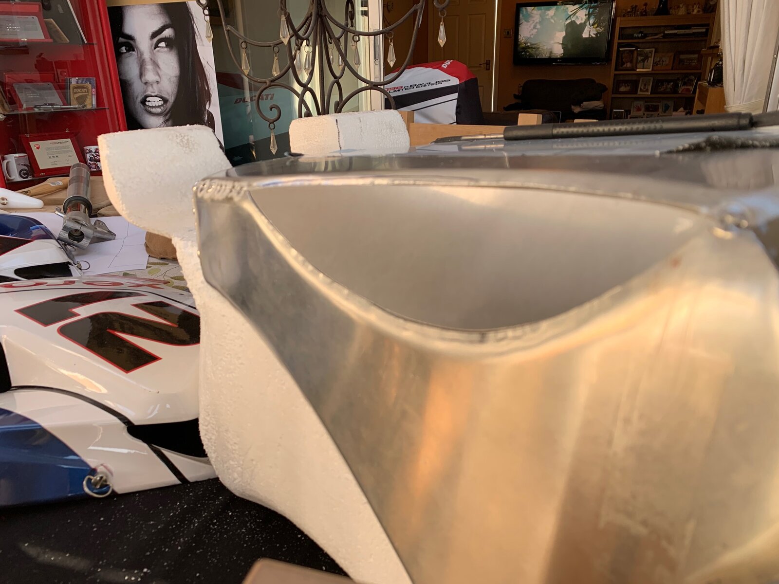

  2. Been improvising with formers for the next bit of the fuel tank - a bit of Land Rover plastic, some shaped MDF and a Ducati 999 fork leg - still a way off fitting but getting there, but now it is time for beer :)

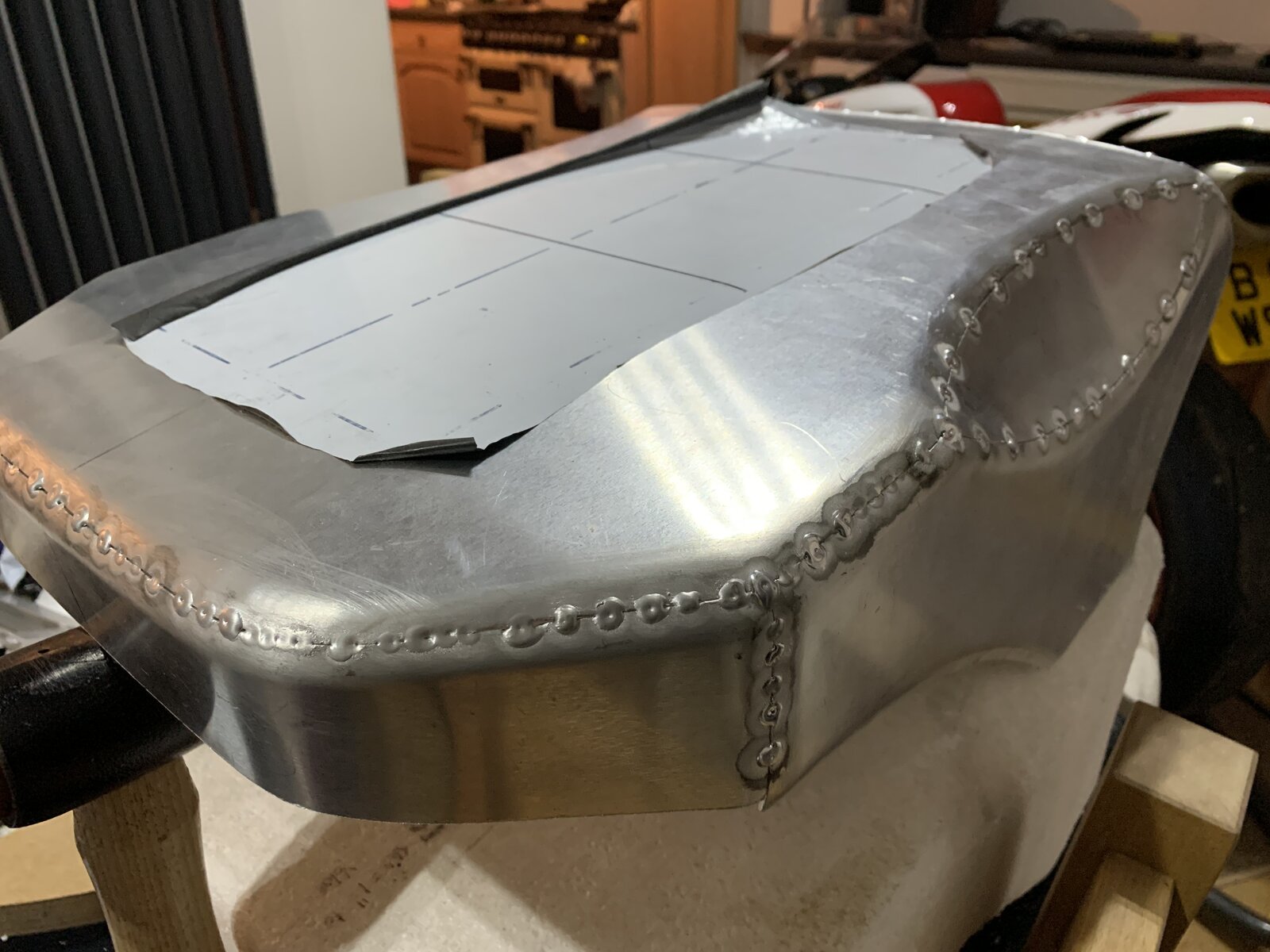

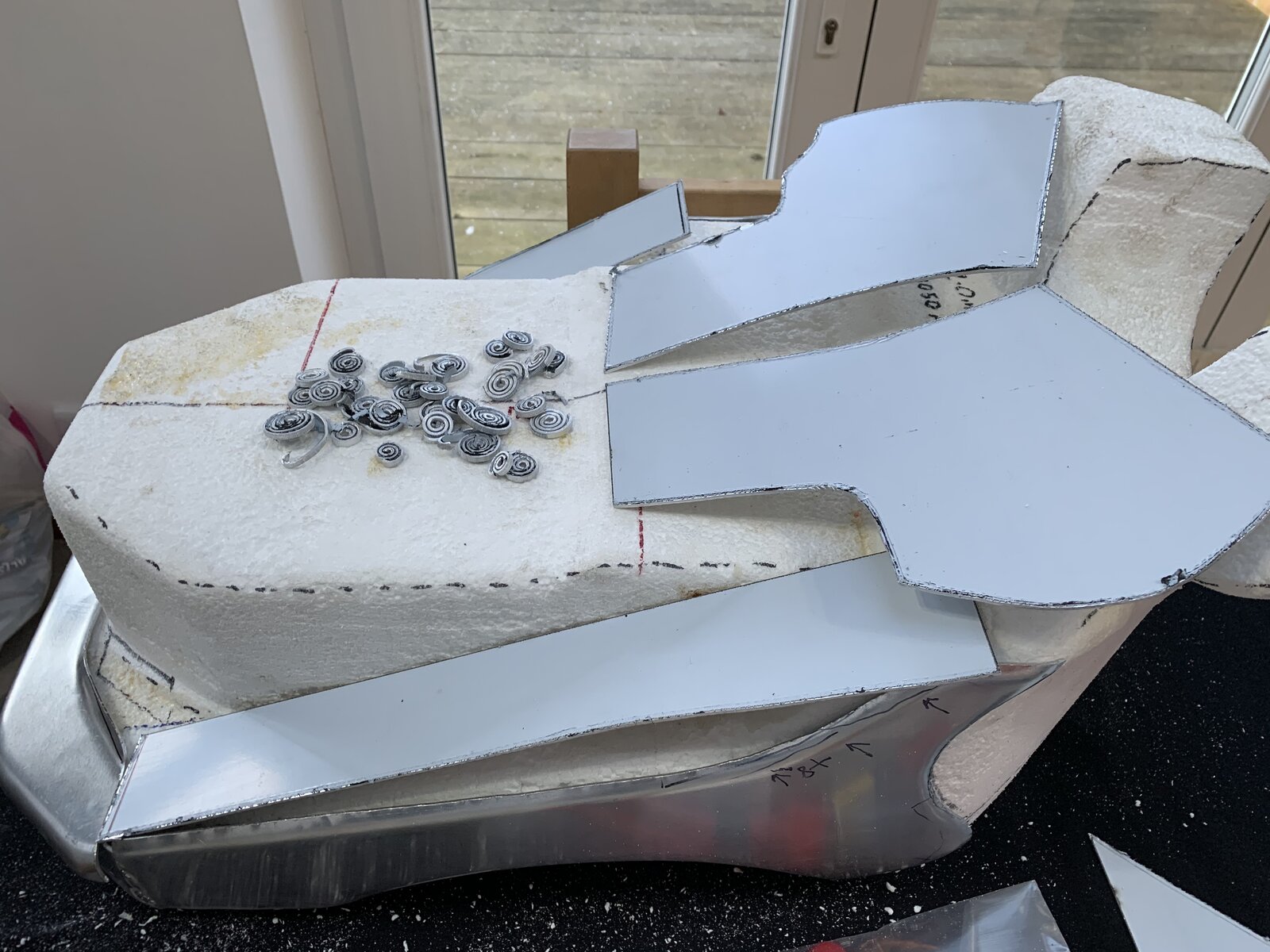

  3. More hand joggling today :no_mouth:
  4. Good joggling there. :upyeah:

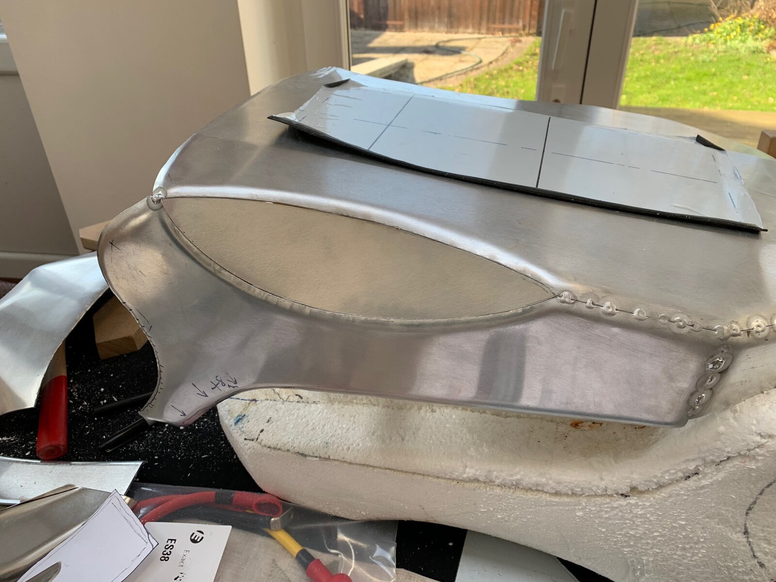

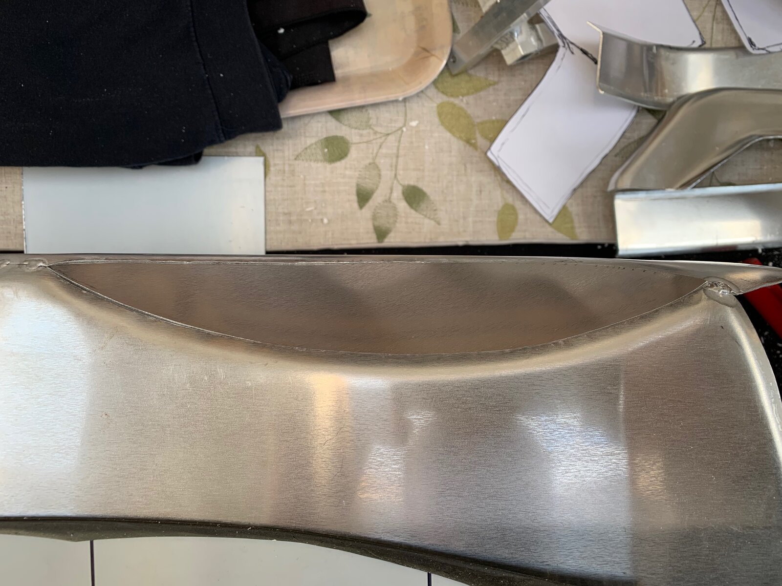

  5. A bit of social distancing this afternoon - rear panel fitting better and the R/H side curved infill is now tuned and fitted after much filing... L/H is next.
  6. Second picture on the right it's sticking up a bit, just needs a bash, otherwise it's looking good.
    :upyeah::eyes:
  7. That gets tapped into place once the tacking starts, I left it for Creamy but you fell for it instead :yum

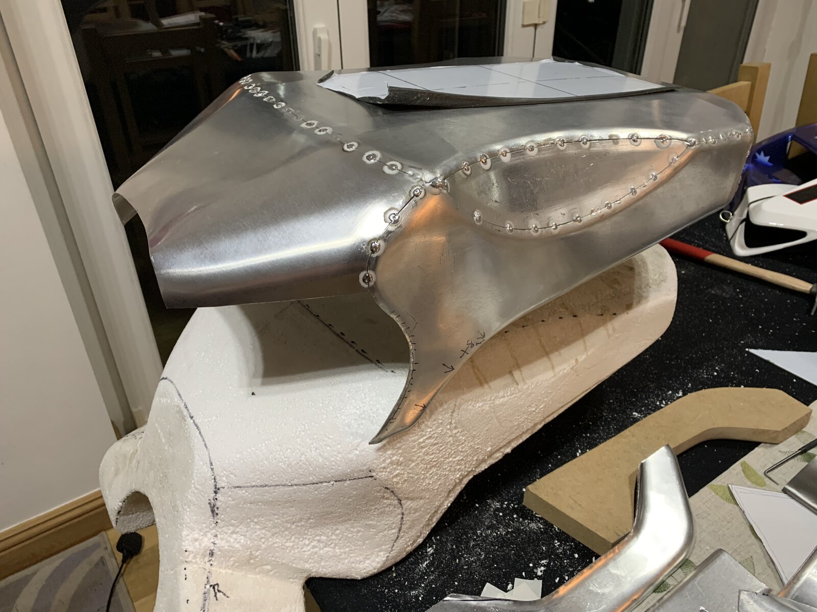

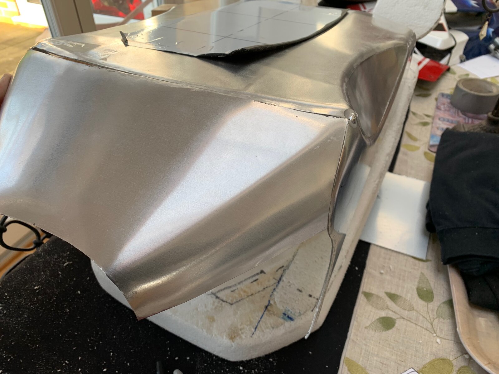

  10. Other side done :) and yes I need to tidy the dining table and living room too :eyes:

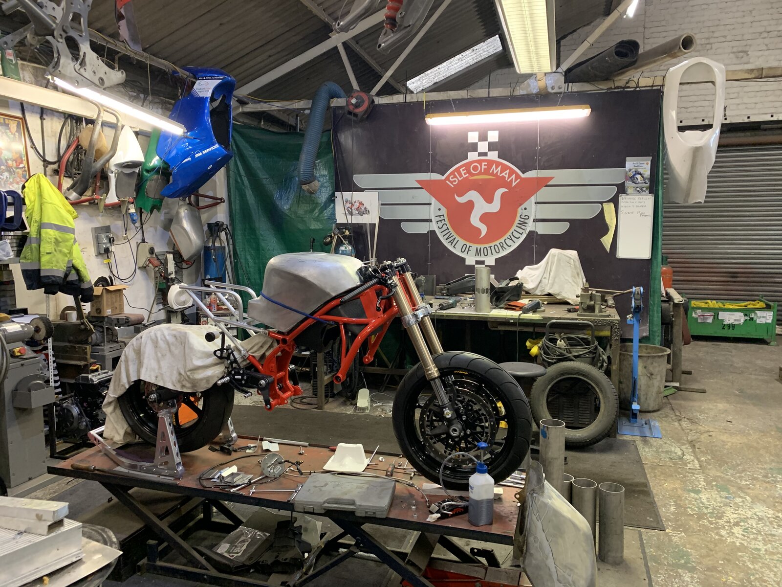

  14. Today I was self isolating in my Van all the way to Hull, then I was self isolating in Chad's workshop maintaining a safe distance o_O
    Just got in before the lock down so now I can progress the next stage :)
