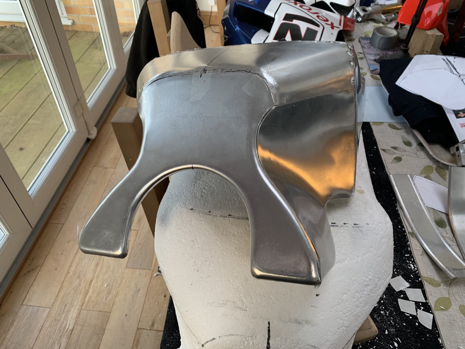

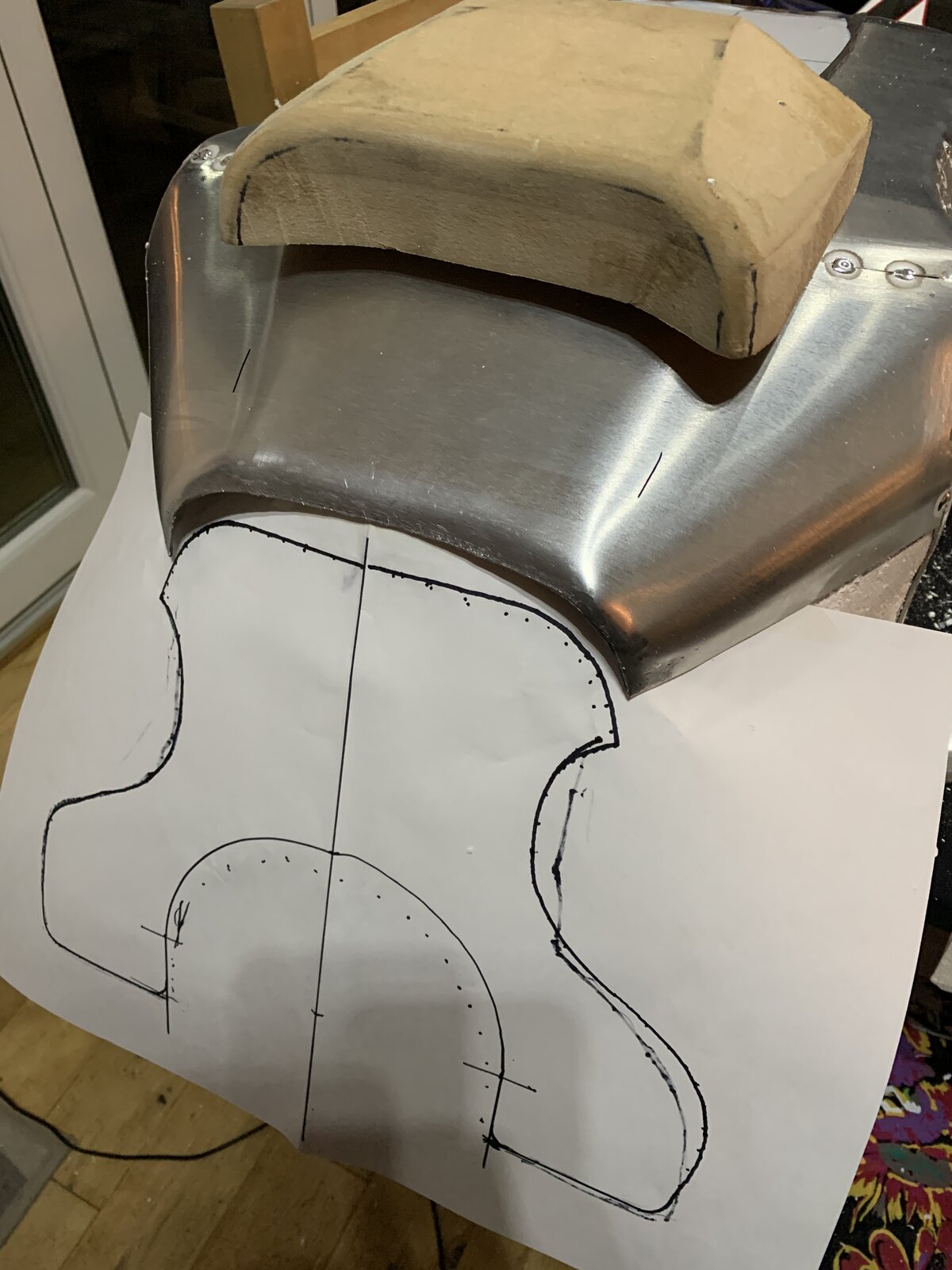

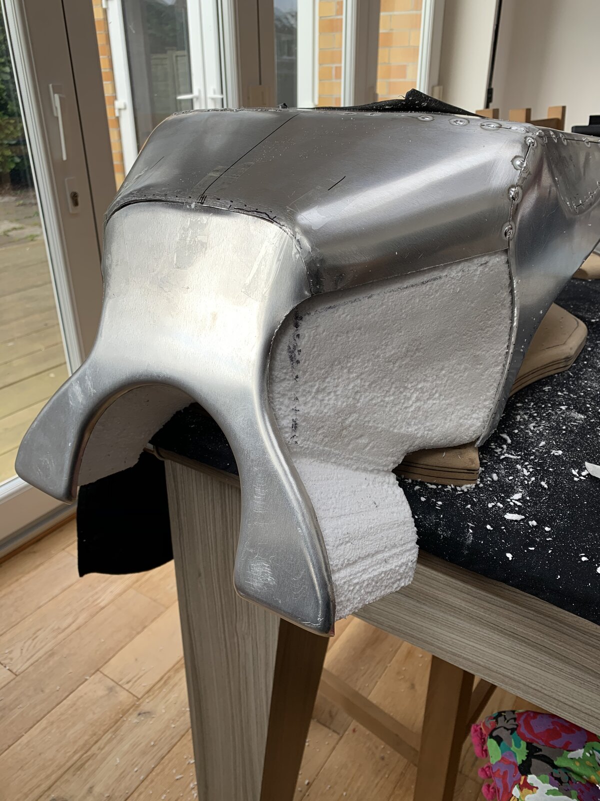

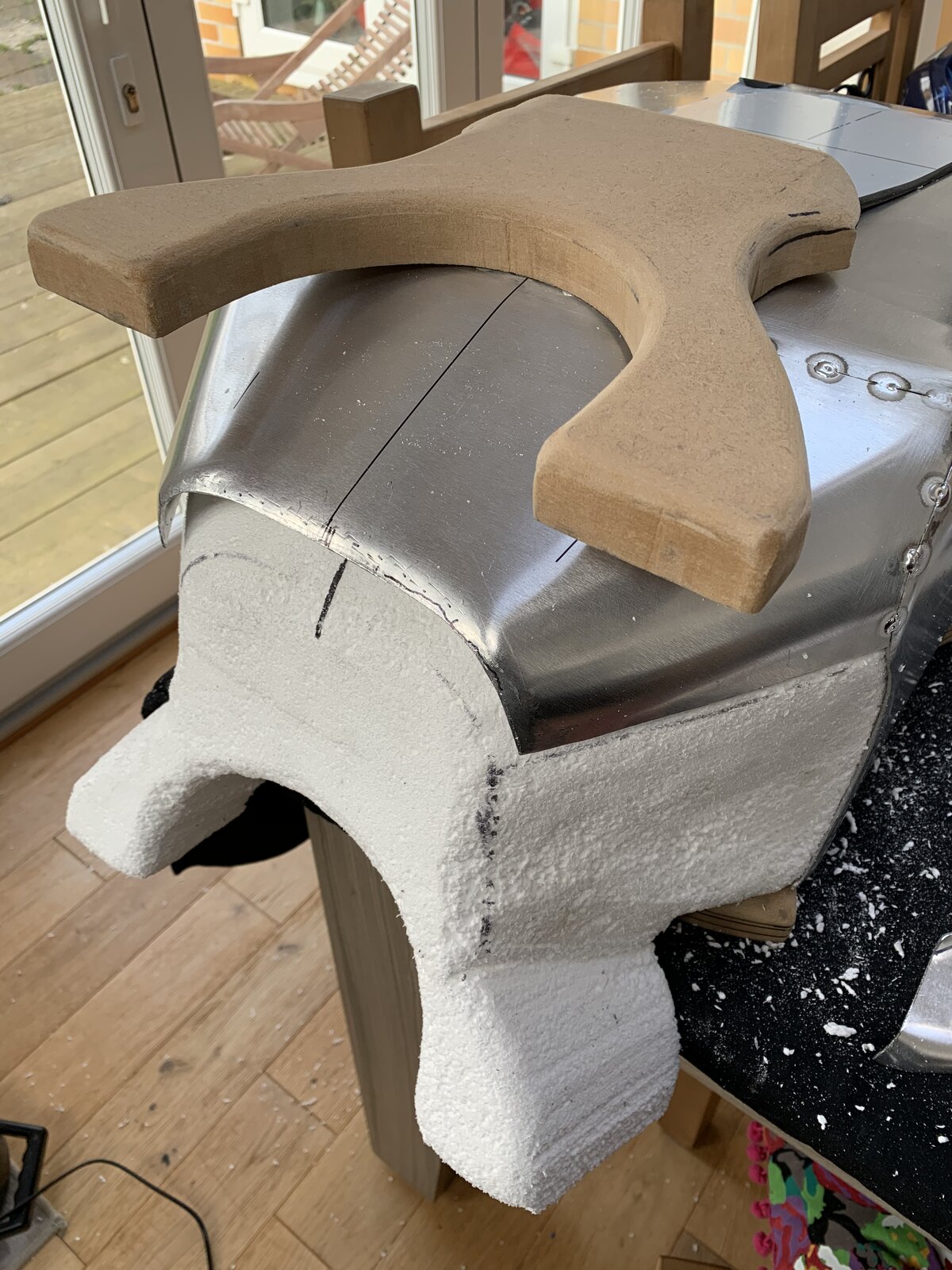

  6. Spent 15 mins every hour (between lazing around) to make an MDF former for the rear curve on the tank, bashed the aluminium around said former.
    Just done a rough out for a pattern for the rear panel - now time for wine :)
  7. And more progress! :eek:
    Former made for the rear panel, Aluminium twatted into shape, just a little fiddling to get the final fit sorted and I can start on the two rear side panels.
  8. It looks brilliant. I wish I had these skills.
  9. So do I :worried:

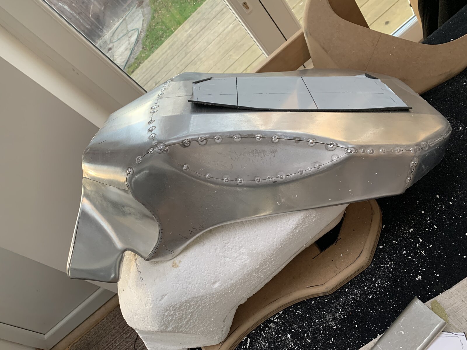

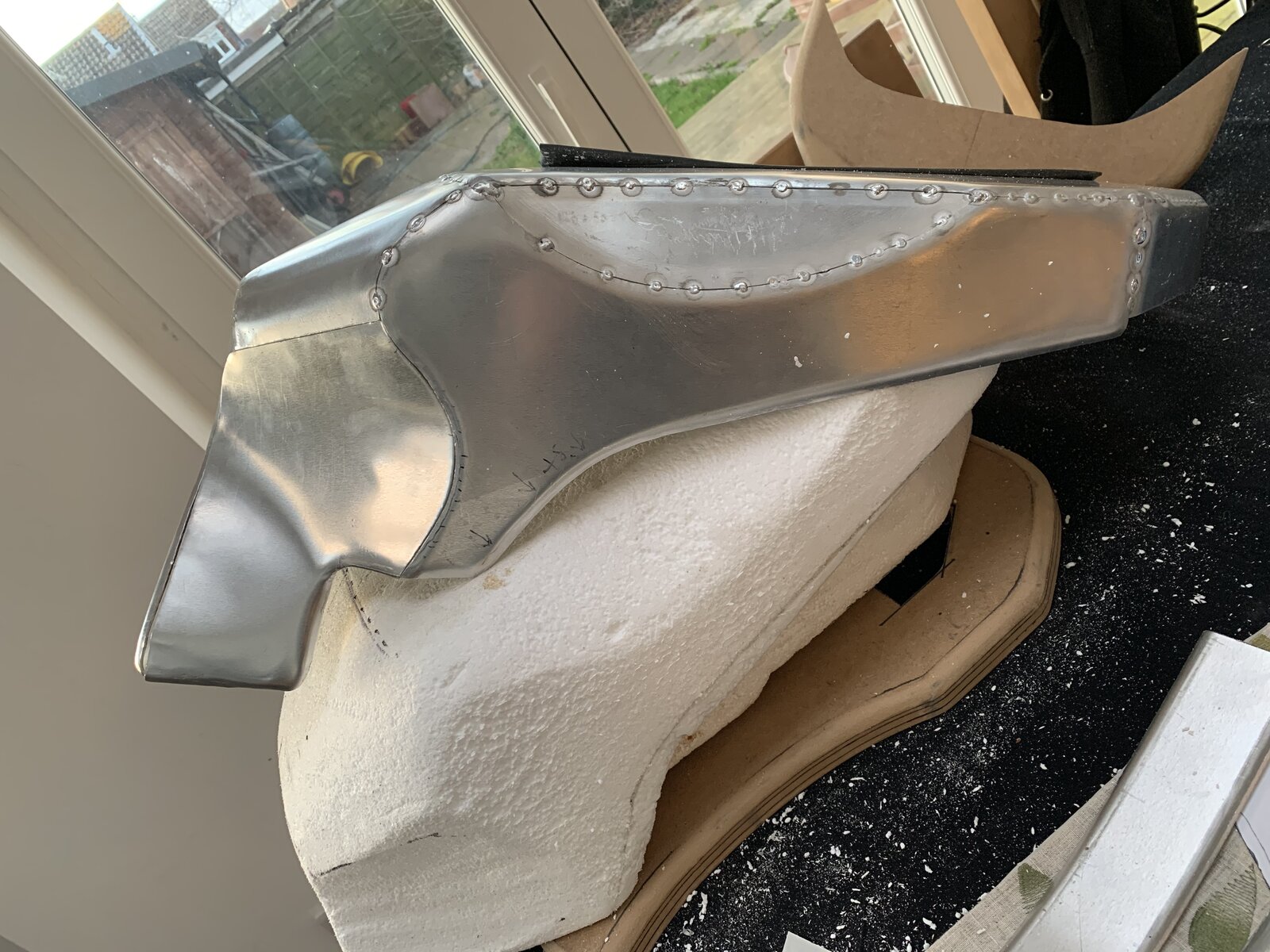

  10. Gritting my teeth having to say this but, well done very impressive.
    Steve
  11. Soooo nearly a face palm :)

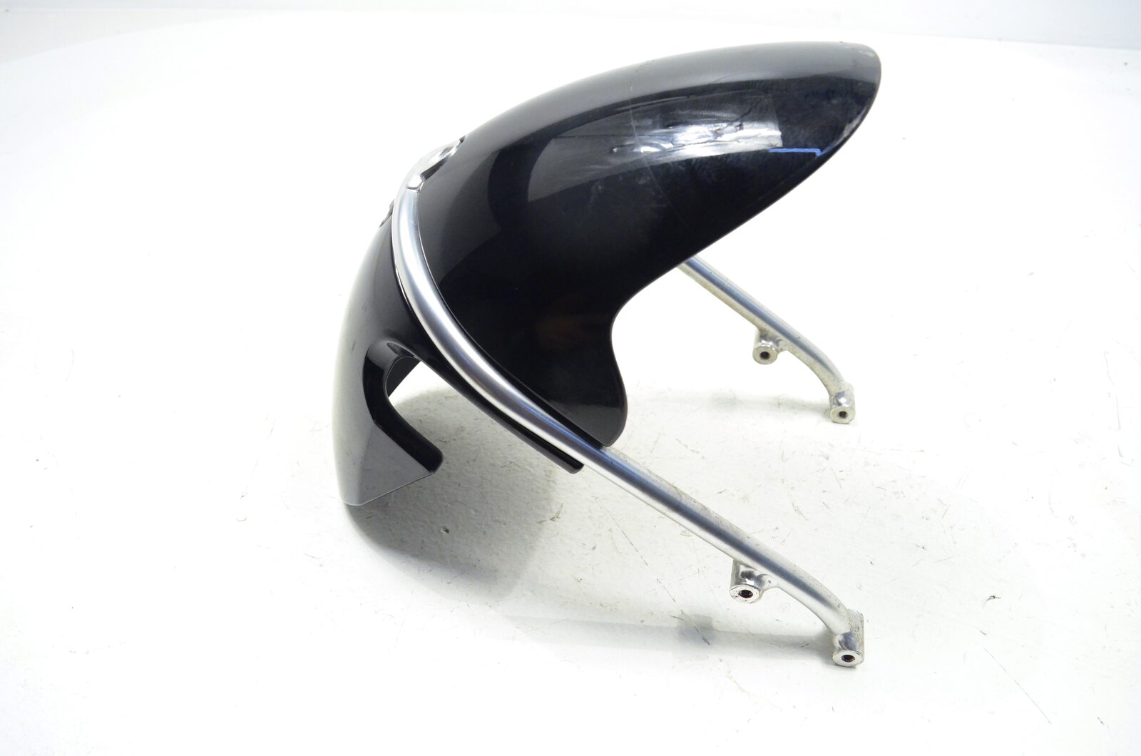

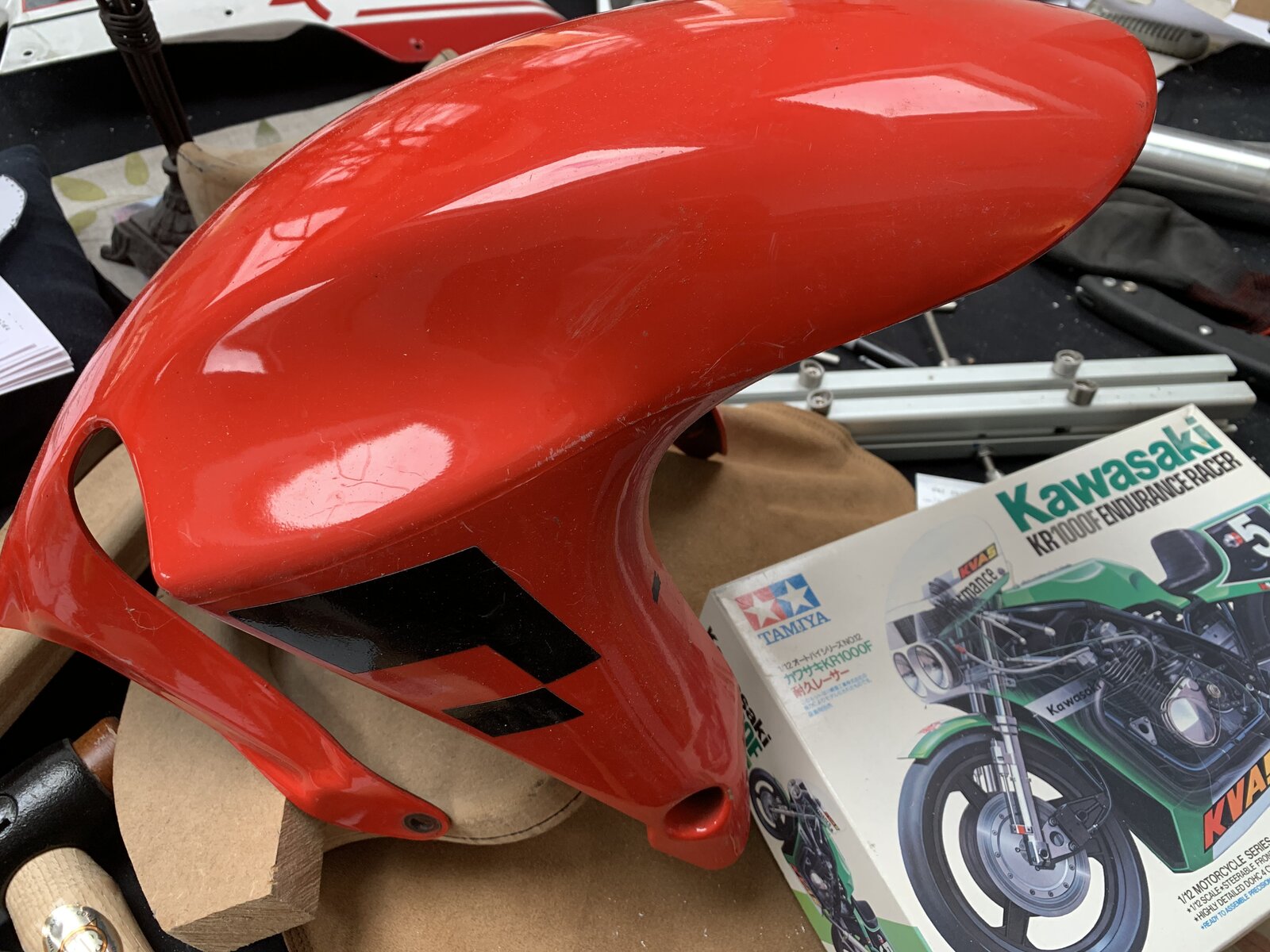

  13. My RSVR Front Mudguard arrived today - now need to cut it down, strengthen it with Aluminium and try and disguise it so it looks like the one on the box picture while keeping the mounting points to the Aprilia Ohlins forks... :thinkingface:

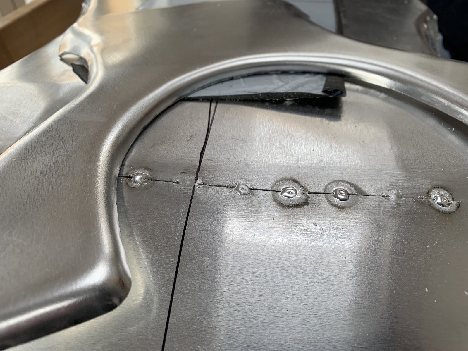

    Only the LH Rear Quarter to do and that's the entire top of the tank finished ready for welding - thanks to the unexpected month off work!
    I will then be stuck until I can get to Chads again :(
  15. For the front mudguard, wouldn’t it be easier to start with a Norton style ally mudguard and make up a fork brace to mount it. That’s probably how the original one was made?
  16. I did think of mounting it higher up - the original was mounted to a fork brace. Although I'm aiming for a close replica, having decided to go with modern suspension, brakes and wheels I thought I may as well utilise the mudguard mountings on the Ohlin's forks. I can slim down the uprights and reinforce with aluminium, then paint them black - so only the top section is painted as the original. I'll see how it goes but may change if it doesn't look good...
    :):upyeah:
  17. The Sport Classic has an interesting combination to mount an old style mudguard on modern forks:
  18. Yeh, that looks good - but I want to disguise the uprights rather than make them a feature - my aluminium strengthening will be internal with 2mm sheet.
