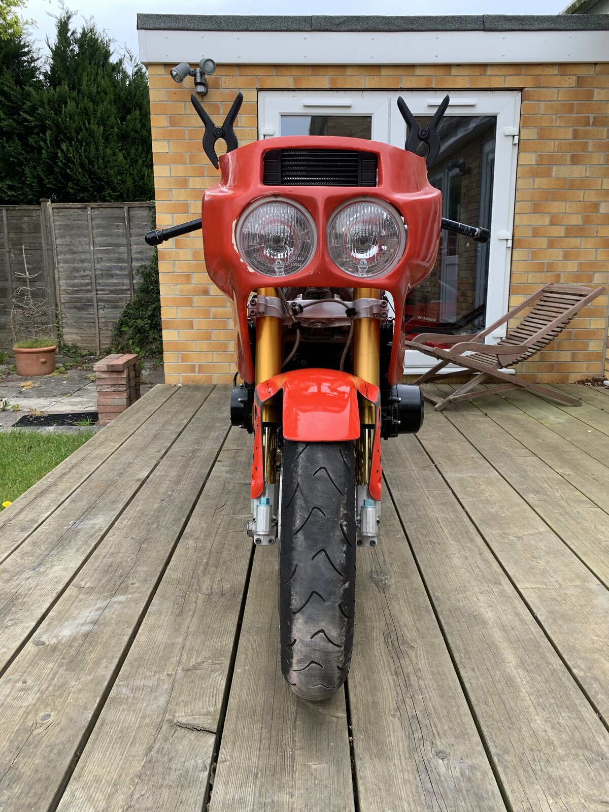

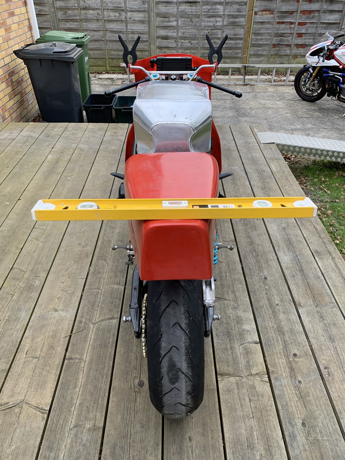

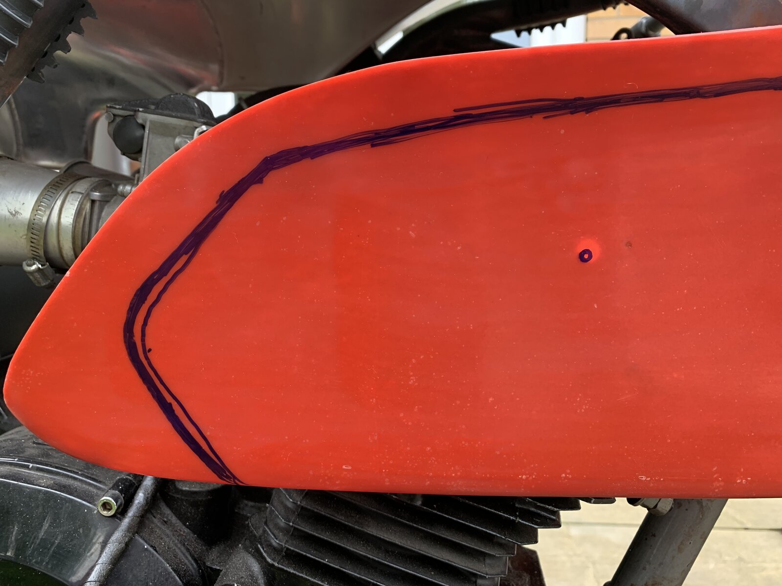

  2. All bodywork marked for fitment and aligned - marked the fairing where it needs trimming to match the original better.
    Used a mini torch to shine through the fixing points...

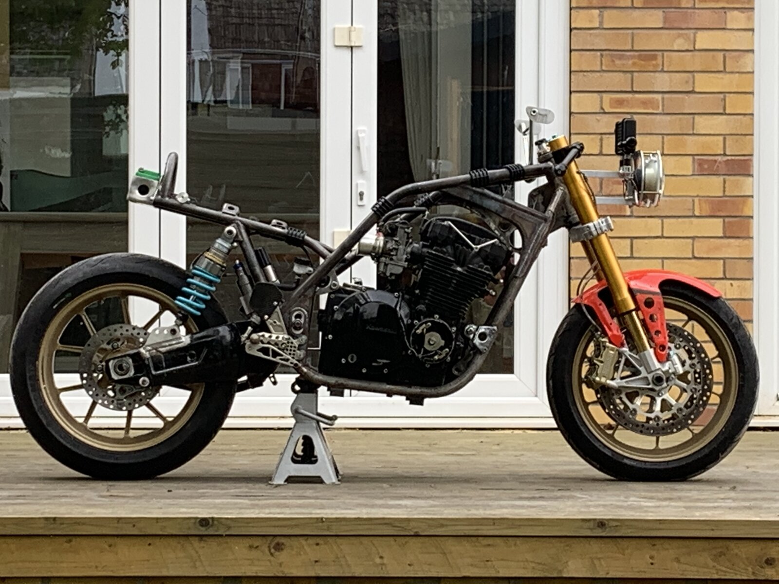

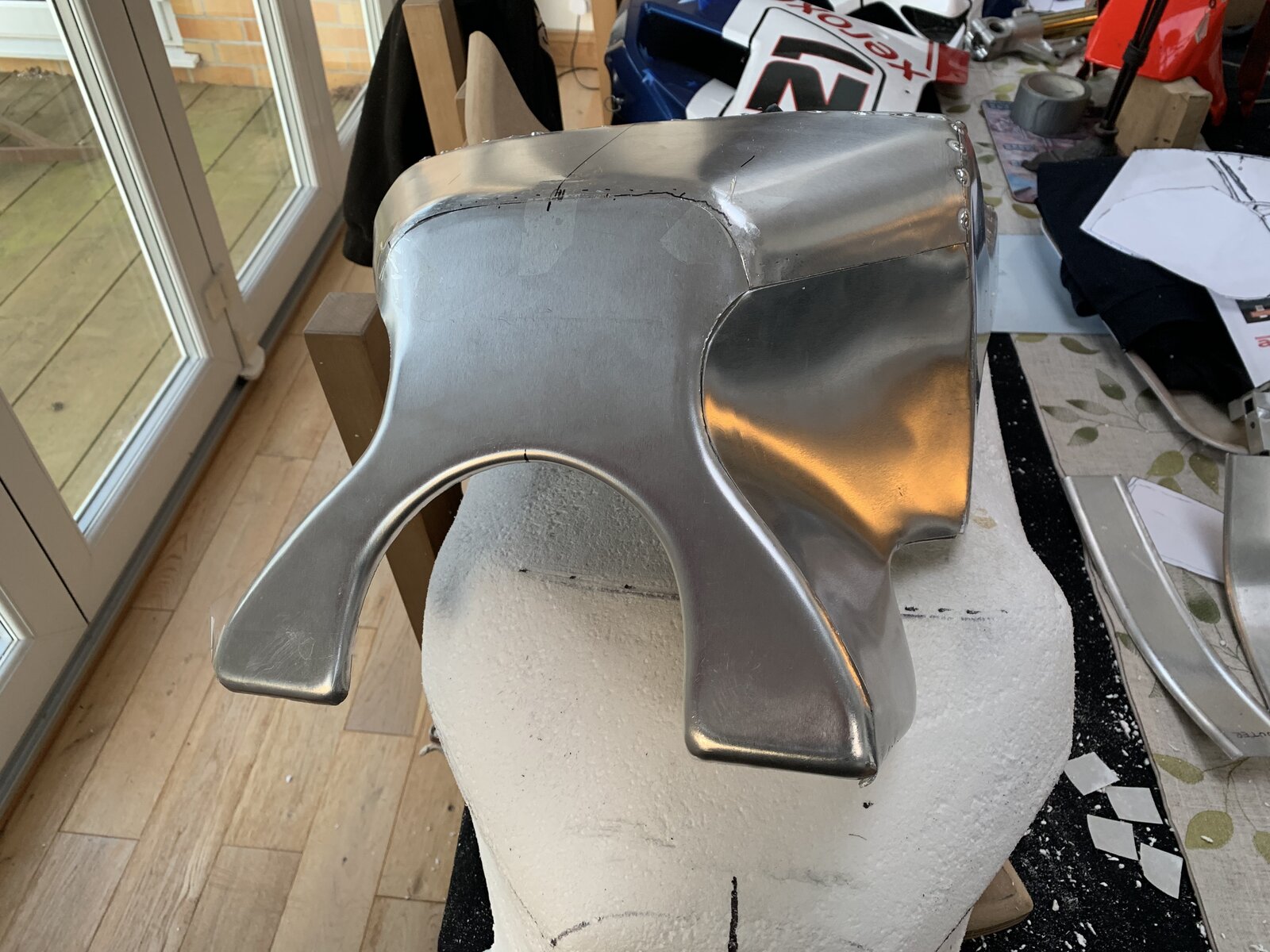

  3. Side view with no bodywork:

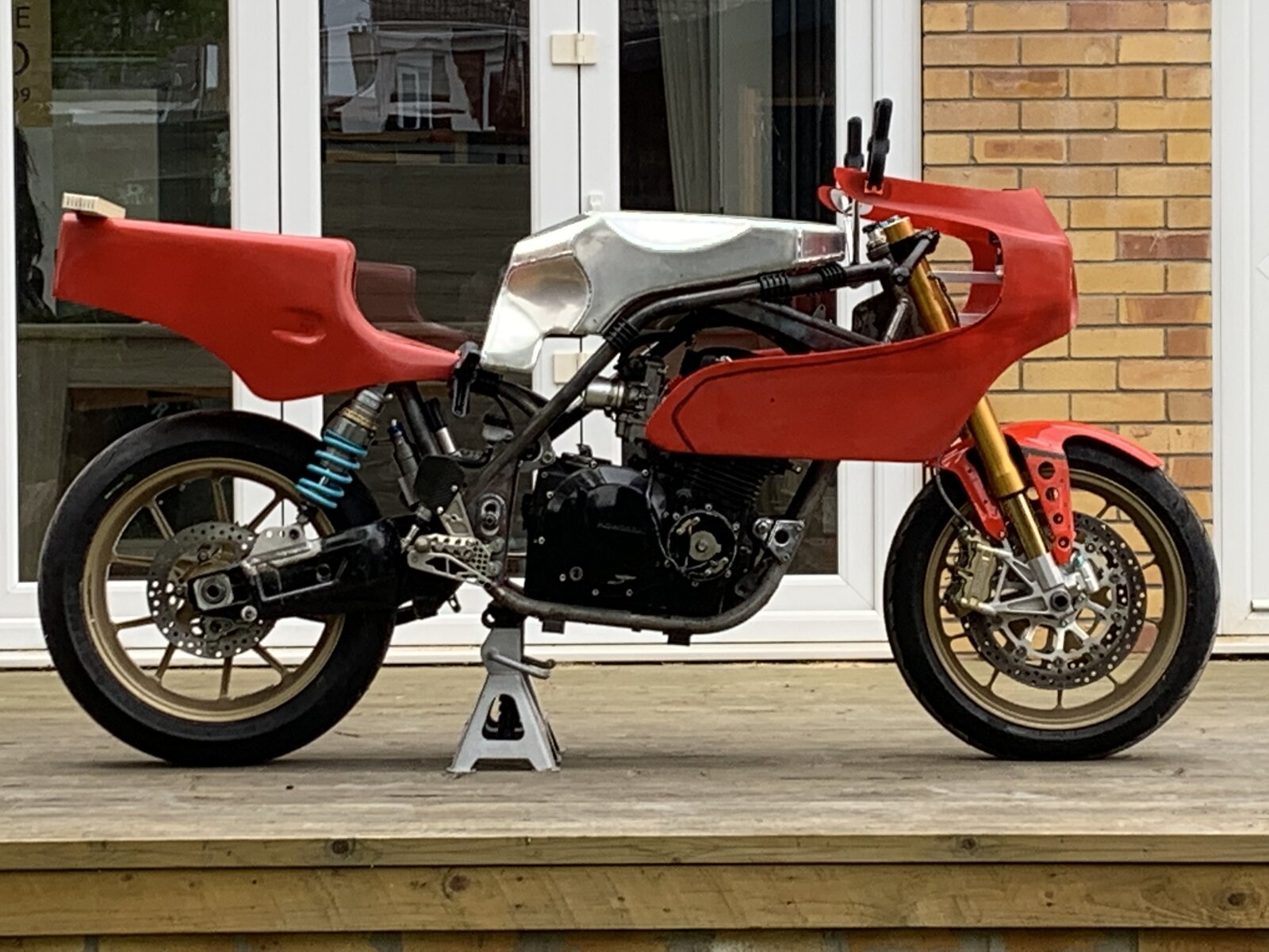

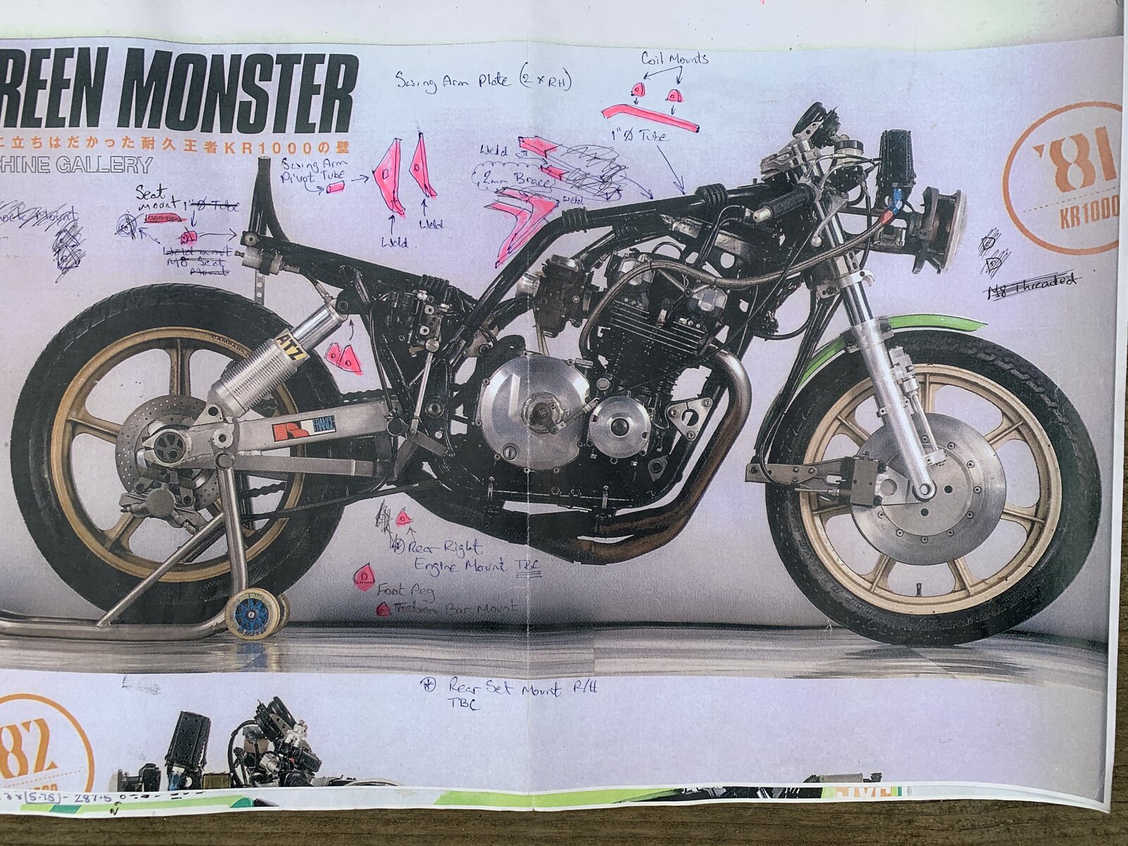

  4. Side view with bodyworks (apart from the belly pan which I couldn't be arsed with - it needs altering anyway...)

  5. Love the antlers and aero foil look goes, well with its startled expression
    Good stuff.
  6. That's not an aerofoil, it's to take cyclist out if they don't leave 2" of room :thinkingface: the antlers are antlers though...

  7. Love it!
  8. Great build mate, looks amazing......just one thing tho.....
    its gonna be an absolute ball crusher with that endurance tank under heavy braking! :eek:
    Jock strap and plenty padding! :laughing:
    Or is it for pootling to squires and back only?
  9. It has a cut out for the essentials :bucktooth:

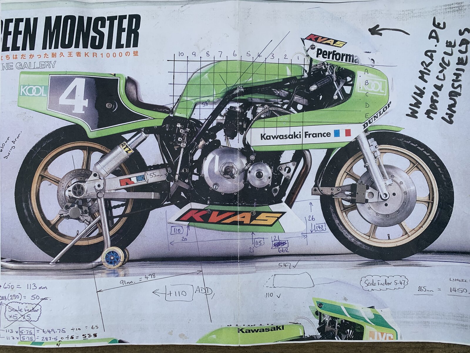

    And have kept this image because I like it:
    I downloaded this many years ago and have been looking for a larger size one for years to get printed in a large format.
