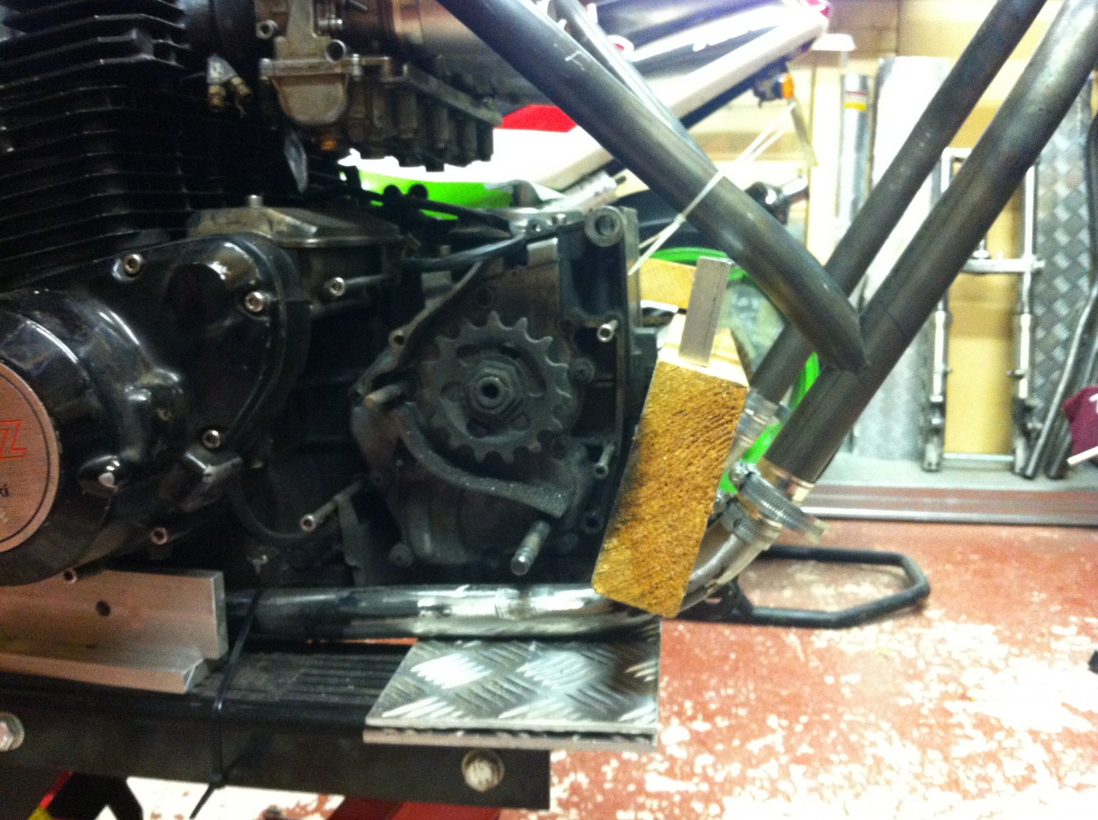

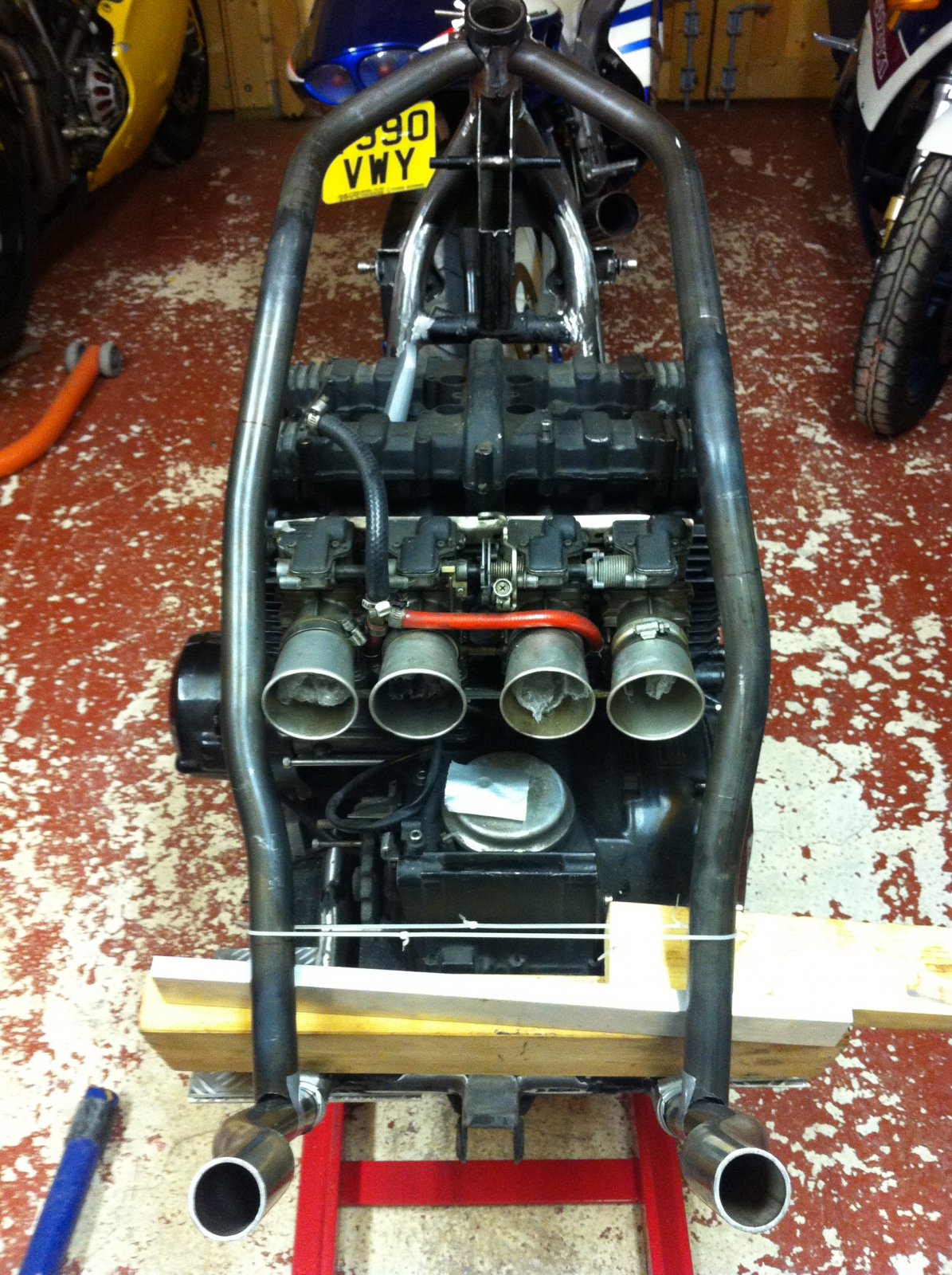

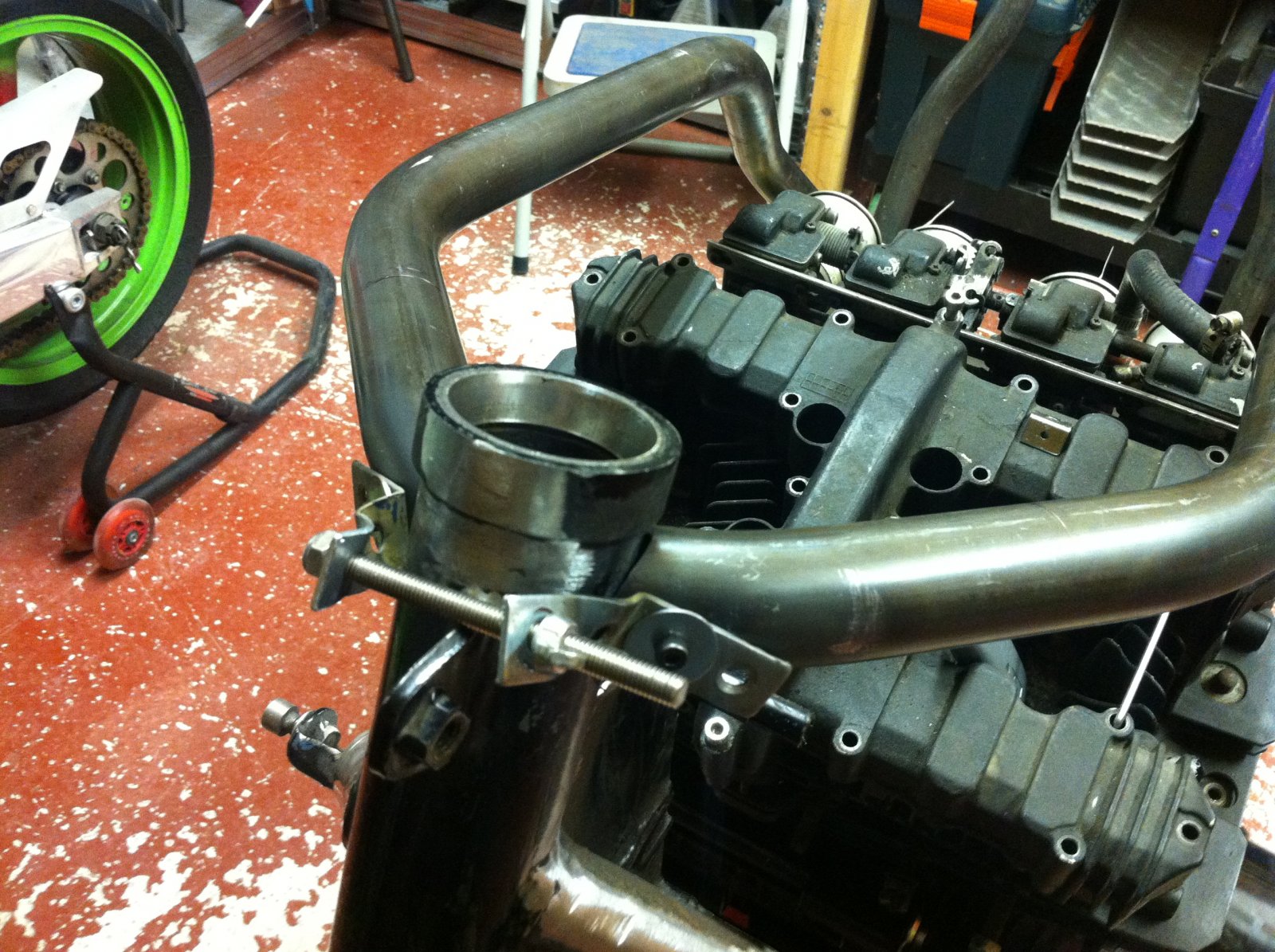

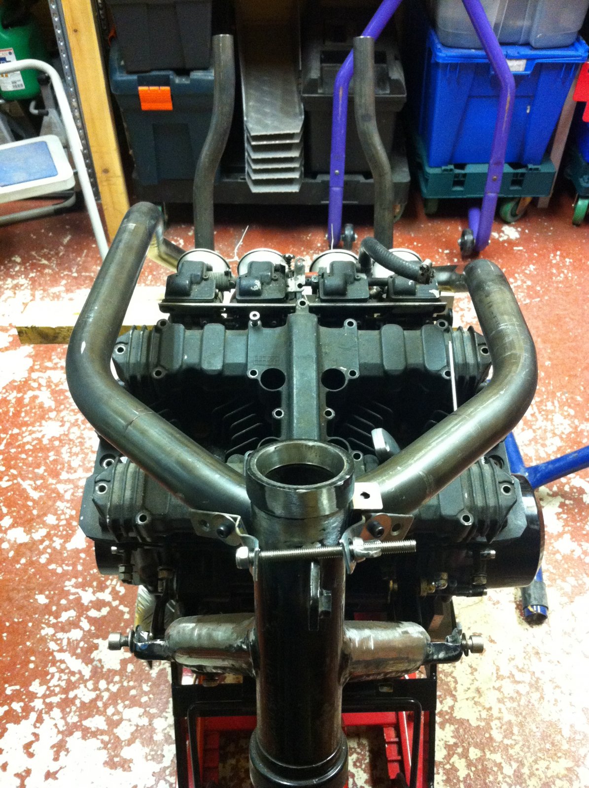

  6. Drilled & tapped the top of the main frame rail tubes with an M4 thread so I could clamp them to the head stock to allow me to get the hole saw cut right for the rear seat rail support tubes...
    A little more fettling and I can hole saw the seat support tube uprights to length (held on with jubilee clips and back bean tins at the moment just behind the lump of wood) then manufacture and fit the seat rail tubes. Then it's nearly ready for weld stage 1 :Happy:

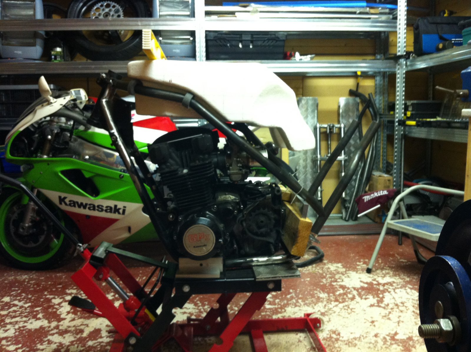

    This frame to look at is pretty cock on but due to all the bends and strange geometry, working from a model kit and scaling up from pictures there are a few areas I feel need a little tweaking. Don't think anyone would notice, but the second frame will have these little corrections and form the basis of the recreation version and this frame will be used on the 'on steroids' version of the bike.
