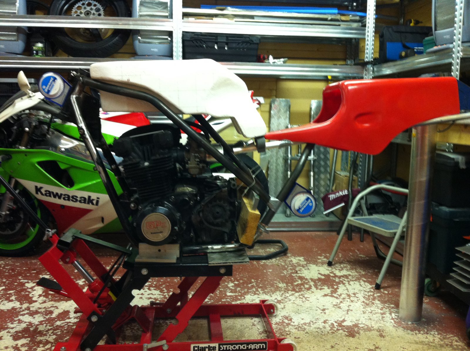

  1. Well, managed a little bit today.

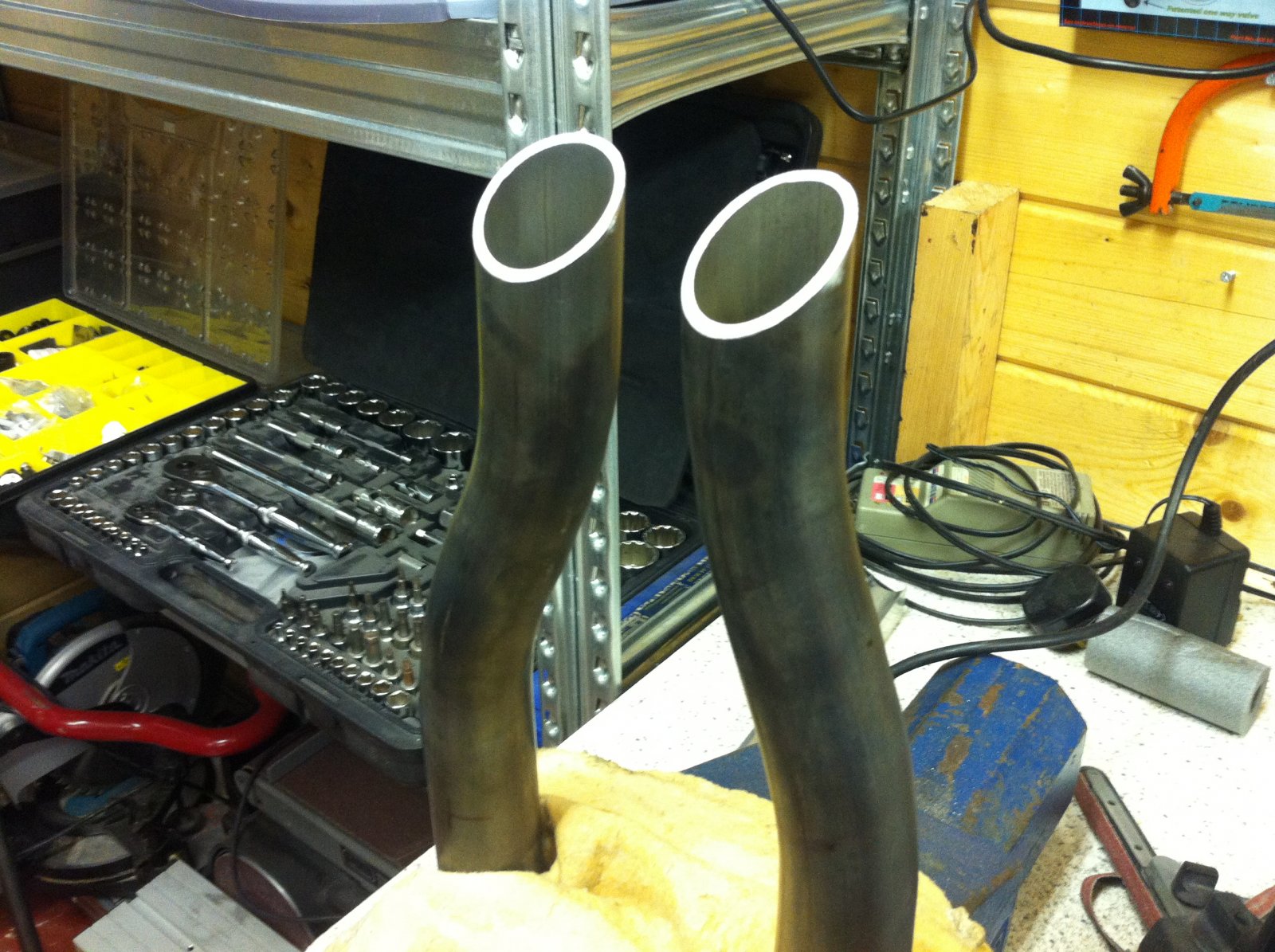

    Used the spare seat rail upright (dodgy bend) to check out the geometry and trial cut for the seat rail...

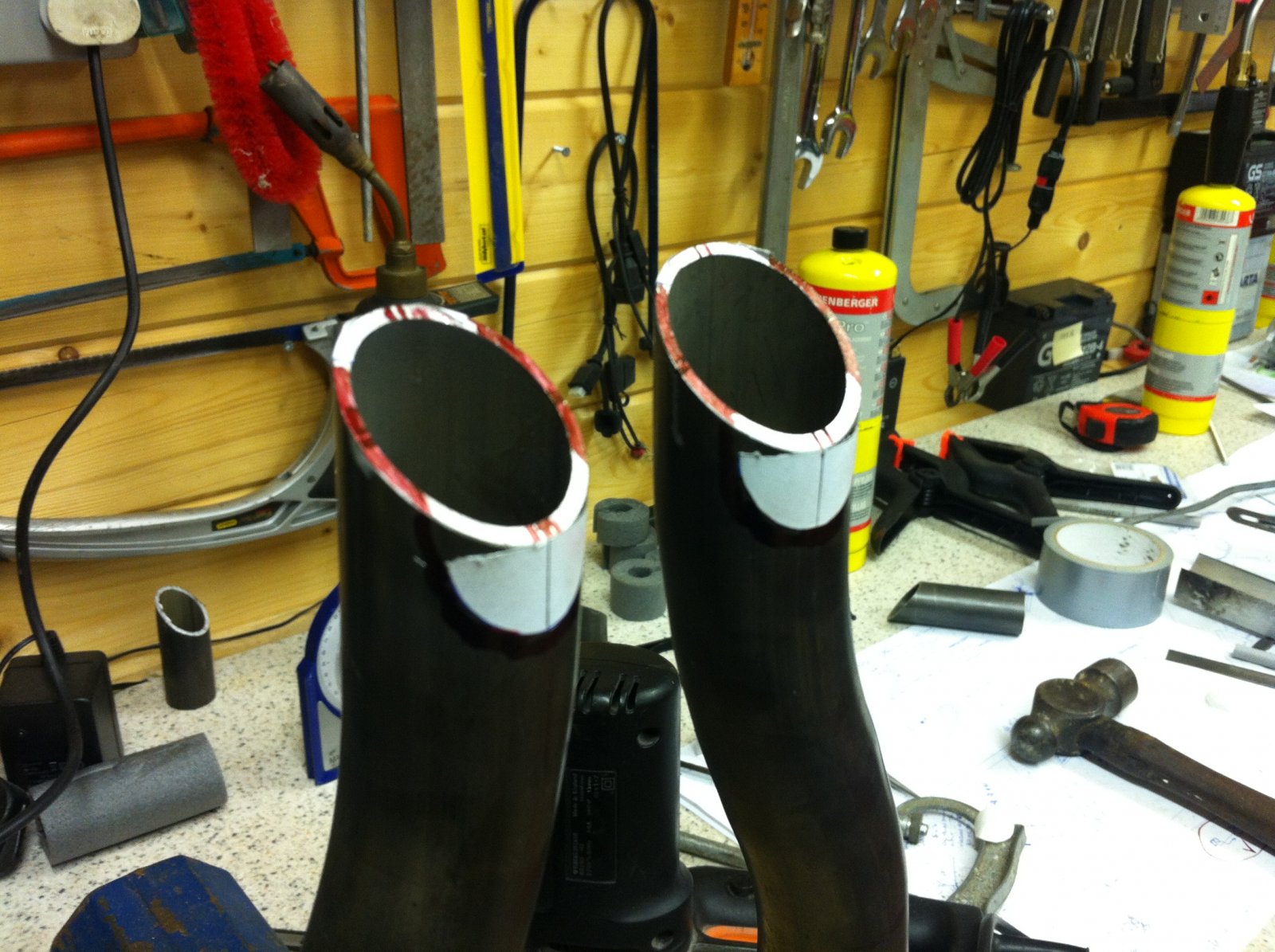

    Then prepped the two 'real' tubes for the cut which was a bit tricky - the rail is cut to 51 degrees...

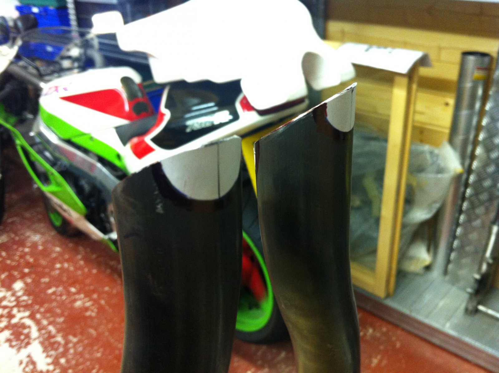

    Then they need to be cut circular for the 1" seat rail tube at an angle to the main centre line of 2 degrees - used a circular sticker to mark out prior to attacking with the powerfile...
    That's it for now...
  2. That is some sweet taping dude!!!!:D
  3. Thanks - interesting programme - if only I fully understood it I could perhaps use it :smile:
  4. OMG,, is that blood on those pipes,,,,,,,,,,,
    are you using hydraulic bender or is it manual one
  5. Have both but manual gave least distortion by far. It's not blood on the 'tubes' just strategically positioned ink on the no go area's for the power file as I'm pretty sure, although not entirely convinced, you knew ;)
  6. actually I thot it might be dye for crack testing.

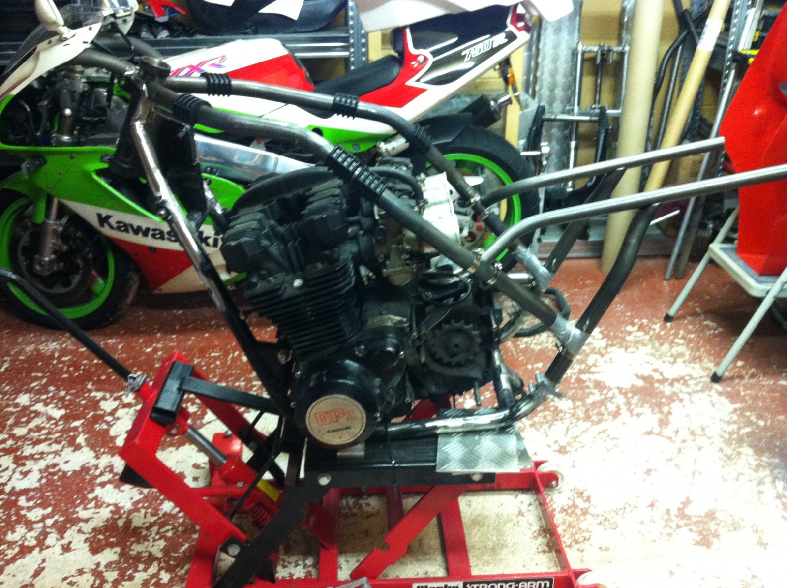

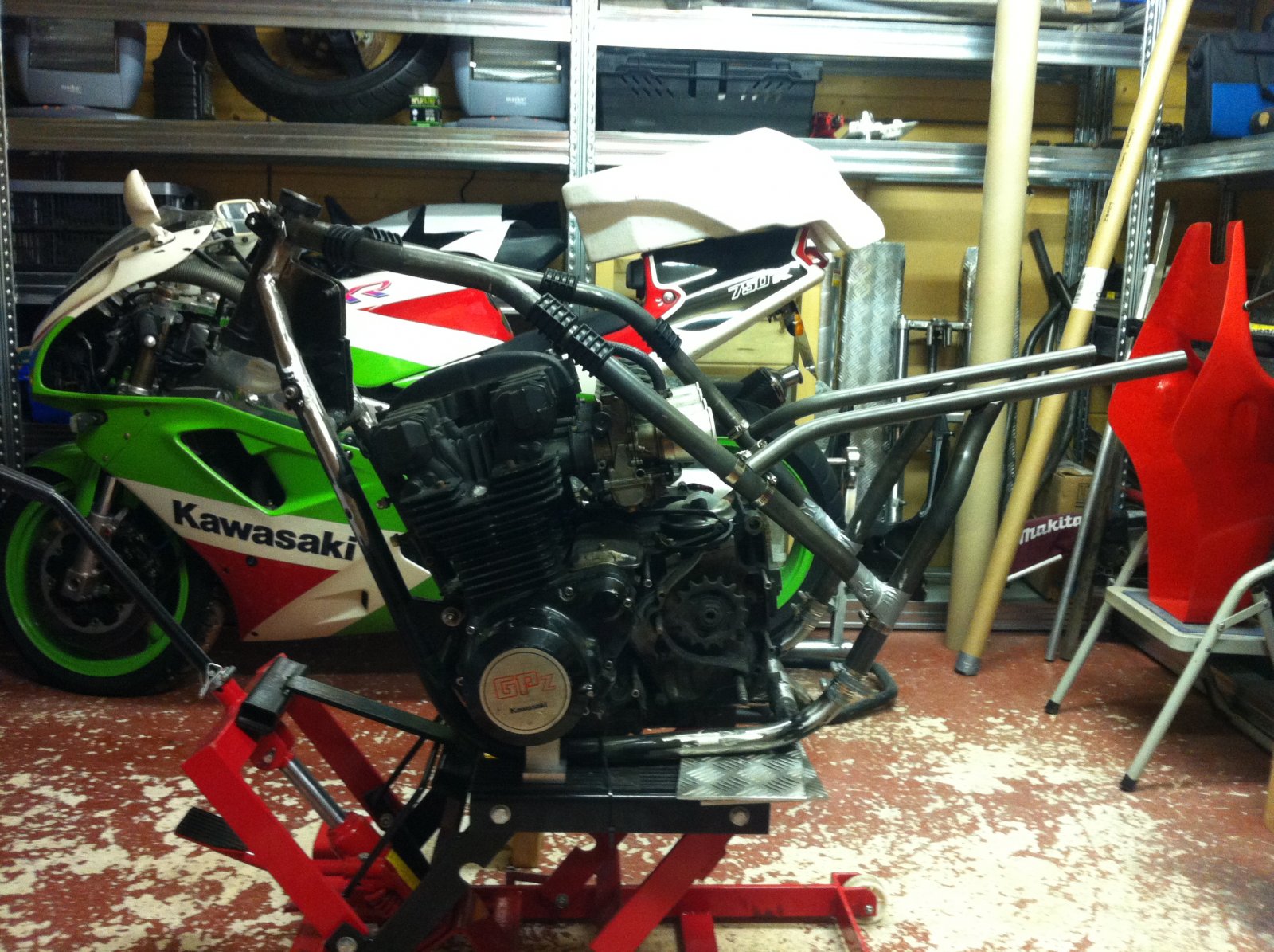

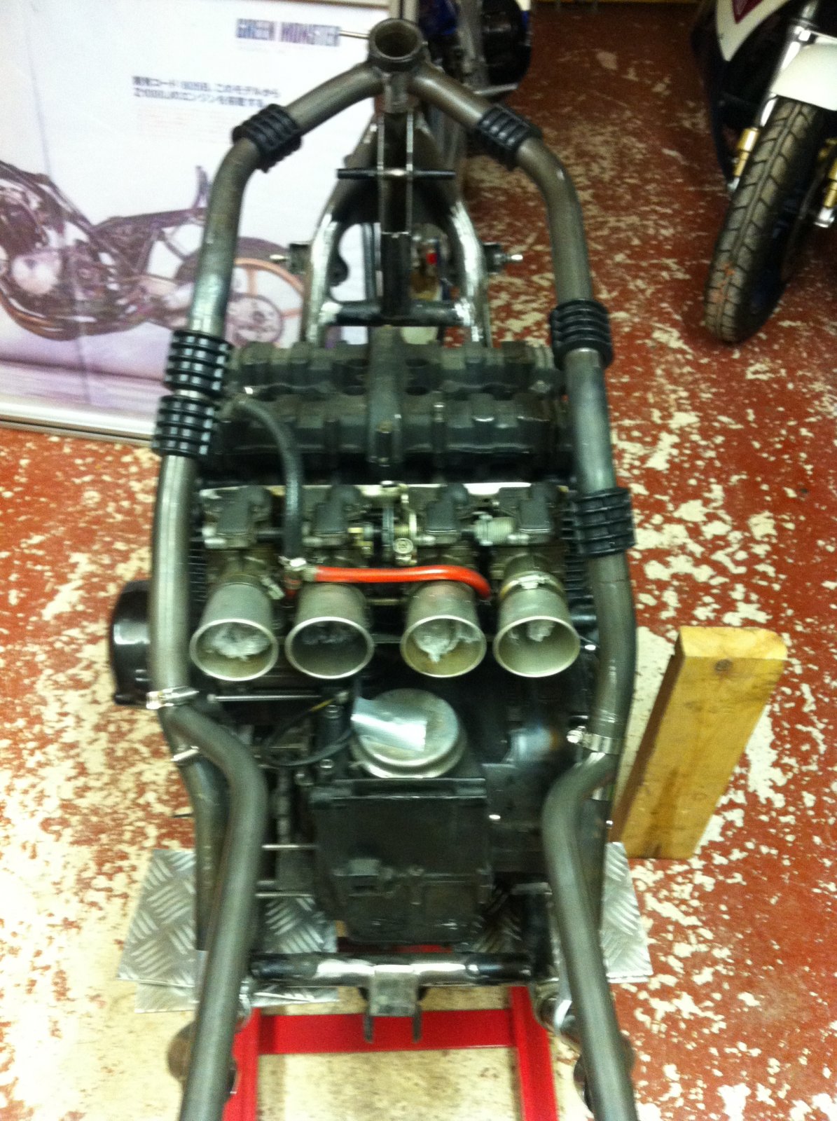

  7. Nearly there with the first stage of the frame construction - just a few tweaks to do to the troublesome seat rails.....
  8. reluctant as i am to big you up, thats pretty cool mate! (pics a bit blurry but unlike others on here....)
  9. That's not blurry, it's the frame wobbling :D
