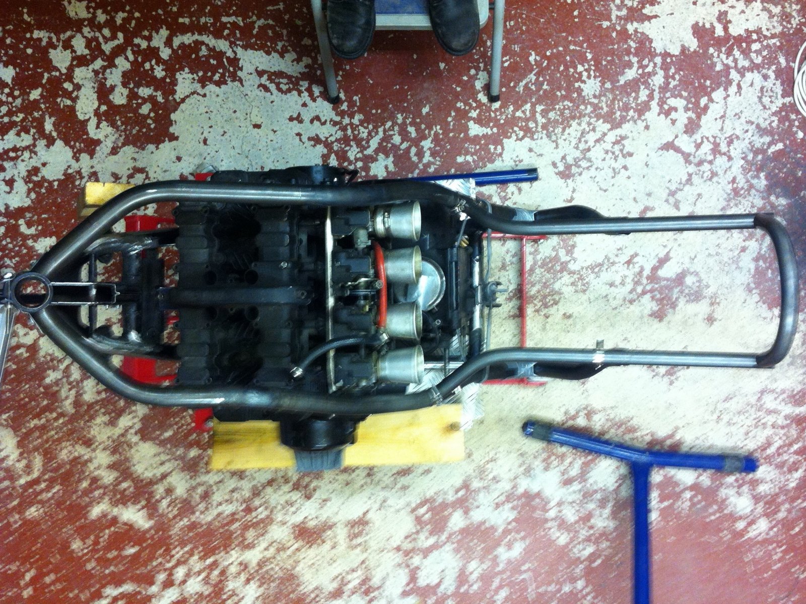

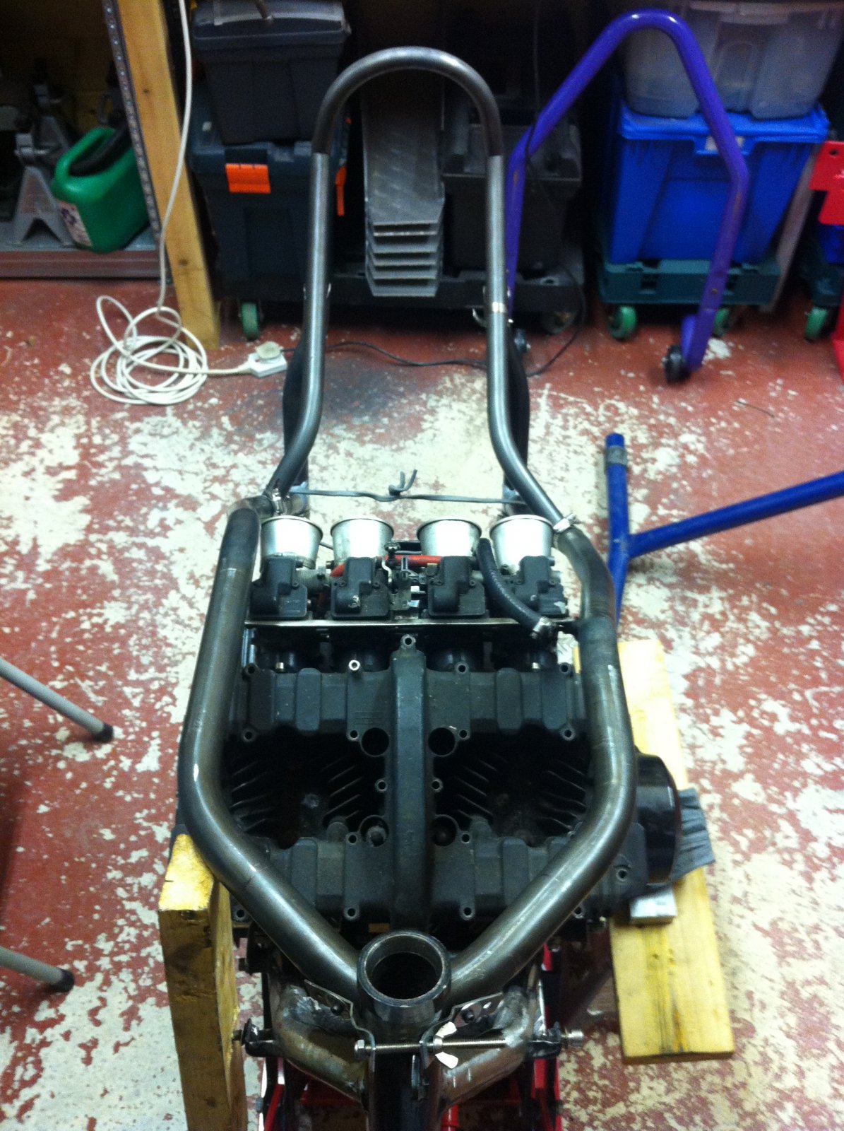

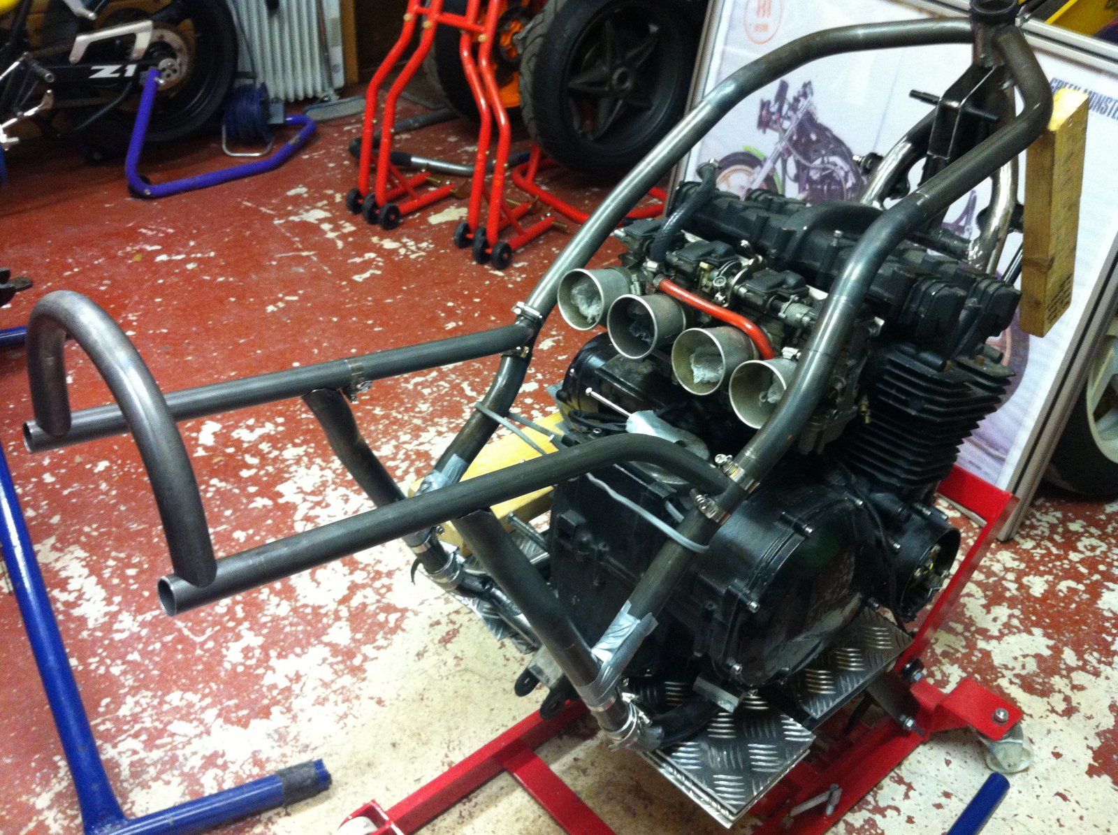

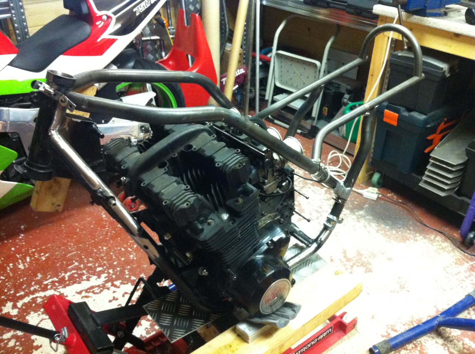

  5. I know it doesn't look like much progress from the last pictures but after a lot of head scratching Stage 1 is ready for welding and everything lines up!!! The second frame rail was a little bit of a challenge due to the asymmetric frame but I got there on the first attempt after a small test piece. I am quite pleased with the results so thought I would share more pictures anyway!!! :Happy:

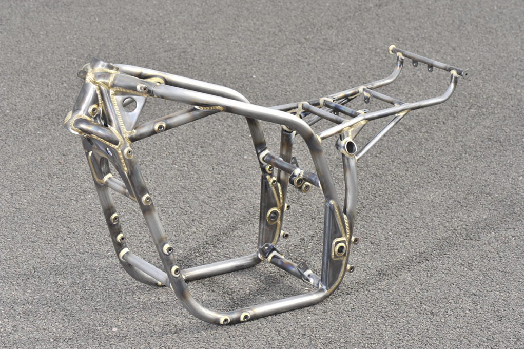

  14. Bronze welded T45 XR69 frame:
  15. after reading and then chatting to the guys at reynolds the advantages are weight and strength..but at some cost. they didn't tell me the price and i didn't ask! T45 will do for me, i can TIG and i have all the gear...but i love the look of the bronze and would love to leave the frame with just a coat of light oil. My only niggle is that TIG has alot more heat in it then a gentle flame and the method of welding has a bigger HAZ, heat affected zone, to which the metal can change is properties and needs stress relief. Unlike reynolds tubing Reynolds Technology
  16. Exige that XR frame is beautiful
  17. That's a Work of art Exige.
  18. T45 doesn't need stress relieving either from my research - one of the reasons I chose it too.
  19. It is, if I hadn't have used the stock cradle and head stock I would have gone that route too. I will make a true replica KR frame after the 2 I'm building and have it bronze welded. It would be a shame to paint it though don't you think? It needs lacquering only!
