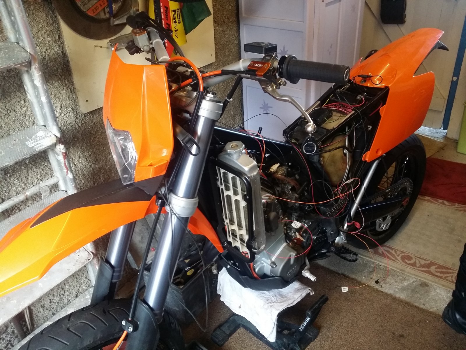

  8. Just to bring it back up to the top.....id say on the home straight now...
    It looks like a right mess there but a lot of the functionality is now working....so far I have....
    Starter button, (turns over the engine) - no cdi connection yet - that's tomorrow nights job...
    front and rear lights
    both brake switches working.
    Rfid ignition working
    full and dip beam working
    As I say tomorrow night is the CDi connection task....then get it fired up on the new loom
    After that clocks and all the relevant sensors that it now has that it never had before (looking forward to testing the G-Sensor)
    Once everything is actually functioning then the whole lot will be taken off and rewired permanently. Im hoping, the next 2 weeks it should be finished.
  9. Leaps and bounds last night....
    CDi is in and working (it starts and runs)
    Clocks are wired in along with the rev counter (absolutely the coolest clock powering up sequence ive ever seen. Period). The clocks are so good in fact im considering fitting a set to the Zed as the motogadget ones actually offer more information, I think than any other clocks ive come across.
    Left to do is the speedo magnet/sensor and the temperature sensor.
    However, the next stage is to label all of it up take it all out and then commit to a permanent loom as (as you can all see) its literally draped over the bike.
    Once the wiring loom is on then ill throw up some video of the starting sequence, m-unit and rfid tag/ignition.
