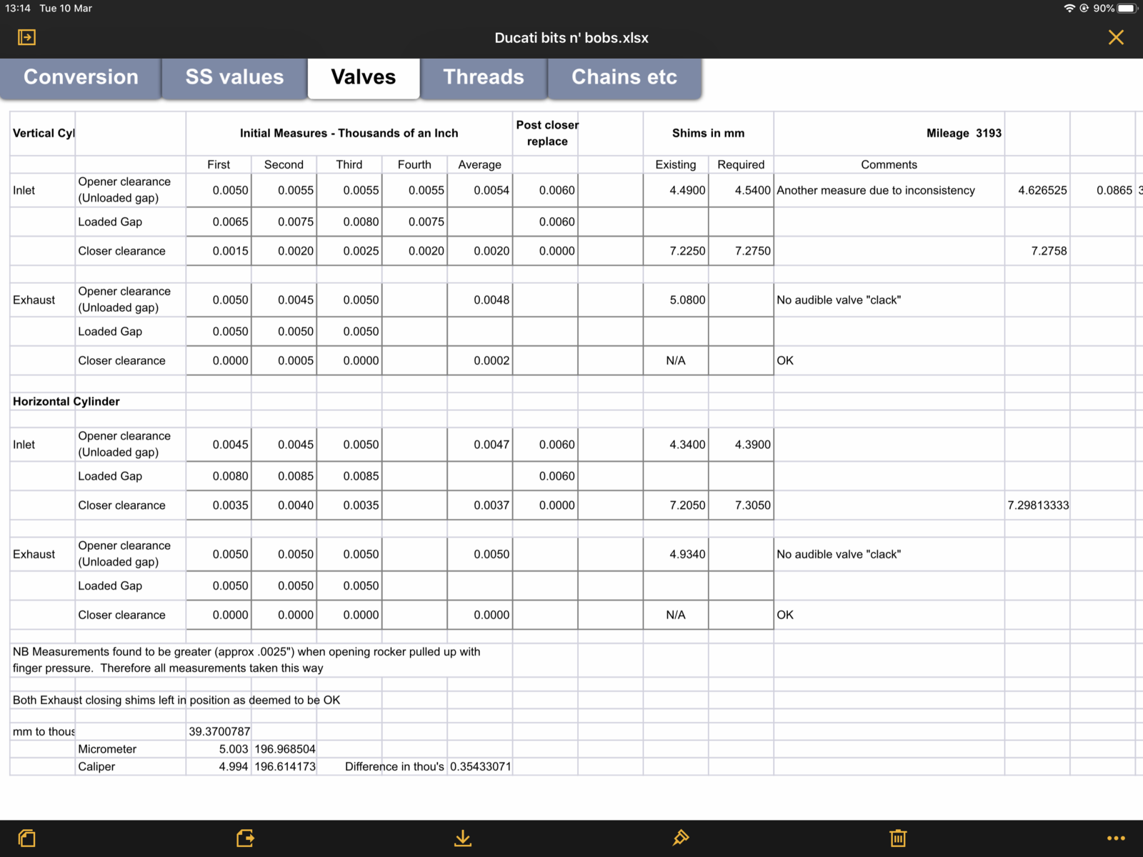

    To assist with the calcs I put this together on Excel which may be of help. As you can see I took more than one measurement on each shim whilst in the machine. All measurements were in Imperial units.

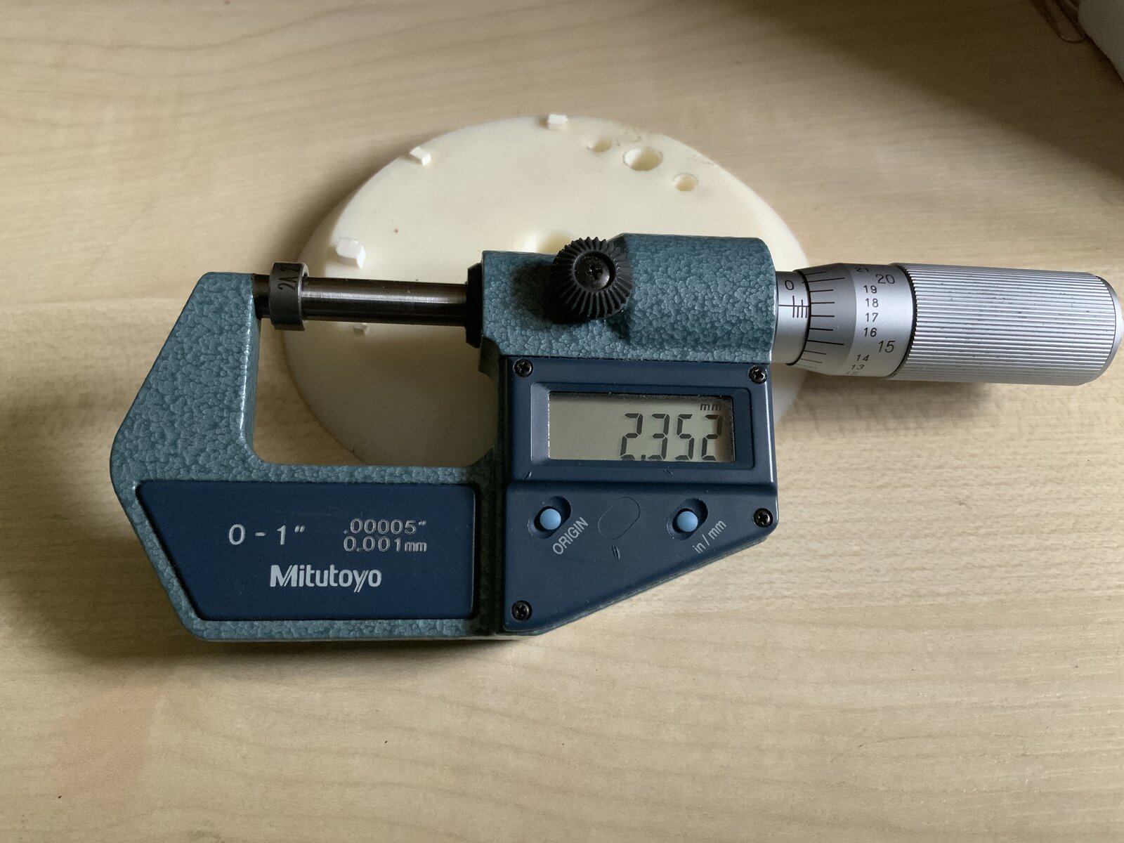

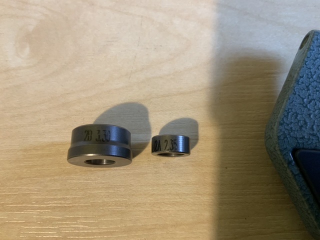

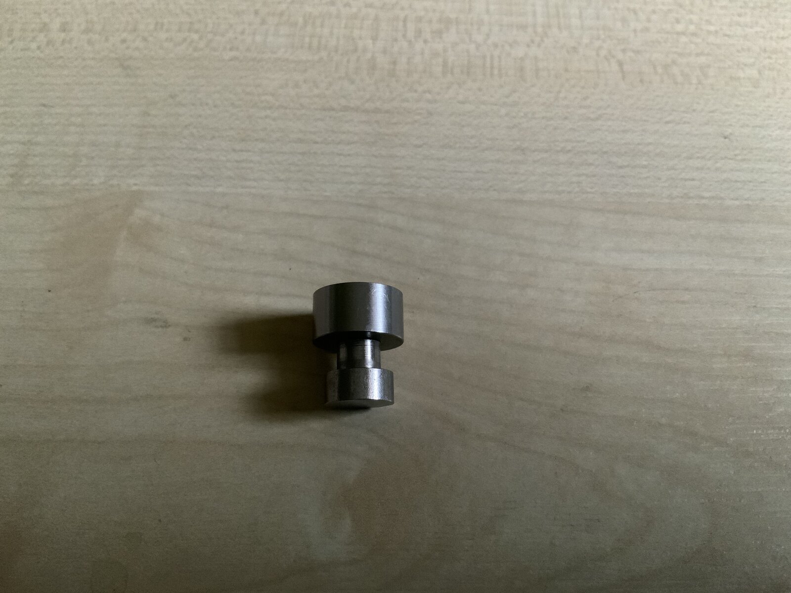

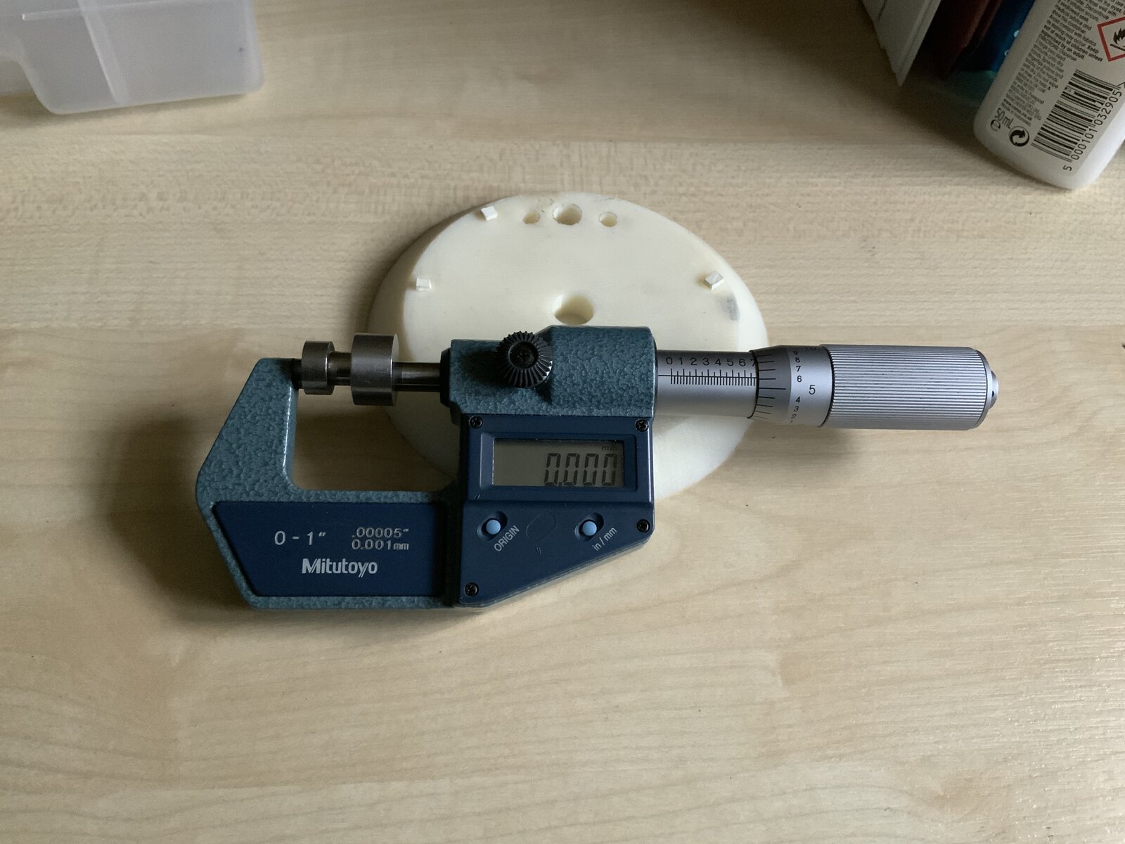

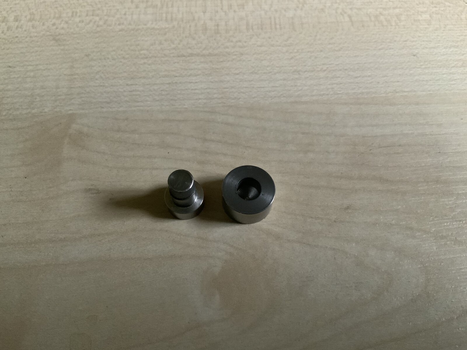

  10. As Derek says if it’s consistent then not a problem. I also bought the Laser tool but not that impressed embarked on my own design and manufacture based on my preferred measurements tool a micrometer. The only problem was the closer is the central hole as I wanted to measure the shim normal to the centre and not at the outer which can give erroneous results based on central shaft tolerance. Basically it can rock side to side as I apply the micrometer. Solved this problem with an additional spacer.
    All material stainless which I had lying around.
    Here’s the closer and opener - both new and untouched.
    using only the micrometer
    Using my pillar zeroed as per laser device etc
    Both parts - anvil plus spacer
    Anvil plus spacer
    Anvil plus spacer - micrometer zeroed
    Anvil plus closing shim plus spacer - micrometer now measures closer shim
